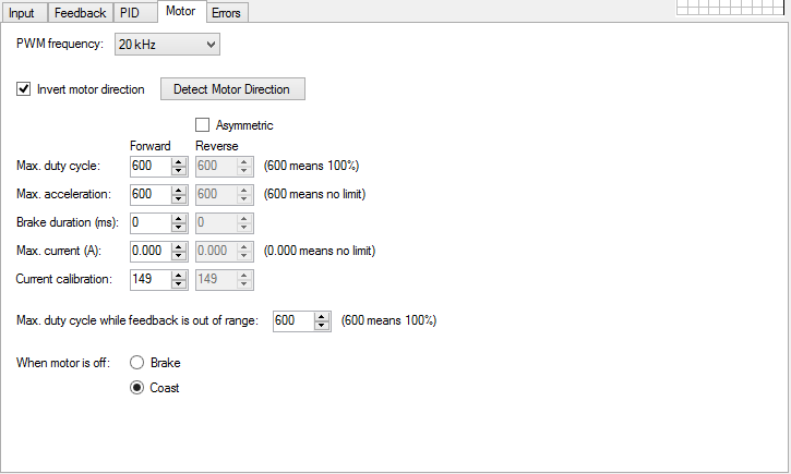

    Nice sim. Not sure what settings you have on jrks , but those motors can snap and move a lot faster. Can you post pics of the tabs in JRK utility ?

    Thanks man, ok
    Only suggestions, but it may really make the sim come alive
    Feedback tab, did you set the numbers manually? Or did you do a maximum and minimum position setting?
    PID, weird to me, but hey. Perhaps P 3/3 I 0/3 D 2/2 may work well, this is a BASE setting and seems to work well.
    Intergral limit, move up to 5000
    Feedback deadzone, down to 3 from 50.
    Motor, max current 0 ( unlimited) I hope you have heatsinks on the big chips and a fan to cool the JRKS.
    Only thing I suggest in motor tab is Max acceleration, try moving number down to 400 and if it feels less powerful, move it up in increments of 50. 600 is flat out. Not really needed. but I used it in the beginning trying these motors out.
    When motor is off, coast , not brake.
    My settings are similar to what I have recommended, in fact, the same. I set profiles to suit and have good motion, a nice vibration for bumps, snappy , but not too nasty motion for everything else. I survive 2-3 hours no problem.
    Everything else looks good, just remember, once you change the settings, the profiles may be way out, so you will have to redo them.
    Any problems, just holler.
    Cheers, David.

    I made adjustments that allowed me to have faster and larger movements. But this configuration suits me well and I can run for several hours without getting tired too.

    I made what you said. Now my sim is as you said : "more alive" :thumbs
    - braking is instantaneous
    - the change of direction is more dynamic
    - accelerations are more frank
    For the feedback tab, I did a maximum and minimum position setting and after that I made minor changes.
    For the PID I took your values.
    For the motor, I pu 450 for max acceleration.
    May still be a few changes to make, but the result is much better. Thank you!
