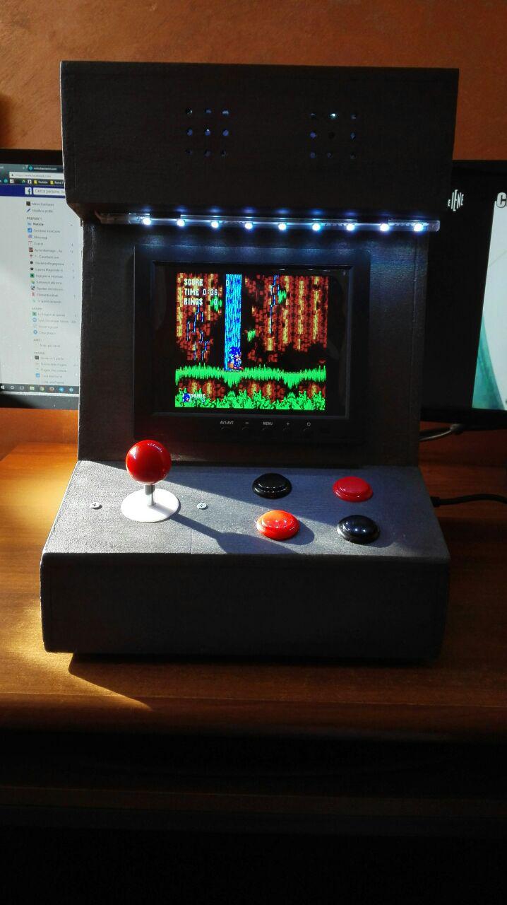

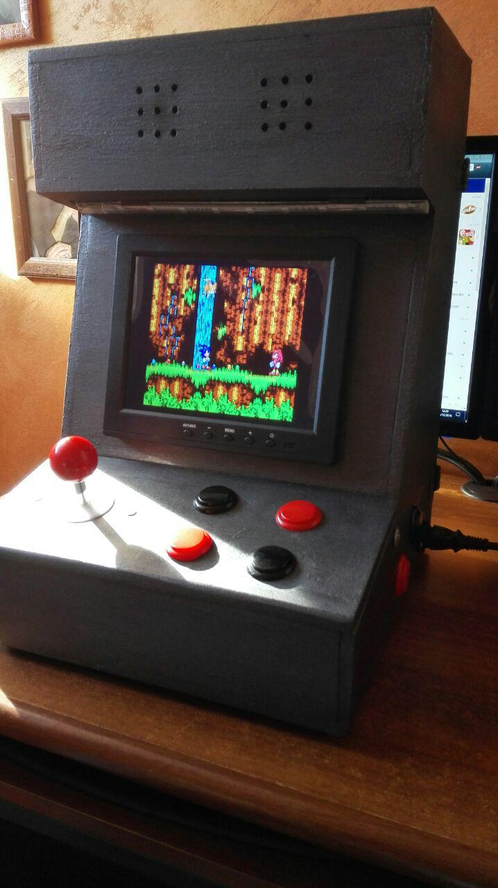

    What do you think about this beautiful cabinet created by me (and my friend) with Raspberry??
    I'm so proud of this work, it's very pretty and compact, and it's not too expensive. photo_2017-02-04_08-11-00.jpg photo_2017-02-04_08-11-04.jpg photo_2017-02-04_08-11-08.jpg photo_2017-02-04_08-11-00.jpg photo_2017-02-04_08-11-08.jpg

    great job! Just wondering why you did not cover the both screws close to the red stick?

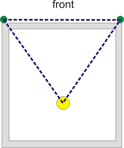

    Just one question...why do you choose to put motors on front of your chair, like noorbeast's simulator?
    In my mind (I don't know if it's true or no) I think that it's better to put motors on back, under the seat...

    Thanks for your opinion!
    To your question:
    This should be a part of the sim looked from above.
    The grey square is the frame on which the seat is mounted.
    The yellow dot is the pivot point (it's not in the middle of the frame).
    The green dots are the points where the force of the motors goes in.
    The dotted blue line now forms an equilateral triangle.
    And what does this mean ?
    I don't know, :D but i've tested the movements with my 3d-program and they seemed to be ok.
    The finished sim has also confirmed this (Thank God ! :))

    For me, the construction of sim it's a very difficult point, i'm not very expert in mechanic, but i'm an informatic/electronics engineer... For now i'm building a small model with Arduino and 2 servo (placed on back).
    For example, I didn't know since now that the pivot point can't stay on center of frame :)
    What do you think about adding traction loss in a compact way? (without any bigger structure on back of frame)

    Oh no, the position of the pivot points depends on the sim you want to build. Whether you want a seat mover or a frame mover.
    In my opinion it's better for a car racing game to build a seat mover and for a flight game a frame mover, but this question is hotly discussed in this forum, and everyone is somehow right.
    First you have to decide this, then you have to mount your seat on your frame, and then you can determine the position of the pivot point while sitting in your seat by balance it all out.
    I don't have traction loss on my sim, so you should study the faq's and other members threads who have TL. I don't want to give you wrong advices.
