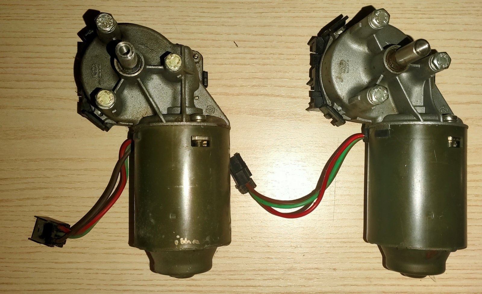

    I'm starting to design my first 2DOF DIY simulator. Everything is based on these 2 wiper motors from an old car.
    I will use an Arduino UNO with the SMC3 firmware to drive them.

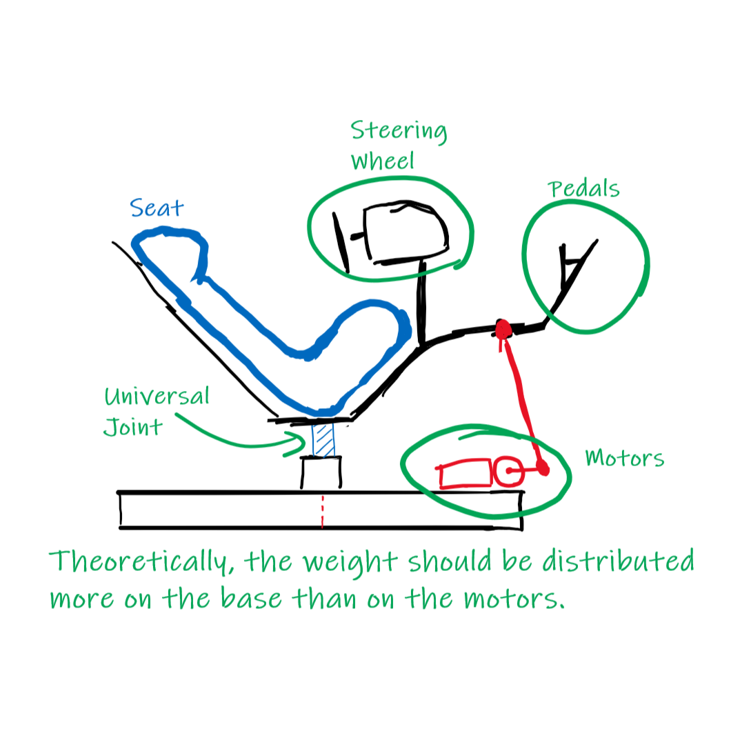

    UPDATE 23/11/2021
    Hi everyone,
    I tested the motors today to see if the external chassis was grounded, but it's not, so I think I'm fine from that point of view.
    Regarding the power of the motors, I was thinking about a design with the universal joint placed in the center of gravity of the rig and the two motors in the front, theoretically, it should work.
    Here's a drawing of my idea
    I'm waiting for your advice...
    Thank you all for your answers and interactions with my project.

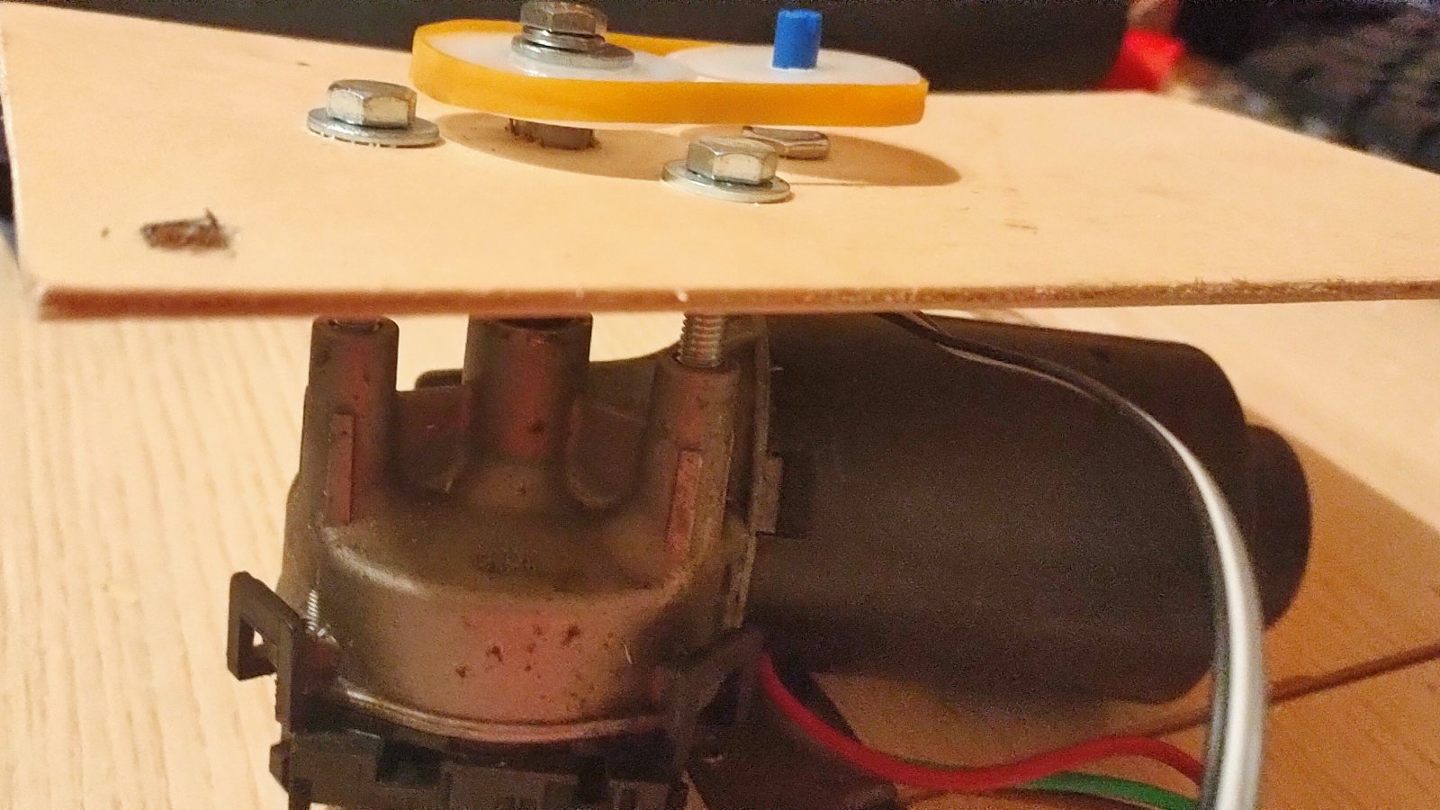

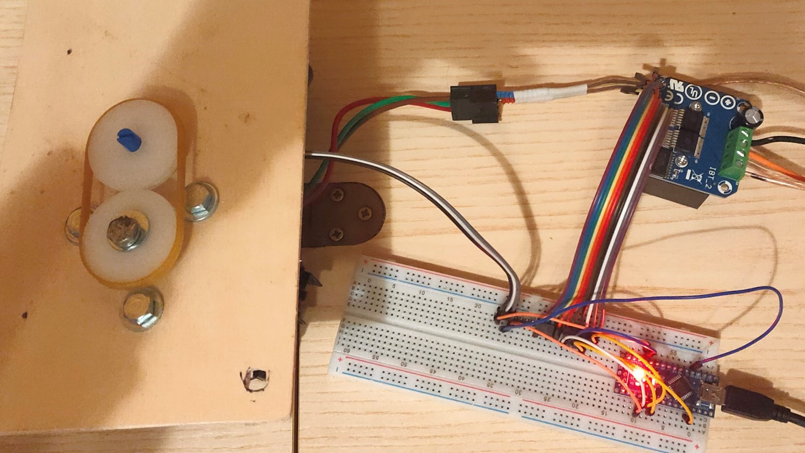

    Yesterday I finally got the drivers for the windshield wiper motors and I proceeded to build a testing rig to test the software working with the hardware and surprisingly everything worked as expected.
    Here are some pictures of the rig:
    It moves!!!

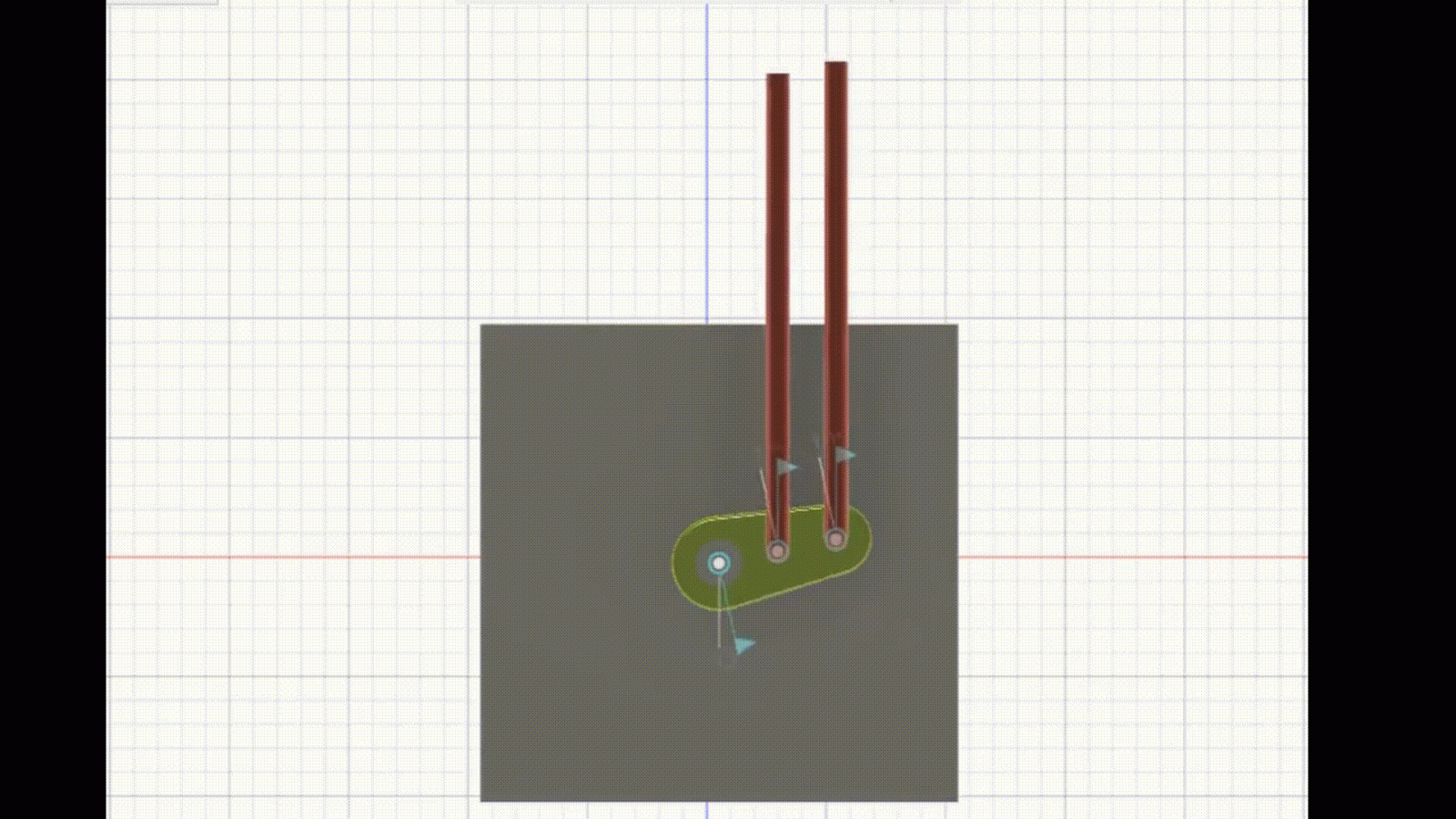

    •·················•·················• QUESTION: MOTOR STRENGTH •·················•·················•
    Now I have a question,
    Since the motors are not very powerful I was wondering what is the best length of the segment that connects the motor with the uni-ball in order to minimize the stress on the motor.
    In this video, I did a test to establish the benefits of the different lengths of the segment mentioned above (shown in green). Obviously the longer it is the greater the displacement will be, but I am afraid that it increases too much the effort on the motor.
    I wait for eventual answers and in the meantime, I will make some tests.

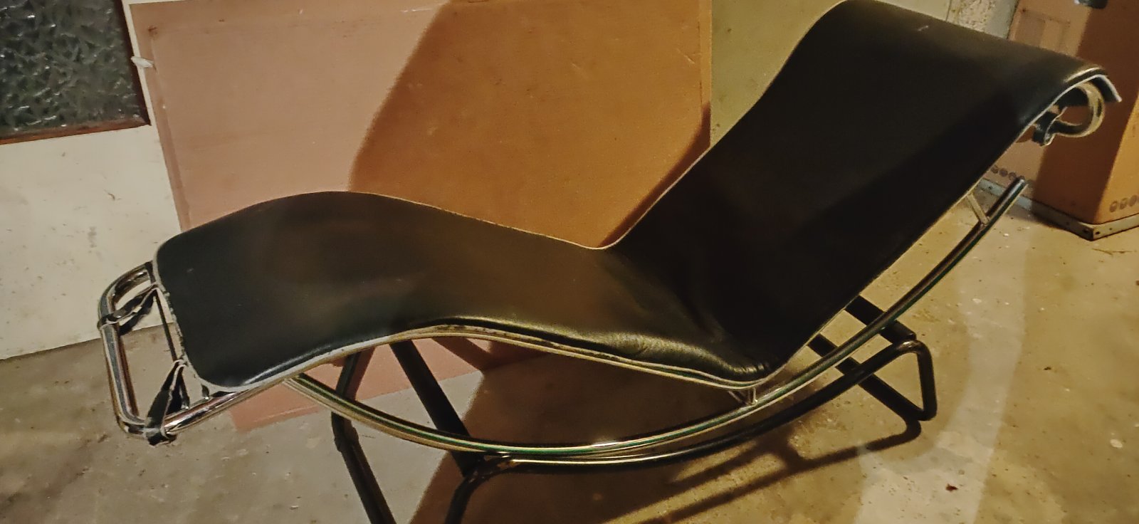

    •·················•·················• SIMULATOR STRUCTURE •·················•·················•
    Let's talk now about the structure of the simulator
    Since I decided to go for a cheap solution, I looked for an alternative way to do the seating.
    This was my idea:
    Yes, you saw it right, that is a chair that was once used by a psychologist for his sessions. Well, I saw in it the perfect shape for a simulator, am I wrong?
    I'm always willing to receive criticism and suggestions, they could be crucial to the success of the project.
