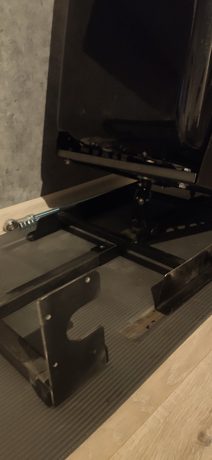

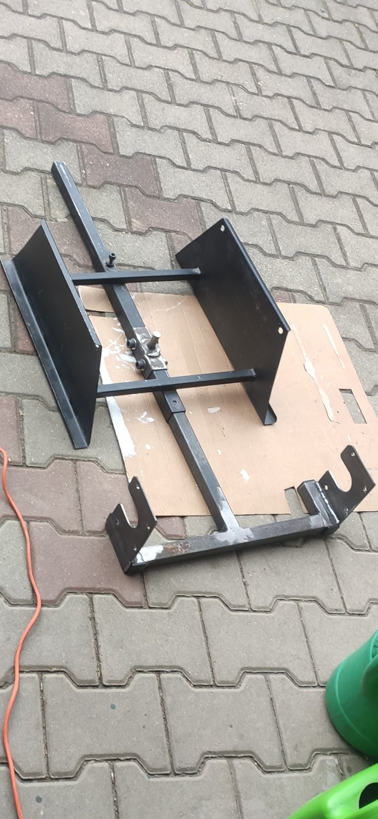

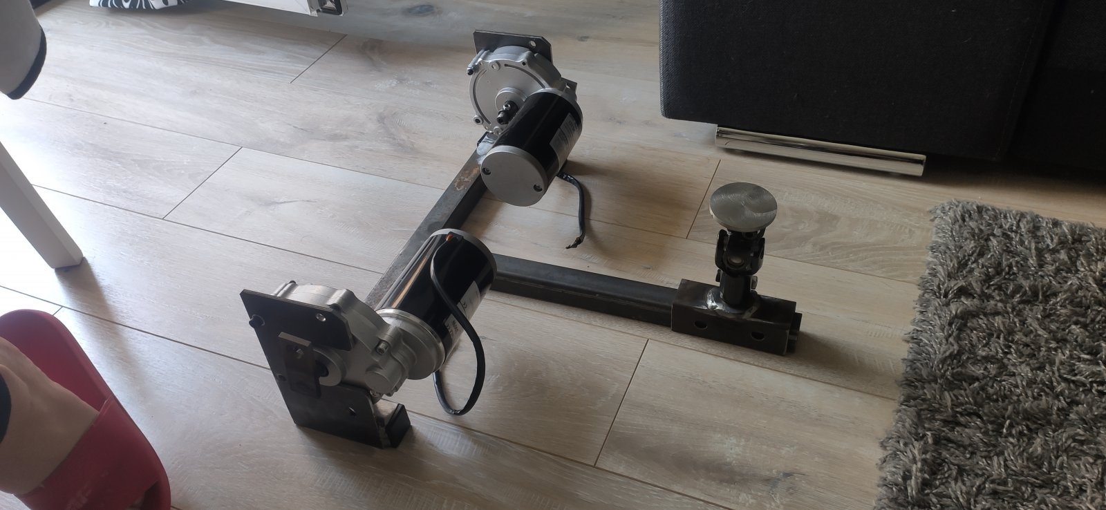

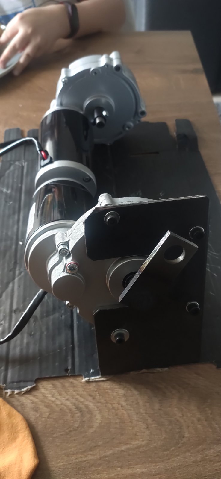

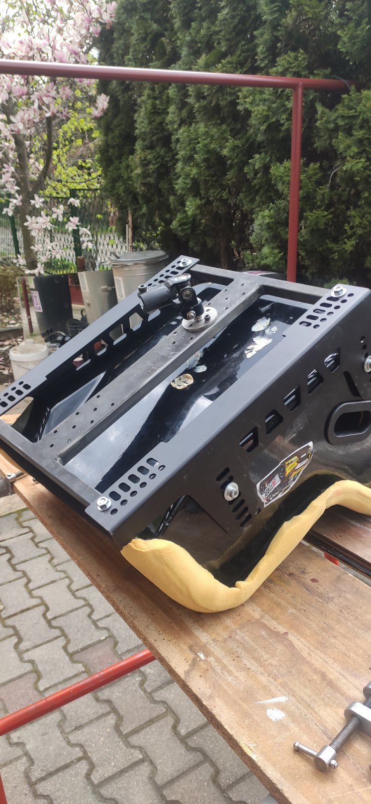

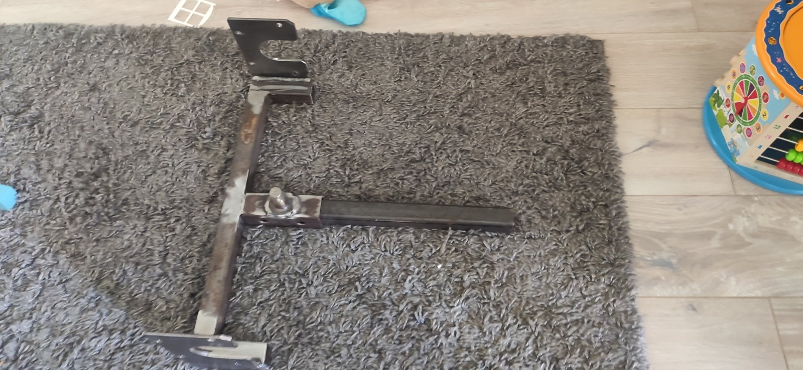

    Bzzz bzzzz I'm back to my 2dof project and make some progress. I have existing rig and I want to do some add on. My rig is build with 35x35 metal profiles I make add on with 30x30 and put inside profile and connect them with scrue. It's good solution for me becouse when I start testing I will see how strong my motors are. Then meybe I decide to put them in front of my sit. Now it's time to do 2nd part of rig for my seat and then connect it and start testing. I know for now that I must do some break again on the next week so my next progress will be after 1st weekend of May. I'm exited I went so far from zero.

    Hi, I am at about the same build stage for my first3DOF platform. Are you going to install also batteries for the regenerative power or are you gonna use clamp resitors?

    Hi. Good luck for u and your project. No i don't use batteries a have 2 power amp 300 wat for 220 volt. I don't understand what clamp resistors means

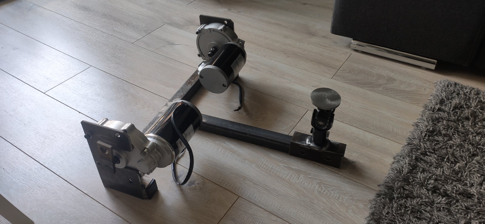

  5. Krzysztof Dej
    Krzysztof Dej Active Member
    Jun 3, 2020
    301
    Poland
    1,056Coins
    +71 / 0 / -0

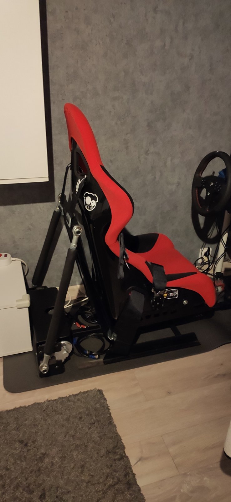

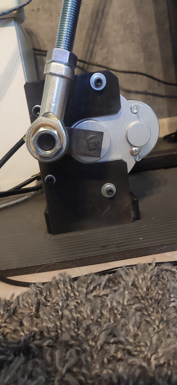

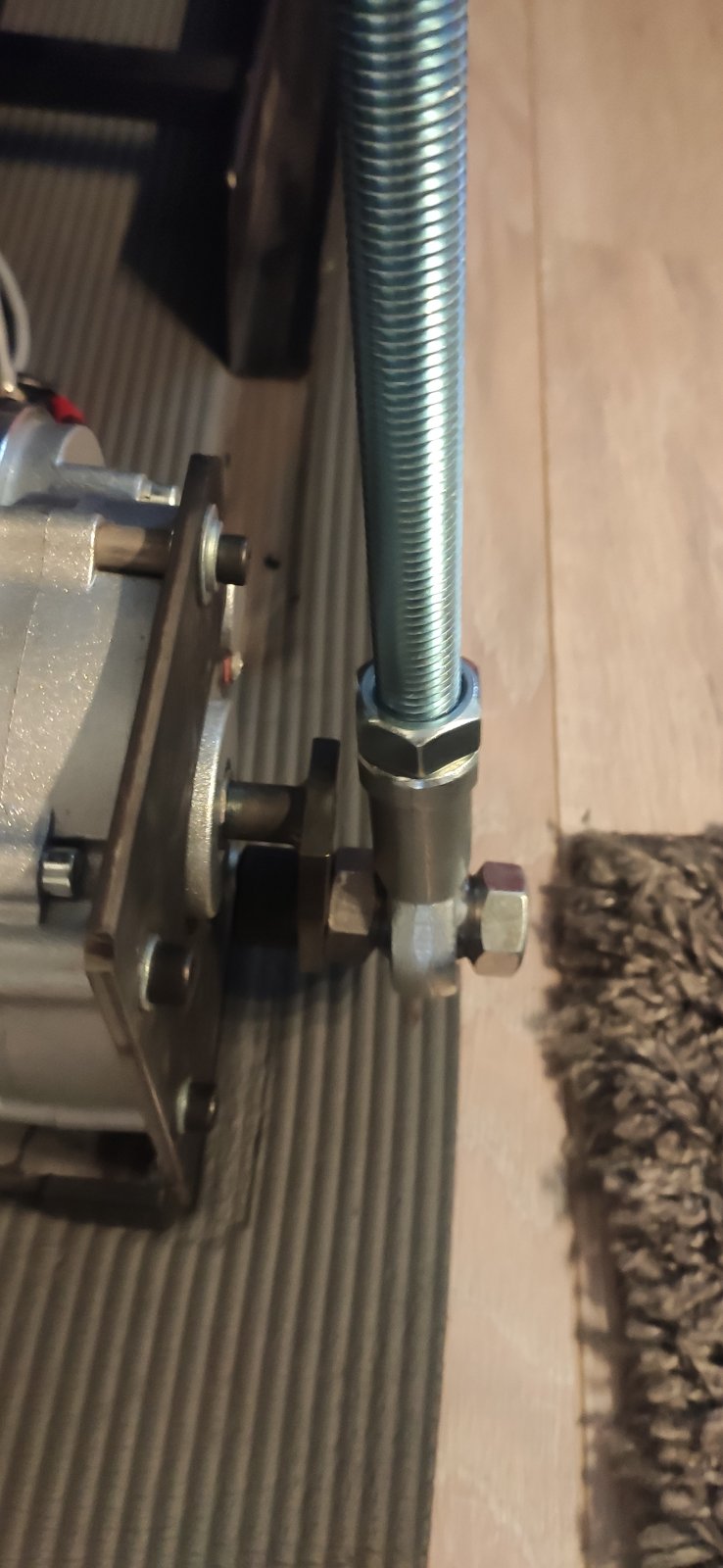

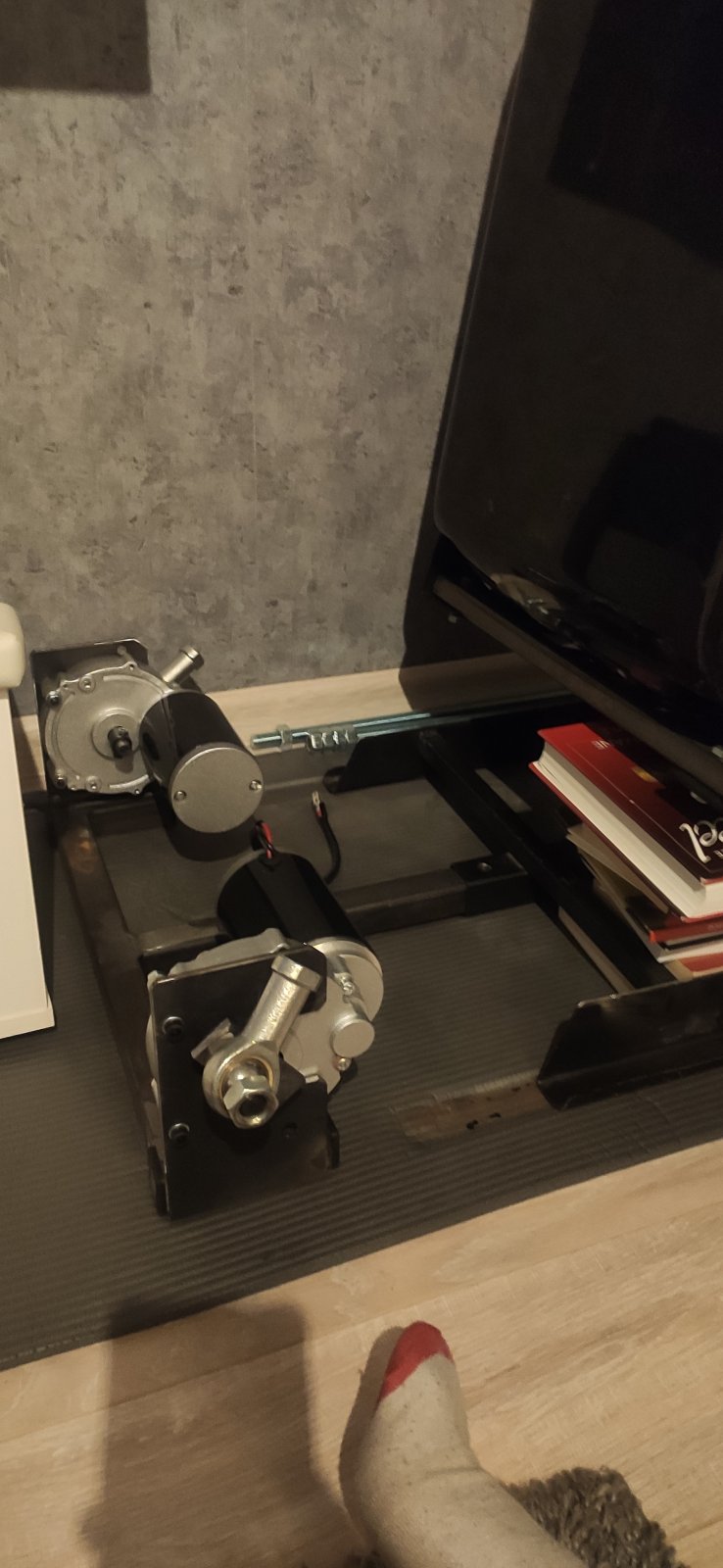

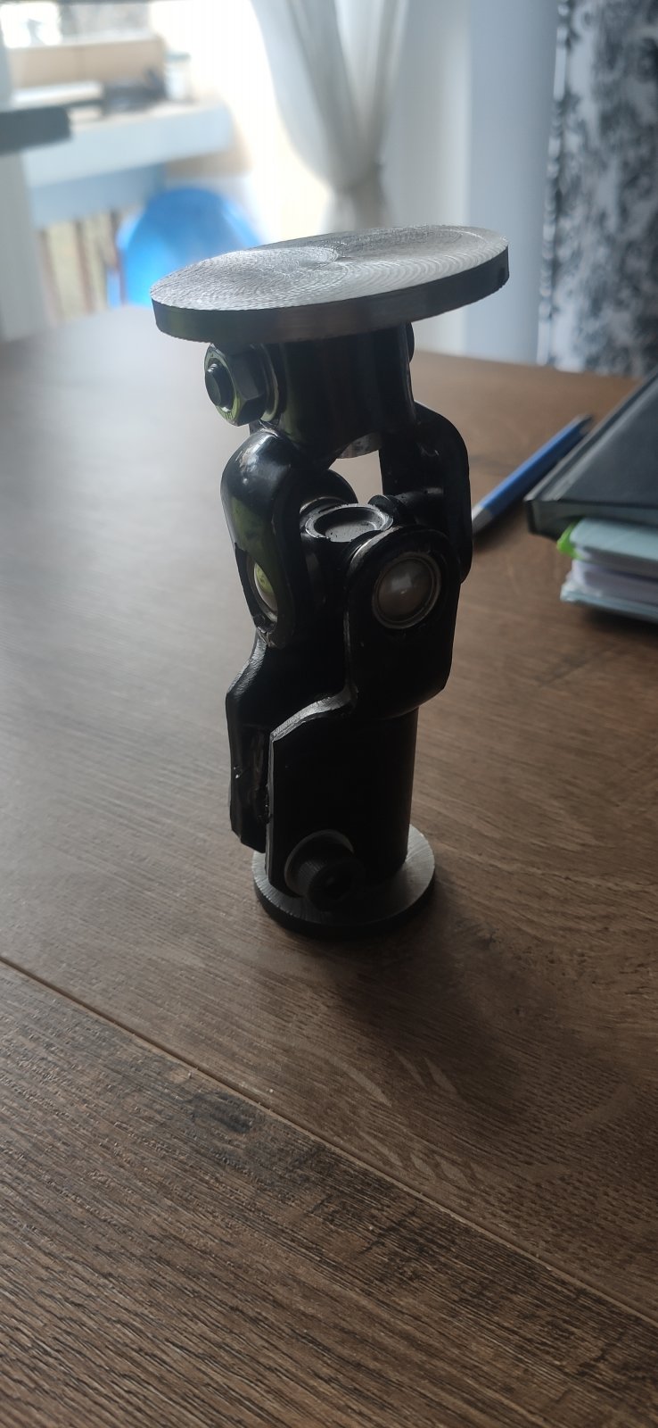

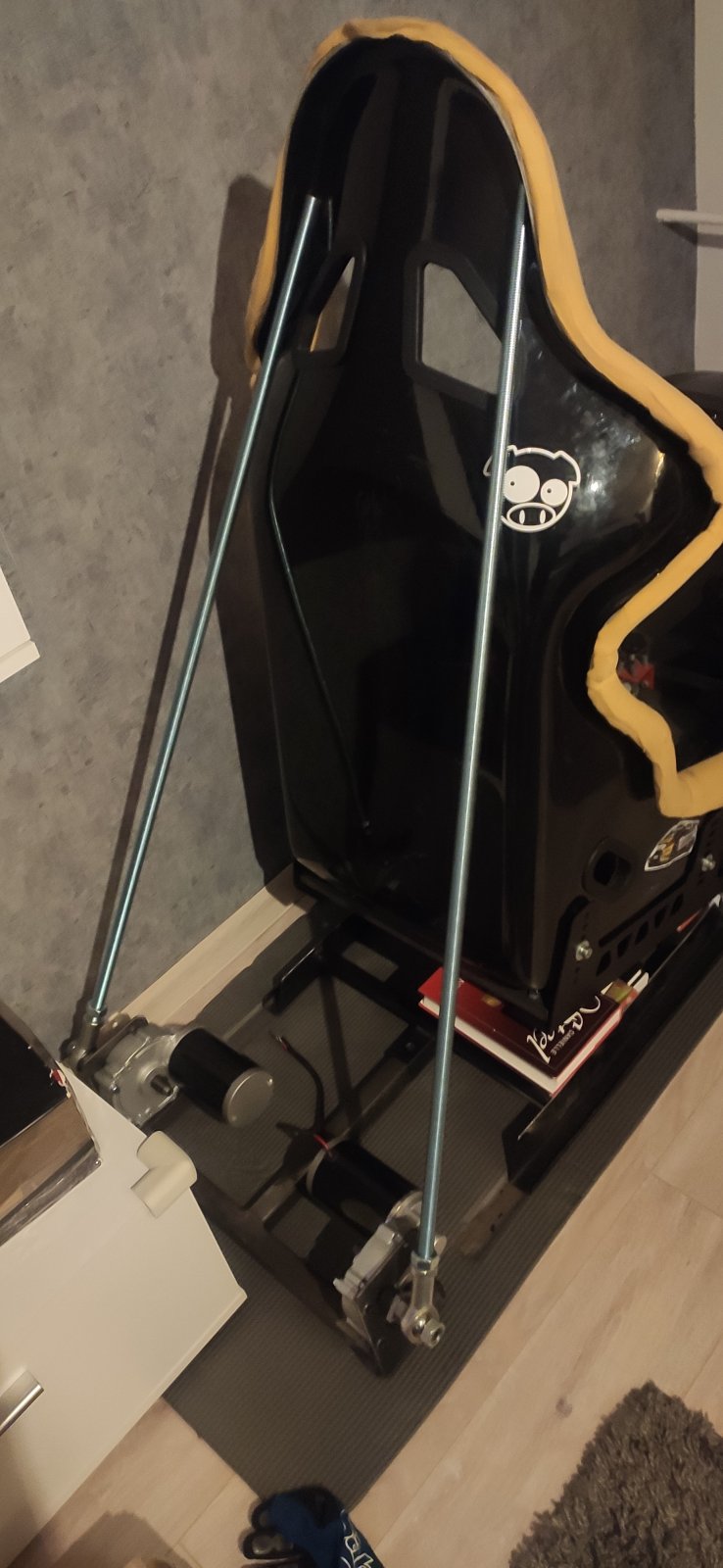

    Hi I make huge step to finish my project. I make add on to my existing rig try to make pivot point adjustable to make sure my weight point will help my motors. I already have 1st tests and it's working!!!!! If I can do this anybody can!!! I like to tnx all people who helped me solve my problems.
    I will tests it and solve potencjal problems
    I want also to create pot cover and new electrical box. Here is my photo and yt video from test 01
    Forces used :surge, sway, heavy

    Omg it's sooo amazing. All the g forces imitate make so good sense and fun. 200 wat motors is strong and they r cold after 30 min playing
    I record young adept making his debiut.
    When he go off track in fisrts reactions was that I was shaking the seat :) I never thought it was going to be that cool

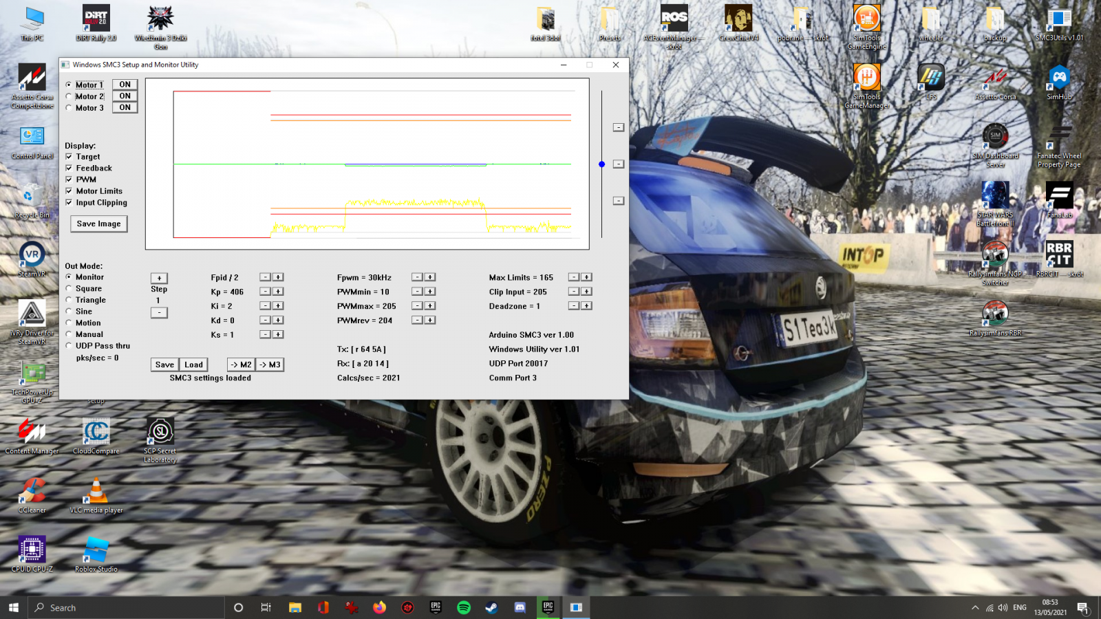

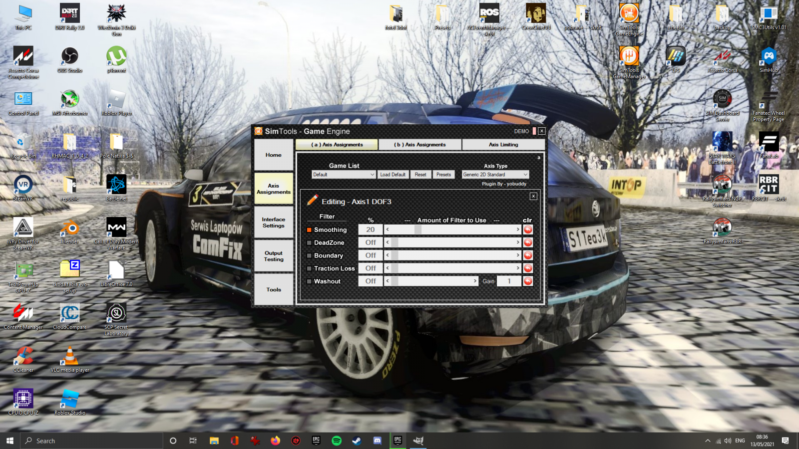

    I post my settings in sim tools and smc3 also
    I pul filter on sway for smooth and feeling is ok

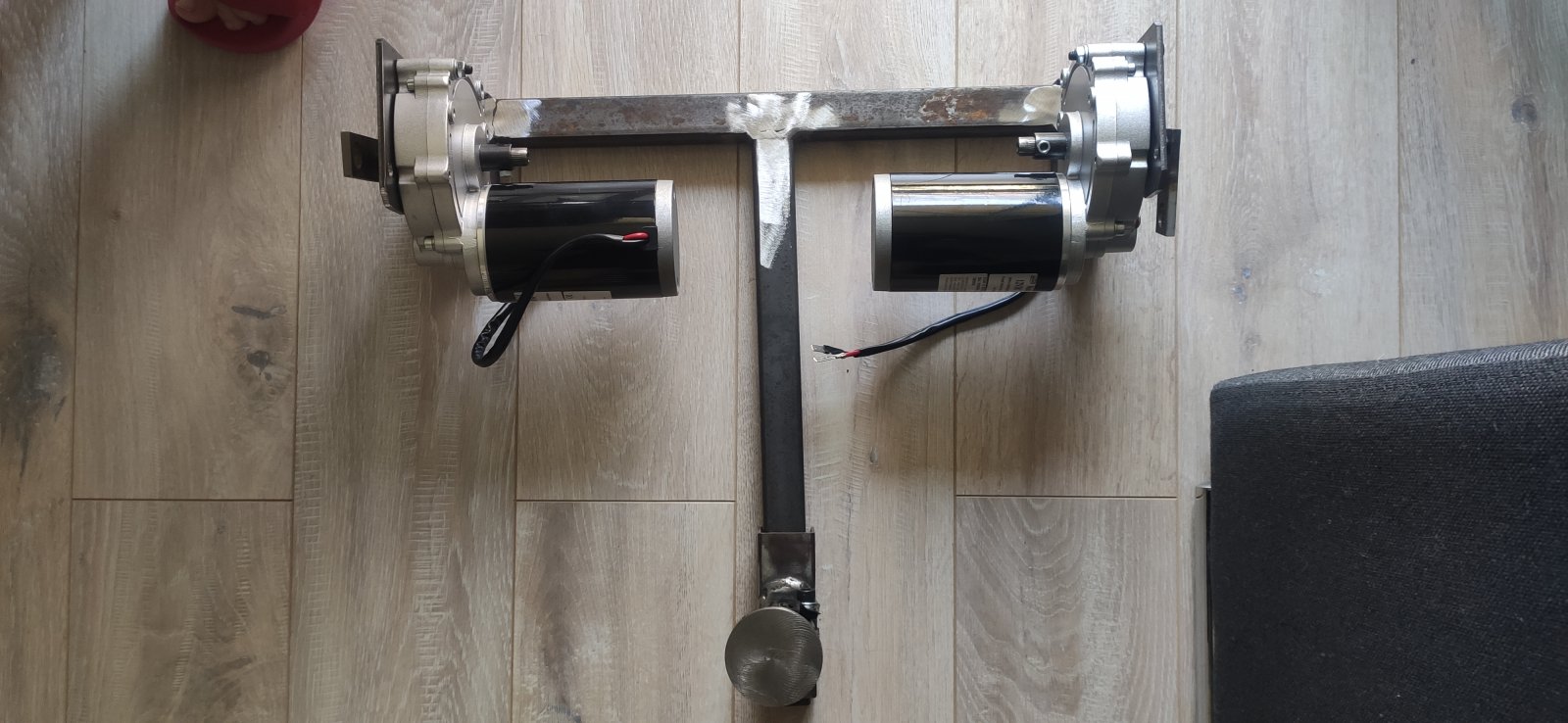

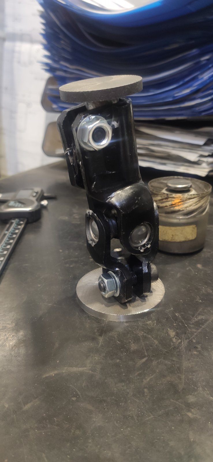

    So my conclusion after this few month :
    From 2dof RC do 2dof motors is much more complicated but u can do it:)
    Important to remember change regional settings in windows!!!!!
    Buy shielded wires for motor silent work
    Be patient if somethings doesn't work. Try switch to the second motor, always restart smc3 after something is wrong!!
    Find best weight point for cardan pivot to not load the motors.
    Buy 20 pots or 2 hall pots :)
    Tnx eweryone for help and good luck with Yours project

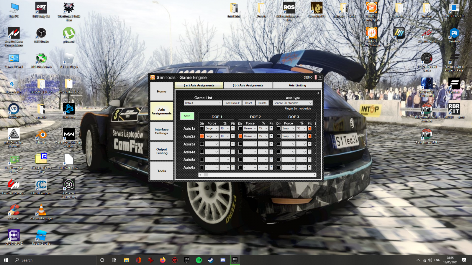

    Trying to set profile: Can U guys talk with me what is the best? I think surge, heawy, sway. But I have mixed feelings about add pitch and roll i think this is good for symulator where screen and steering wheel are moving. What forces are You have guys?
    20,557
    145,160Coins
    +10,780 / 52 / -2
    I use sway, heave, surge, roll and pitch, see the tuning tips in the FAQs, initially do one axis at a time, then turn them all on and tweak from there: https://www.xsimulator.net/community/faq/steps-to-create-a-motion-profile.228/

    Ok but u put more on pich and roll or less? How u find this. I start yesterday rally stage The road was inclined and I was leaning off. I don't know if he wants to. Like I say upper post. Pich and roll is better for platform with vr where steering wheel moving also
  12. noorbeast
    20,557
    145,160Coins
    +10,780 / 52 / -2
    You start at around 25 Axis Assignment and do each axis individually at first, to find the best settings for each, as per the tuning tip link. Likely you will end up with higher Axis Assignment values for sway pitch and roll, lower for heave and possibly surge, but it can be different for different games. Refining a motion profile takes time and practice.
    Tuning includes refining Tuning Center values after an initial capture. On some games heave may have a TC value less than 1, the larger the value the slower the response, but over a bigger range, the smaller the value the sharper the response, so roll and pitch often have higher TC values that say surge or heave.

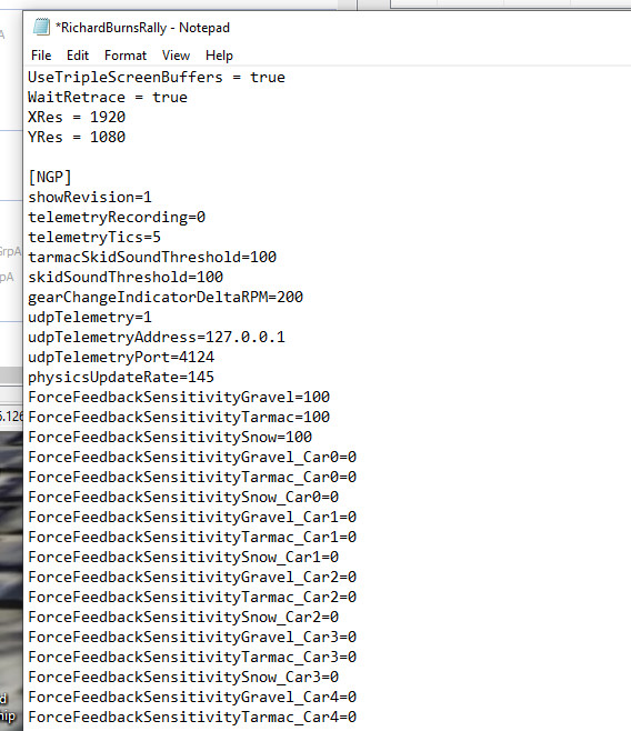

    Hi so I understand that I must have game configurated to receive data on simhub and udp to sim tools? So if simhub receive game port 6667 i create forward udp for simtools 4231 on 127.0.0.1 to sim tools can receive data? This is not working for me. Sim tools patch all games for shaking. When I configure them for simhub is this right?
    I want to have my shakeit from simhub.
    Like on this pics game telemetry udp port will be 6667 (game patched by simhub)
    And forwarding do sim tools
    UDP forward port 4231 that sim tools can take data from port that it use. Can someone help me config this?

    Simhub udp for Richard burns rally :)

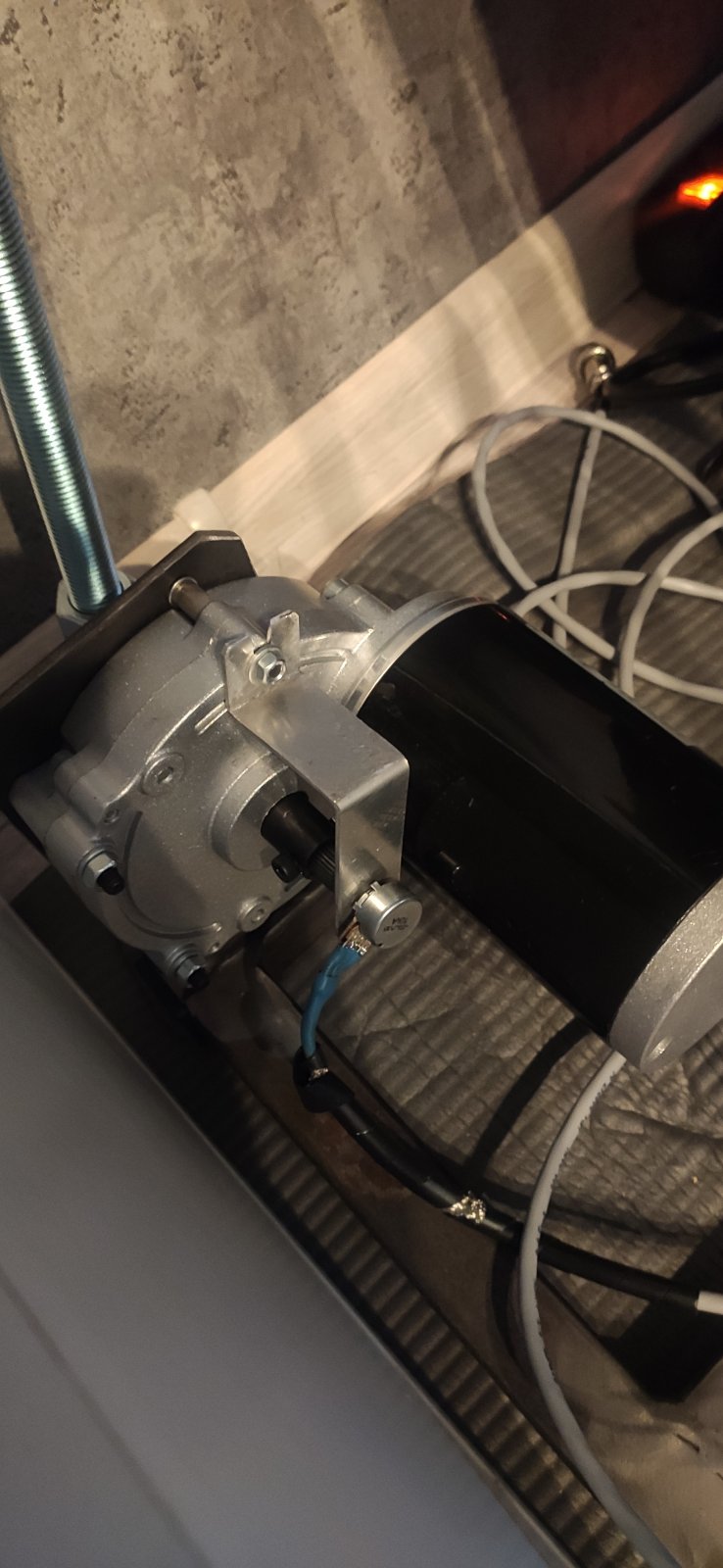

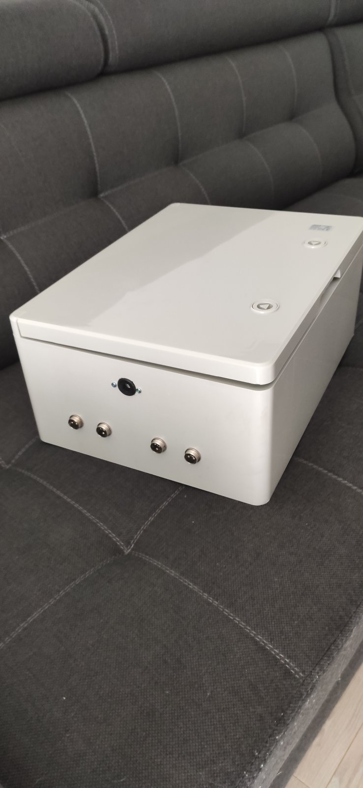

    Final version added some covers and.. Replaced pots with hall sensors ( i broke like 10 pots already)
    One more thing to do is cover for electronics.
    After about a month of use no other malfunctions

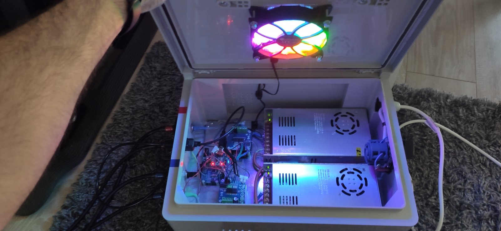

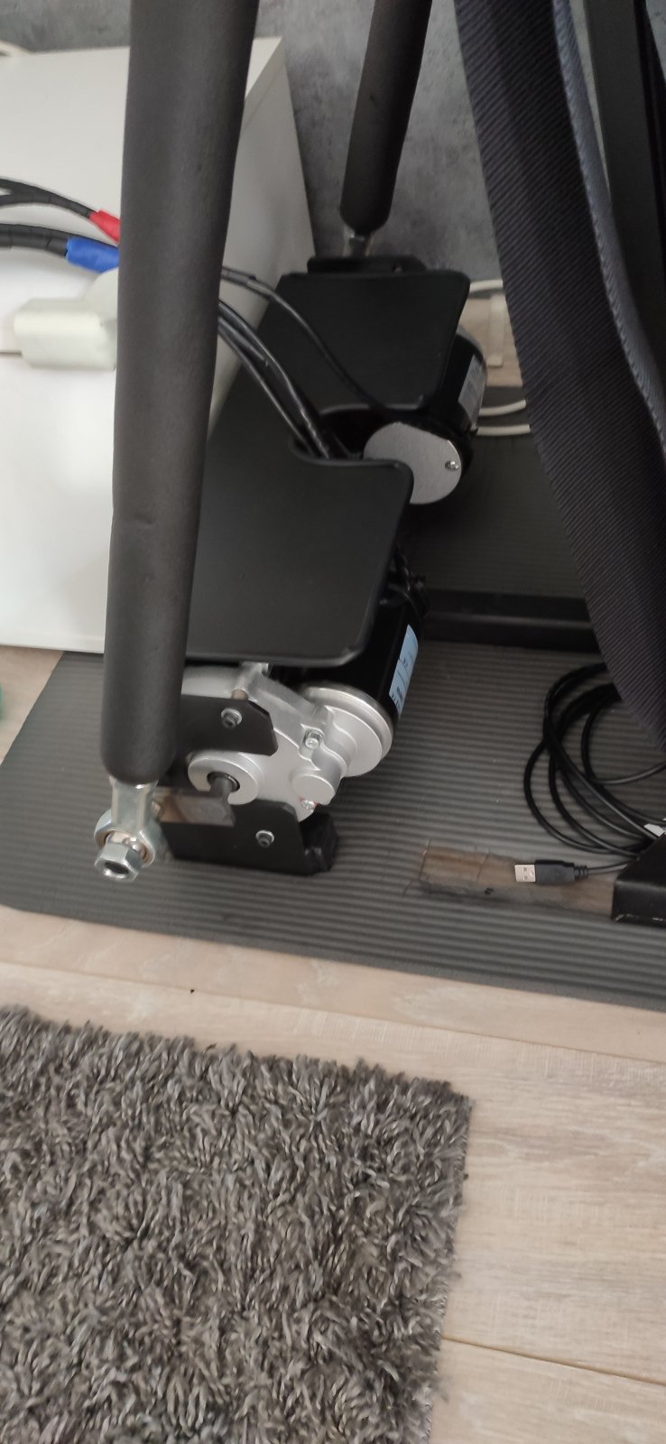

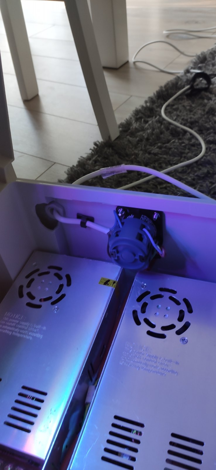

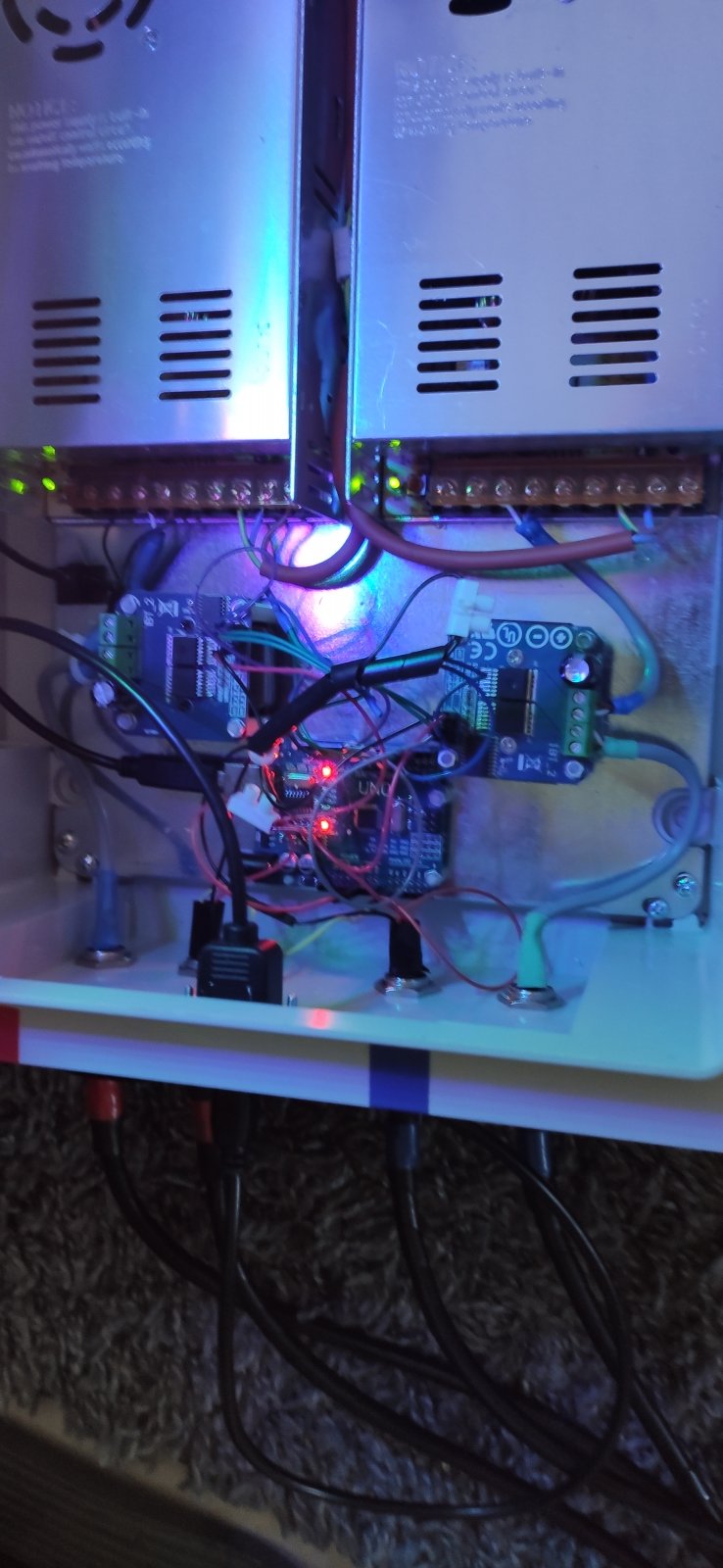

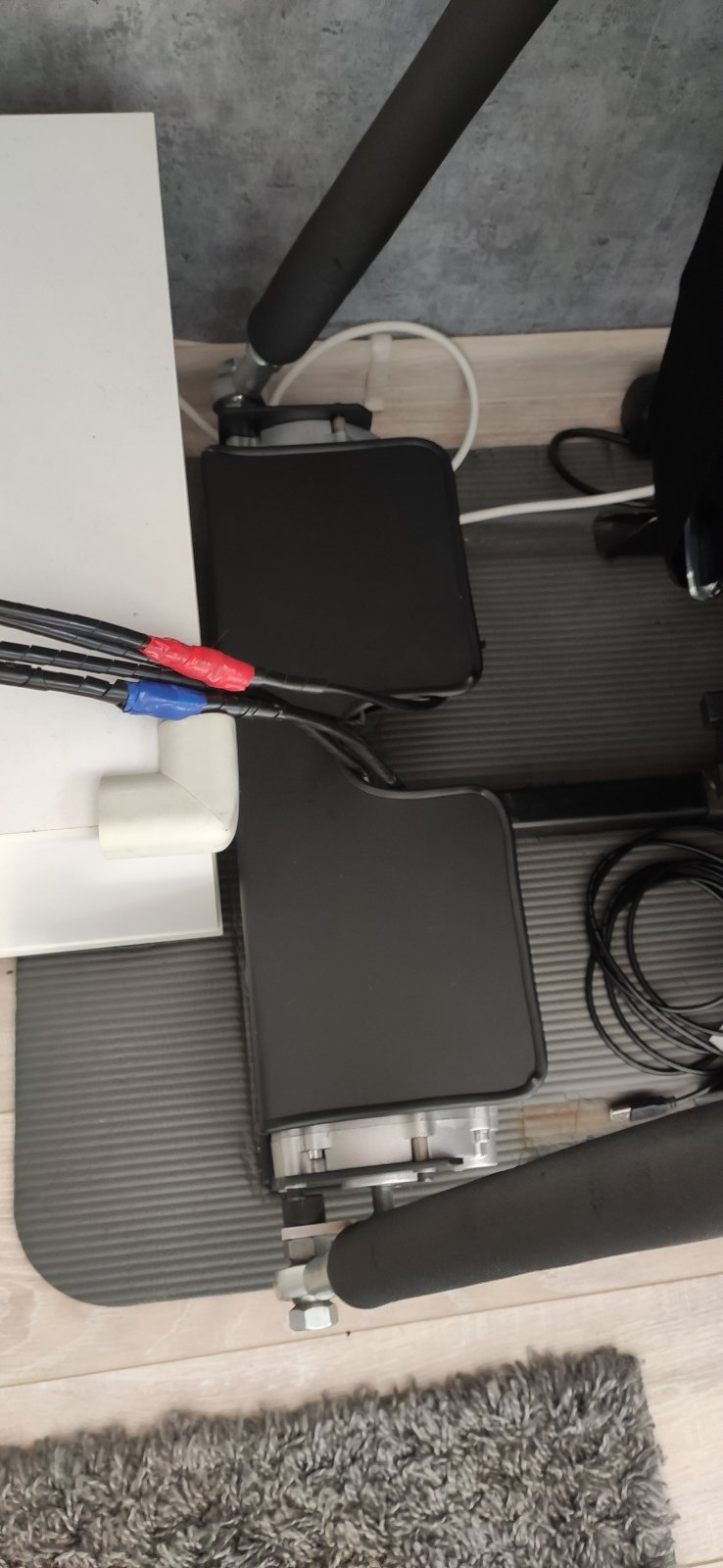

    One of my last posts. I managed my switch cable with stuff termo shells to avoid potencial damage. I finish box with all electric. Connect radiators of motor controller to metal plate by aluminum plates to dissipate heat. My 1 year old baby is my best beta tester so all things must be armored :) for me and my lack of time most demanding thing was creating motion profile. So I write a lot on this forum and yt and still best is less movement with subtle information. On this time I use my 2dof I have problem with one loose pot. My fault I don't give a washer to screw ;/ my longer play was about 3 hours and all elektro and motors was cold so it's working good. Thx so much for all people who helped me with my project and good luck with yours
