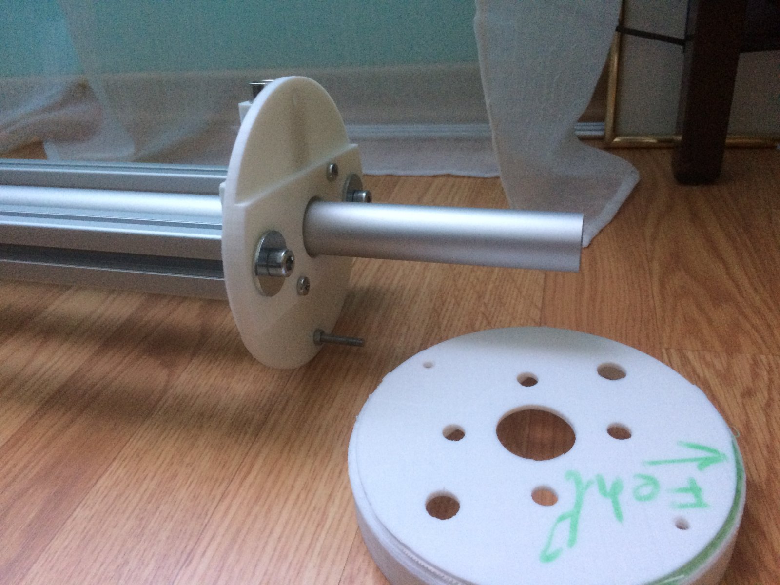

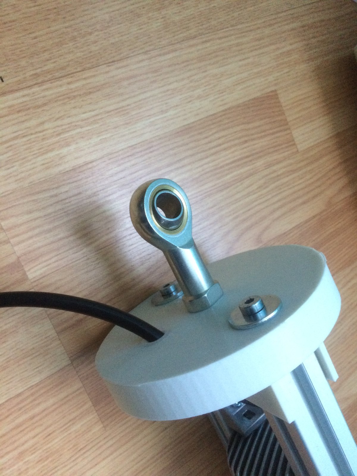

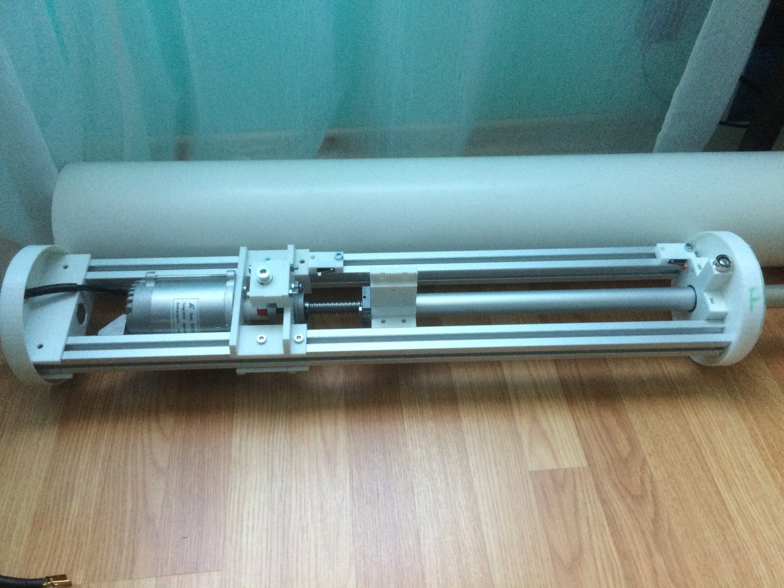

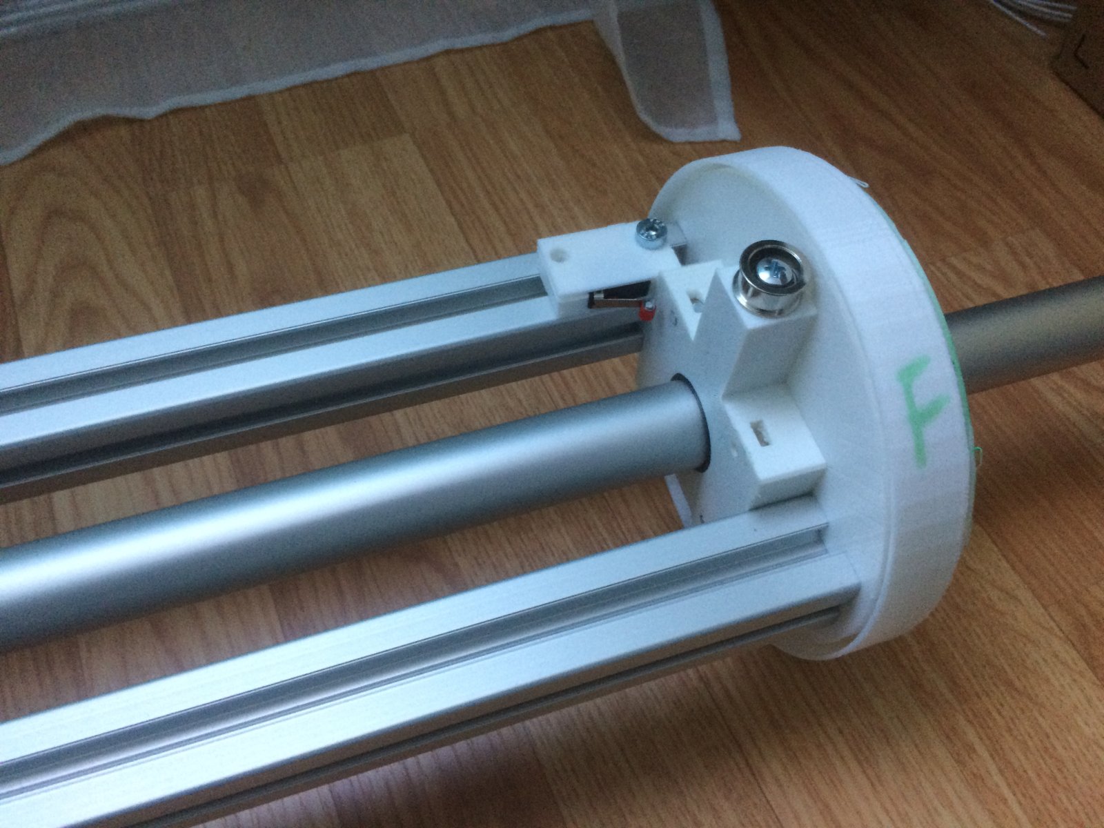

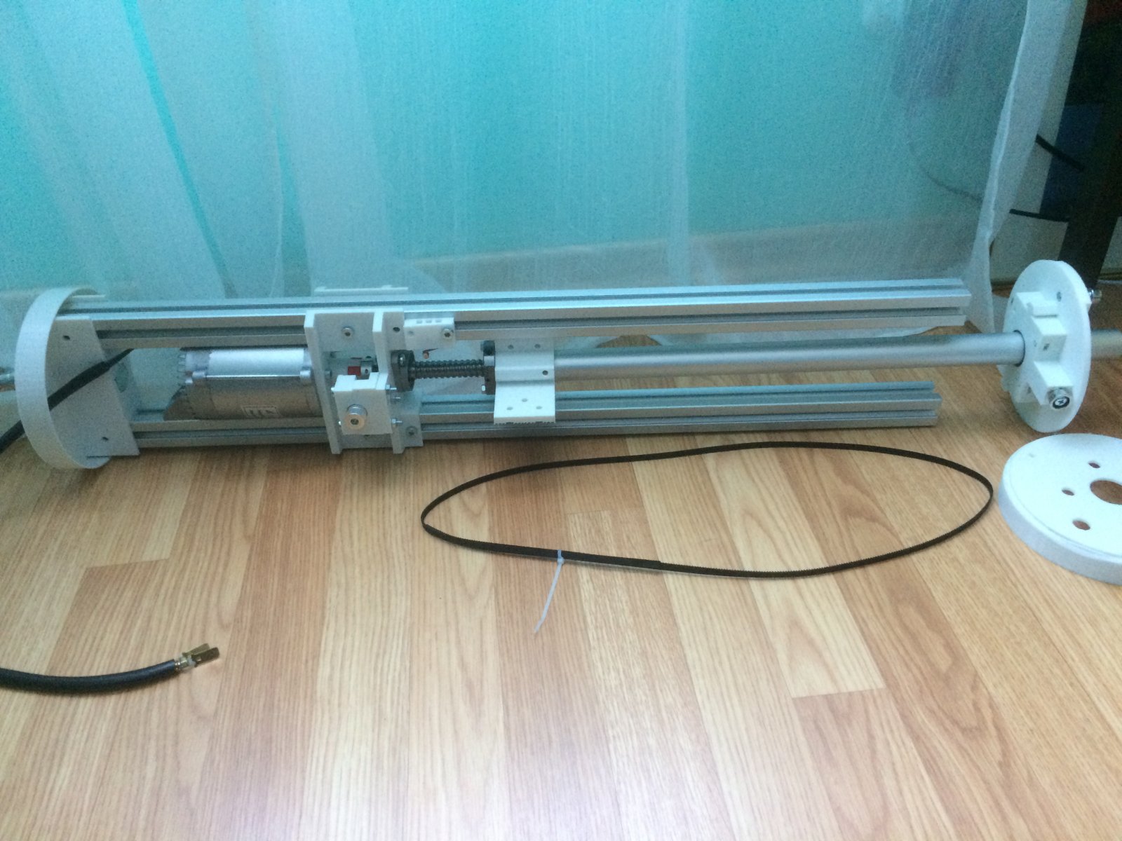

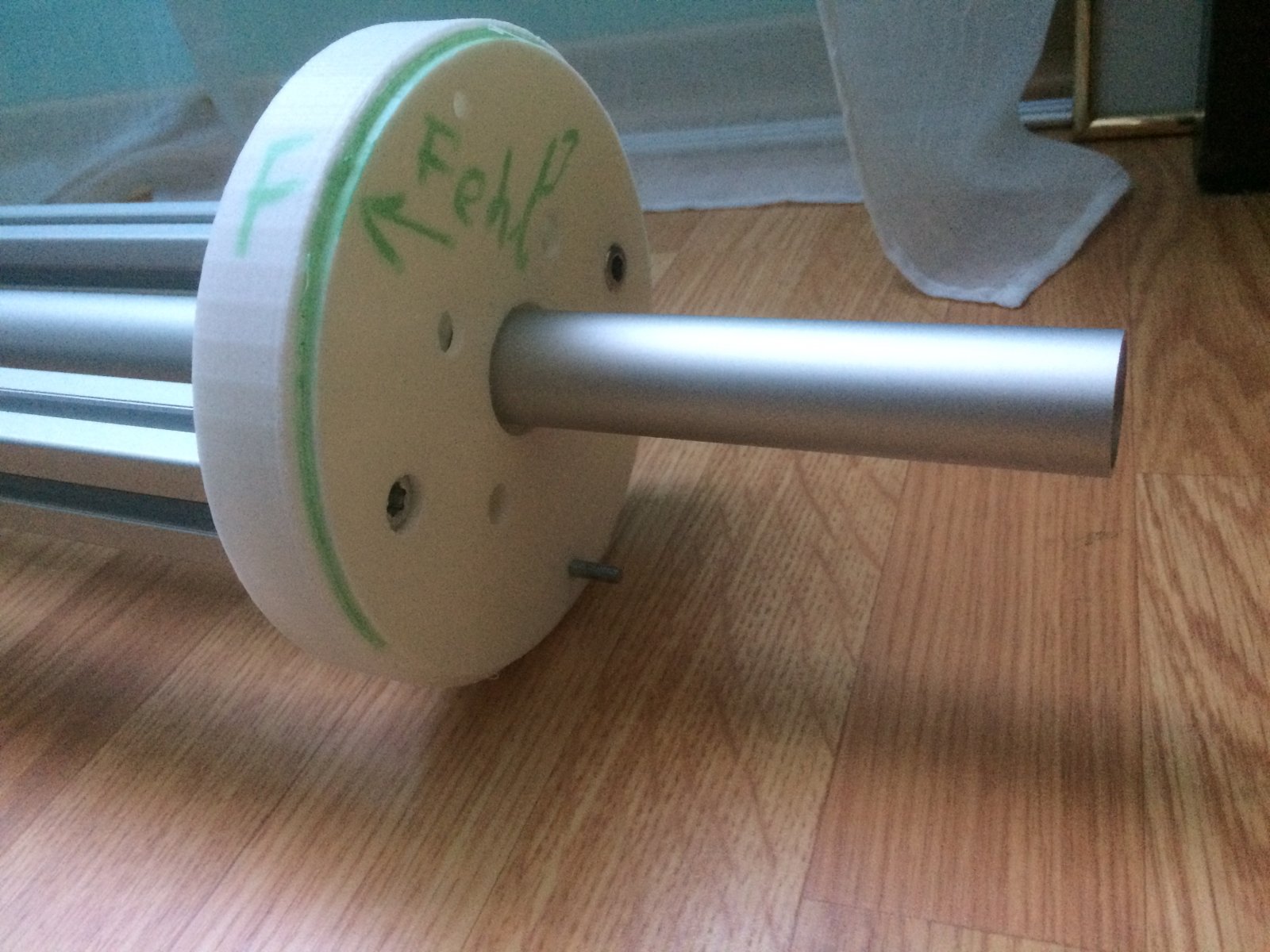

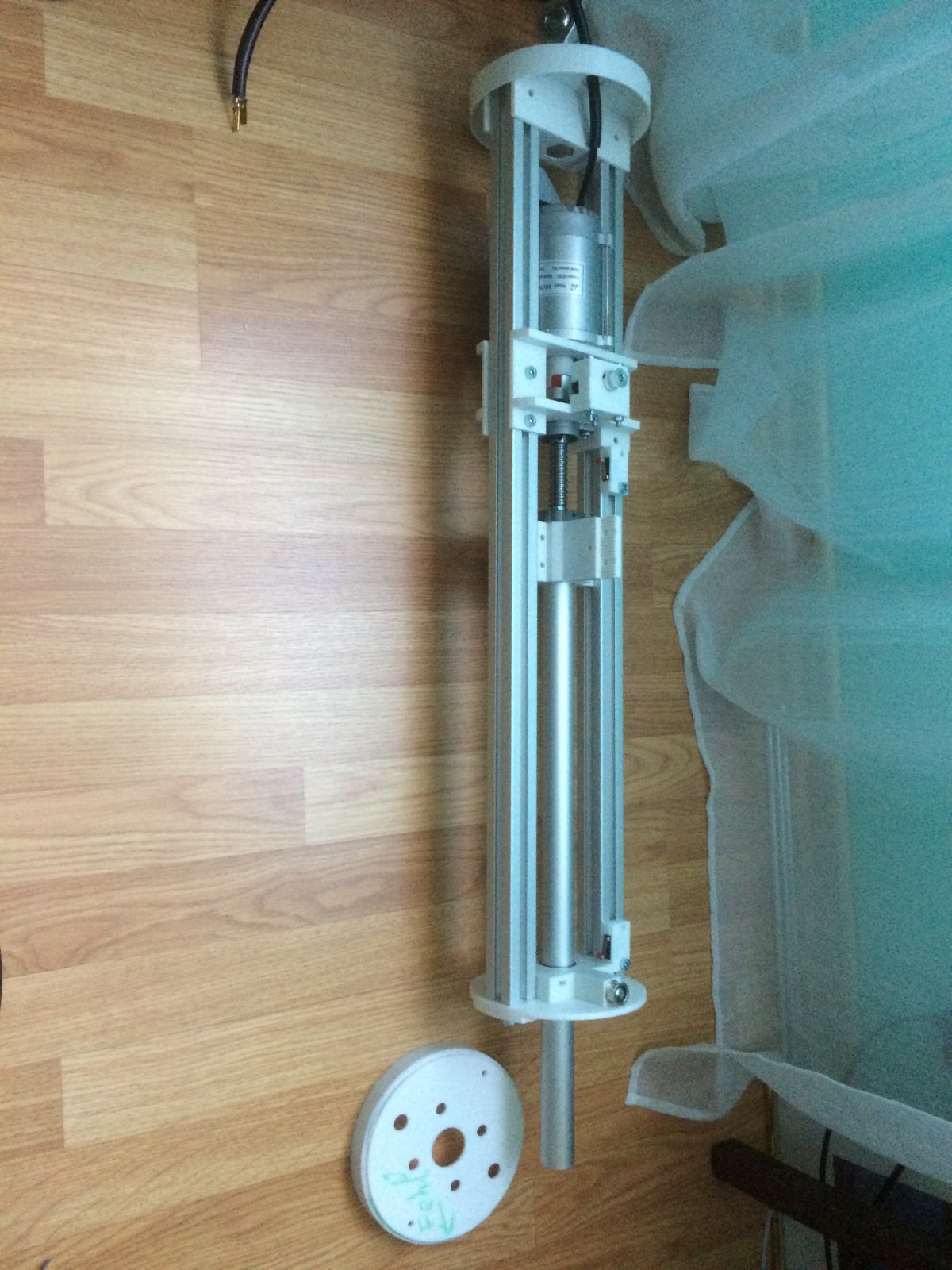

    Hello everyone, I have almost finished work on the first actuator. there are only little things left.

    Hi. Nice work in that actuator. May I ask how you build the parts. 3D Printing? Do you follow a former build from the Forum, or did you redesign any parts. What Controller so you plan to use. I follow this forum for some years, but still collecting information. Looking forward to follow your build.

    Hello Zwodog, all parts were created with 3D printer.
    Many parts i have taken over in forum and adjusted for me and rebuild.
    I plan to use a Sabertooth dual 60A motor driver with Arduino.

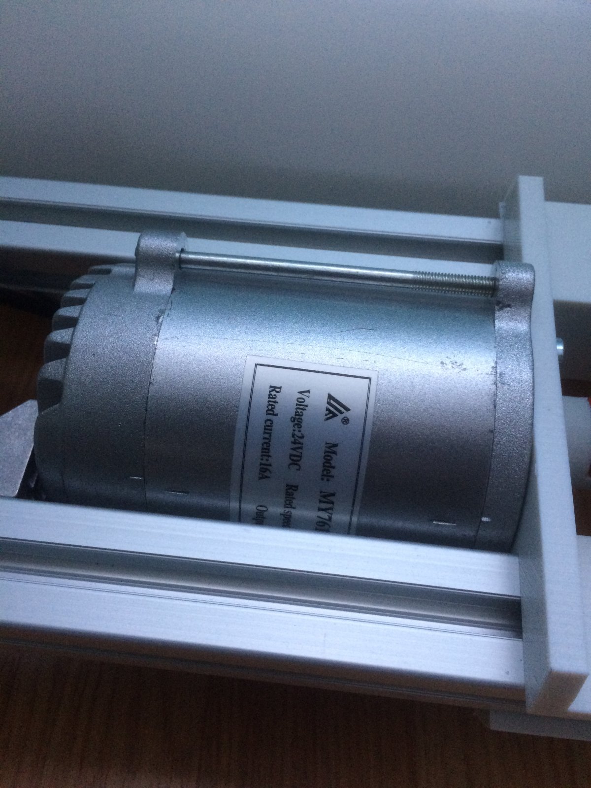

    I have selected MY7618 24V 300W Rated current 16 A 28000RPM motor. I bought a power supply 24V-40A on eBay. Now you need one
