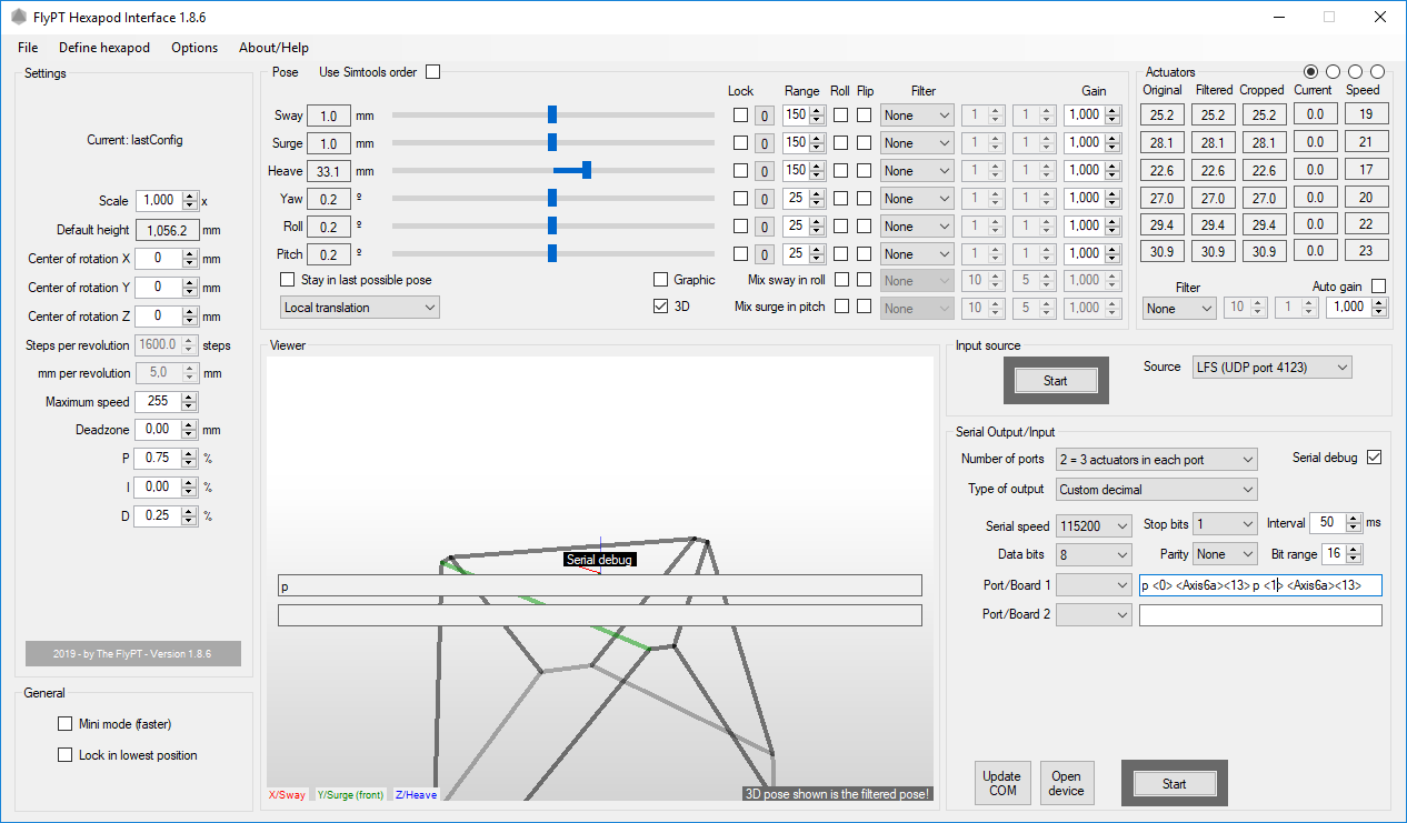

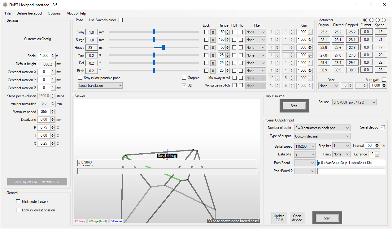

    Hello, I've reprogrammed my controllers to work with the negtive values (I saw them in the serial debug function) but I have another problem. When sending positions to my controllers with the command: p 0 <Axis1a><13> it works but there are two motors per controller so I need to send p 0 <Axis1a><13> p 1 <Axis6a><13> but this only seems to output to one of the actuators. How can I solve this? I've tried sending positions with 2 seperate outputs in the FlyPT interface but this doesn't seem to work because you can only connect with one command for each COM port.
    Thanks in advance

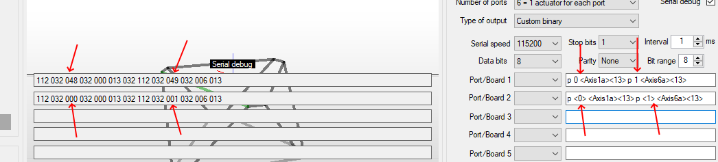

    Is it expecting value 0 and 1 or the char value of "0" and "1"?
    If it's 0 and 1, try: p <0> <Axis1a><13> p <1> <Axis6a><13>
    Because with that string you are sending the char value (look at the serial debug)

    p stands for position, the 0 and 1 are for motor 0 or motor 1.
    My output is 'custom decimal', it doesn't seem to work, the ascii caracter 13 is 'end line' so it prints on the next line in the debug, I can't see it very well but I think it only sends oen 'p'.
    What can I do about this?
    Cheers

    Hi
    I found the problem, the space between the commands was not expected.

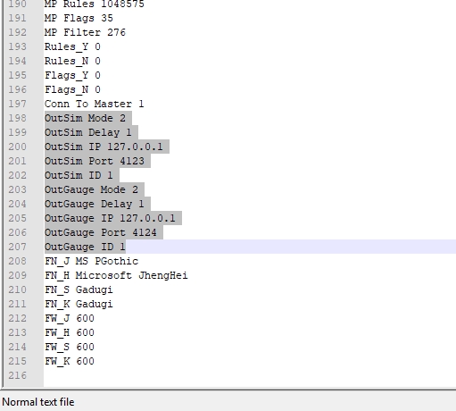

    Are you in cockpit view? LFS outputs data, only in when we are in cockpit view.
    With Simtools or direct from the interface?
  12. pmvcda
    pmvcda aka FlyPT
    Nov 3, 2010
    2,272
    Portugal
    15,902Coins
    +2,716 / 18 / -0
    Here's a screenshot of my cfg.txt:
    Your file should also have around 215 lines and the darked area is what you should change.
    If the file is small, it's because you didn't complete a race yet. So go to the track and make a race of 1 or 2 laps to generate a complete cfg.txt

    It doesn't work, I've already deleted the file and let the game create a new one and it keeps saying: "trying to connect with LFS, but it's not sending data!"
    Anything else I can try?

    Can I check if you ran a race in LFS in first person mode before patching it for motion, as that generates some required files.
    If not try un-patching, run a race and then re-patch.

    Also, try to disable the firewall and test to see if it works.
    You might have to allow the application on the firewall.

    Do you have another program using port 4123?
    Try running everything as Administrator.

    The administrator trick worked! Now, is it possible that the programme slowly moves back to the Original position because now, it kinda stays in the same postition.
    Cheers
