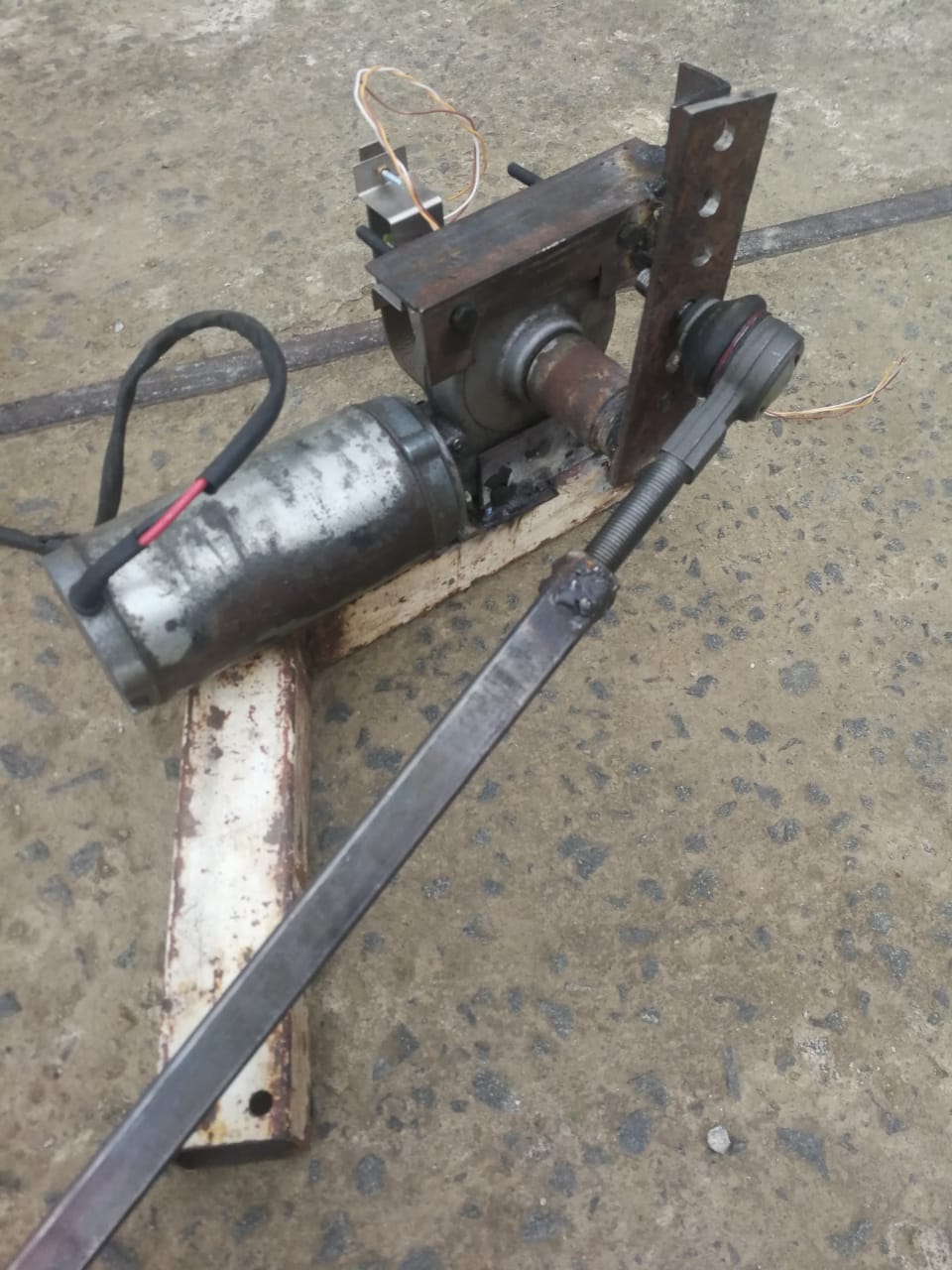

    Hello everybody!I have already started my build and read many posts from this awesome site.
    I was also on a tight budget,so where did I look for my parts?Our local junkyard!The costs for my build,motors ,metal,gas strut,seat and the electronics is about just under 200 dollars.It will be a 4dof rig.
    I have 4 motors, specs are:
    • 1 pair are 24v 200w from a wheel chair cost about 5 dollars.
    • 1 pair are 24v 400w from an old floor polisher 9 dollars.
    • Gas strut found laying round for heave.
    • A old office chair.
    • Scrap metal for frame
    • Electronics bought from china.
    • For power supply two 12v 85ah batteries from junk yard.
    I have been building my rig as I found part by part.
    Here are some pics as I went along.

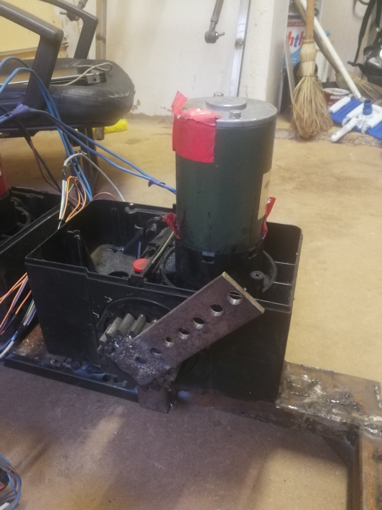

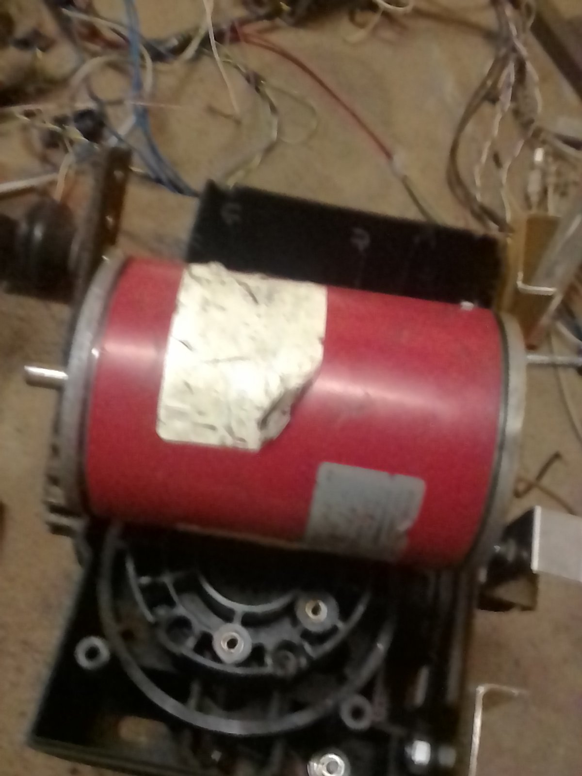

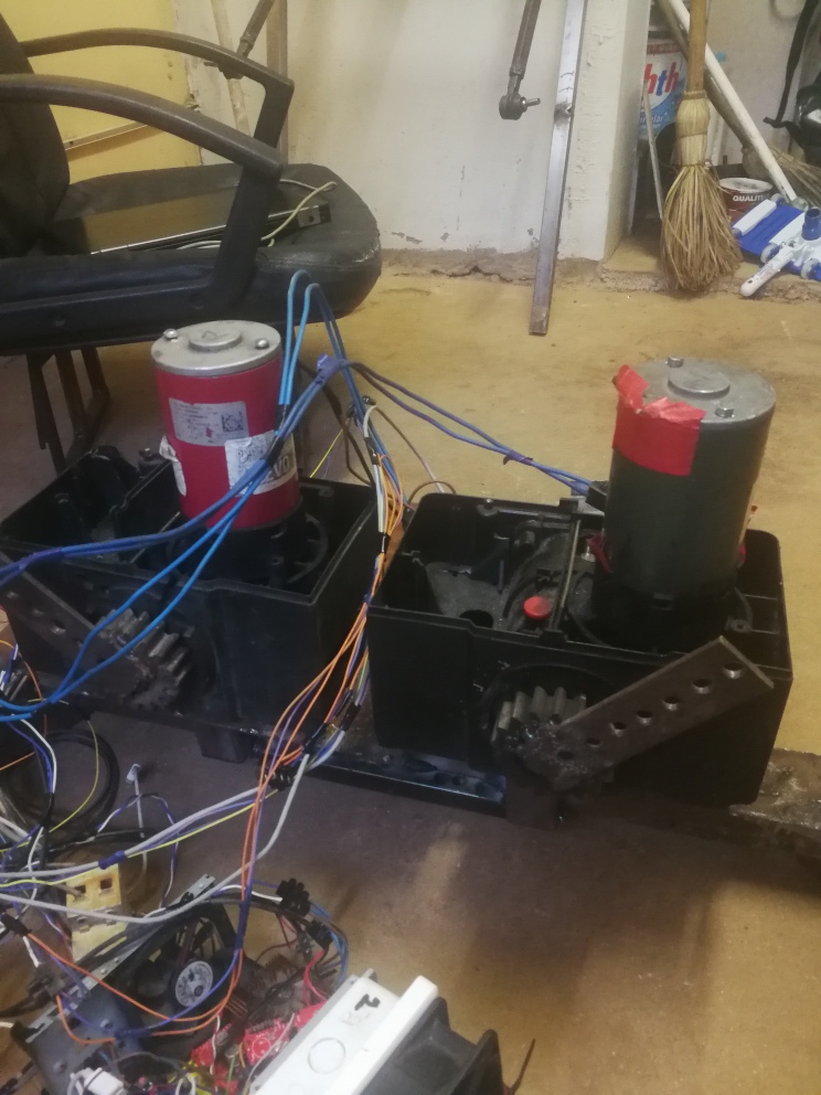

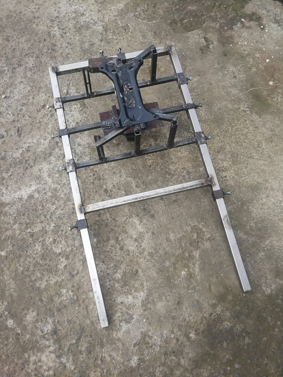

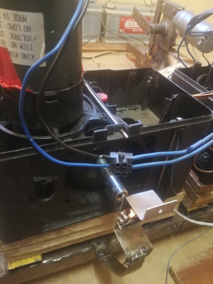

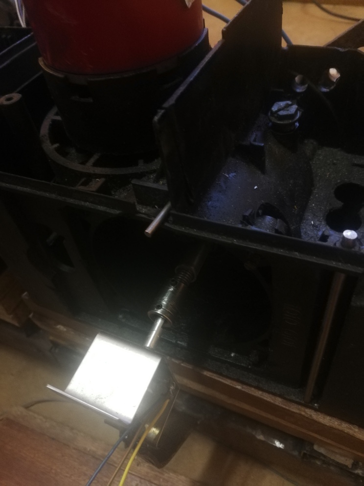

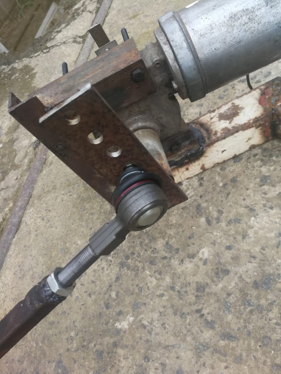

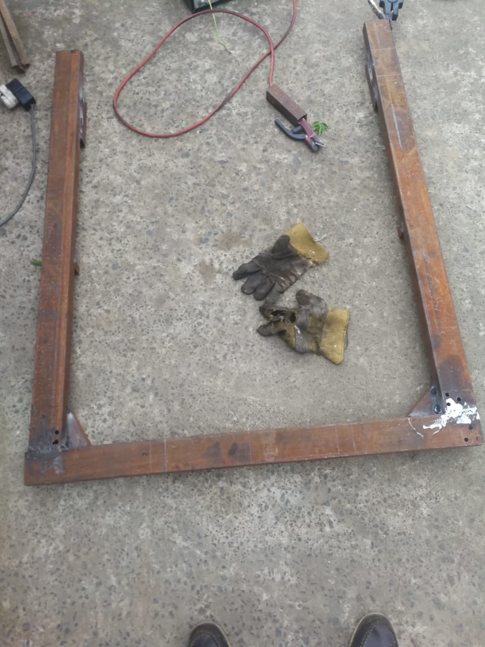

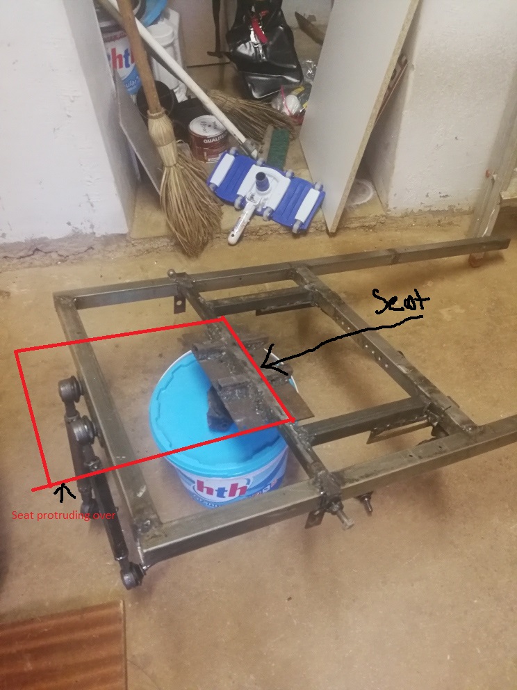

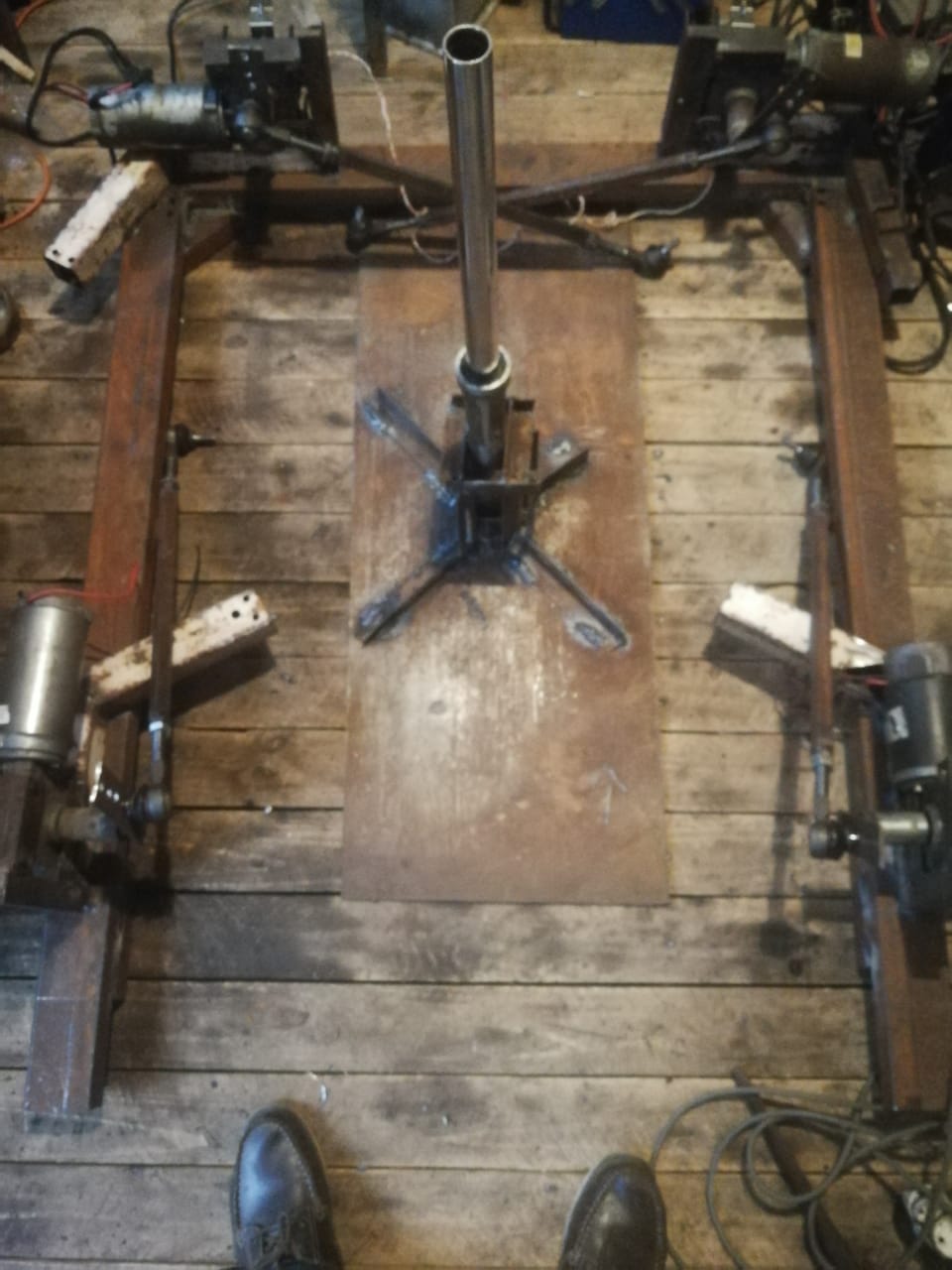

    Guys just a small update,been busy with other projects around the house thats taken up my time.Firstly changed my rear motors to gate motors with their gear boxes to see if it will handle my weight better than the wheel chair motors,also they are plenty and cheap,about 3 dollars each at the scrapyard.Then I have decided to modify my frame as I felt it was to high.So I cut my rod arms down,also read a thread on calculating where to place my motors from the pivot point inorder to get a higher angle degree.So i decreased the width and length of my frame.Also worked out the centre of gravity using racemat suggestions.But now i have created a dilema whereby the front legs of my seat is the gravity center but if i place the front legs of my seat on the pivot the seat will now hang way over my rear motors..Will this not put too much strain on the rear motors?Will post pics of this dilema and the new setup.
  9. Llewelyn
    Llewelyn Member
    Nov 10, 2017
    69
    IT consultant
    south africa
    108Coins
    +18 / 0 / -0

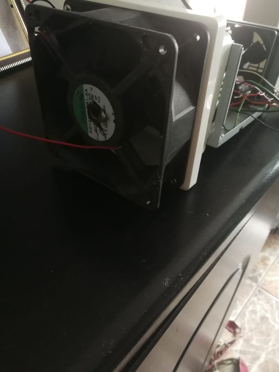

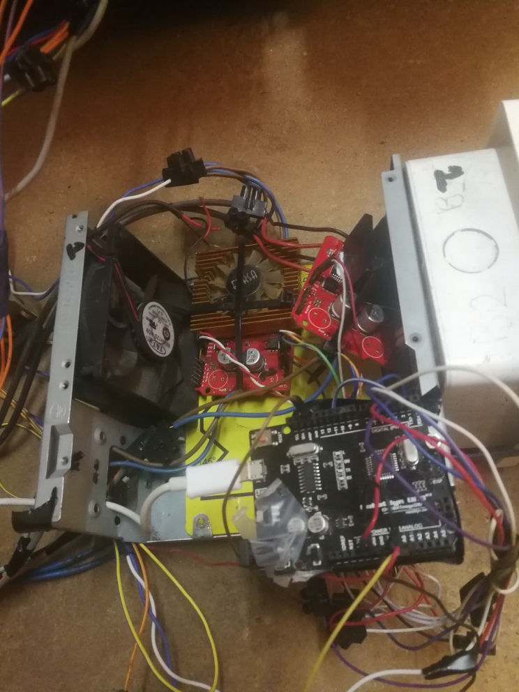

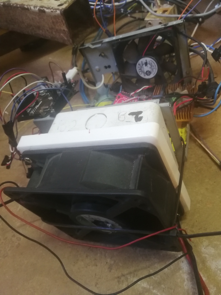

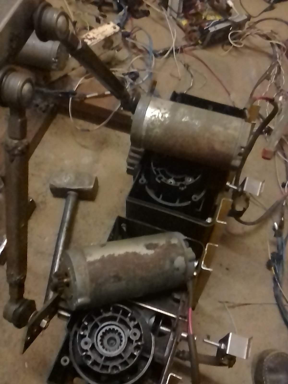

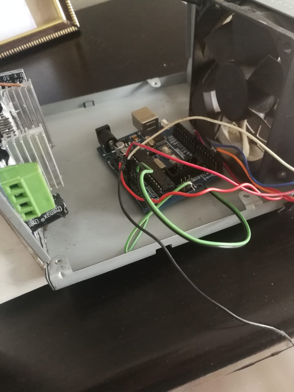

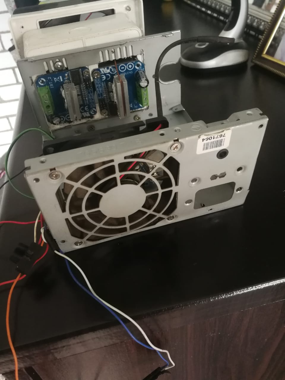

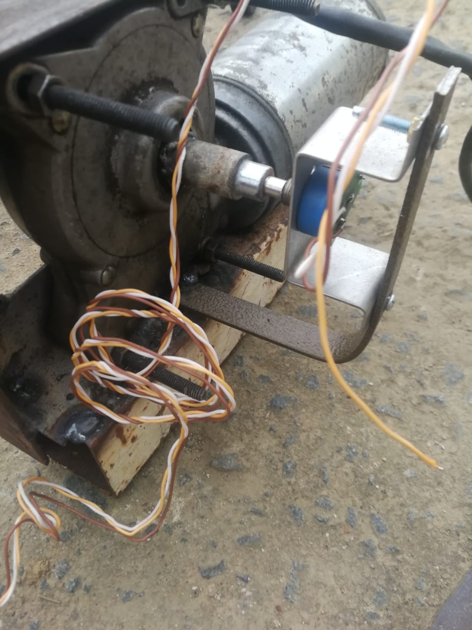

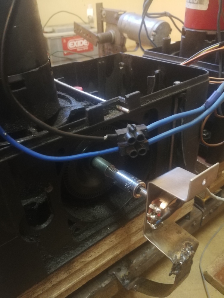

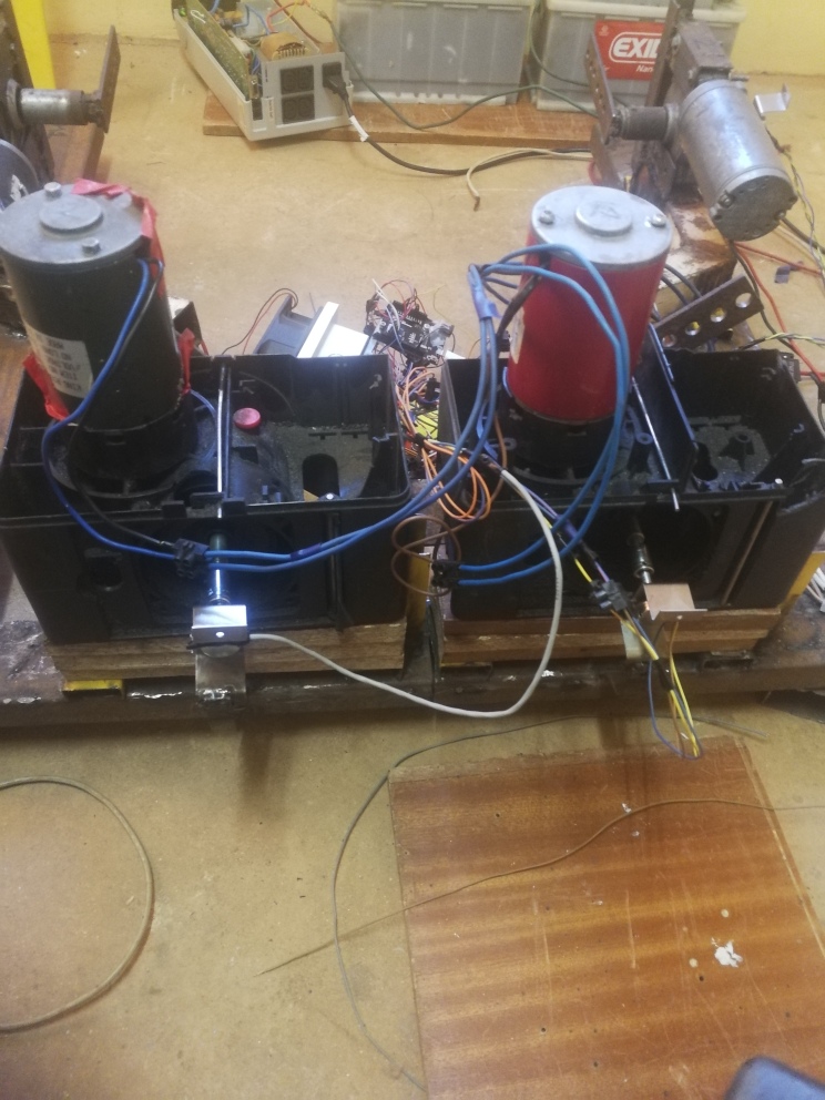

    Okay I have some pics of what has been done so far.These are my 12v 180 watt gate motors I am testing to see if they will be up to the job,as you can see from the pics how I connected my pots also,using a wrench socket that I had drilled and tapped for a hex screw.Don't know what is the gear ratio on these,but has good holding power and has good speed.Also have connected my motor drivers,using two Monster Motor Shields and two bts7960's.Have moddified a atx power supply to fit them in and is cooled by the default fans on the cases and have also added a larger fan to each case.Excuse the spaghetti wiring.

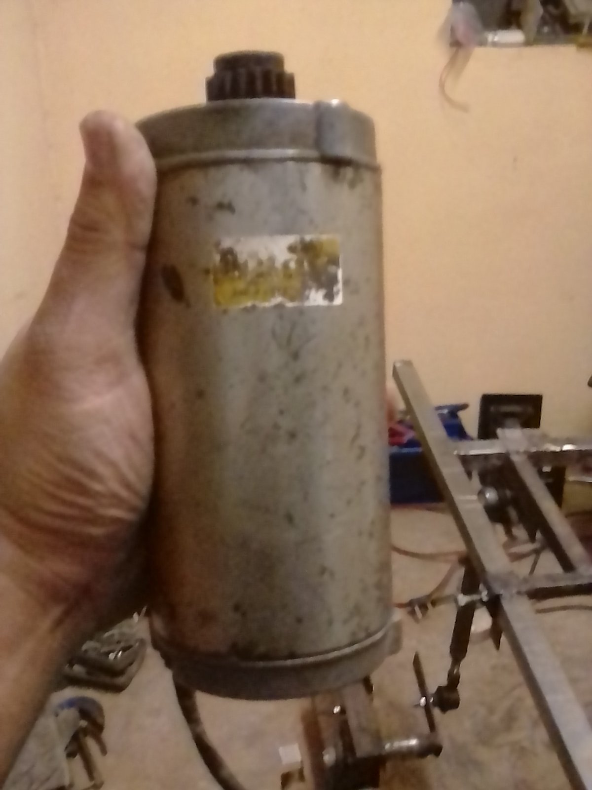

    Yep they weren't in the best of condition,had to redo brushes and refurbish them,always on the lookout for motors to rebuild,for instance I already found 6 3phase 1hp motors for my 6dof future sim all for 86 dollars paid for them by weight 1,43 dollars per kg :)

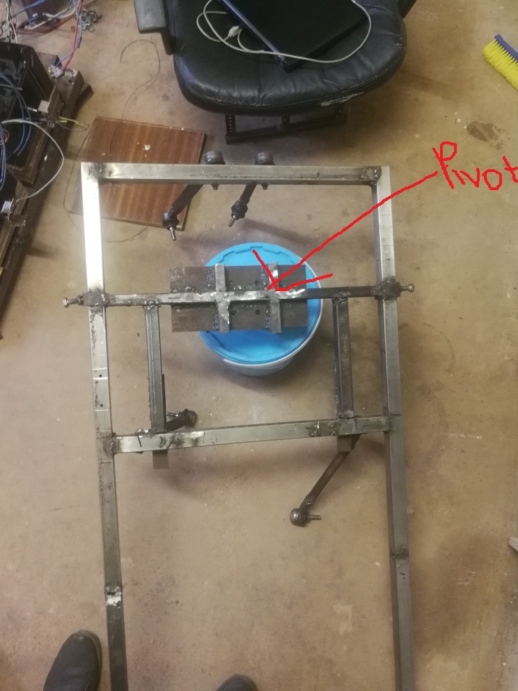

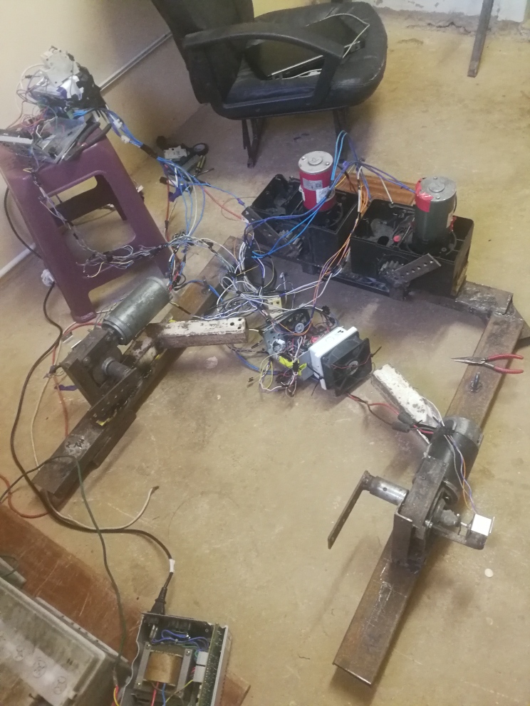

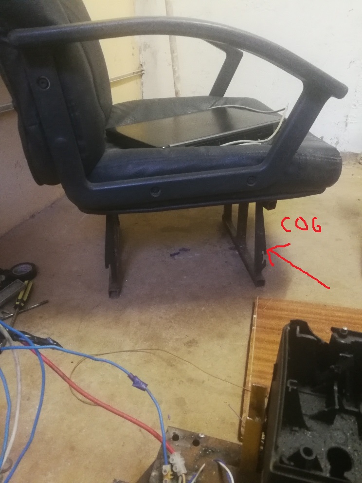

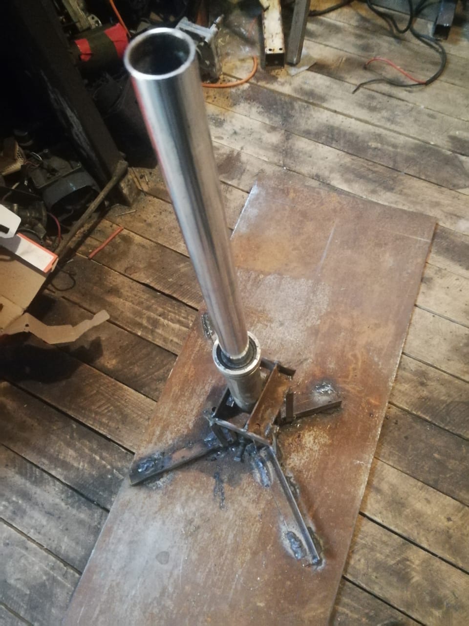

    Okay here are pictures for someone to perhaps have a look for any ideas to assist me....
    This seat has the centre of gravity by the red arrow.
    The pivot point where im going to place the front legs of the seat.
    The red square is how the seat will sit on the frame,as you can see it will be protruding over....will this cause the frame to be unbalanced or have too much starin on the back motors?Any help please...

    Oh and here are more pics of the front of my gate motors if anyone wants a look.

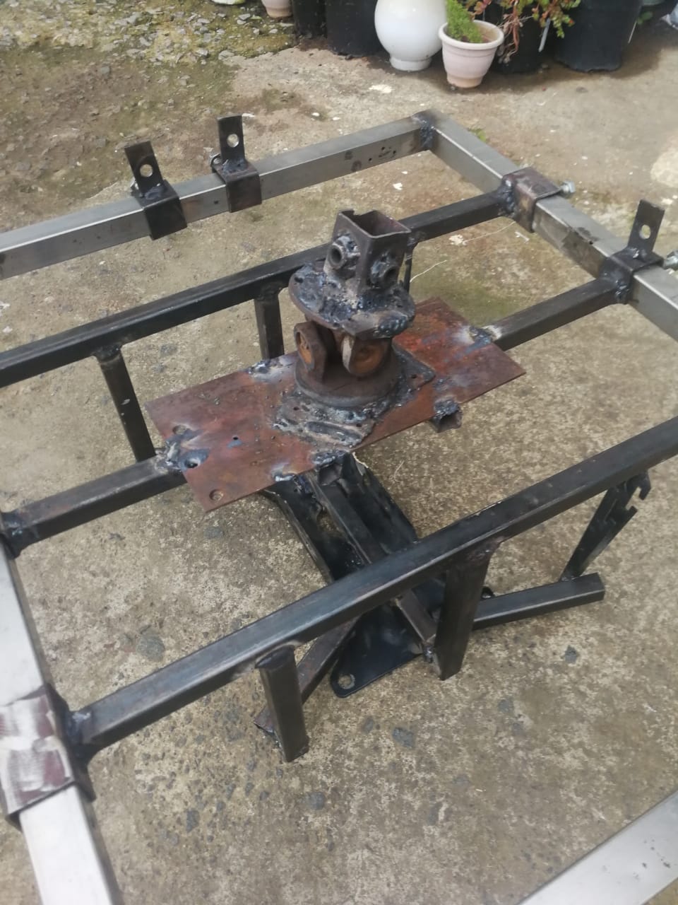

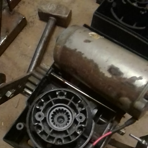

    Okay the journey continues..
