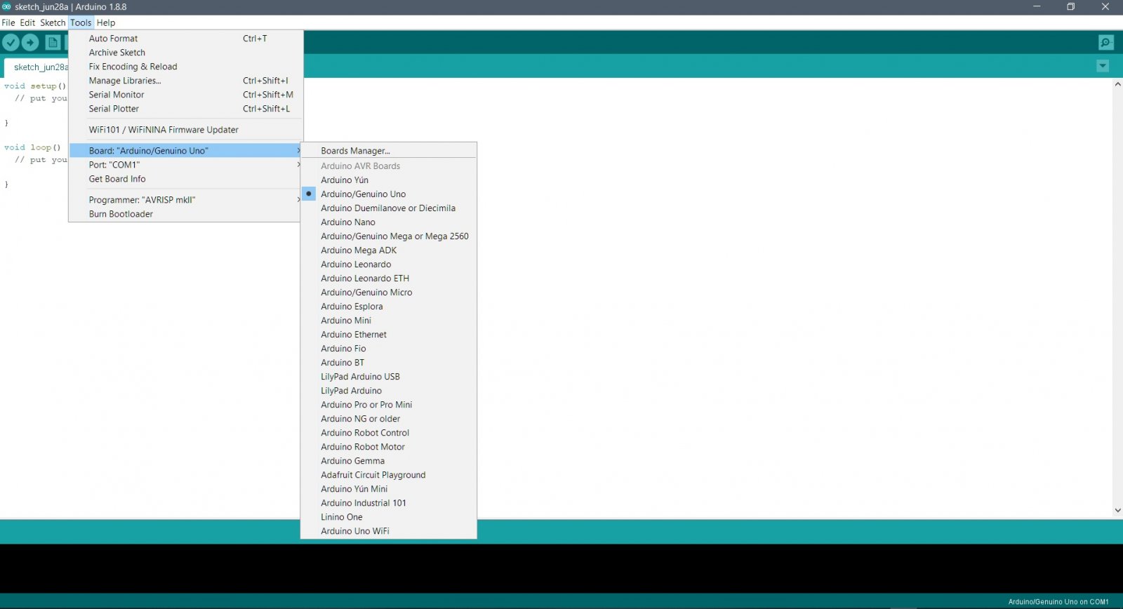

    Depending on what control boards you choose likely SMC3 or one of its variants is the easiest path as it has an app for configuration: https://www.xsimulator.net/community/faq/arduino-code-for-use-with-various-hardware-and-simtools.31/
    You will need the Arduino IDE: https://www.arduino.cc/download_handler.php?f=/arduino-1.8.13-windows.exe
    And set it up for the Uno:

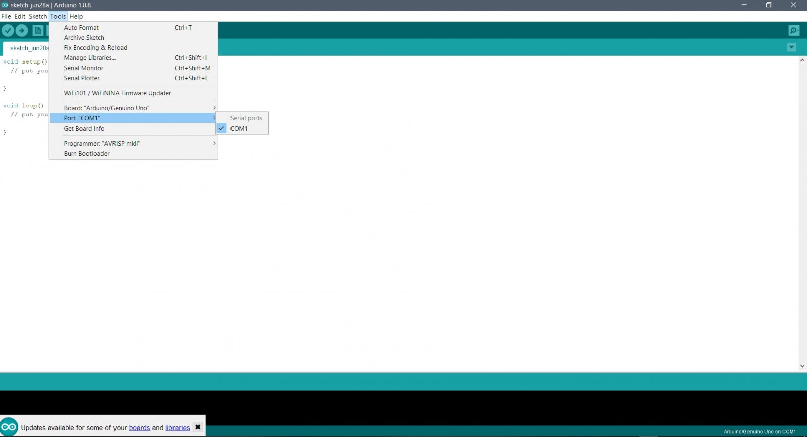

    Then set the Com Port:
