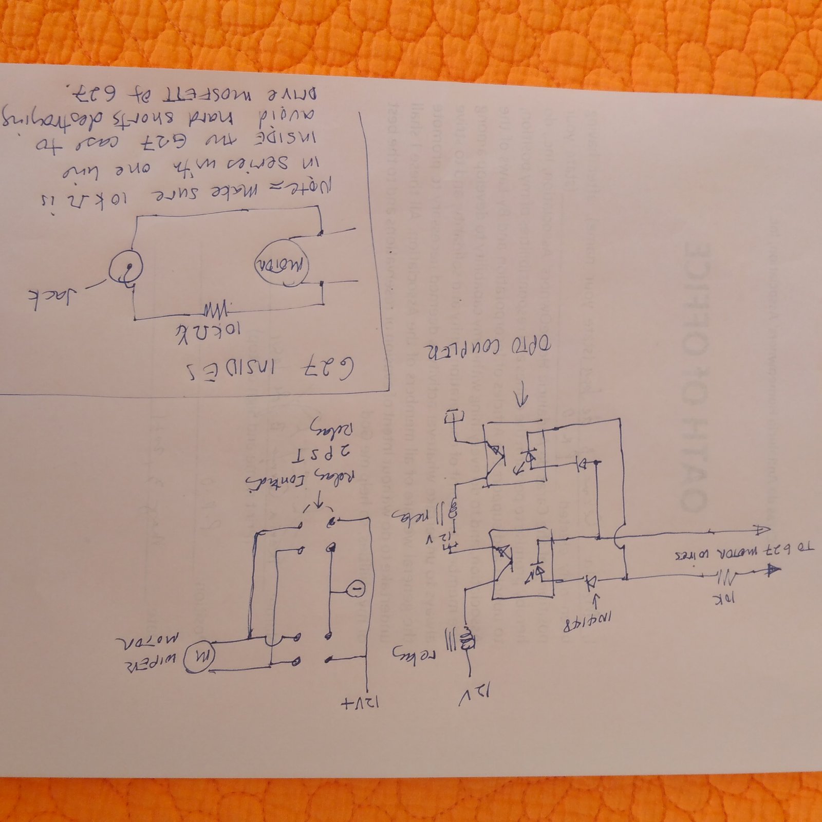

    will post pictures and circuit diagram. am just busy at the moment.

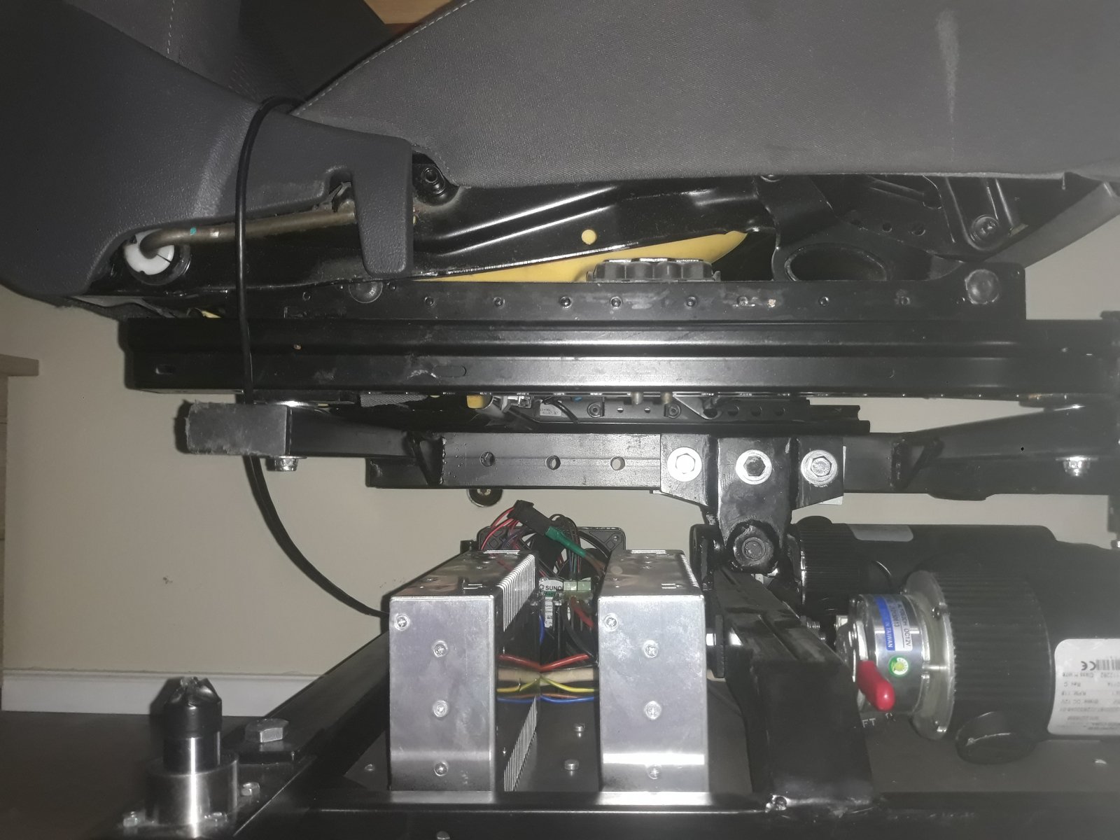

    have you teardown the gearbox yet..??
    i want to know the rasio of that gearbox...
  3. Ivan Ilic
    Ivan Ilic New Member
    Mar 11, 2021
    21
    - 252Coins
    Motor gearbox ratio is 1:26, output shaft is 118rpm.
    At the beginning of the previous page you have a picture of the gearbox inside.

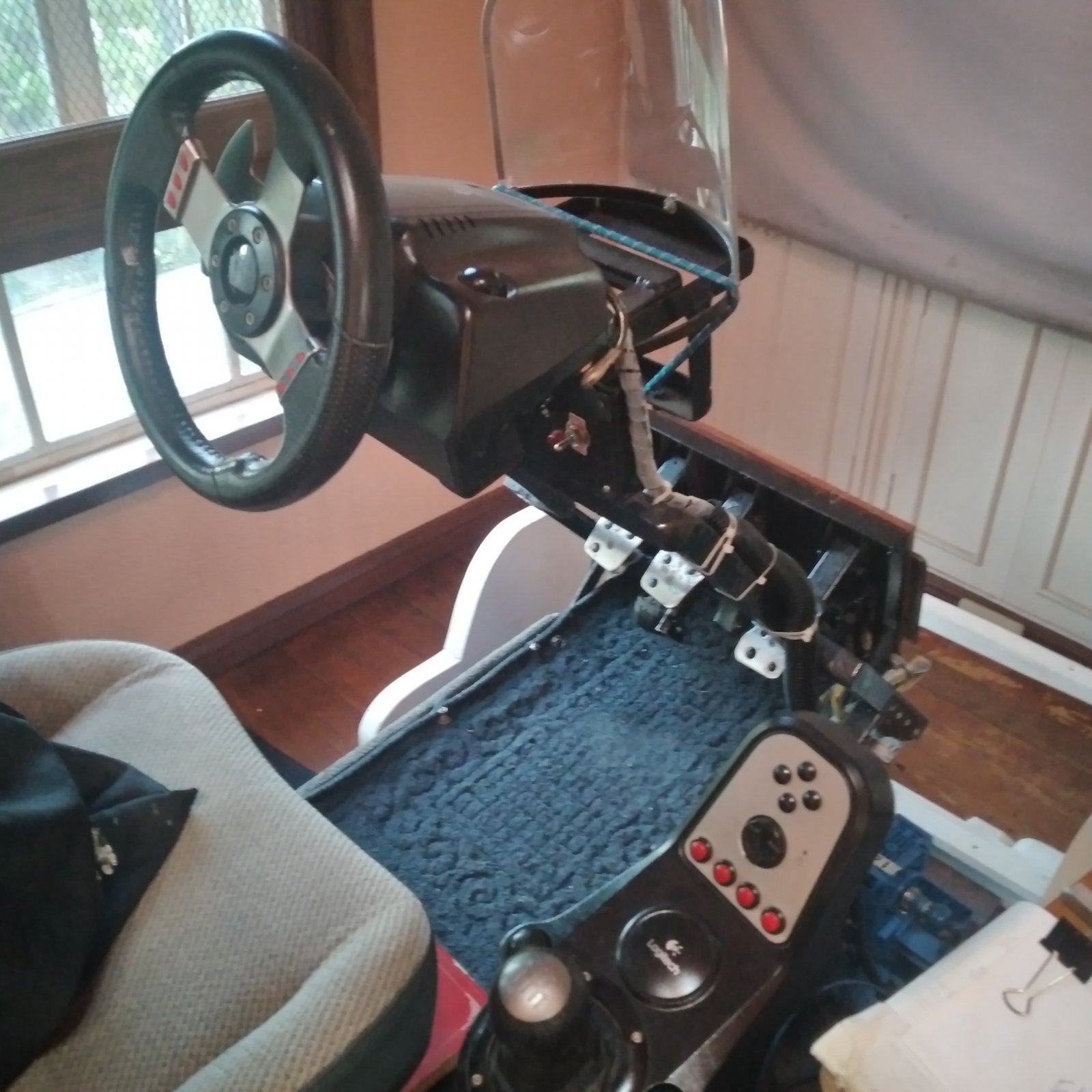

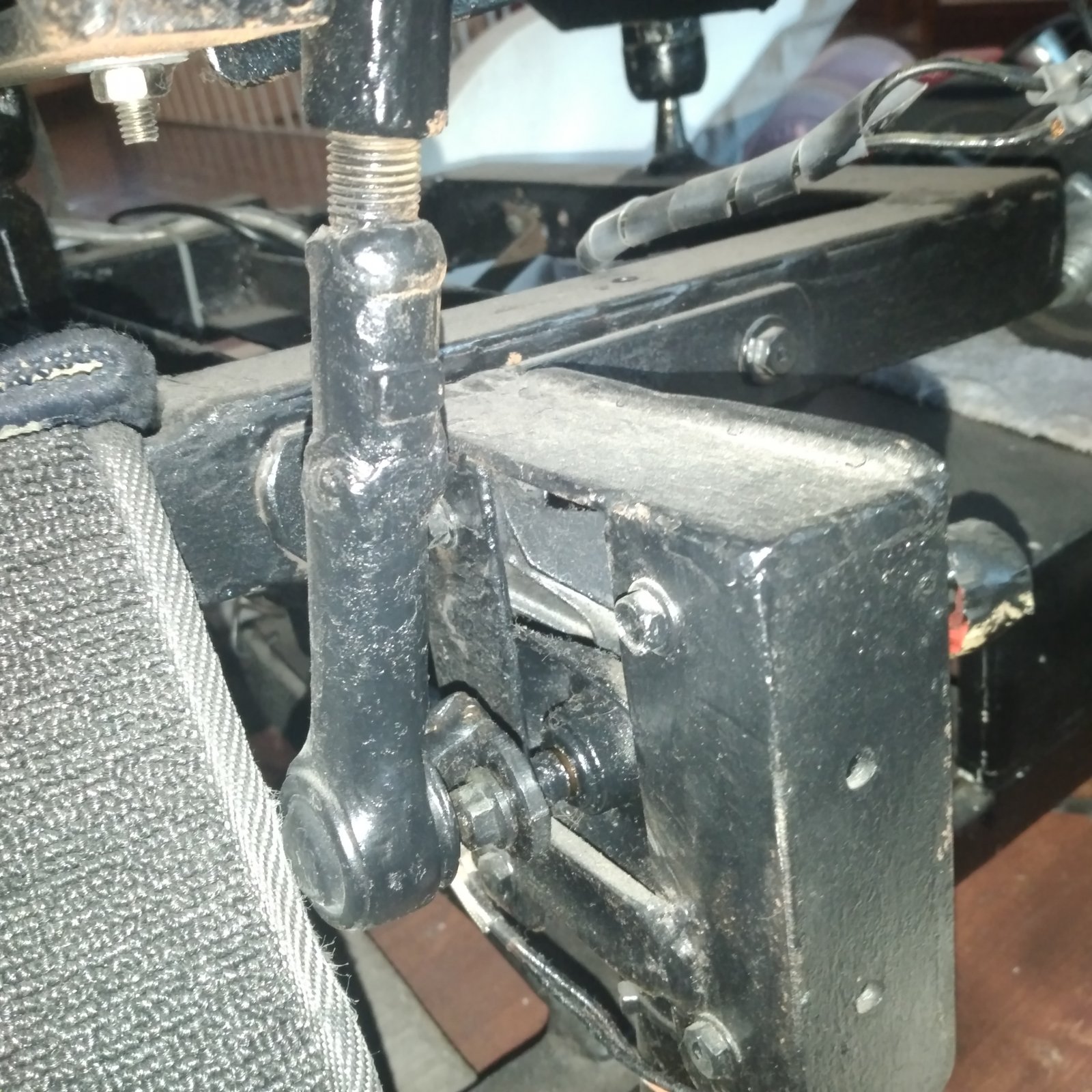

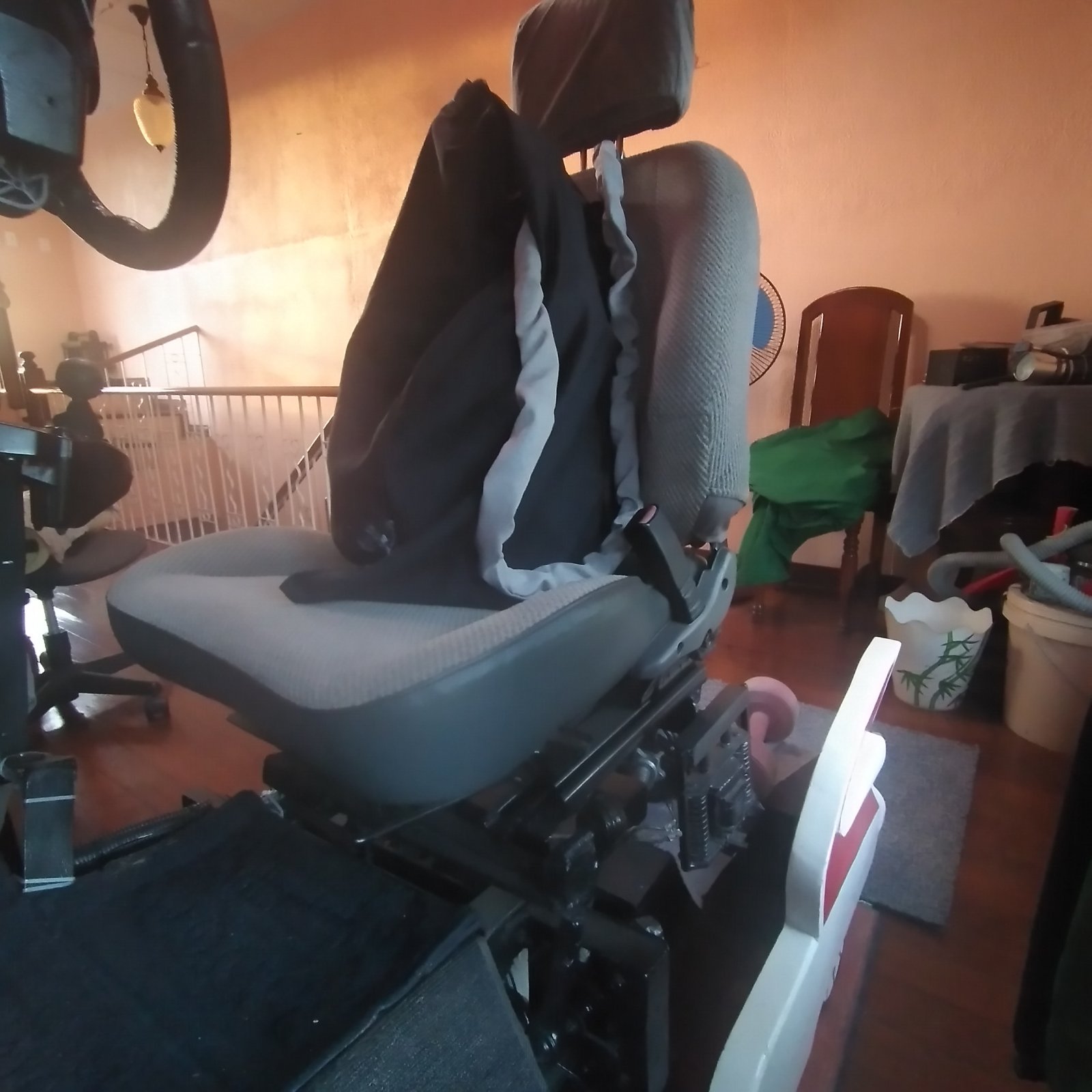

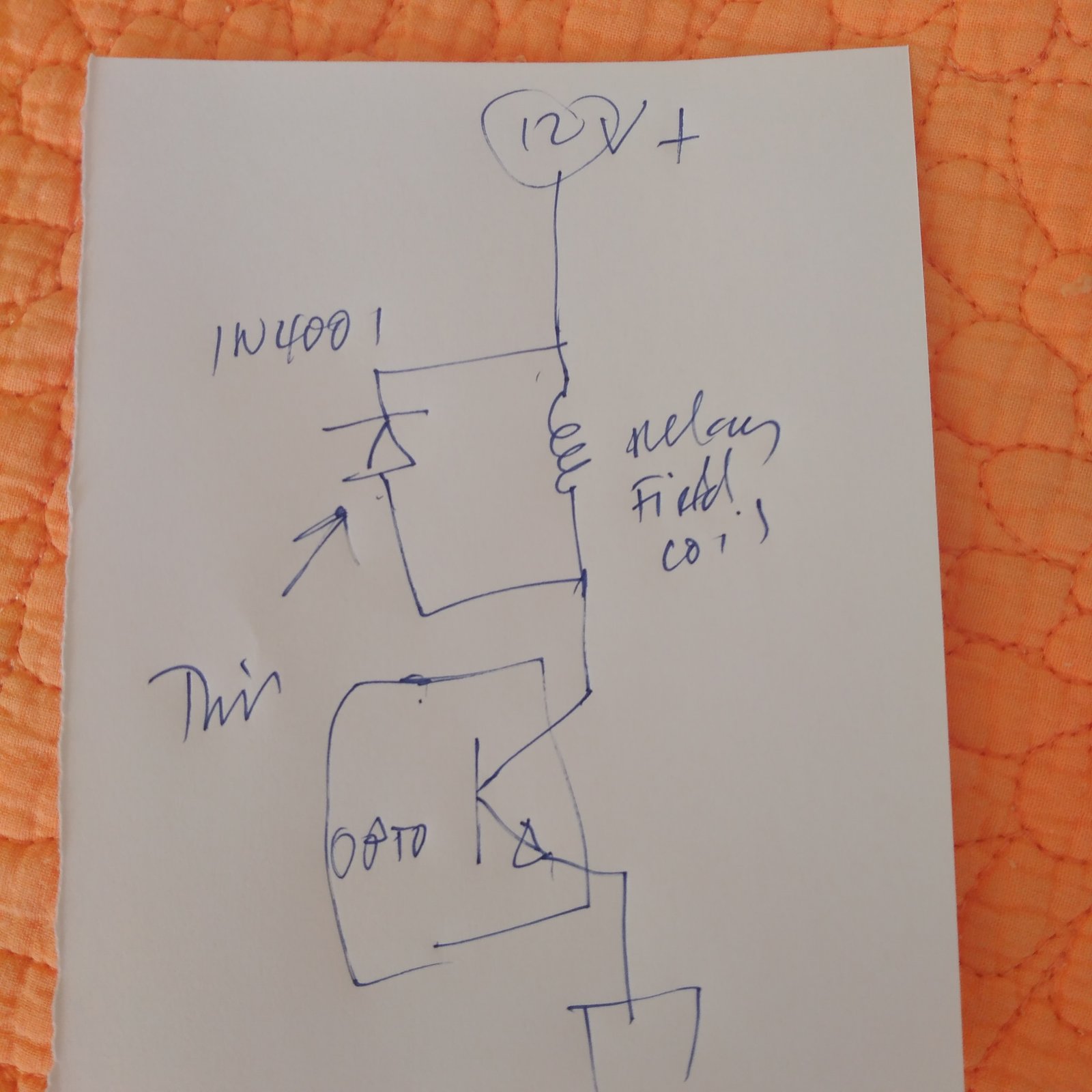

    As promised, will try to send some pictures except I don't know how to do it. Was absent when it was taught ! g27 to chair sway Circuit.jpg Seat Joints  2x front&back.jpg g27 to chair sway Circuit.jpg Seat Joints  2x front&back.jpg wiper drive.jpg

    Pls note to add a diode across the relay field coil circuit to protect the optocoupler from reverse current. Sorry I forgat to include those (1 per relay) pls see picture. The Opto should be able to drive a small 12 volt relay for this purpose. The relay is a double pole single throw (dpst) 12 volts type. Any relay capable of passing 3 to 5 amperes on its contacts should work.
  8. Ivan Ilic
    Mar 11, 2021
    21
    - 252Coins
    The wheel is directly connected to the output shaft.
    The wheel was 13 inches, but it says that the speed is 10km / h

    Thanks for posting

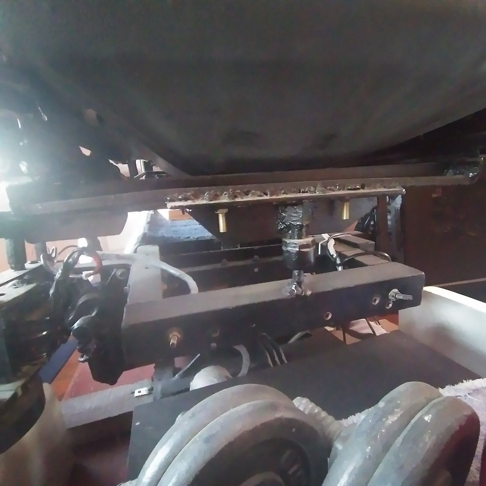

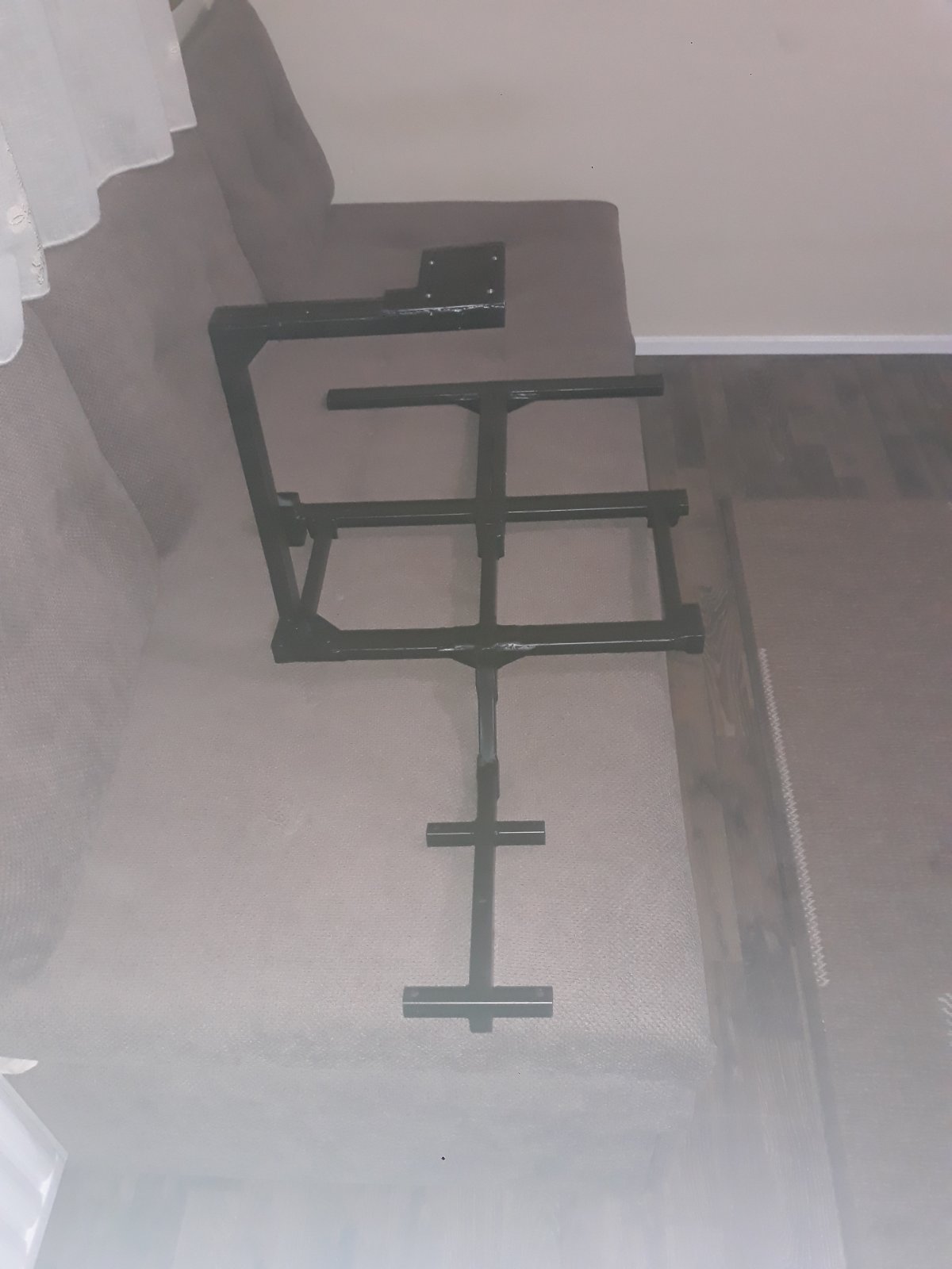

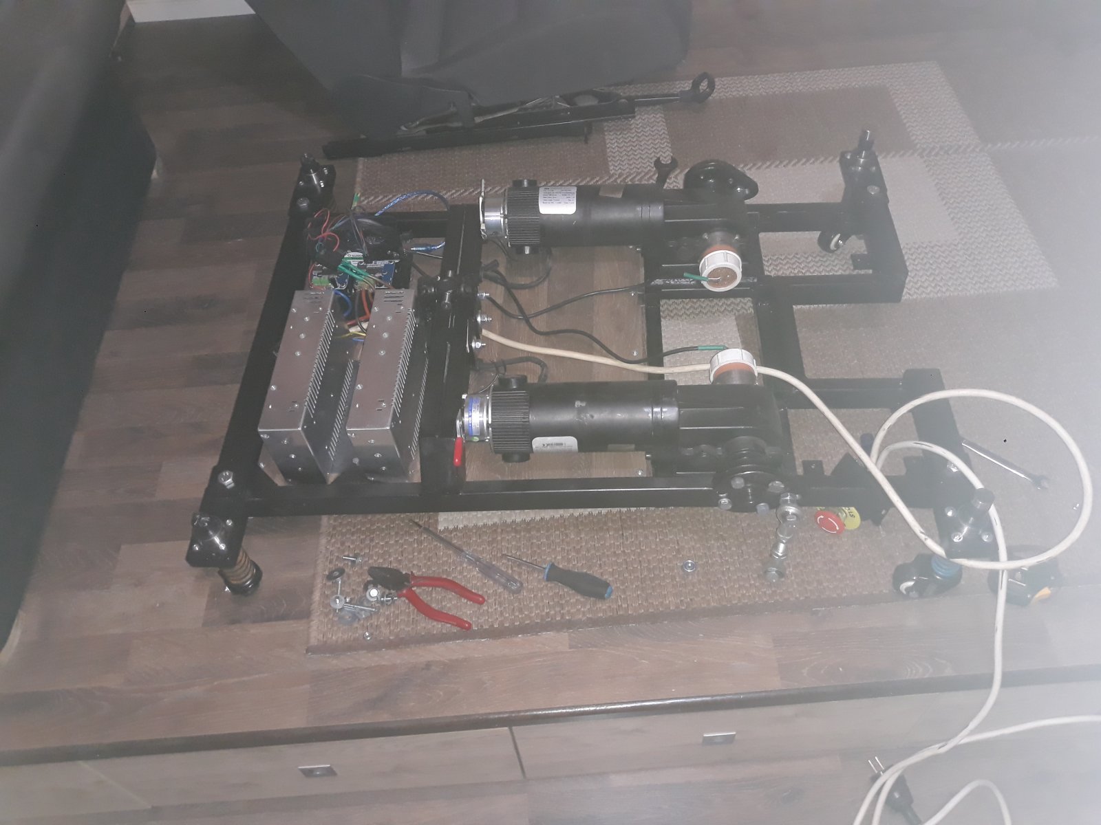

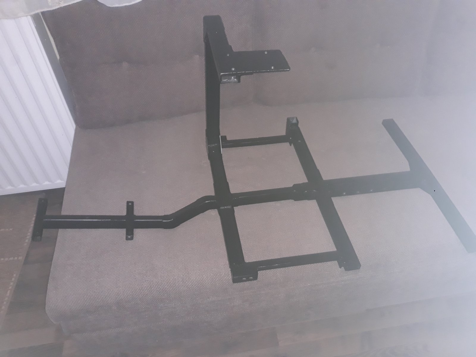

    Modification from seat mover to whole platform move. Basis:
  13. Ivan Ilic
    Mar 11, 2021
    21
    - 252Coins

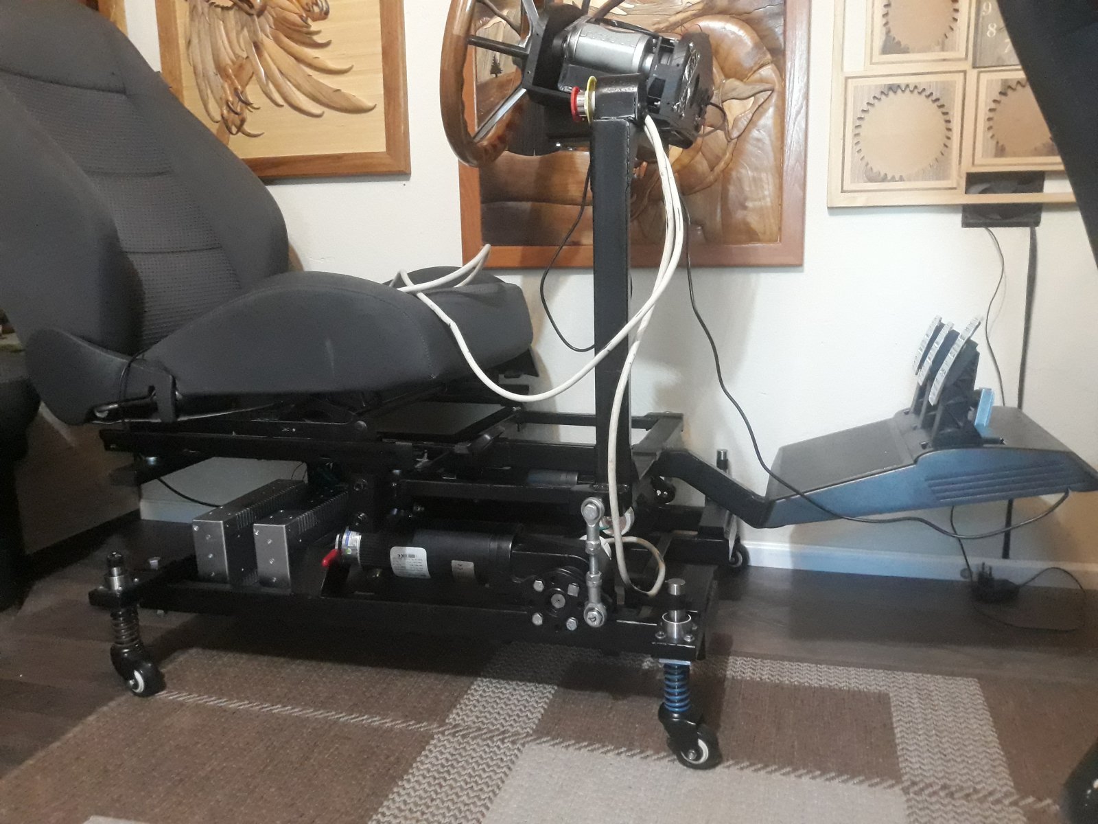

    platform:
  14. Ivan Ilic
    Mar 11, 2021
    21
    - 252Coins

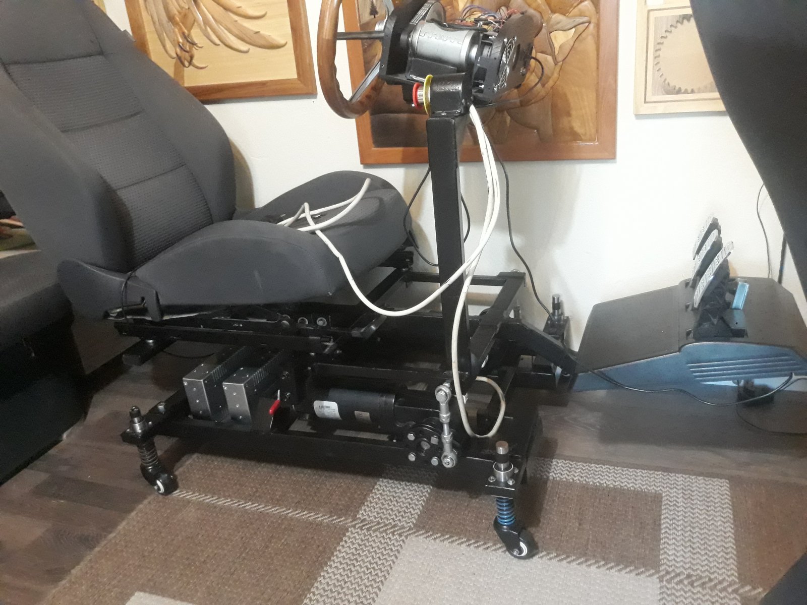

    Shifted center of gravity (picture 3)
  15. Ivan Ilic
    Mar 11, 2021
    21
    - 252Coins
    At about 30 seconds and at 2:25 during sudden braking an error occurred because the PWMrev in the SMC3 utility was set low (only 20). I haven't studied well what PWMrev is for :)
