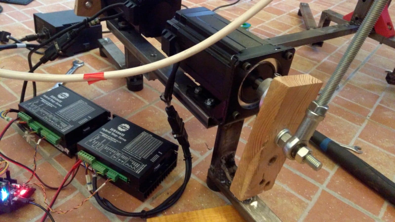

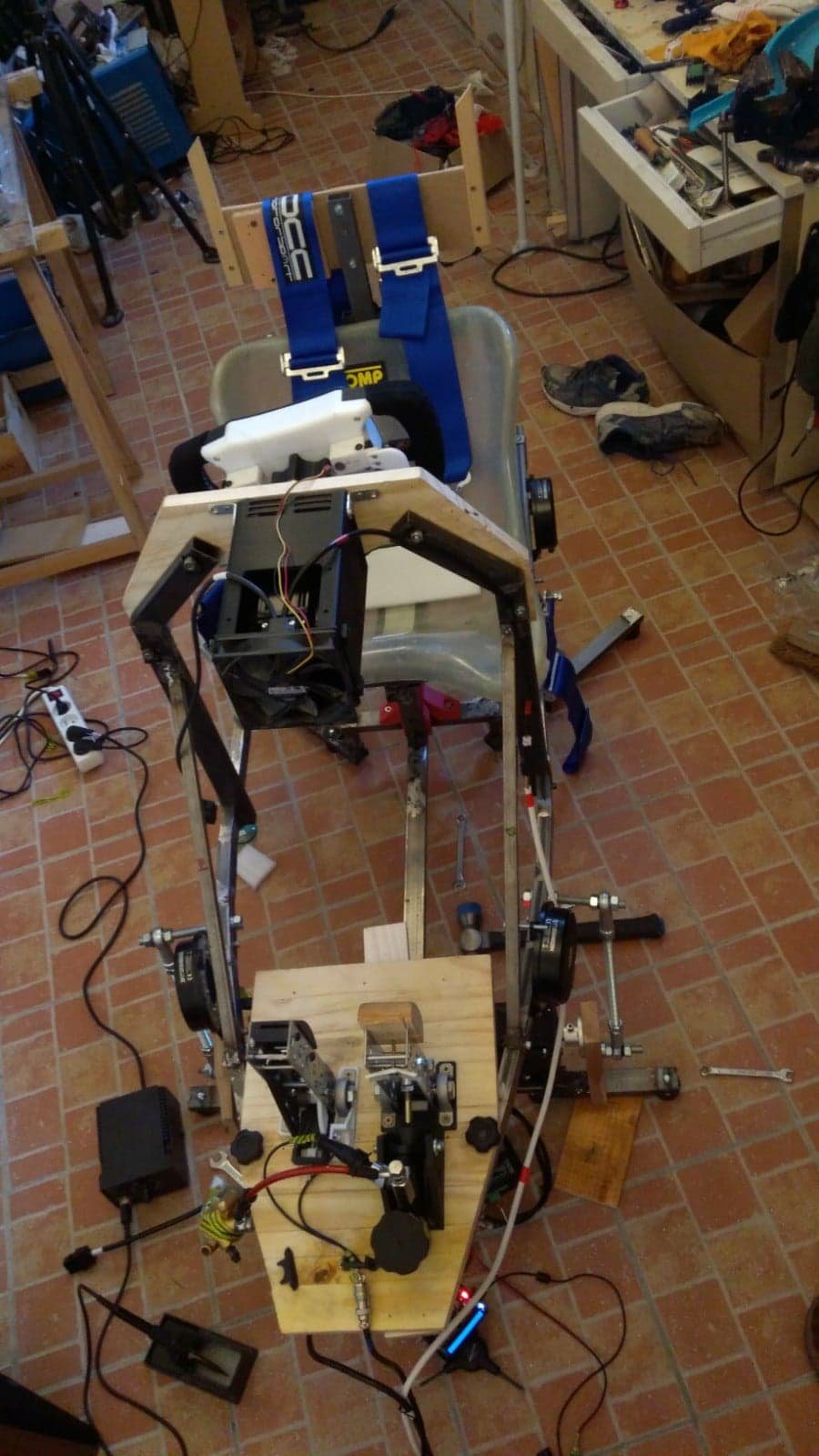

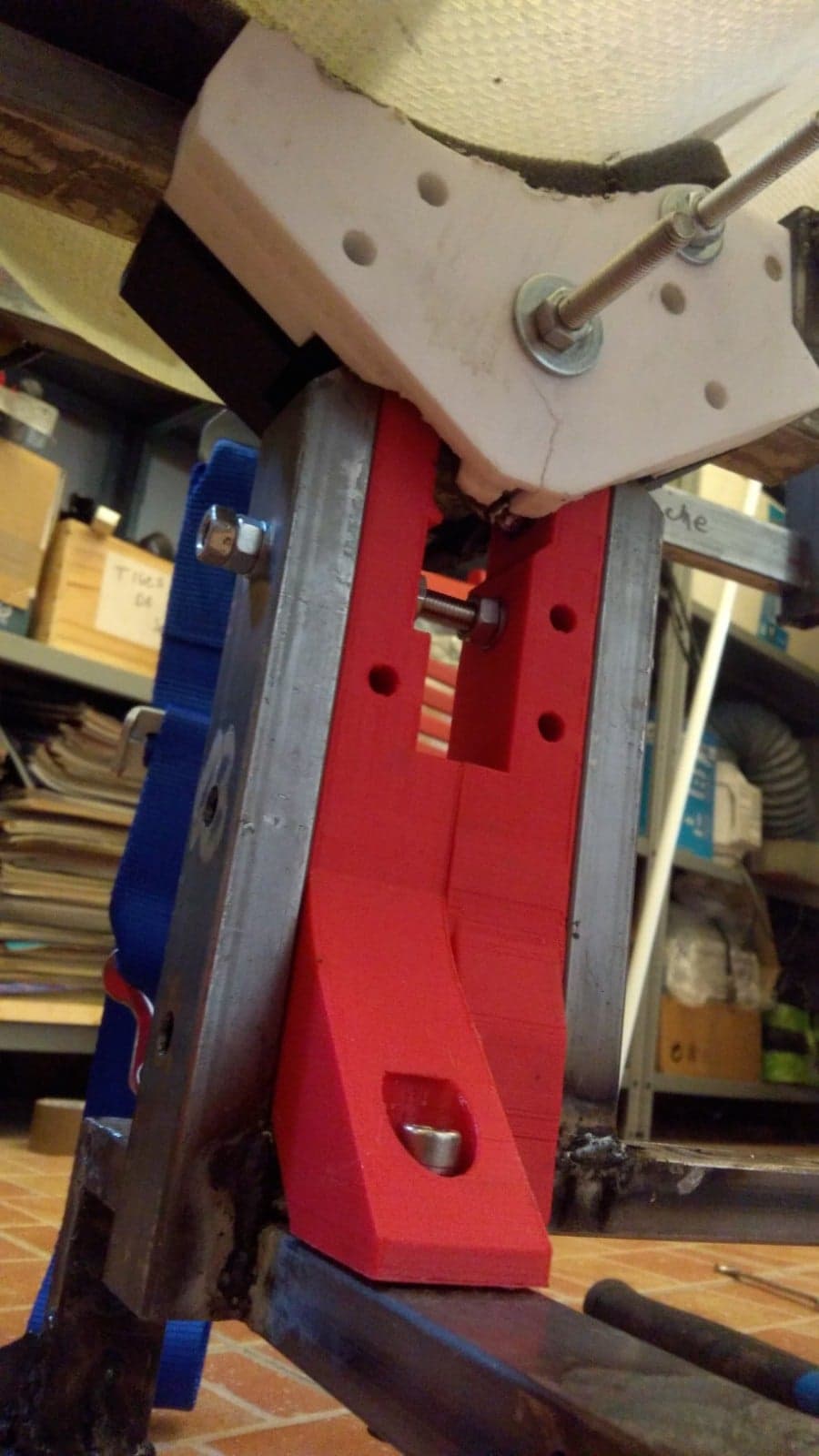

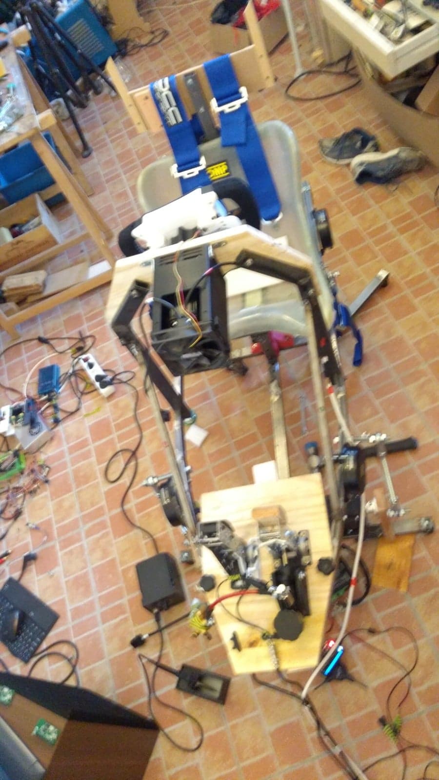

    Here is my 2DOF sim motion rig based on two stepper motors. The goal was to build a rig that would integrate all the features in one, while being fast to start. It will be used for a 24h race this summer. I also wanted something quite compact because I will be moving to a flat. On top of that, I wanted to build as many components by myself. I have been working on the rig for 3 months. Everything needs refinements but it starts to fall into place ! I can share every 3D files, but don't expect it to be perfect. Here is the guided tour :
    It's mainly based on a steel structure (20x35 rectangular profile) with two arms at the front. I needed to put them quite far from the pivot to have enough force.

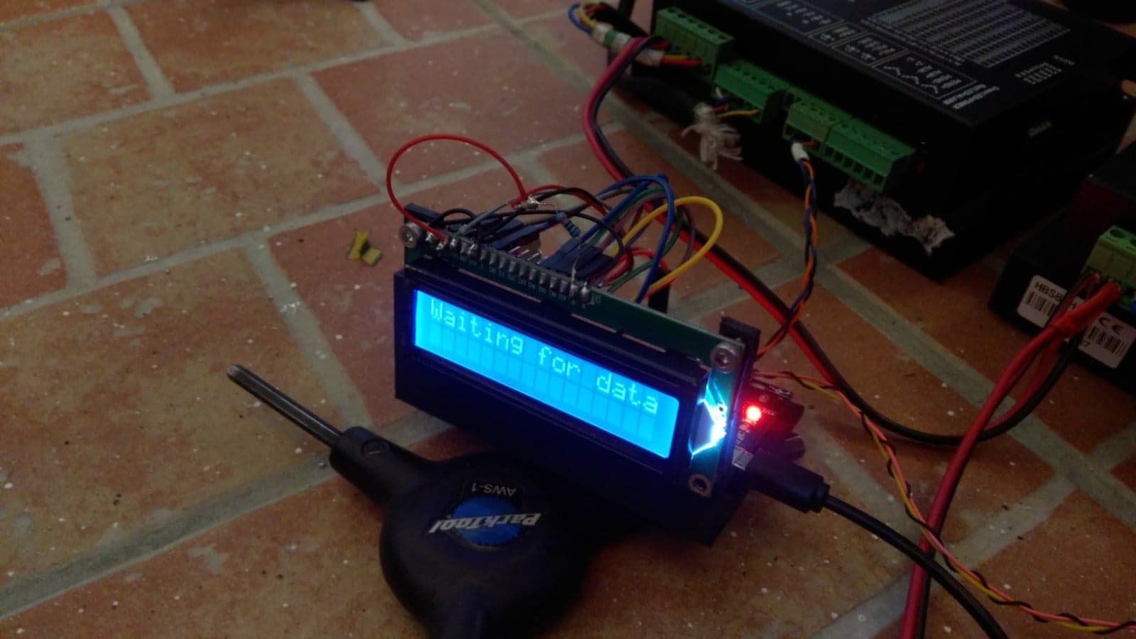

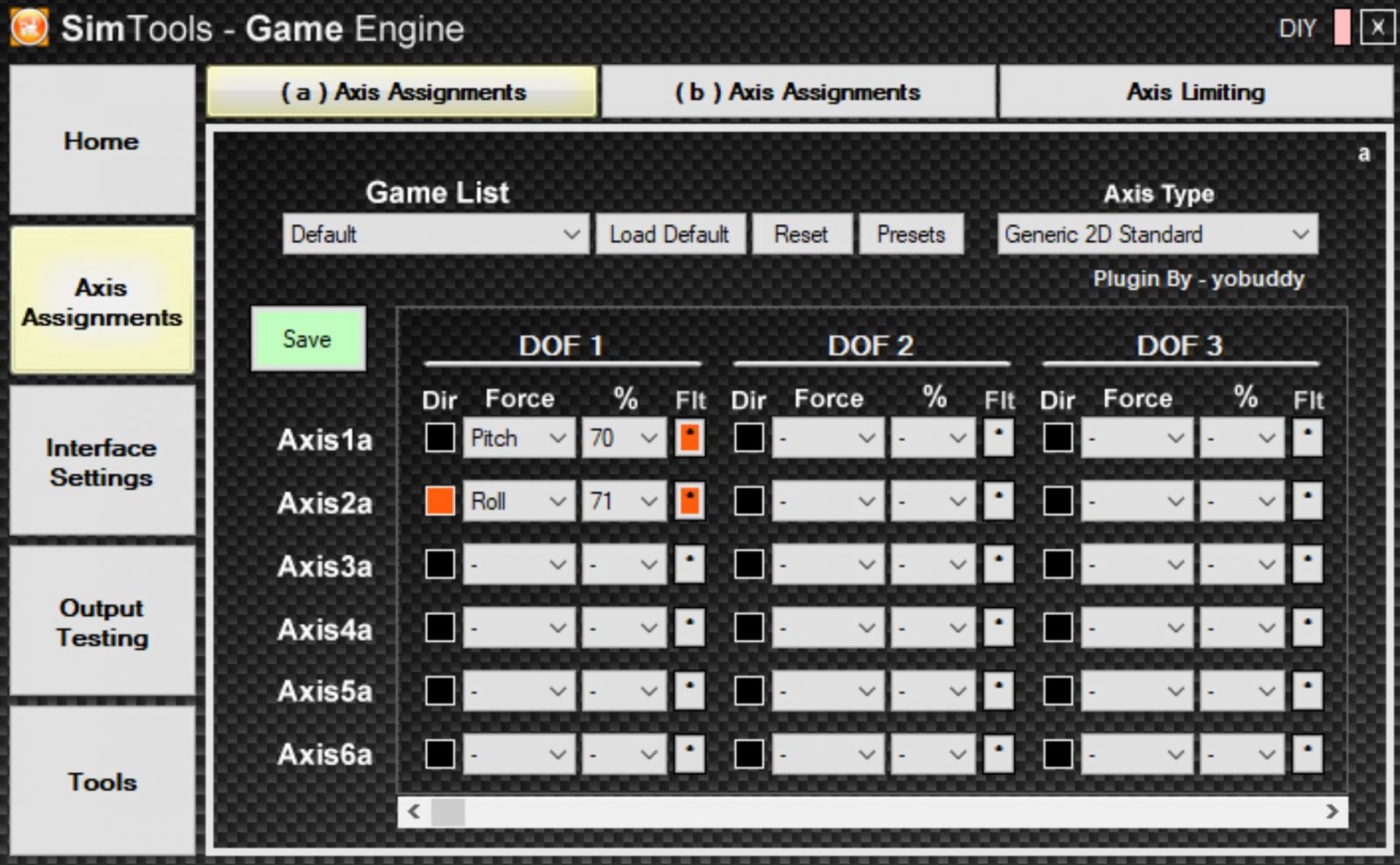

    The brain in a Arduino Leonardo. I use a LCD screen to debug everything, calibrate etc...I will put the code below.

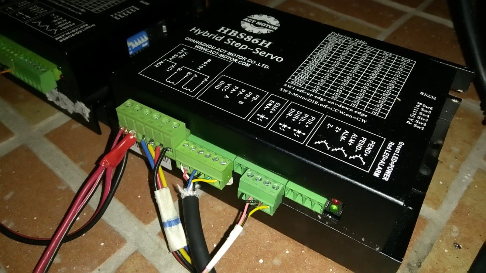

    Arduino sends pulse and dir signals to two HBS86h stepper drivers. I had a hard time trying to make them work. I learned a lot doing this project, but it also means that it took quite a long time... It's a closed loop driver. that means that an position encoder is fitted on the motor shaft and indicates to the driver where the motor is, and the driver can correct the position.

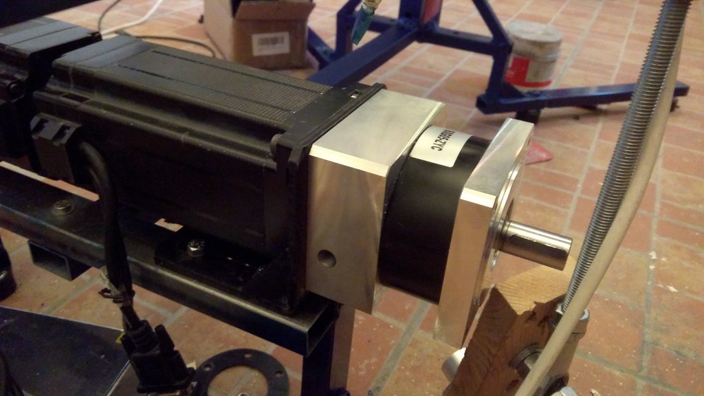

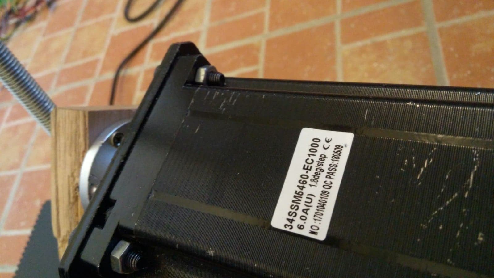

    The motors are two 12Nm Nema 34 stepper motors (ACT MOTOR 34SSM5460-EC1000). I will had a 5:1 gear reducer to have even more torque. For the moment, it's a bit weak, but very very fast.

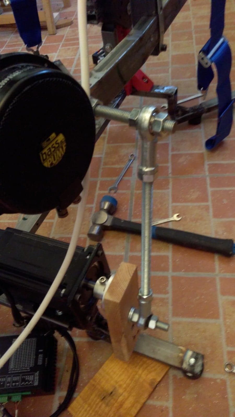

    Then we have the arm. It's a 12mm threaded rod, and I think it's a minimum because there is a lot of torque to support. I know that the wood part seems a bit crappy but it does the job...
    [​IMG]65448580_1352336744918013_1962440655703638016_n
    The pivot is based on a U joint. It's fitted in 3D printed PLA parts to be sure that there is no play. Then it's reinforced with steel parts.

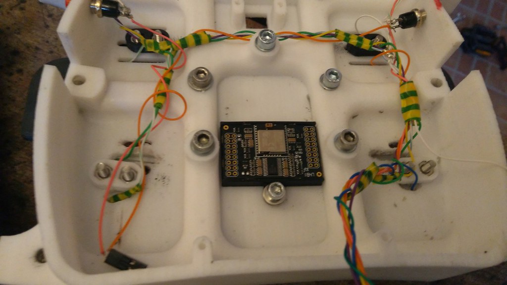

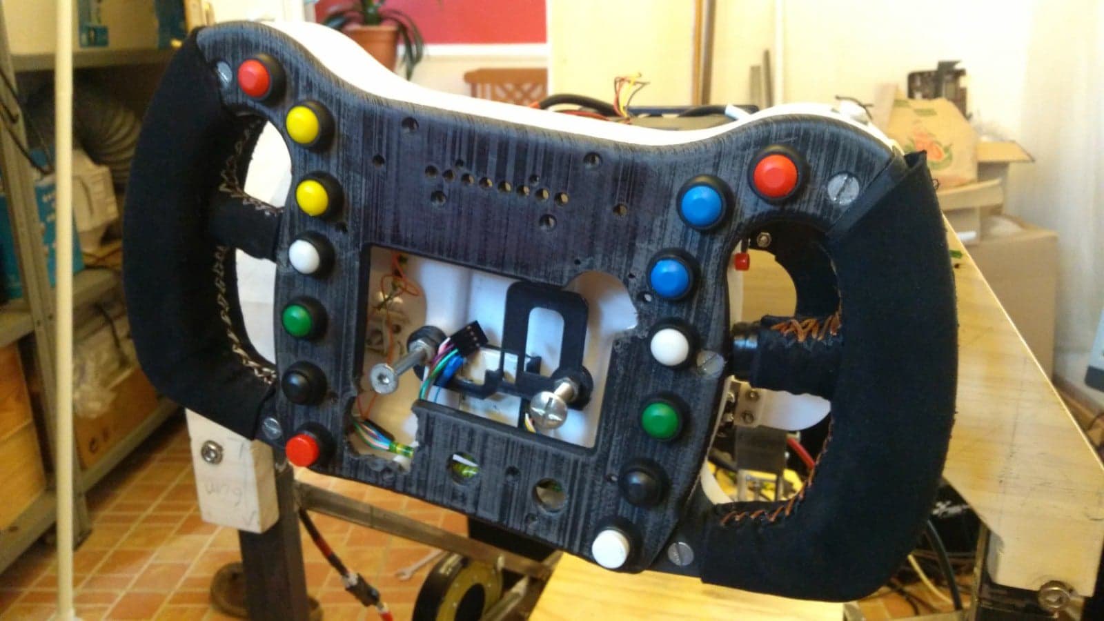

    That's it for the motion part. Now with have the indispensable steering wheel and pedals, and additional features :
    I modified a wheel by LeecarL. I added some buttons, redesigned the paddles to be better fitted to my hands, added two of them in the back because I need it for KERS (I drive the toyota ts050). I also used the bluhid board, but it doesn't seem to work anymore, so I will be using the Simucube wireless board... Thanks a lot to LeecarL, his work saved me a lot of time.
    https://www.thingiverse.com/thing:3468336

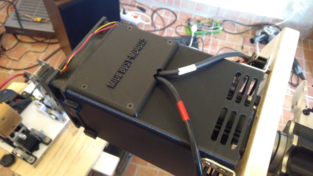

    The motor is a Mige 80ST-M04025. I choosed it because it lighter that common DD motors. The big problem is that it's overheating a lot. I had a MIGE 130ST-M10010 before. For Project cars 2, 55% torque was already very hard, and the 130ST didn't heat. The equivalent of maybe 40-45% for 130st torque with 80ST will be too hot to put your hands on it... So I added this box with a fan. I am printing the last part now, we will see if it's efficient. By the way, I thought that because the 80st is faster (2500 rpm insted of 1000 rpm for 130st), and have less inertia, it would be better (more details?). In fact, it's not really better. It's just far more efficient to cut your finguers when there is a bug... If I should do it again, maybe I would go for a 90ST-M04025, to avoid heat problems...Otherwise, the 80ST does have enough torque IMO and is very light.

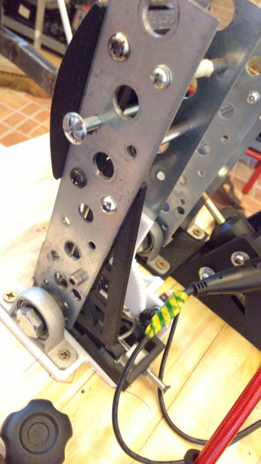

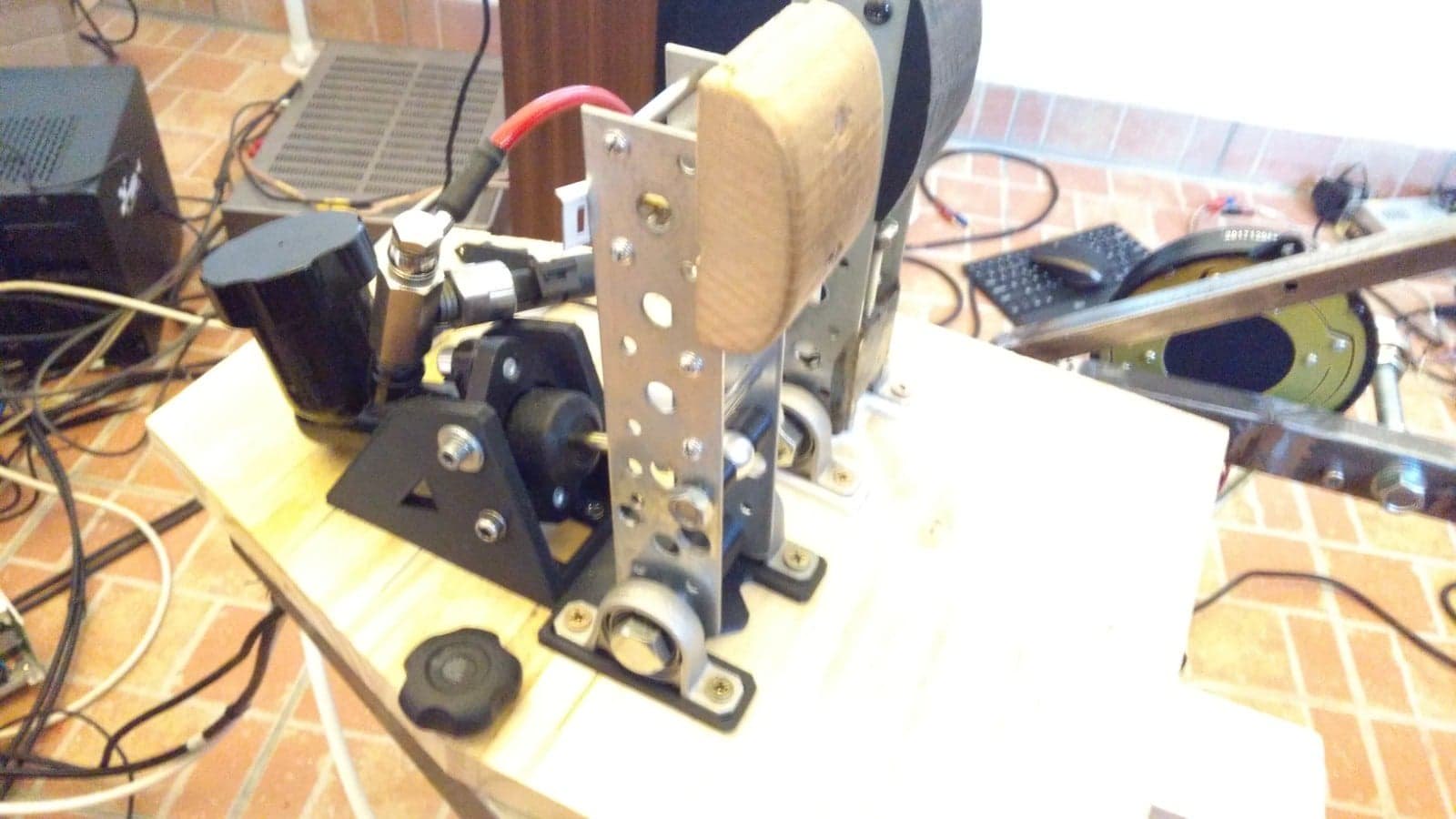

    The accelerator pedal is 3D printed a lot. It's tunable, and there is no flex. It uses a simple potentiometer (my feet doesn't have a 16 bits resolution^^). It does the job. If I have more time, I would like to 3D print the metal arm to have something that everyone can print...
    EDIT : Now everything is 3D printeable, so anyone with a 3D printer can afford the best pedal set for around 150€. The full project is here.

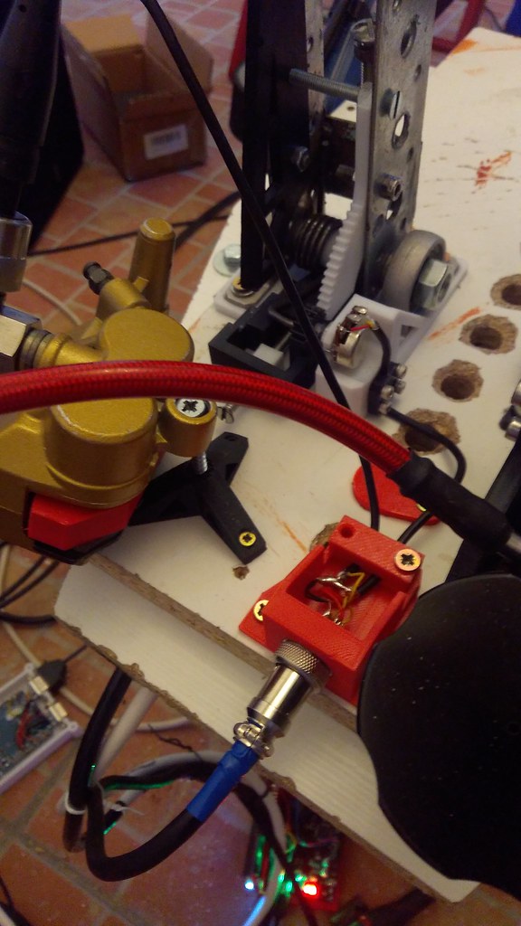

    The brake pedal is hydraulic with an hydraulic pressure sensor. It works perfectly, even with 3D printed parts. There is an hydraulic caliper at the end.
    And now the features :

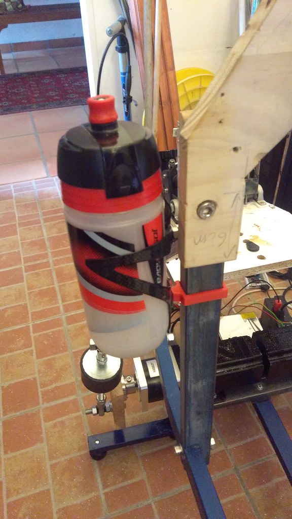

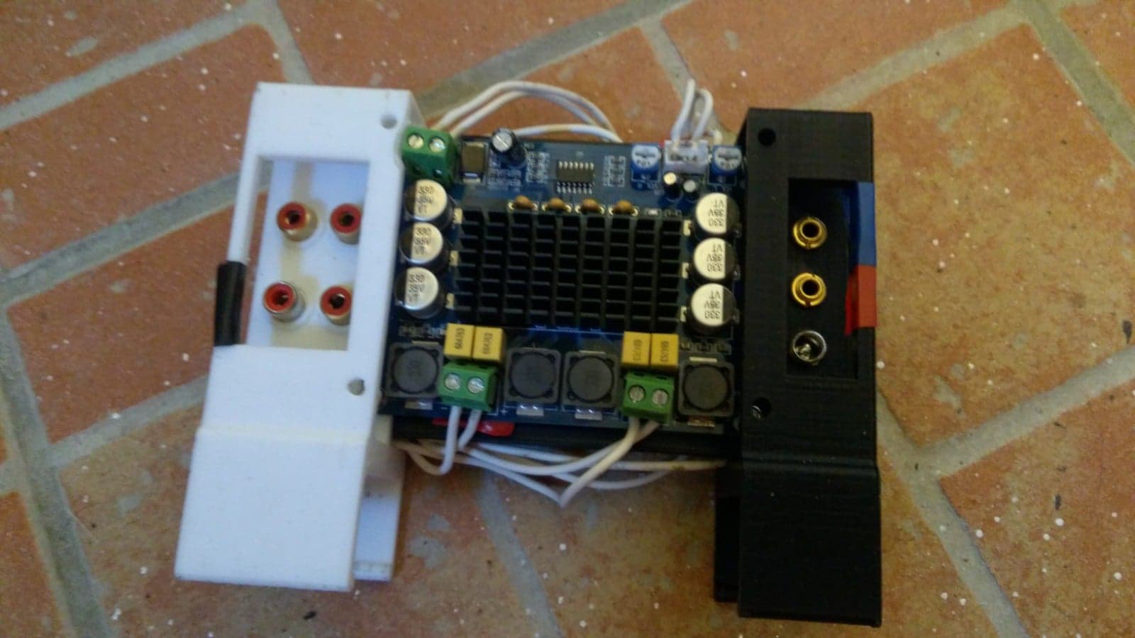

    I use 4 bass shakers on the rig. So I 3D printed some parts to build a component that integrates the amplifiers and can be installed very fast.

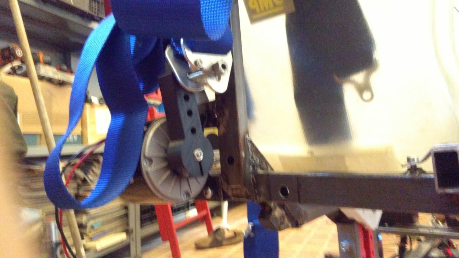

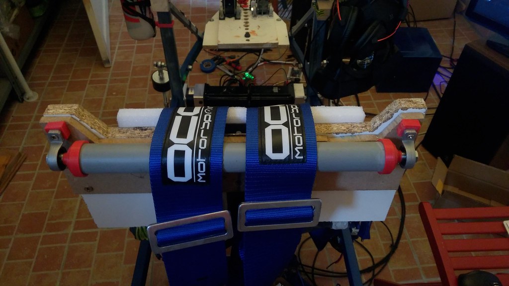

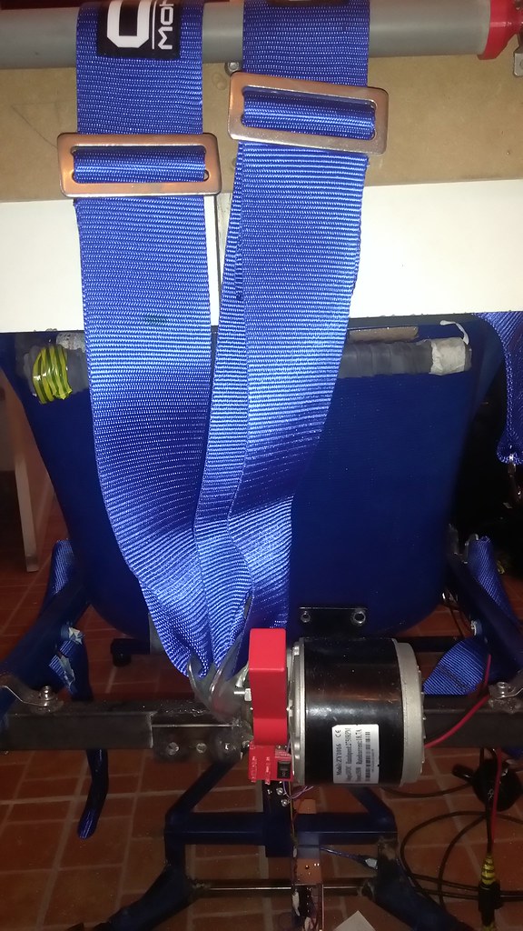

    There is a 4 points seat belt. The motor pull it back when we brake.
    And that's it !

      SerialReader();                             //Get the datas from Simtools

    // Simtools output : P<Axis1a><Axis2a>

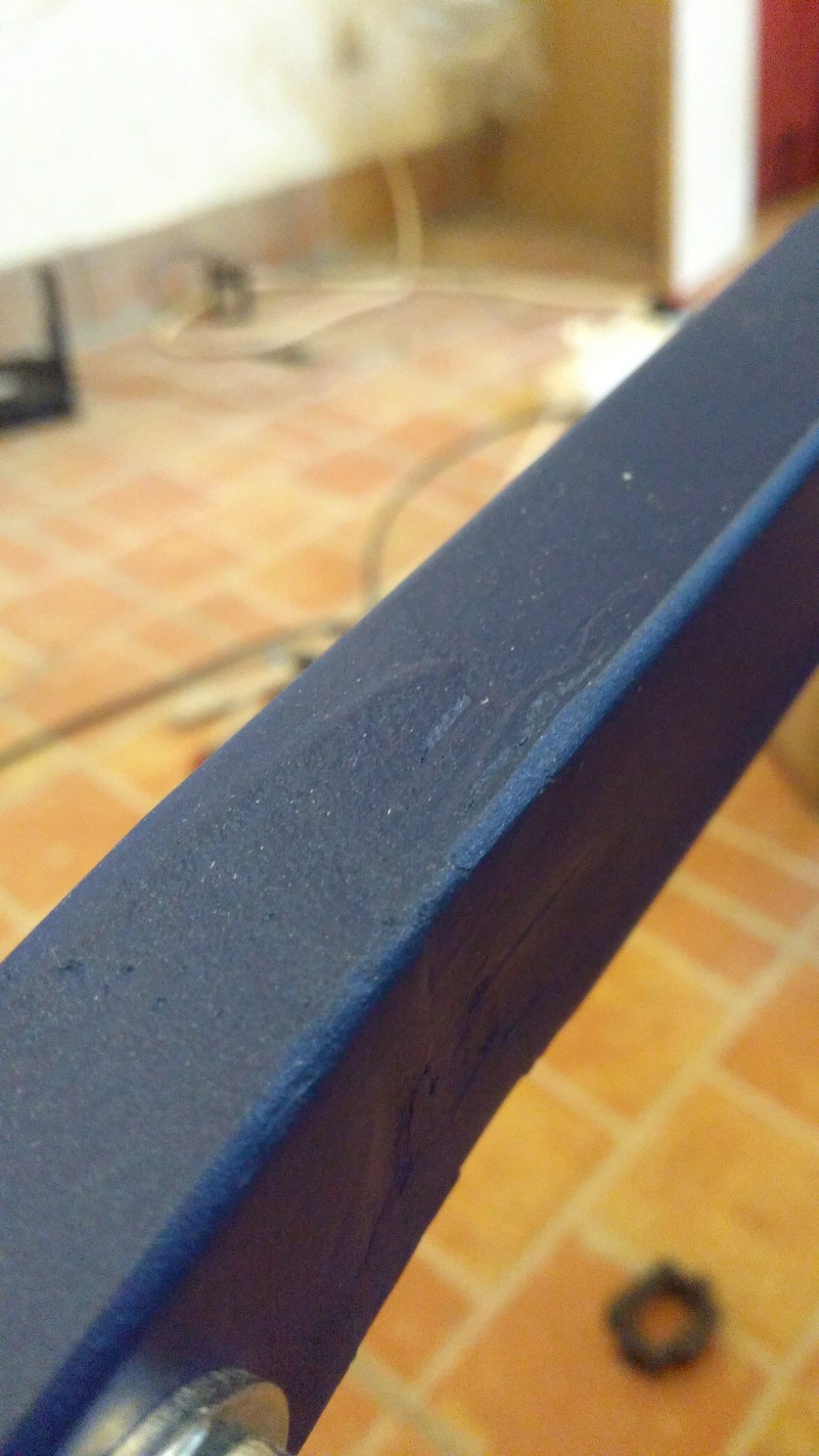

    - I added Steel parts to add rigidity to the pivot and i am preparing some parts for painting.

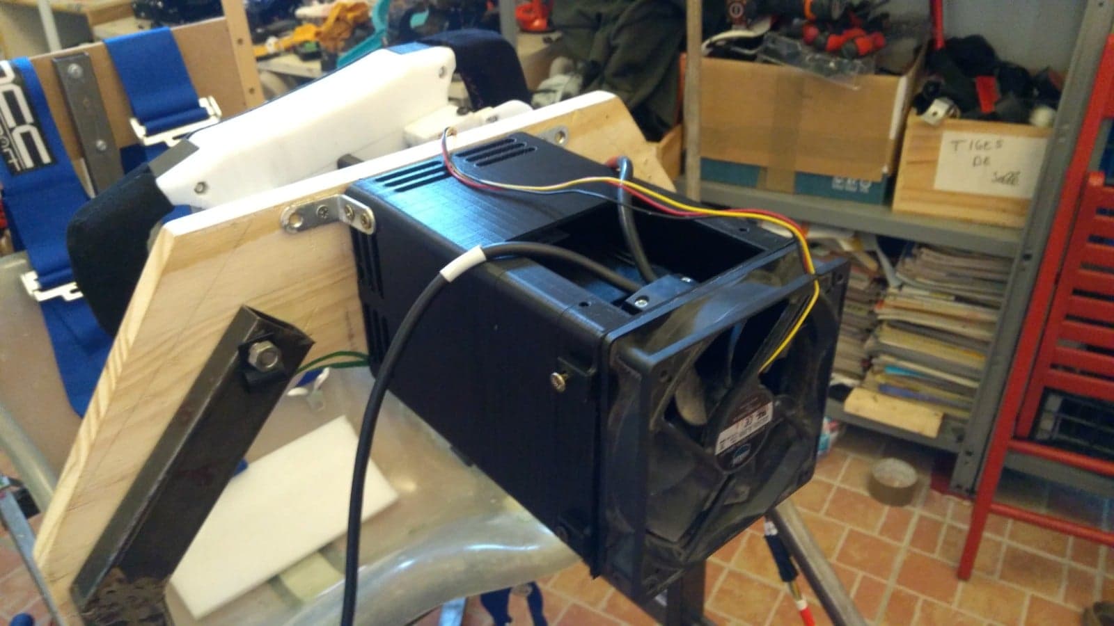

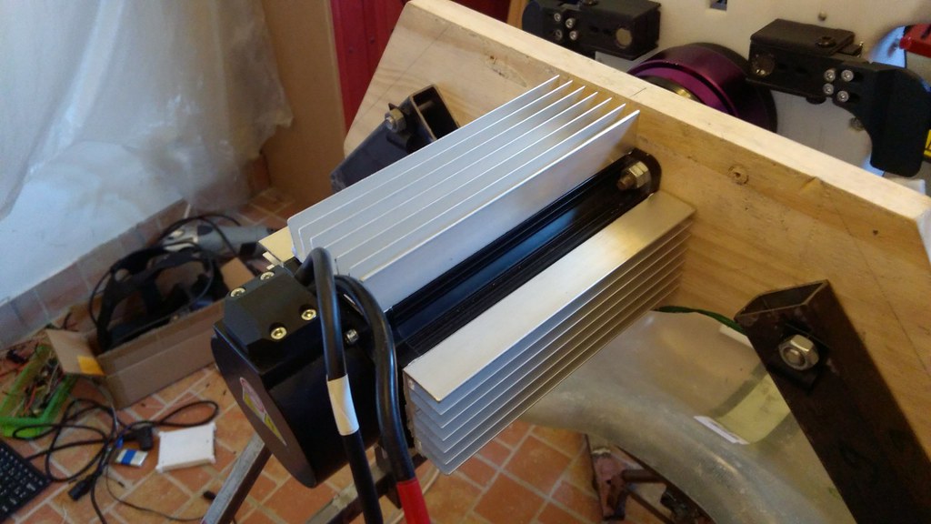

    - The motor is now well cooled. I will add heatsinks to improve cooling, but it's already ok at around 16A.

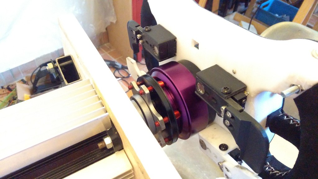

    - I received this quick release, and built it yesterday. I added a small 3D printed ring, and there is now almost no play at all, very satisfied.

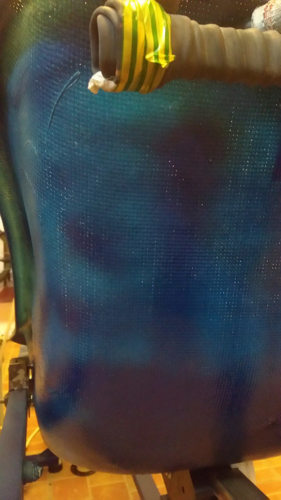

    1) As I was waiting for parts, I tought it was a good moment to start to paint. I thought I could just do a quick preparation job and just enjoy painting... I was definitely wrong... So I messed up most of the parts. The color is blue. It's my neighboor's car color. I liked it (the car...), so I painted my MTB with the same color, and now my rig. Everything is logical.^^
    As you can see, it needed more sanding... I didn't clear coated it as it needs to be redone.
    Here the primer wasn't evenly applied..

    3) I put a 3D plastic fan case around the motor, and added big heat sinks. Now the motor is really well cooled. I can even run it just with the heat sinks, without the plastic fan case. But now it's the wires that overheat... So I will keep the motor at around 17A, that is already plenty enough.
    4) I installed this quick release and I am really satisfied. I added a small 3D printed part to be sure that there is no play, but it's already satisfying without it.
    I don't know if it is a good idea to put alloy screws, as they are weaker than steel ones but... it's red !!!

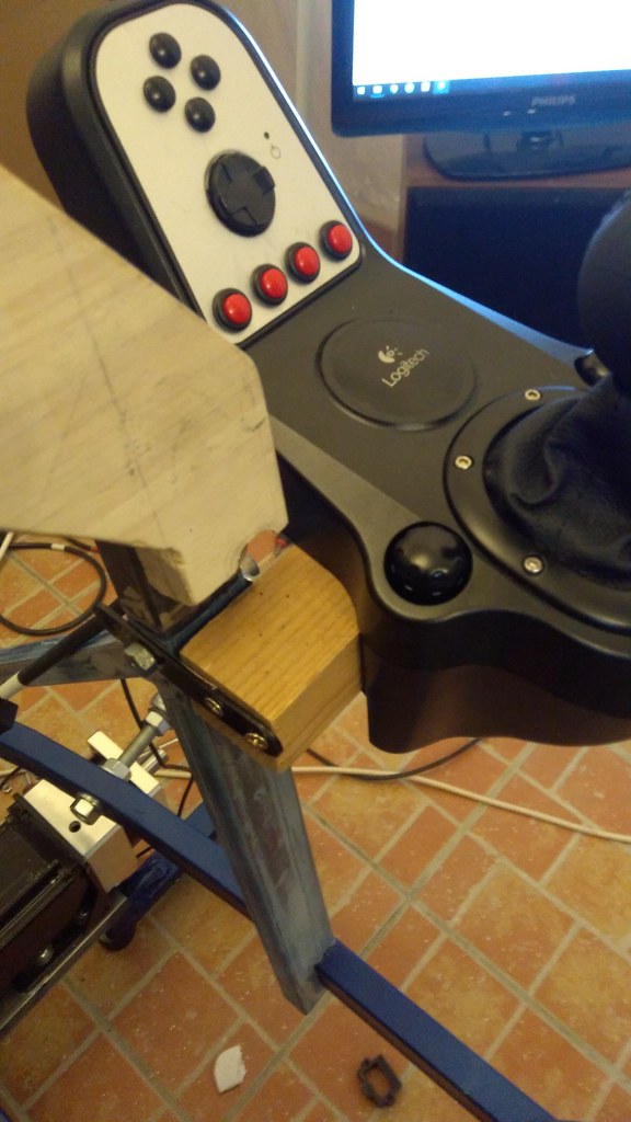

    Before that I managed to quickly mount the G27 shifter.
    6) I mounted a 5:1 gear reducer. So I will have 5 times more torque but with less speed. It also adds "resolution". I am waiting for the 16mm coupler to land. I am printing a plastic one, but I am not sure that it will handle the torque...

    I spent a lot of time trying to make microstepping work. I found out that my uno board was defective... Now it works. Again, it needs a lot more tuning, but at least it's smooth and quiet enough.
    Here is a video.

    Code:
    // Stepper microstepping settings :  51200
    int const StepPin1 = 2, DirPin1 = 3, StepPin2 = 4, DirPin2 = 5;  //Step or pulse pin, check how DirectionManager is written.
    int commandbuffer[4] = {0};    // To stock the serial datas in the good order.
    int nbrStep1 = 0, nbrStep2 = 0; // The number of pulse that each motor will receive. If the number is negative, it inverts the direction
    unsigned int pitchTarget = 16384, rollTarget = 16384;  // The pitch and roll positions we want to reach
    unsigned int  pitchPosition = 16384, rollPosition = 16384; // The actual positions
    int c = 0;
    int dir1 = 1, dir2 = 1;         //Will be used to set the motors direction
    int pulseWidth = 10;            //From the HBS86h datasheet : For reliable response, pulse width should be longer than 10μs
    bool LCDMode = false, InitializeMode = true;
    int max = 0;
    int x, y;
    int btnPin = 13;
    #include <LiquidCrystal.h> // includes the LiquidCrystal Library
    LiquidCrystal lcd(6, 7, 8, 9, 10, 11); // Creates an LC object. Parameters: (rs, enable, d4, d5, d6, d7)
    void setup() {
      delay(2000);    //safety delay to flash the code
      pinMode(StepPin1, OUTPUT);
      pinMode(DirPin1, OUTPUT);
      pinMode(StepPin2, OUTPUT);
      pinMode(DirPin2, OUTPUT);
        if (InitializeMode) {
          Initialize();
      Serial.begin(115200);    //To communicate with Simtools

    void SerialReader() {       // This function is the work of Sirnoname
      // Simtools output : P<Axis1a><Axis2a>, Data bits : 15 bits, Parity : None, stop bits : 1
      int buffer           =  0 ;    // It takes the value of the serial data
      int buffercount      = -1 ;    // To count where we are in the serial datas
      while (Serial.available())
        if (buffercount == -1)
          buffer = Serial.read();
          if (buffer != 'P') {
            buffercount = -1; // "P" is the marquer. If we read P, the next data is pitch
          } else {
            buffercount = 0;
        else   //  if(buffercount>=0)
          commandbuffer[buffercount] = buffer; // The first value next to "P" is saved in commandbuffer in the place "buffercount"
          buffercount++;
          if (buffercount > 3)
            pitchTarget = (commandbuffer[0]) * 256 + commandbuffer[1];
            rollTarget = (commandbuffer[2]) * 256 + commandbuffer[3];
            buffercount = -1; // Re-initialize buffercount.
            break;

    UPDATE #7
    Ok it works fine now. A new version of the code is available at the end.
    - I added a removable bottle cage : next week we are going to race the 24h of le Mans and are expecting high temperatures.
    - I added moving seatbelt
    - Some parts have been printed again with some improvements, particulary for the pedals :

    The seat belt has been upgraded with a cable drum. There is many advantages over an arm style system :
    - more torque because there is relatively less arm
    - no need to adjust the seatbelt, it will automatically be tight in few brakes.
    Here is a video.

    I raced the 24h of le mans with two friends. You can find pictures and videos here on the Pimax forum.
    Regarding the simulator :
    - The stepper motors were slowly losing calibration, going a bit down. We re-calibrated them twice during the race... I don't know why.
    - Most of the shifters paddles failed, due to the changes to the design I made... I fixed them during the race.
    - One of the belt tensioner 3D printed part failed, probably because the heated motor soften it... I need to build it with tighter tolerances.

    I used this parts :
    bicycle brake cable
    motor, quite powerfull, if you have a proper build, it will even be too much powerfull. Maybe around 250W would be better... the thread is inverted so don't loose the bolt.
    driver, as the motor is really powerfull, it needed a strong driver too. I tried other that burned immediately. Plus this one got stop and dir switches that are usefull to tweak the system.
    Pay attention to the fact that the potentiometer wires colors are wrong. It's something like :
    black is signal (you want to replace it with a analog signal coming from an arduino/simhub, you need to convert the pwm signal with a DAC circuit (a capacitor and a resistor, google it),
    red is ground (link it to the arduino ground)
    yellow the VCC... I lost a lot of time because of this...
