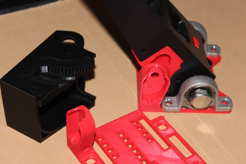

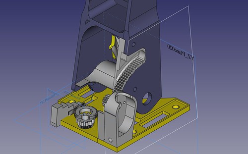

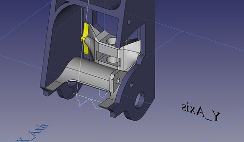

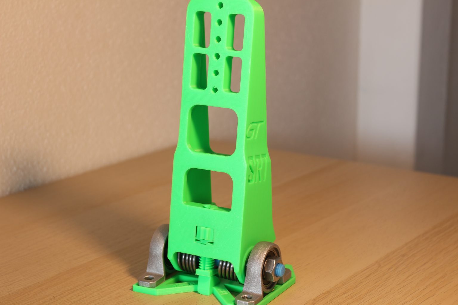

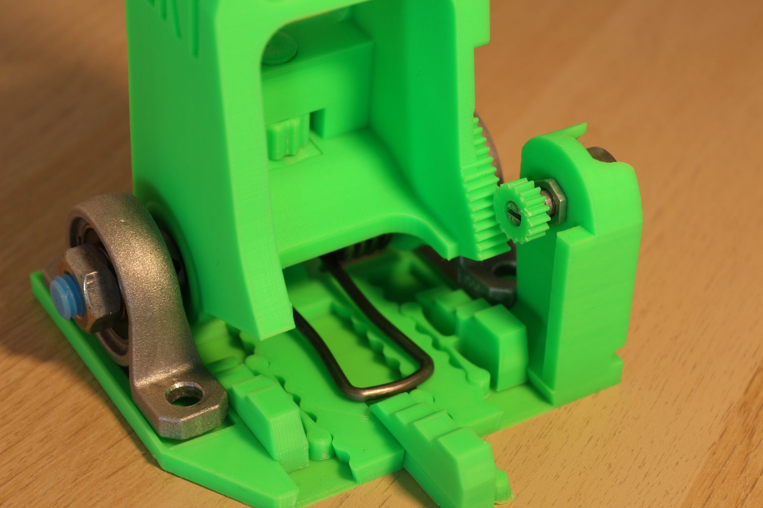

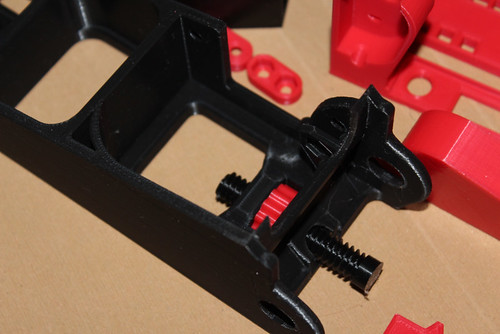

    a) Accelerator pedal
    Angle can vary from -20° to 35° The starting position is tuned by a screw and a knob (no tool needed).
    The end position is tuned by steps.
    There is a preload for the metal torsion spring.
    Pictures of v5.8 :
    Thingiverse page : https://www.thingiverse.com/thing:4461145

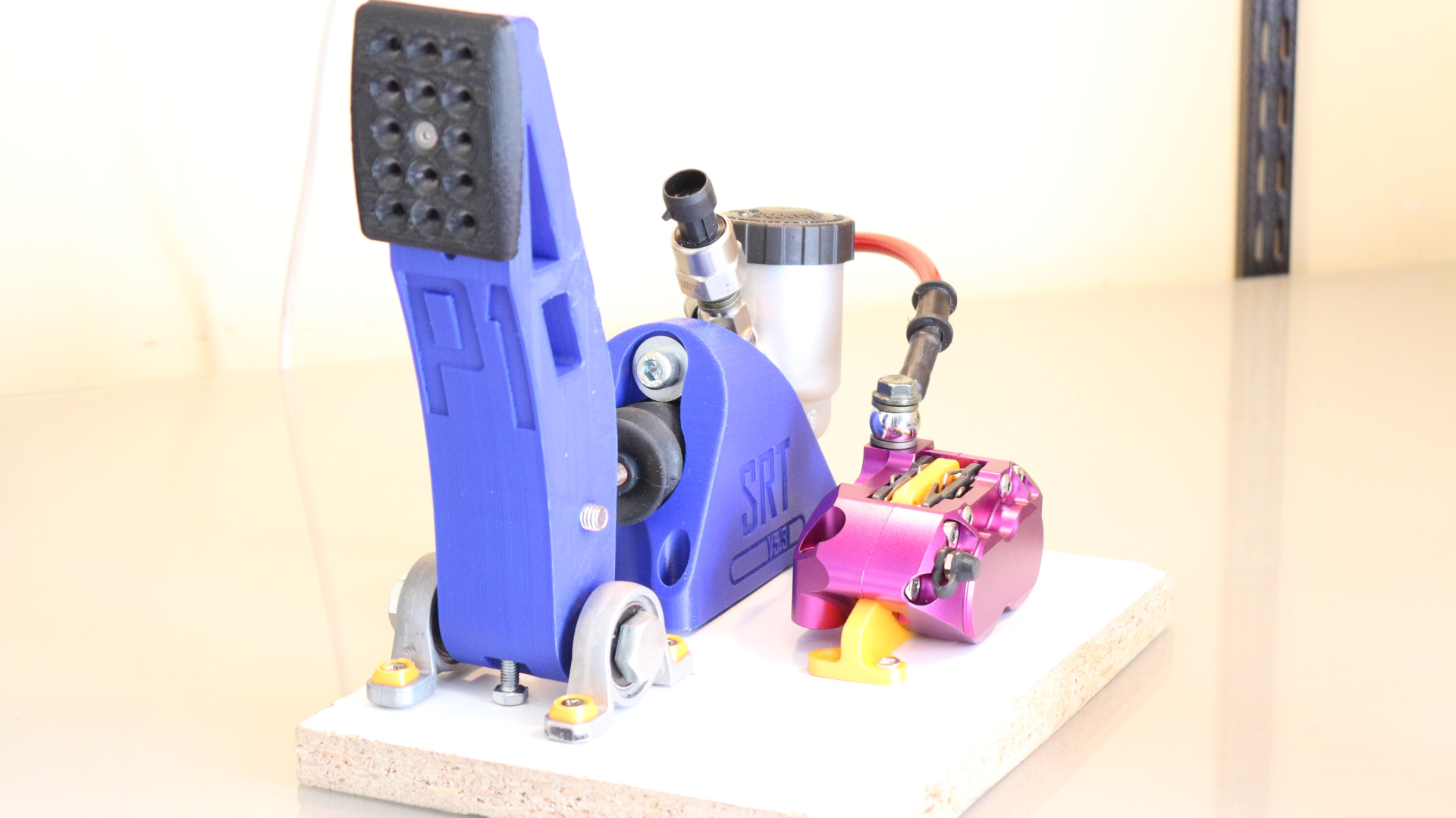

    Here is the pictures of the brake pedal (v5.3) :

    Already working on v5.2 :

    accelerator V5.2 is coming :

    Accelerator v5.2 is online :

    Already working on accelerator v5.3

    BTW. On the brake pedal, you can add a preload, but for the moment it's quite hard to change the way it behaves after that.
    It can be changed, but for the moment it's not my priority as it's the feeling is plenty satisfying for me for the moment. Maybe later with a kind of financial support I could go back to it.. (my girlfriend doesn't like too much when I throw away a working pedal set to build a new one ^^)

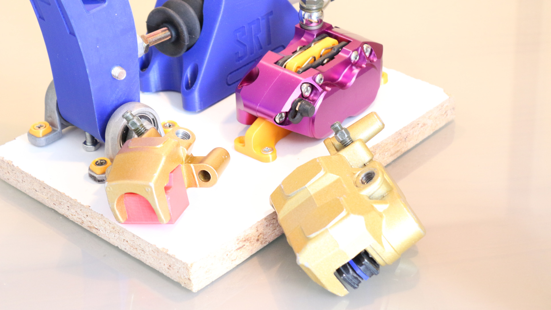

    For the build, everything is basically like a normal brake except the caliper is a pressure sensor? Pedal to mc, reseviour to mc, mc to pressure sensor? Is there anything else that helps with compression as most other, I think, still uses rubber to compress to give feeling of using a real brake.
    Also I read your previous thread and you used a caliper with a load cell where the brake disk would be. Is there a reason why your not doing it this way anymore?

    In fact, I never managed to get something satisfying with rubbers.
    I tried a lot of things, but finally went back to use a brake calliper.
    Then you can also add a spring on the mc axle, or rubber in the brake calipper..

    I don't use load cells anymore. You need to amplify their signals and i always struggled to do so. Know I use hydraulic pressure sensors that are plug and play : they just act like an potentiometer.

    I think I'm getting a little confused by how you've configured this.
    Where is the pressure sensor? Is that connected to where the caliper and brake lines connect?
    Does the caliper have a metal part between the brake pads to simulate a brake disk?
  20. Lebois
    Dec 10, 2018
    353
    Math teacher
    2,565Coins
    +210 / 2 / -0
    Yeah the sensor is between the mc and the brake calipper.
    I printed a 3d part that replace the disk and brake pads.
