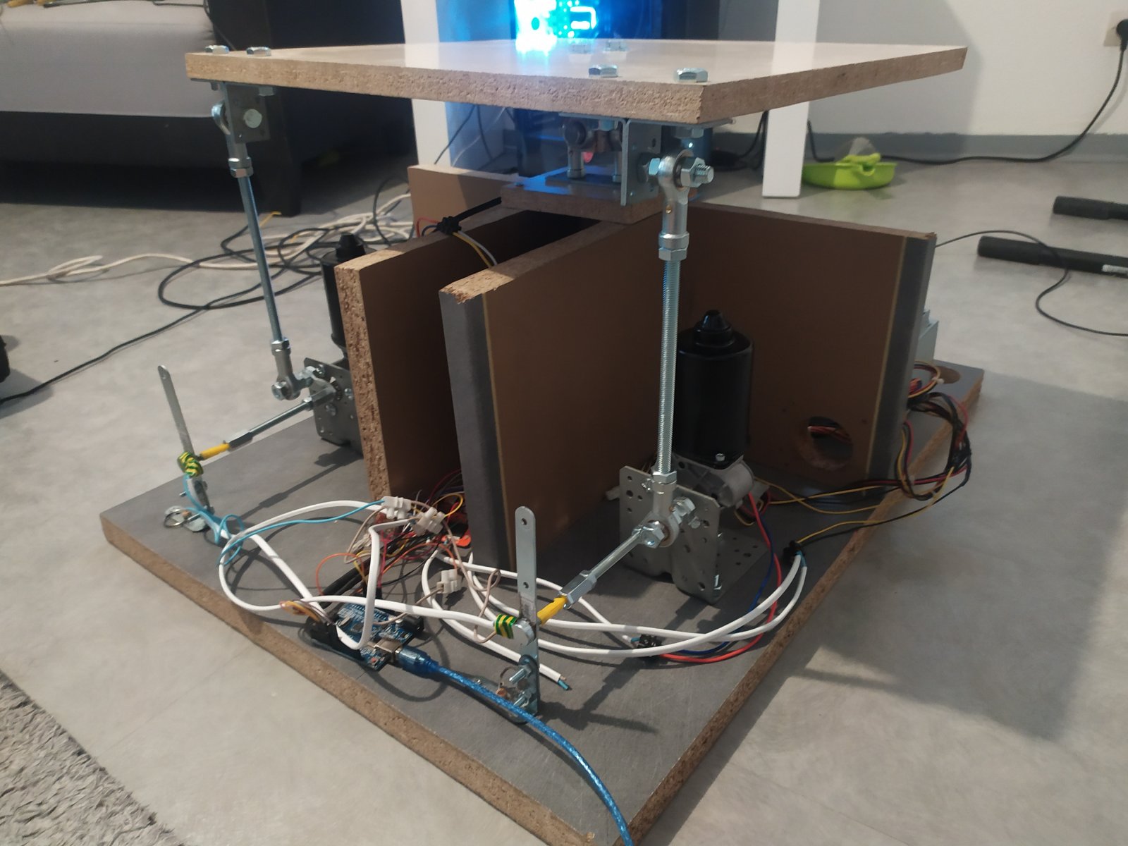

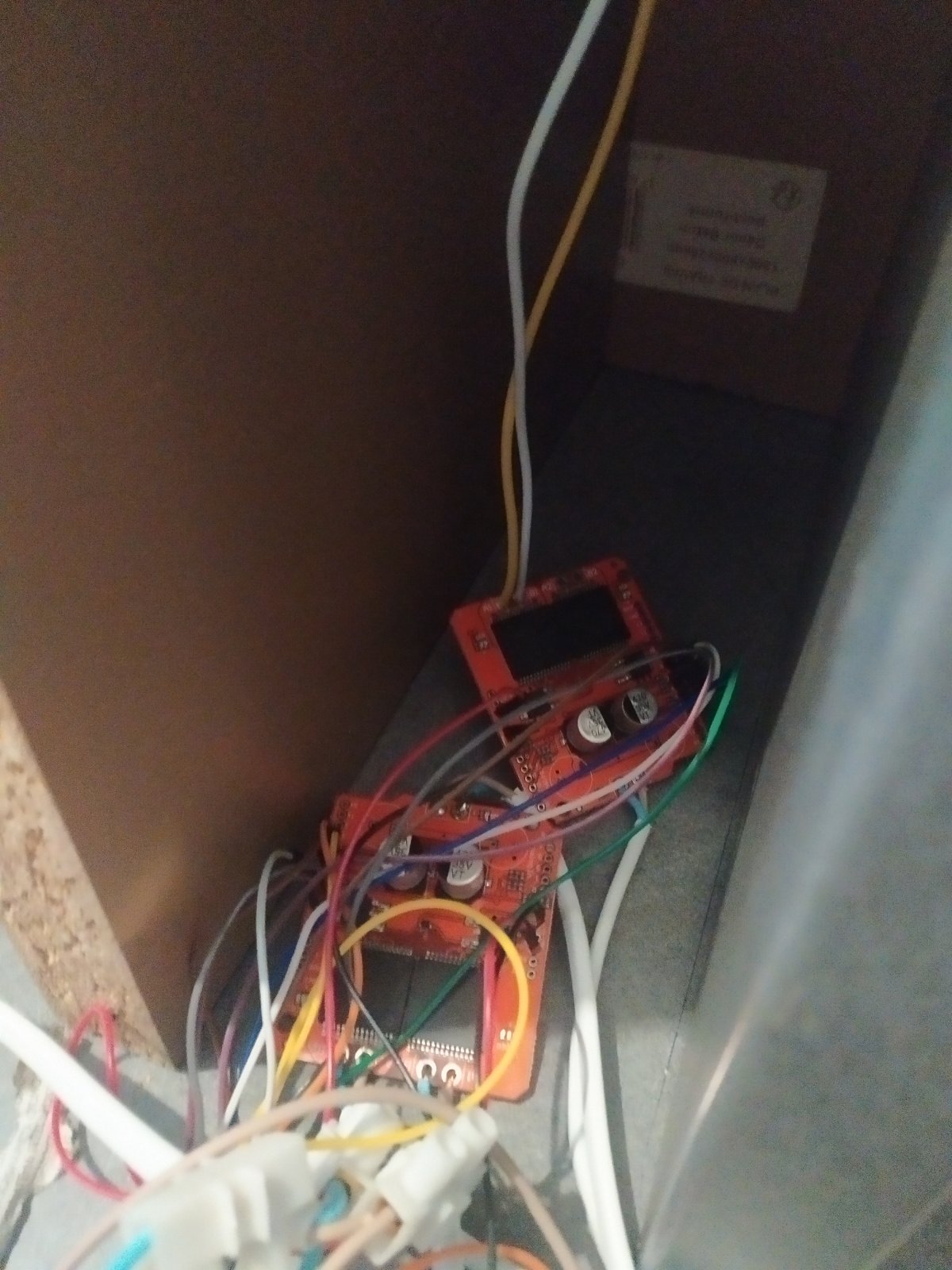

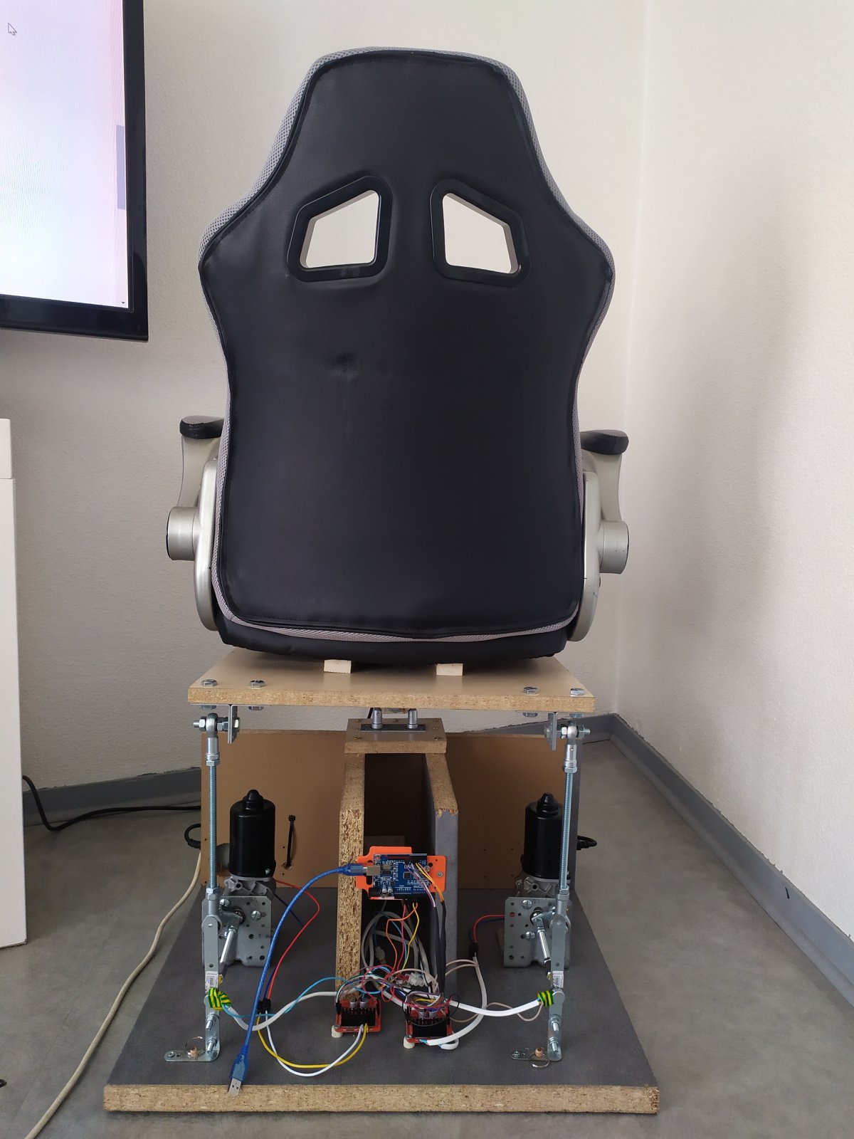

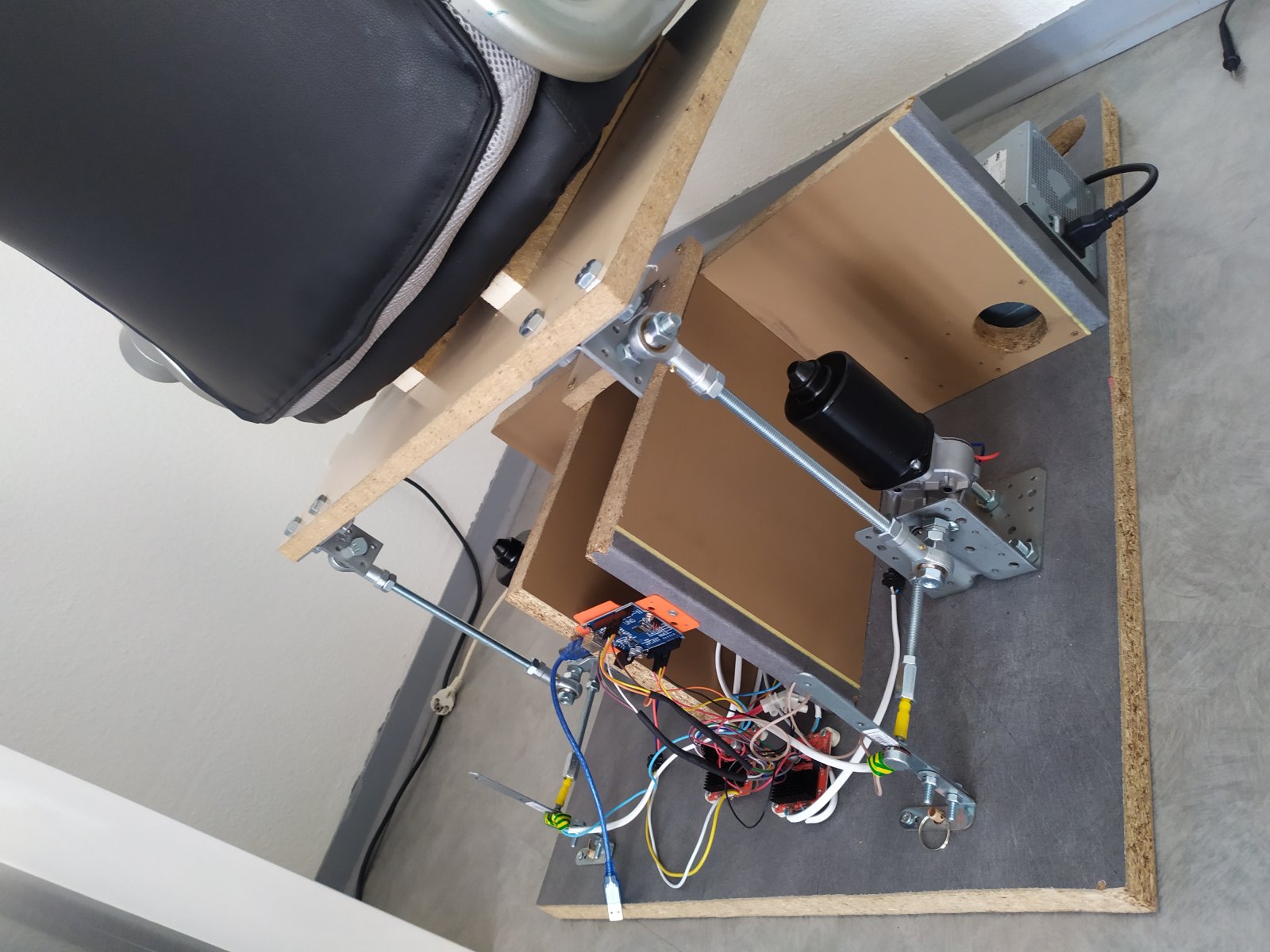

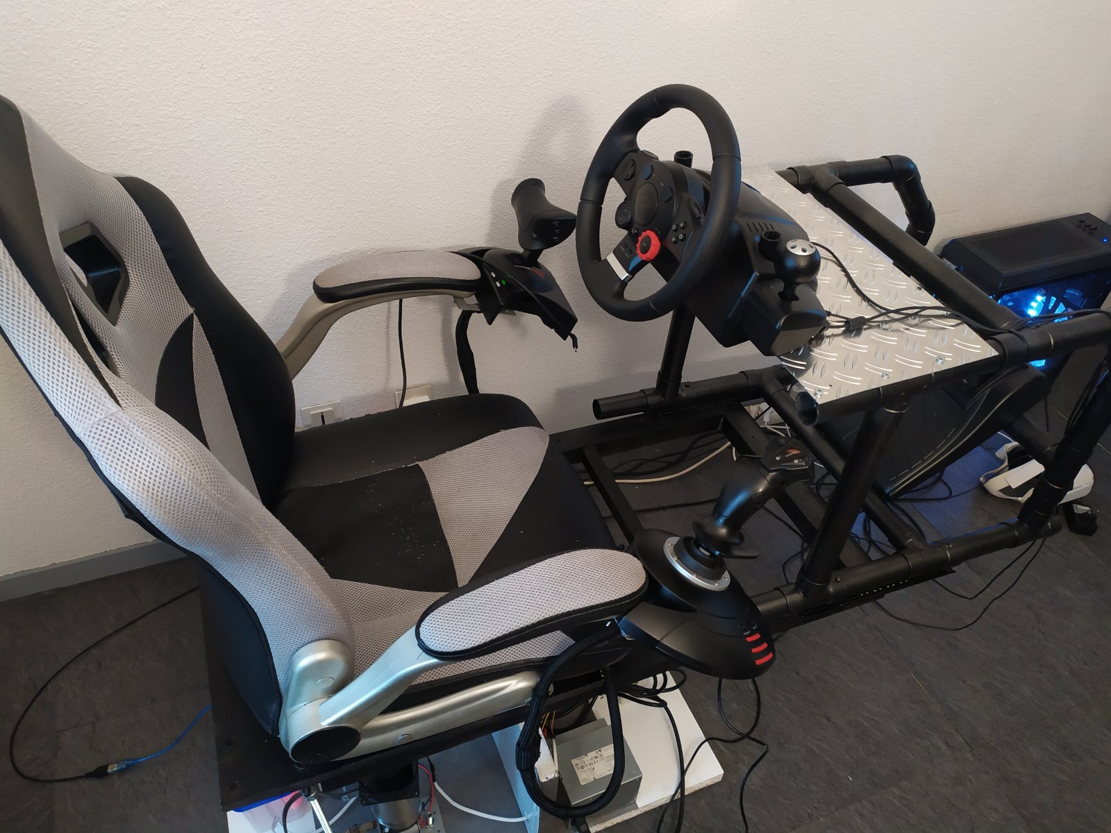

    Hello, I have started making a 2Dof. I followed the wanegain tutorial but with a motorcycle monster shield card and potentiometer directly coupled to the 12 volt wiper motor. I installed 2 motorcycle monster cards since they were defective on one channel, so 1 card per motor. It works pretty well but my 12 volt power supply comes from a PC and cuts very often I think it lacks power.

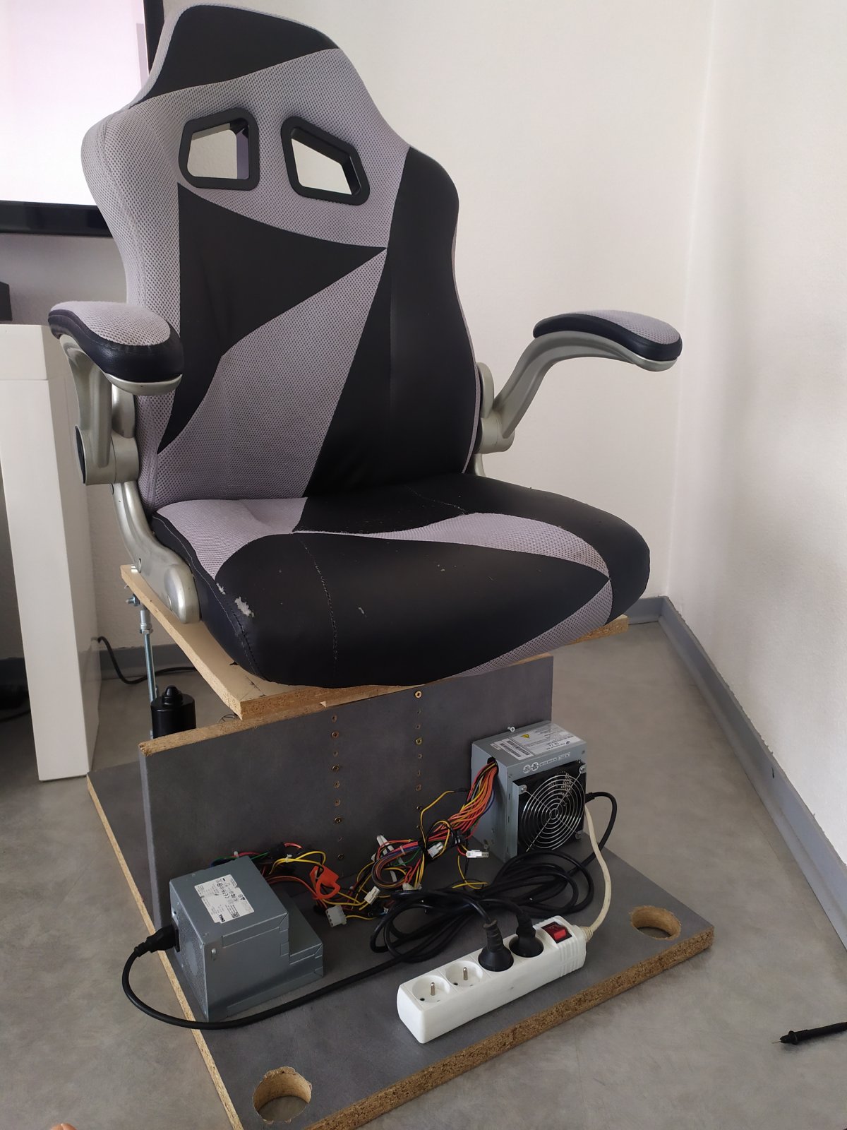

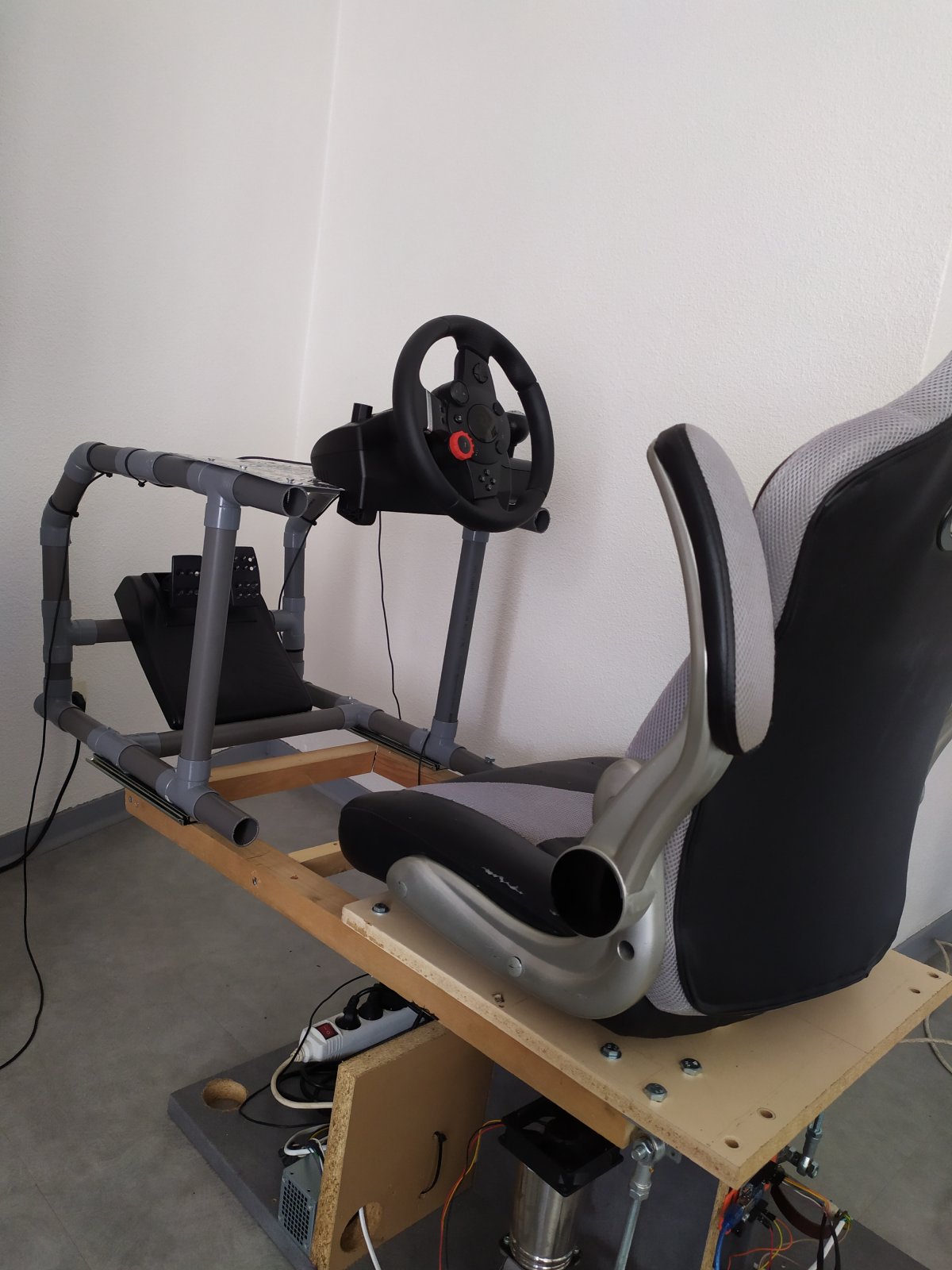

    I fixed my power supply problem that was cutting. I put a motor power supply and it works very well. I bought the simtools license but I didn't know that I still had to pay for the plugins IMG_20210722_175501.jpg IMG_20210722_175609.jpg IMG_20210722_175655.jpg

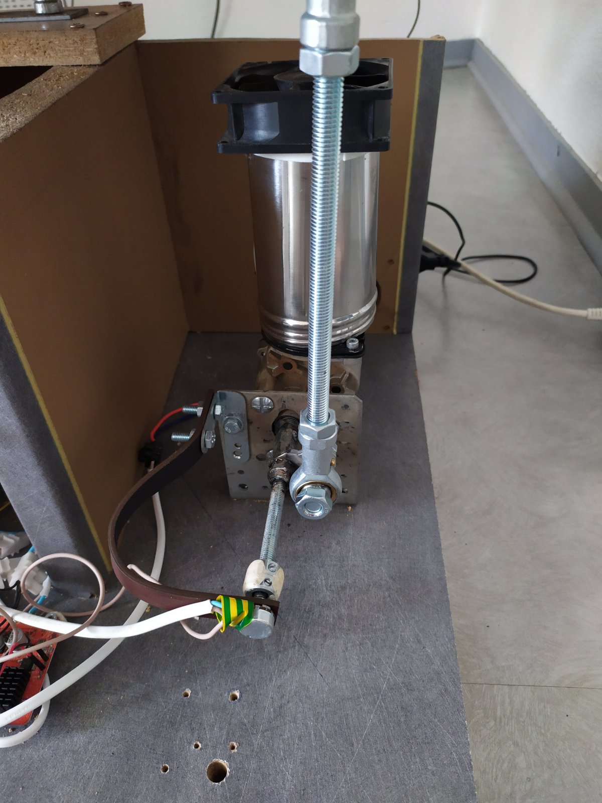

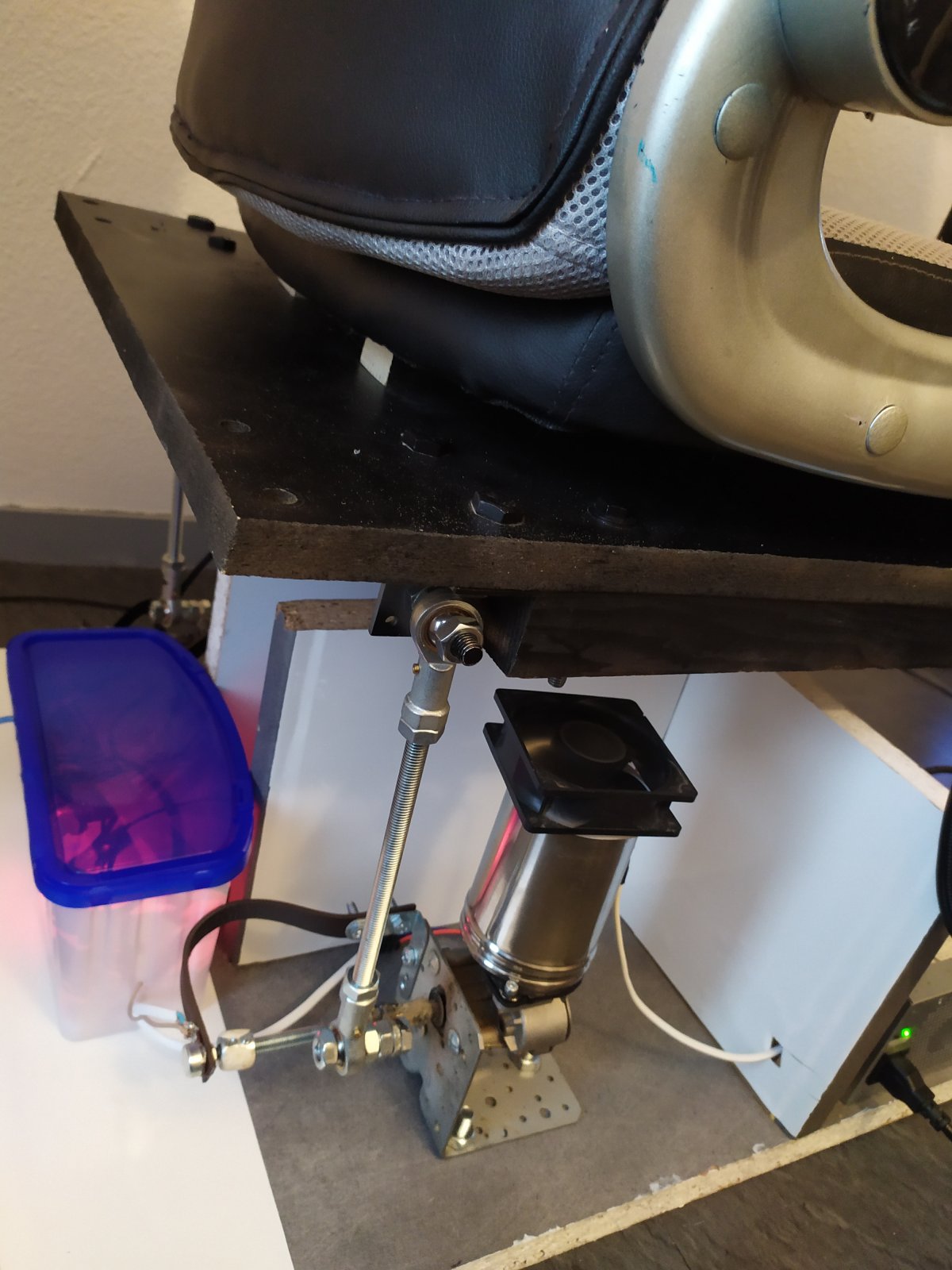

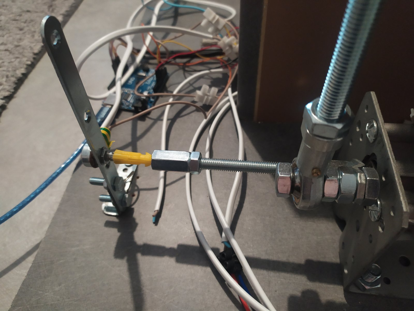

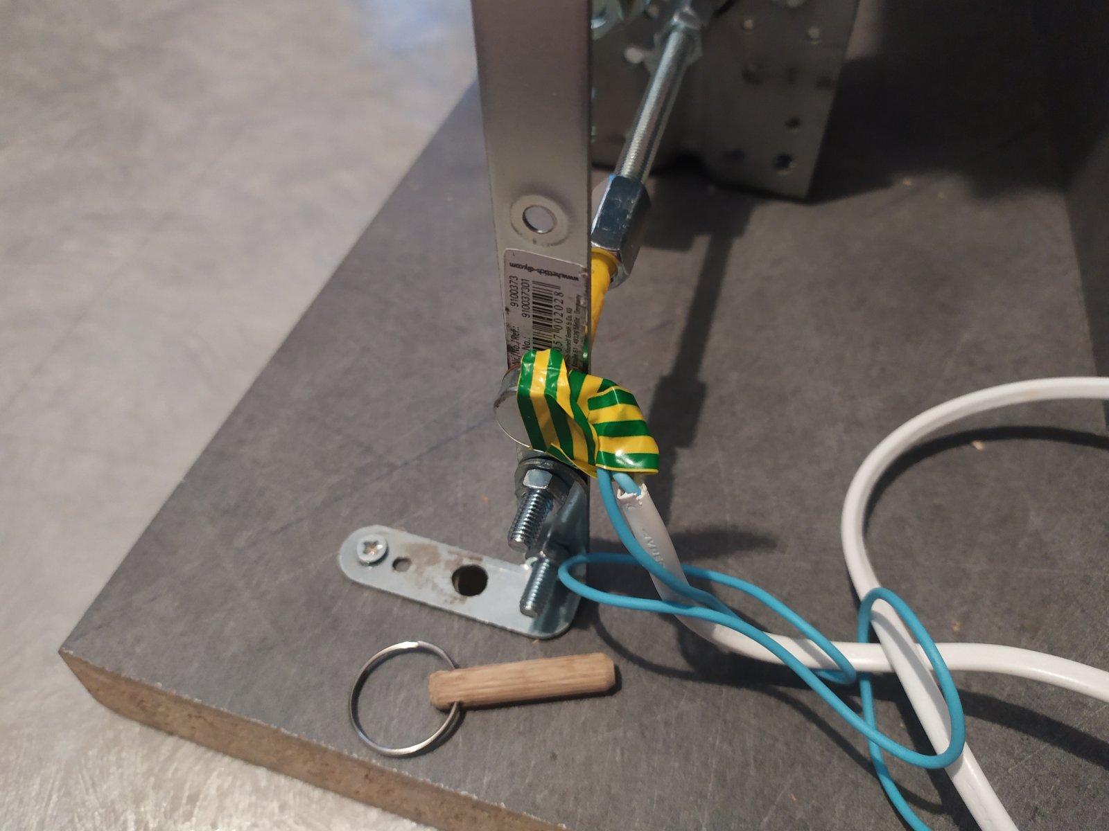

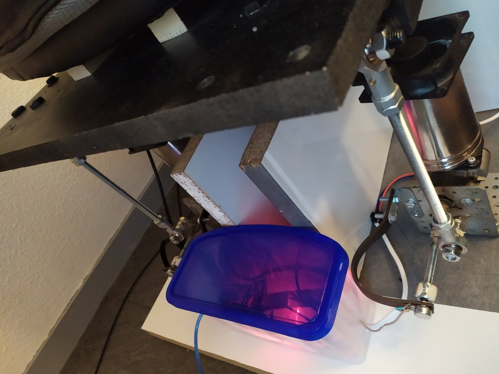

    I changed the fixing of the potentiometer with a leather belt fixed directly on the square of the motor and it is perfect. I ventilated the engine and added flywheel pedal attached to plumbing pipes. this system and adjustable thanks to the drawer slide fixed on these pipes

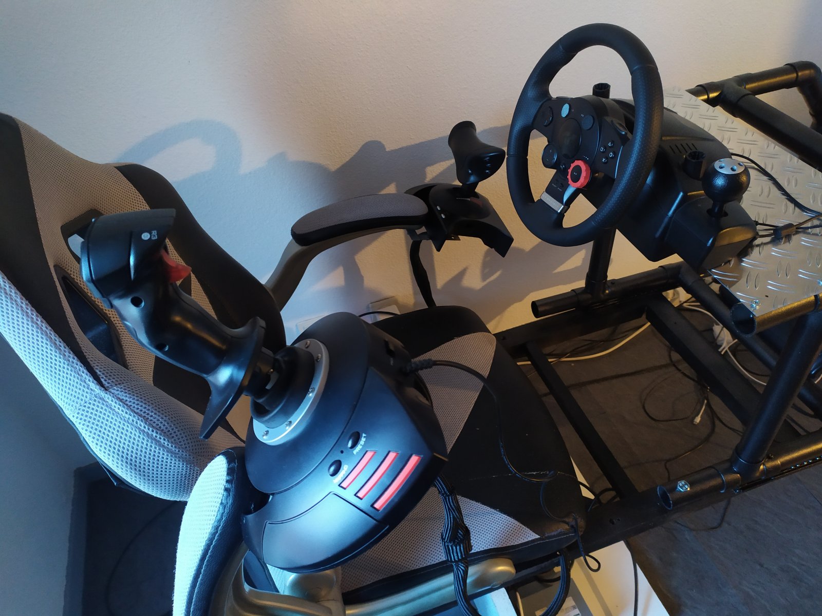

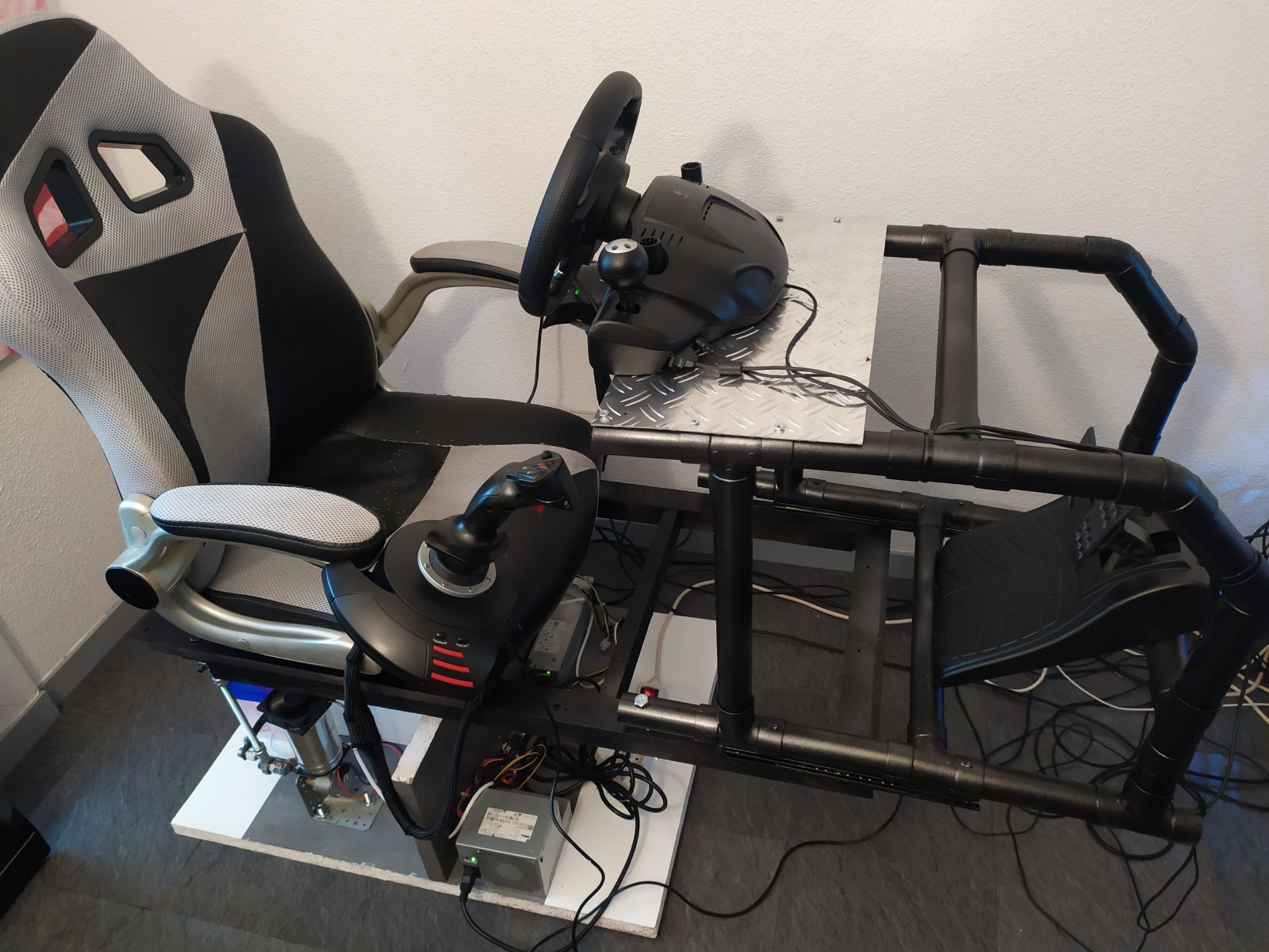

    my simulator a little modified with the addition of a hotas x

    as I see you use two power supplies, one of them dedicated to control circuit (arduino) and the other for motors I guess. is it true? cograts, good work.
  8. elvis77
    elvis77 New Member
    Jul 7, 2021
    9
    11Coins
    thank you ! no the two power supplies each control a motor and the arduino and powered by the PC
