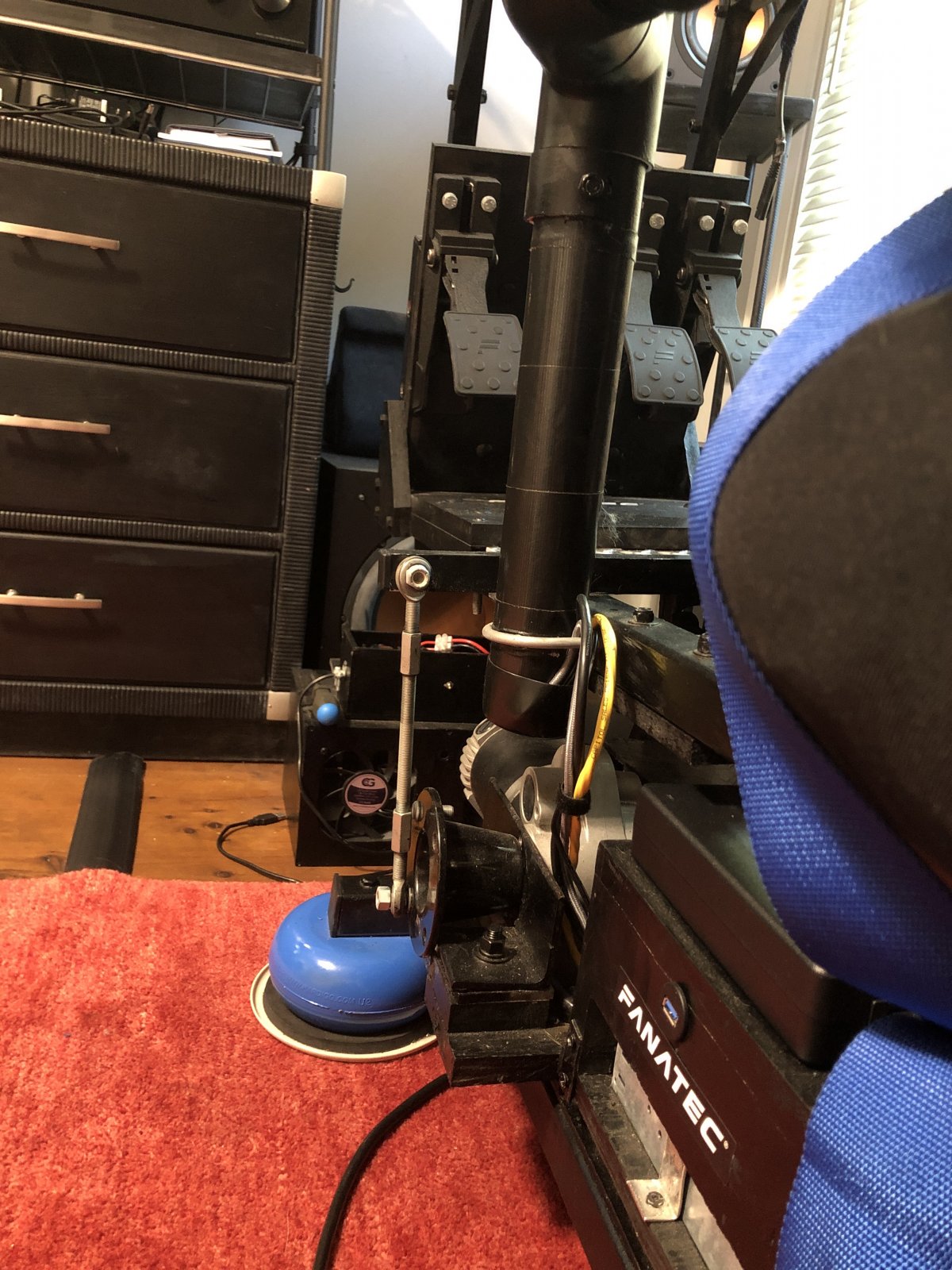

    This is a nice and simplistic build. One thing you could consider is adding a metal bar where the motor arm connects to extend the distance from the center. This will decrease movement in exchange for less force exerted on the motor.

    Hi Sam, i am interested can you elaborate on this?
    I am not sure i understand where to put that metal bar?
    Thanks!

    No problem. As you can see in this picture, you can put the point of contact to the motor out farther from the center of the platform. This fixed the issue I had with one motor going down when no power was applied but it might not work for you due to your motor position. image.jpg

    I think i may look into a shorter lever ctc since it seems to have a bigger impact looking at simcalc....
