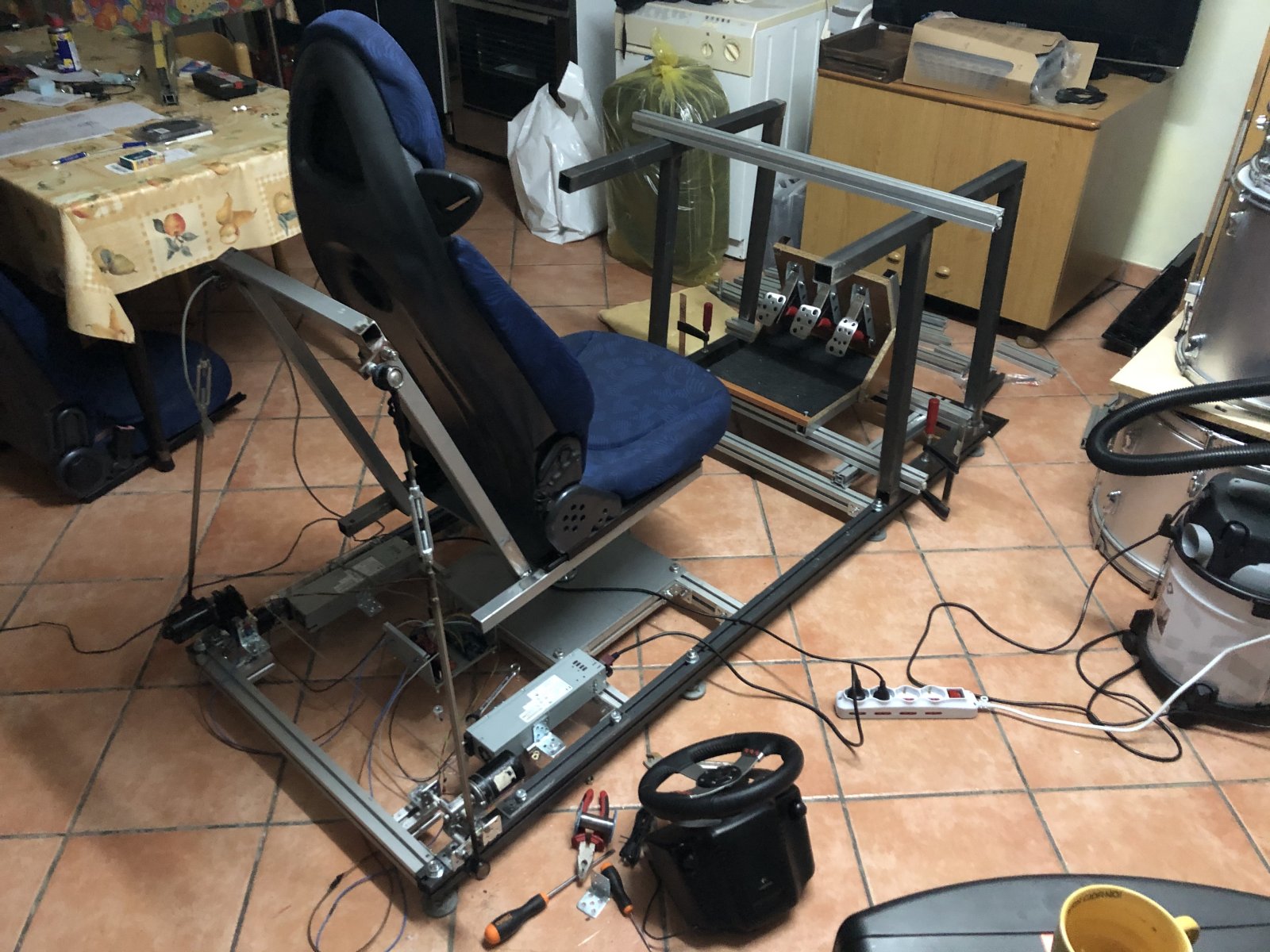

    Hi everyone.

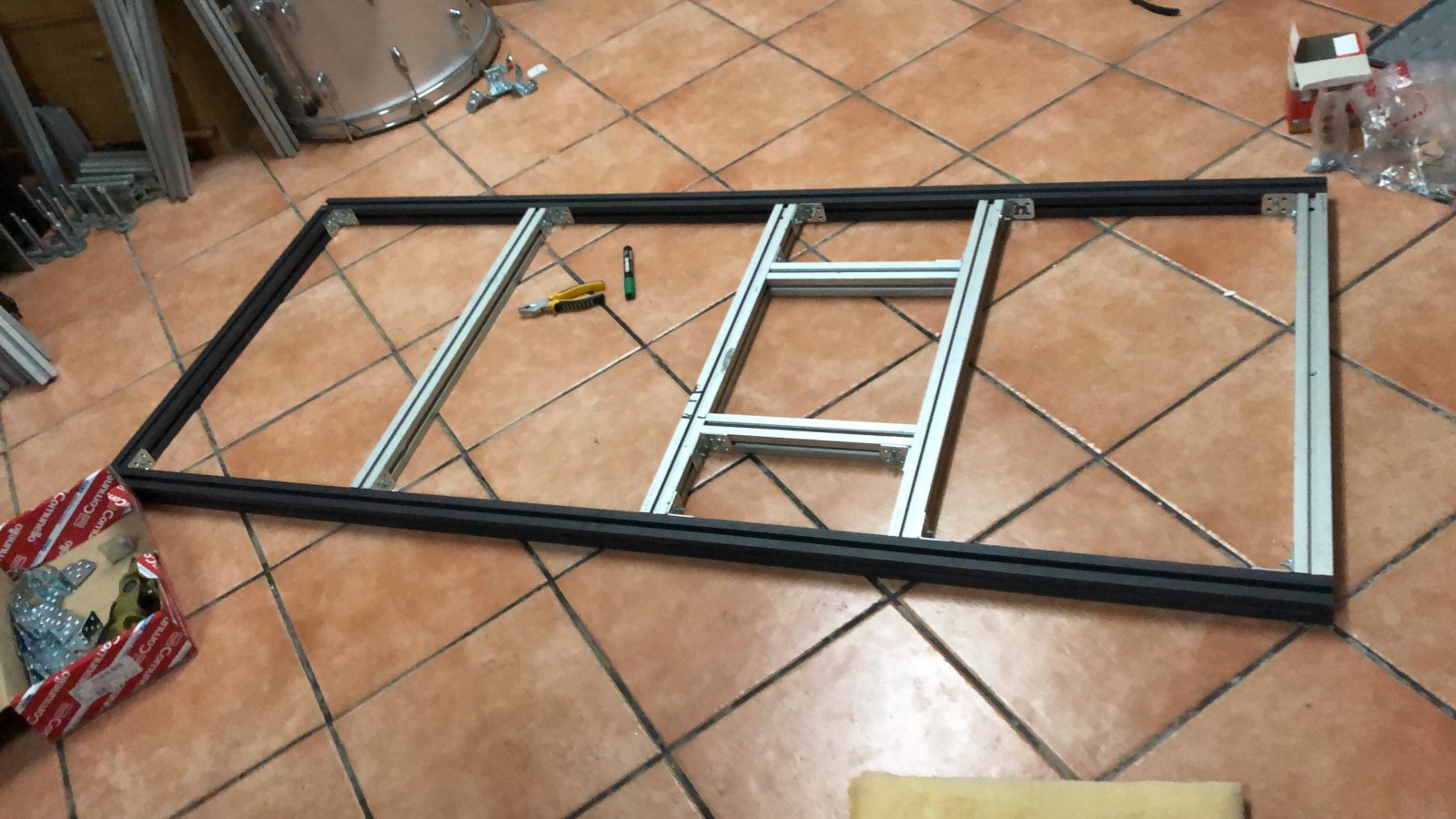

    I show you my 2dof project. It's not completed yet. It's my intention to update the thread with each improvement.

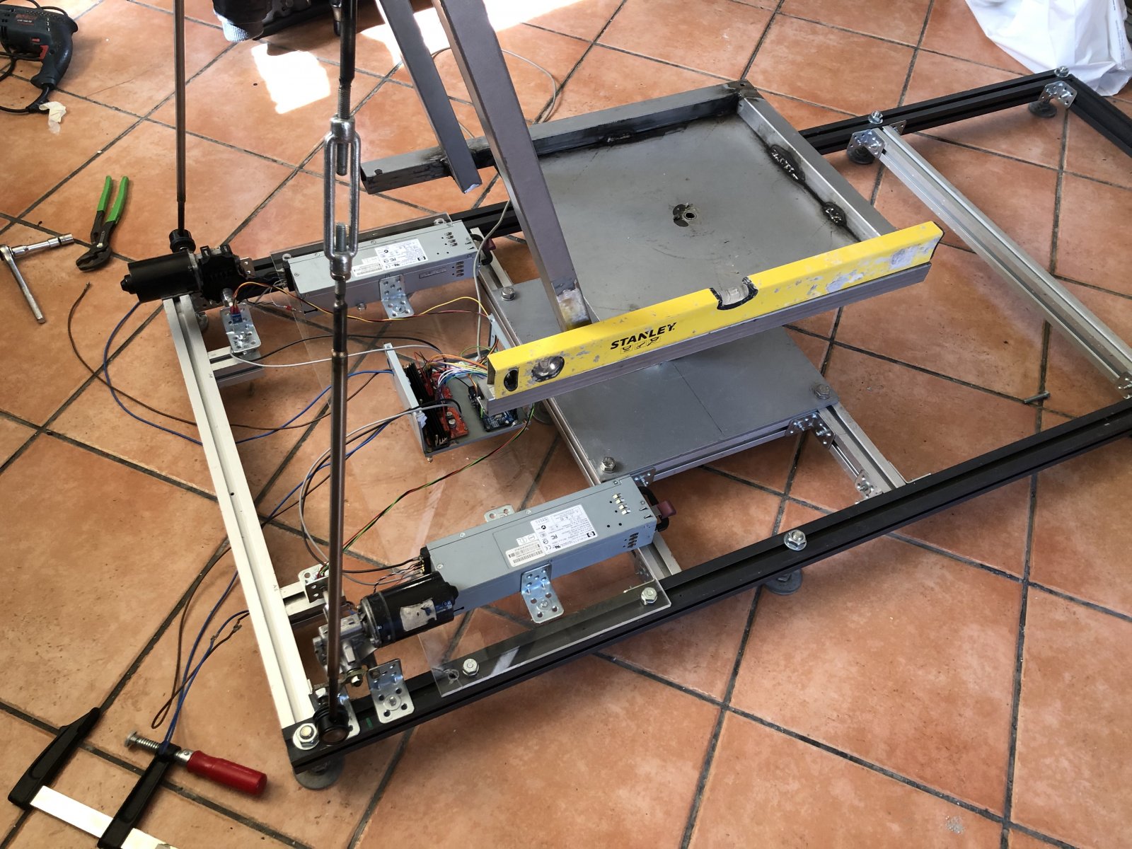

    MECHANIC PART

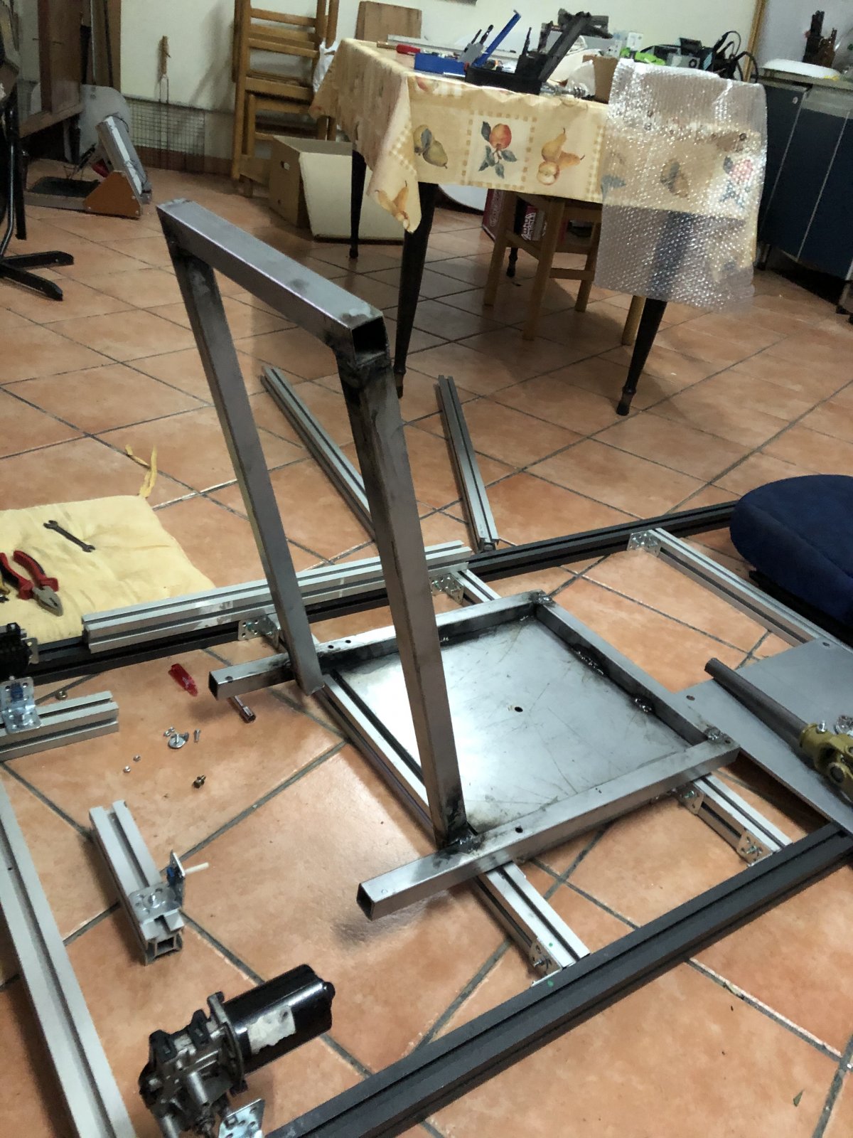

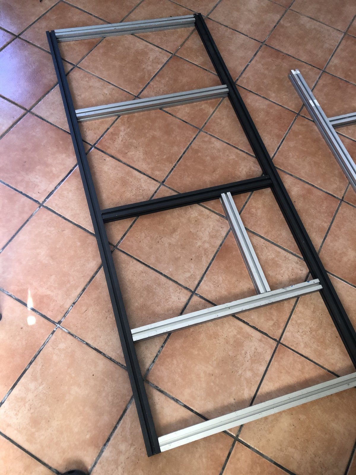

    I choosed to use aluminum profile for the base structure.
    The profiles are connected via L bracket.

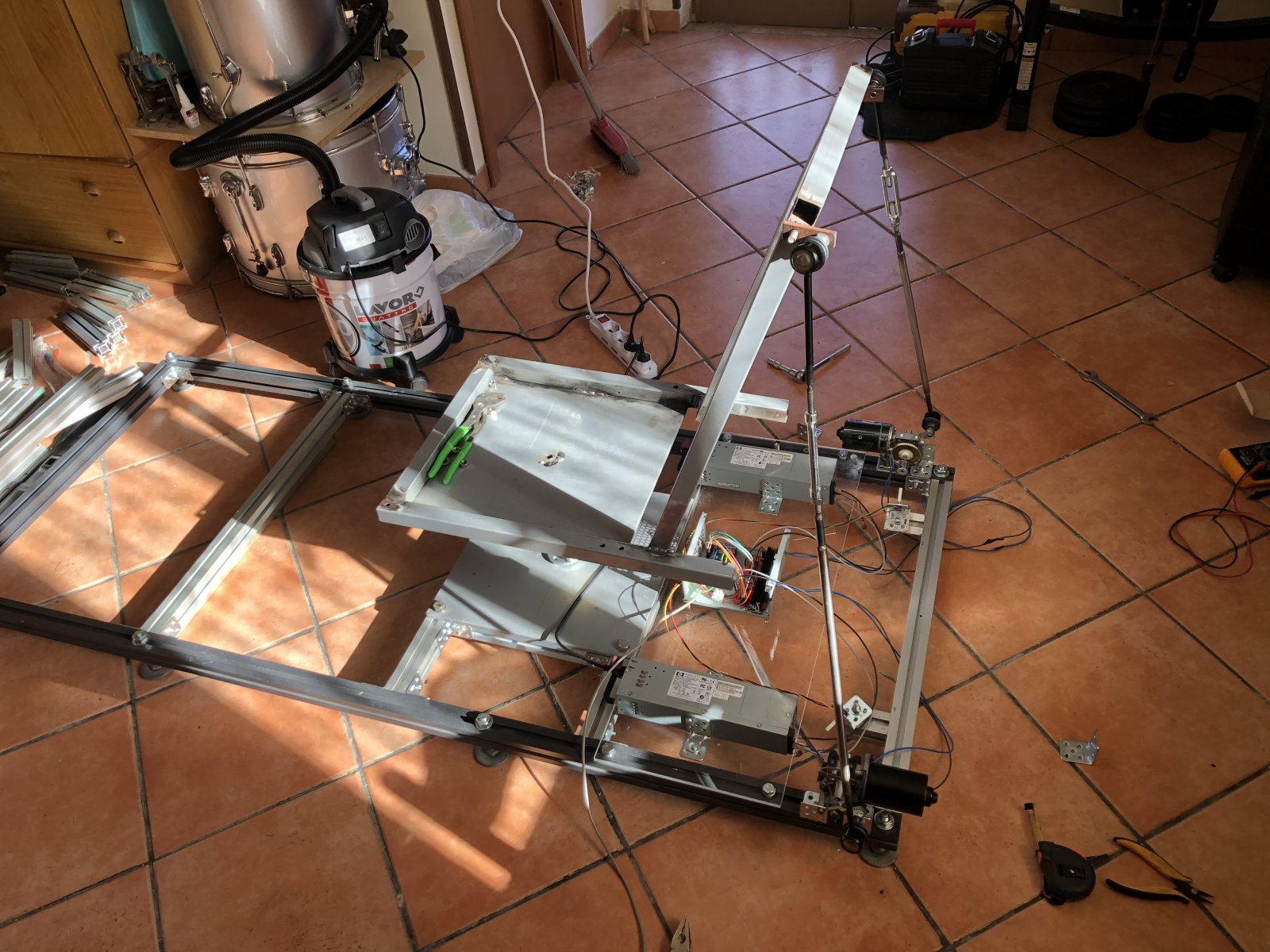

    The seat structure is build with 30x30 iron tubular.

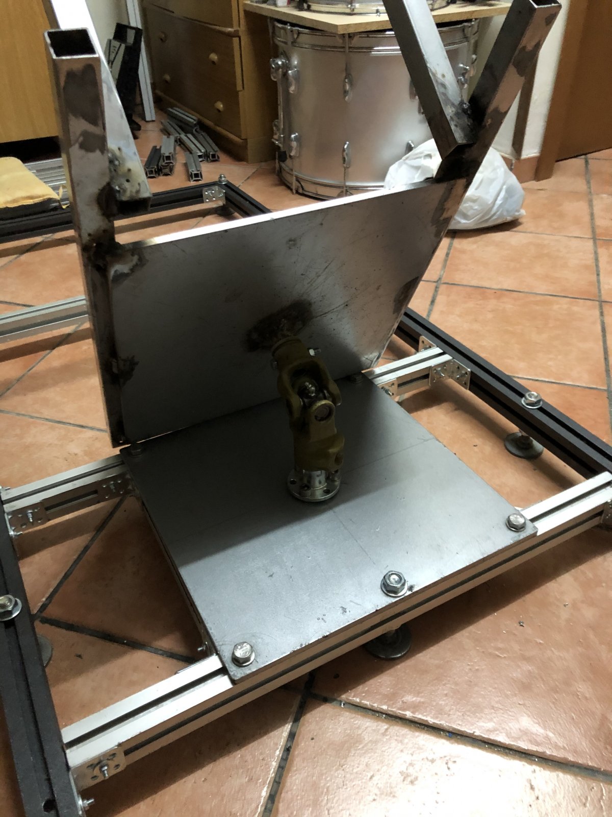

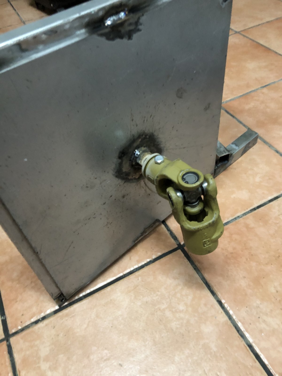

    The cardan joint

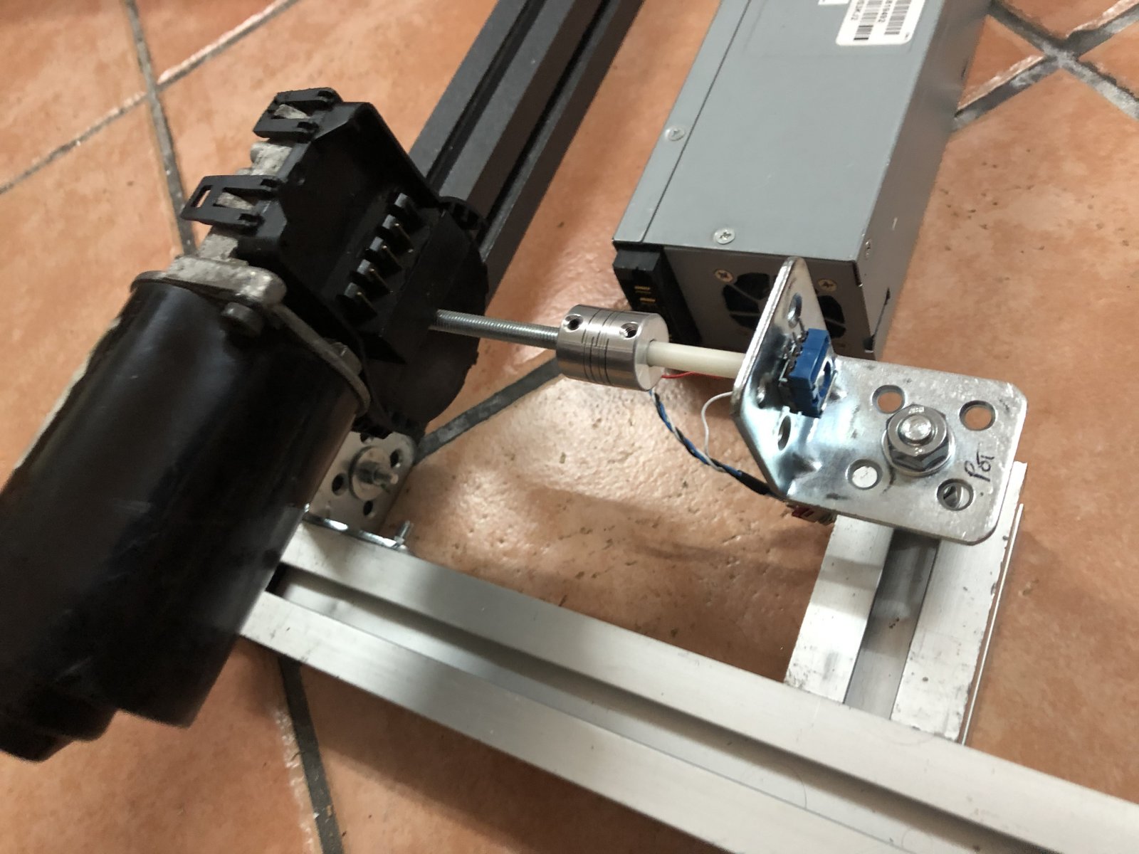

    Then I use 2 modified stabilizer bar link to connect the seat to the wiper motors

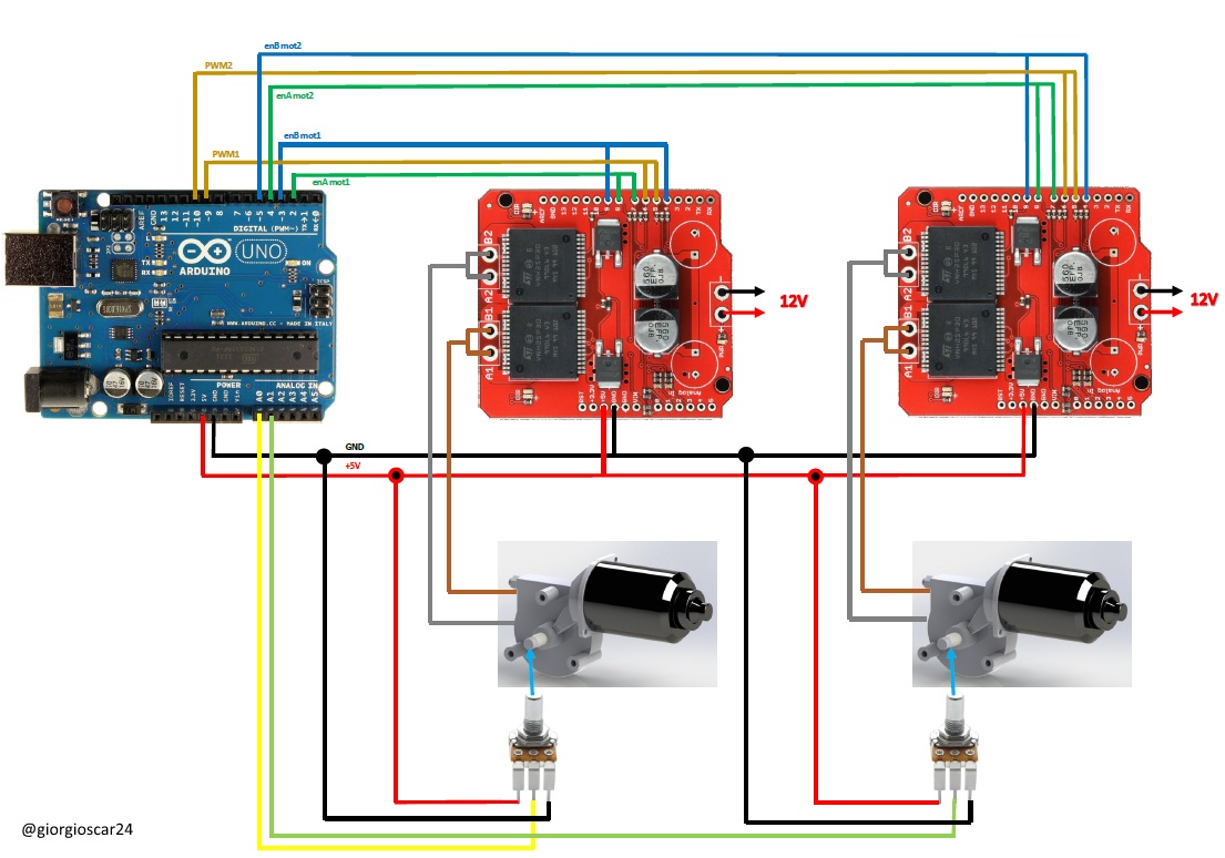

    ELECTRONIC PART
    I used the SMC3 guide of this forum.

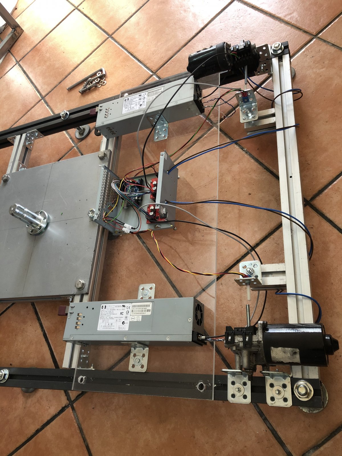

    The wiring:

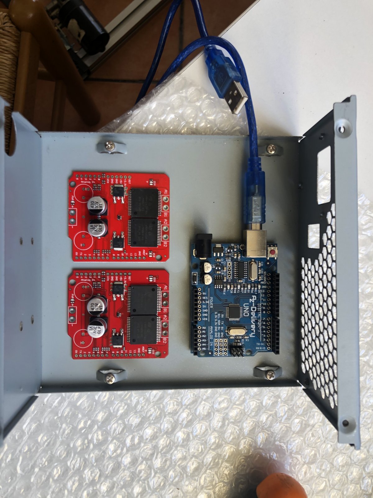

    The boards. I opted to use one MM each motor.
    I connected the pots with the shaft through a flexible coupler

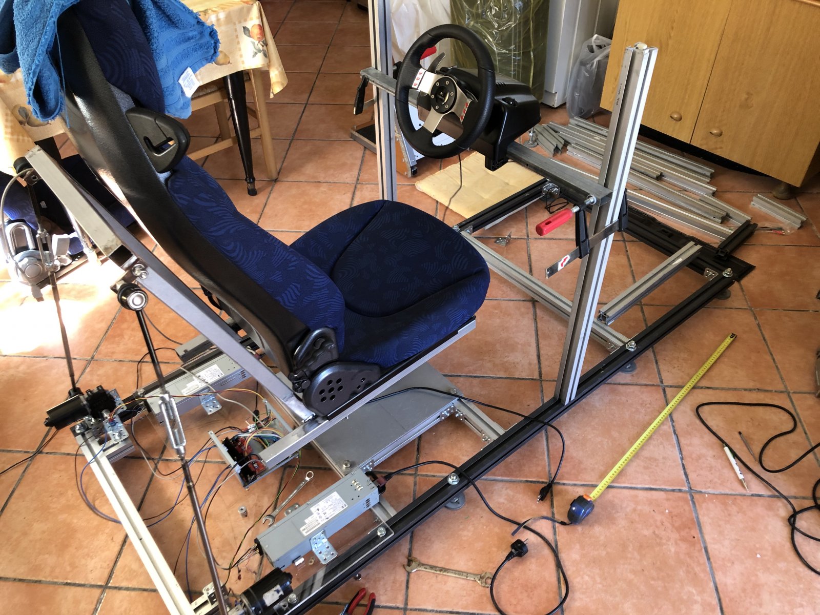

    Wheel base structure measurements

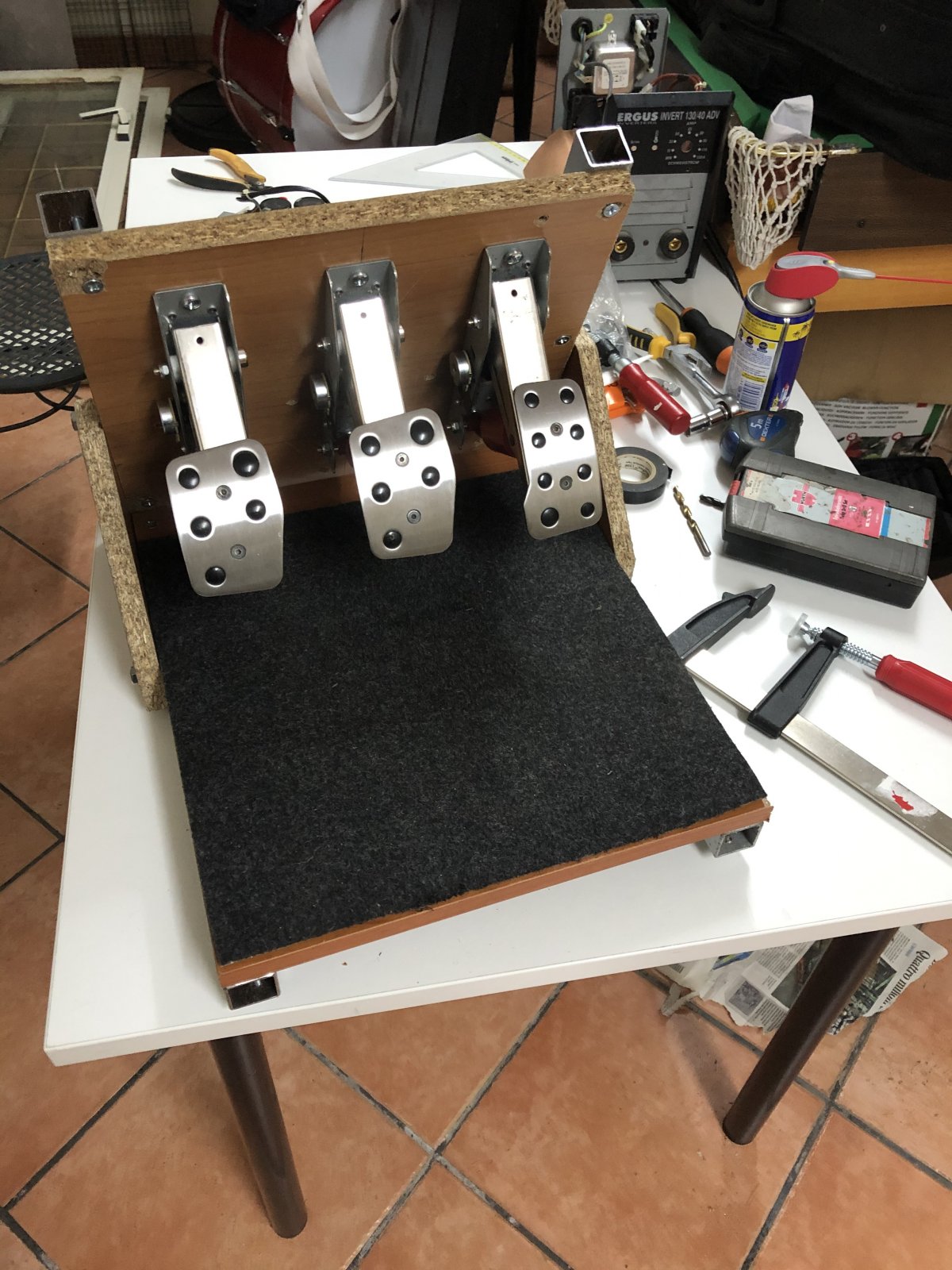

    Pedals with autobuilded structure
    Currently I'm continuing the building of the G27's structure. I'm using 40x40 tubular iron.
    The base will support the screen.

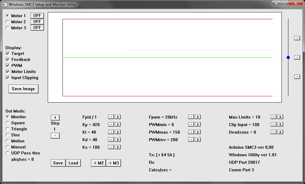

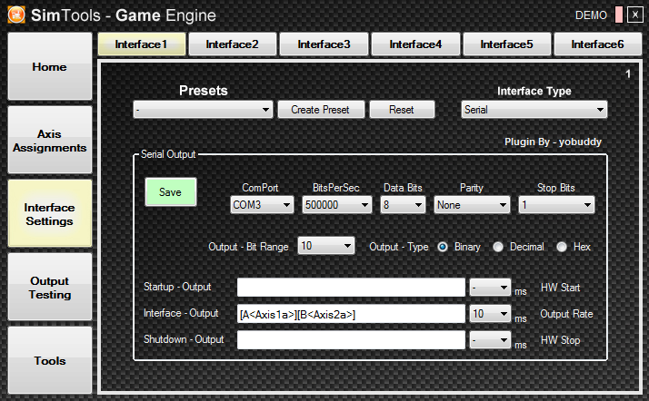

    CONFIG PART
    SMC3utils parameters

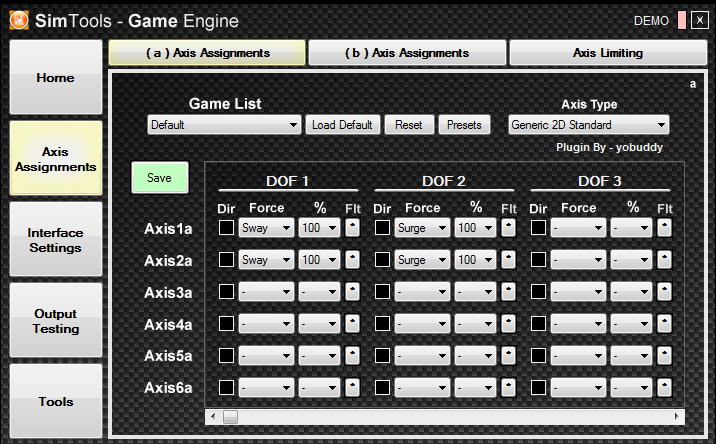

    simtools Interface settings
    Simtools Axis Assignments
    I tested the system with LFS and all work good but the fine adjustments are not completed yet.
    I hope to finish the total assembly before the end of the month.
