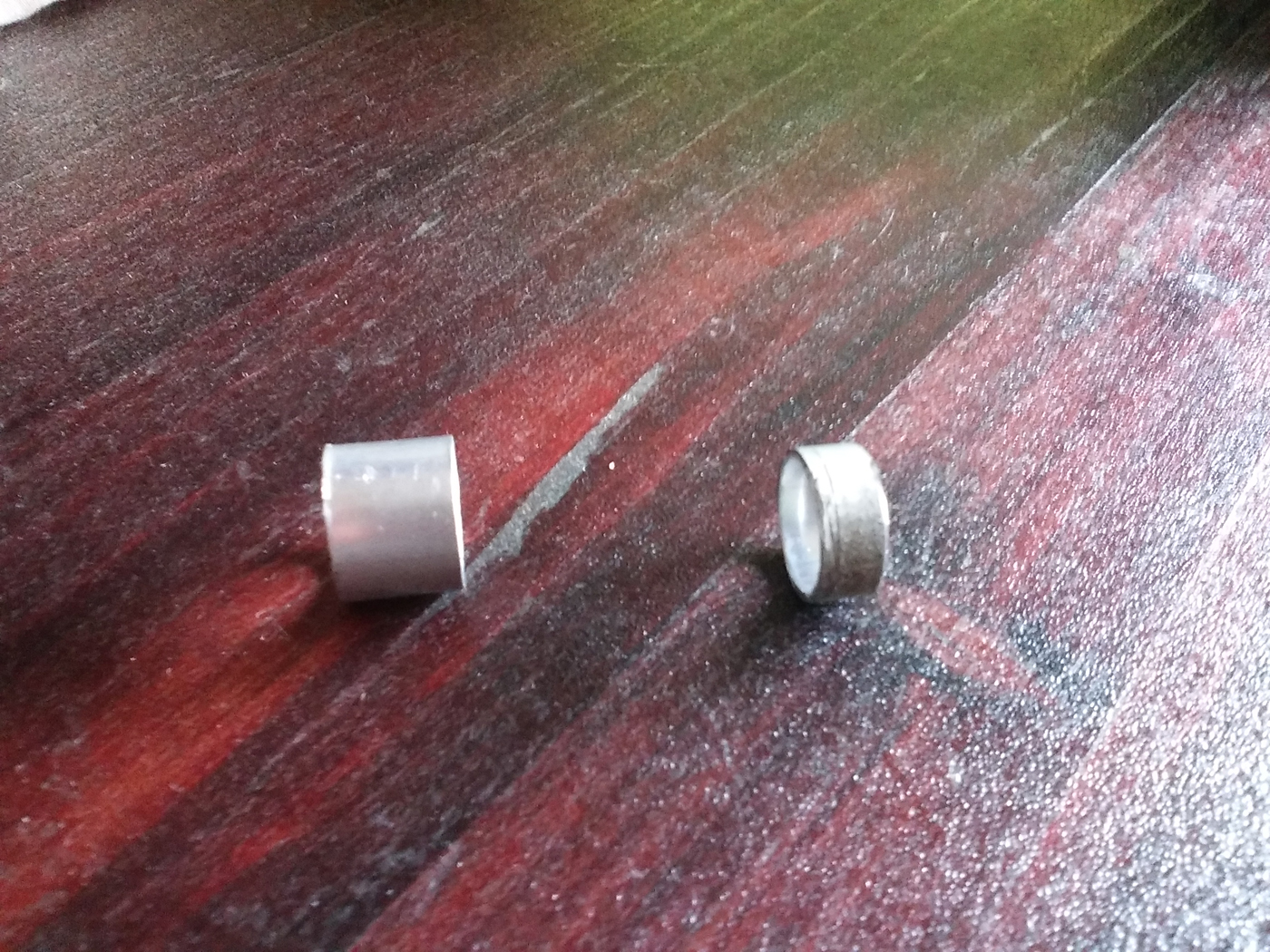

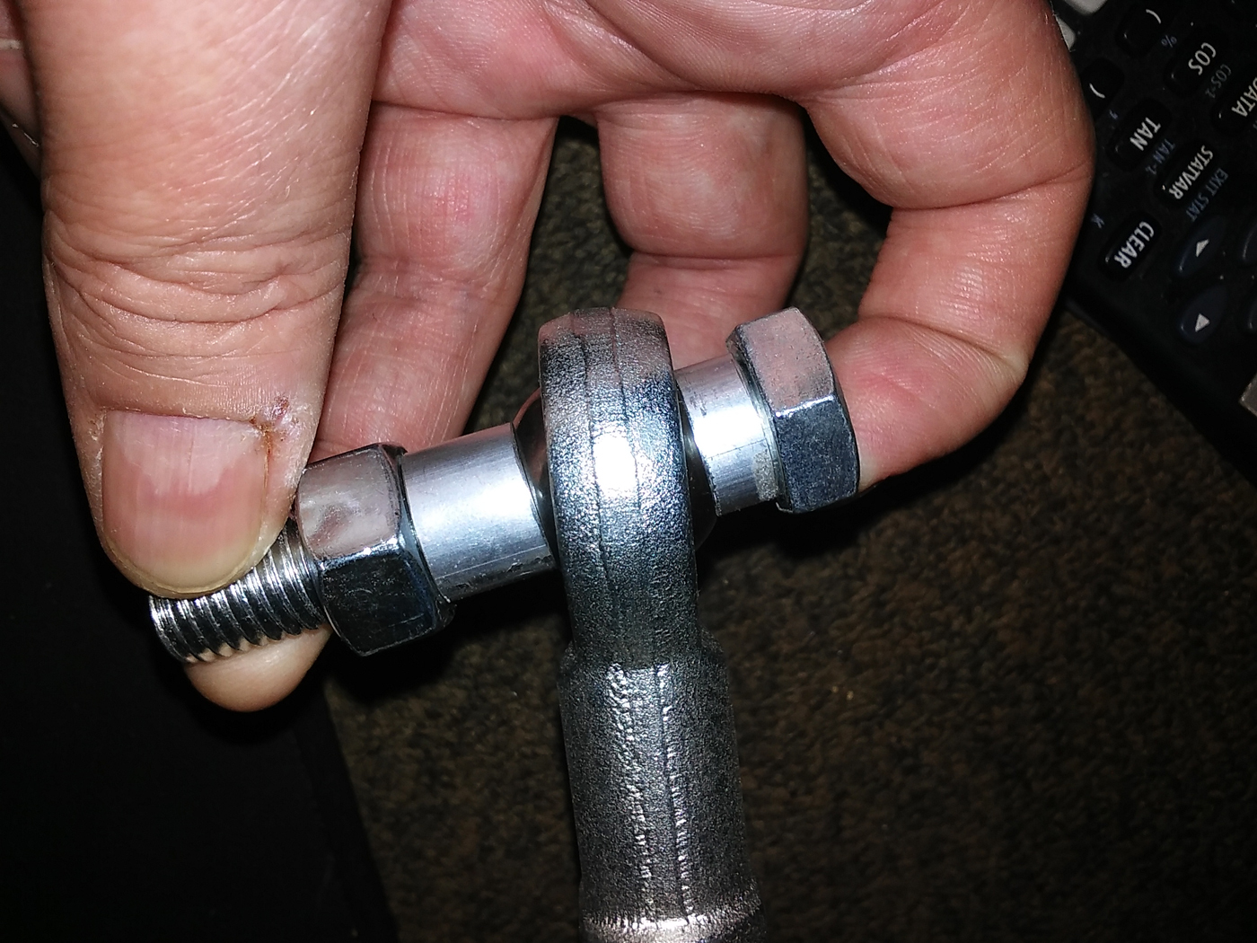

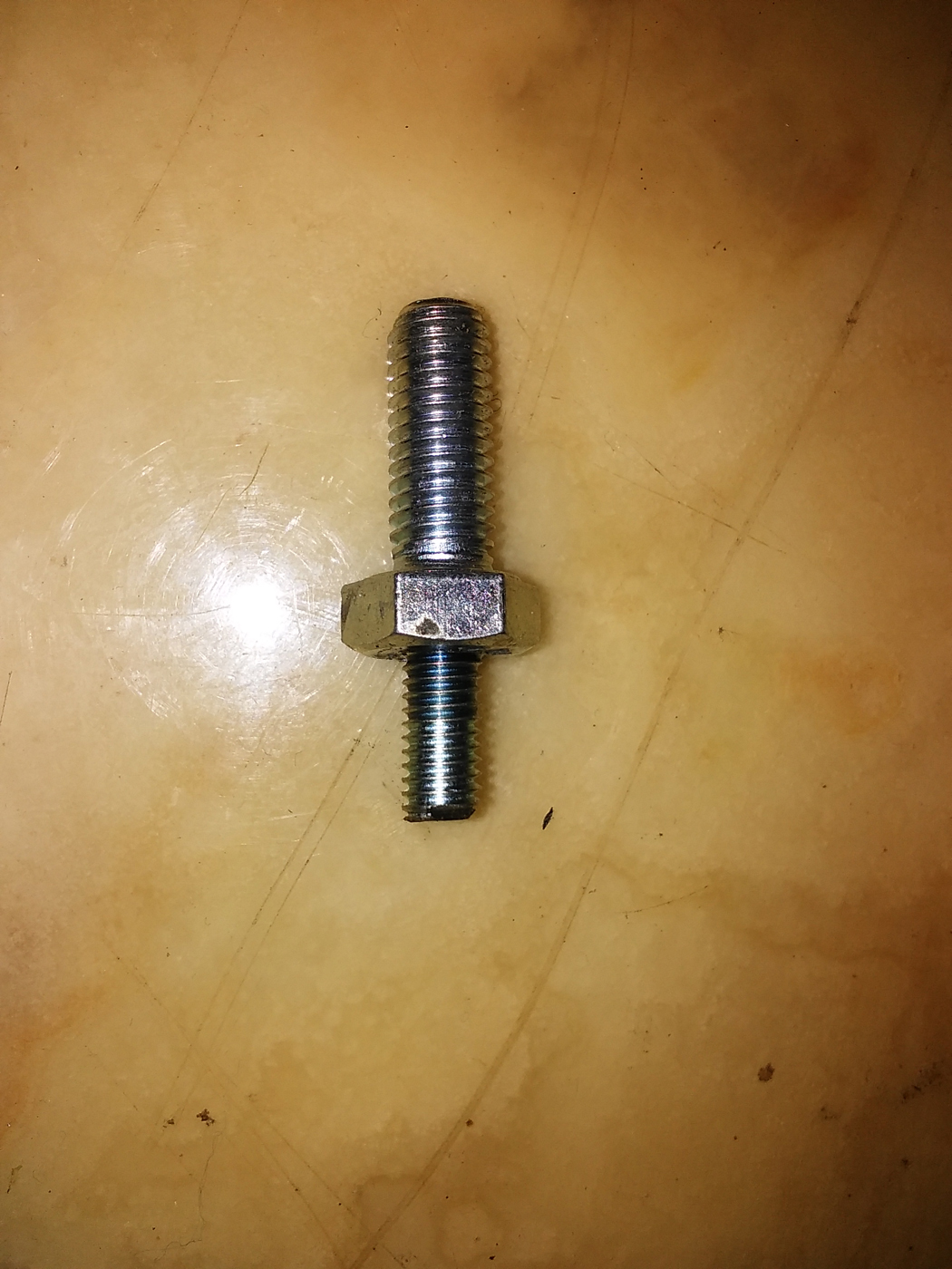

    For more freedom of movement of the rod ends I use spacers.

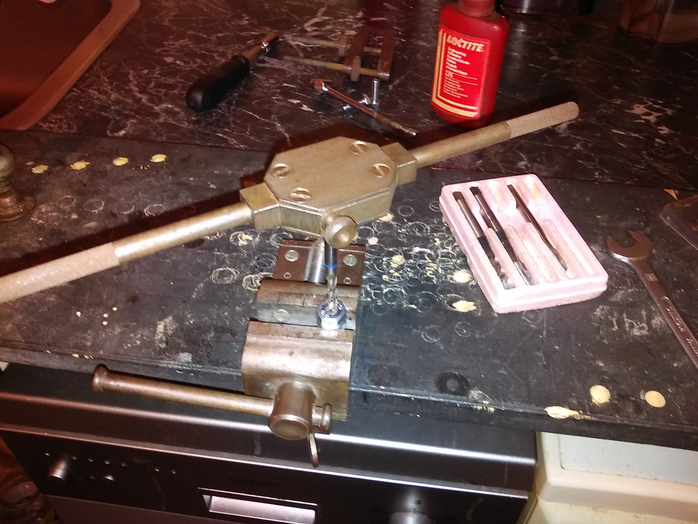

    I built a special screw for the lever to attach the pot to it.
    In addition I drilled a M6 thread into the head of an M8 screw.

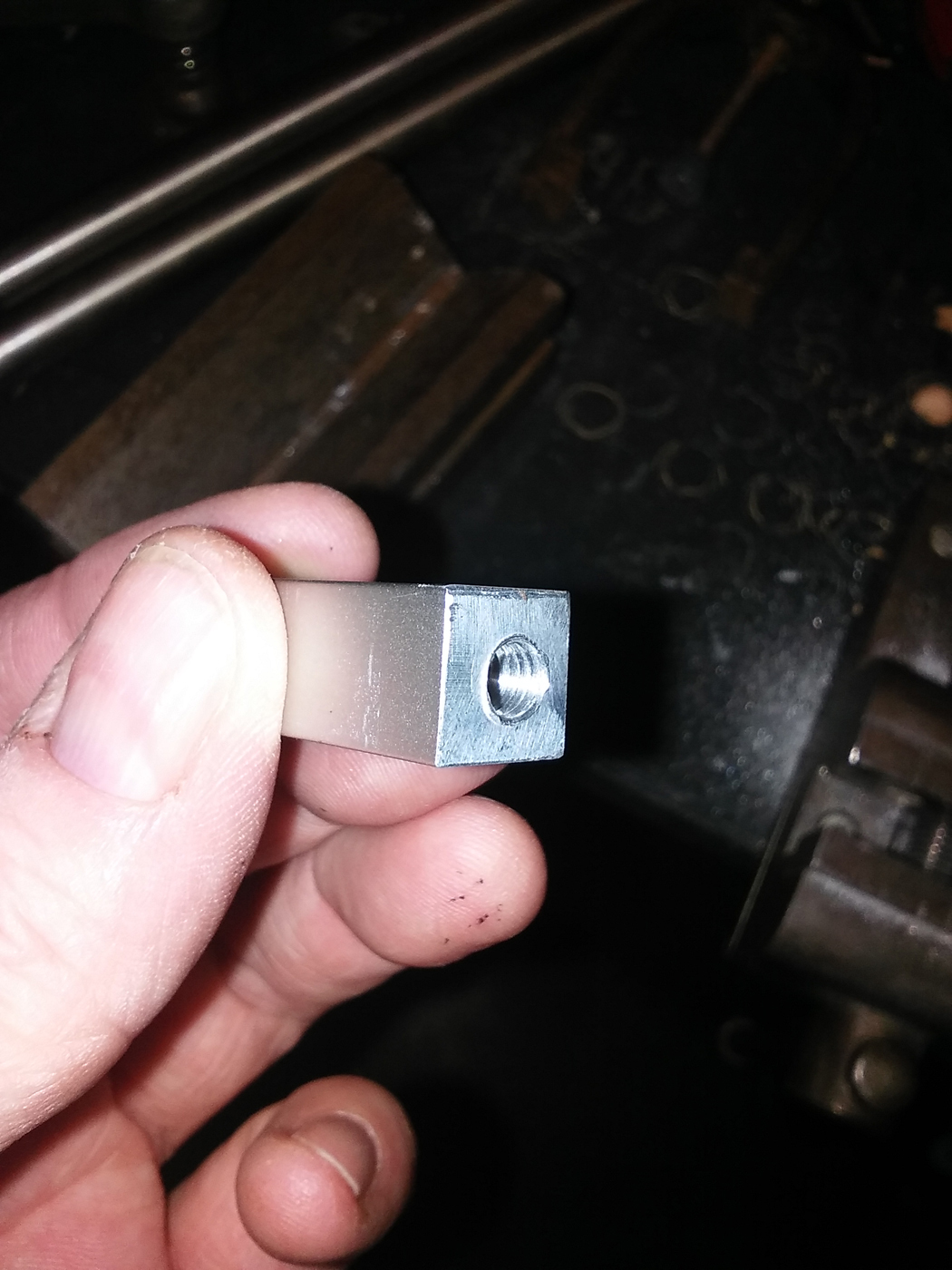

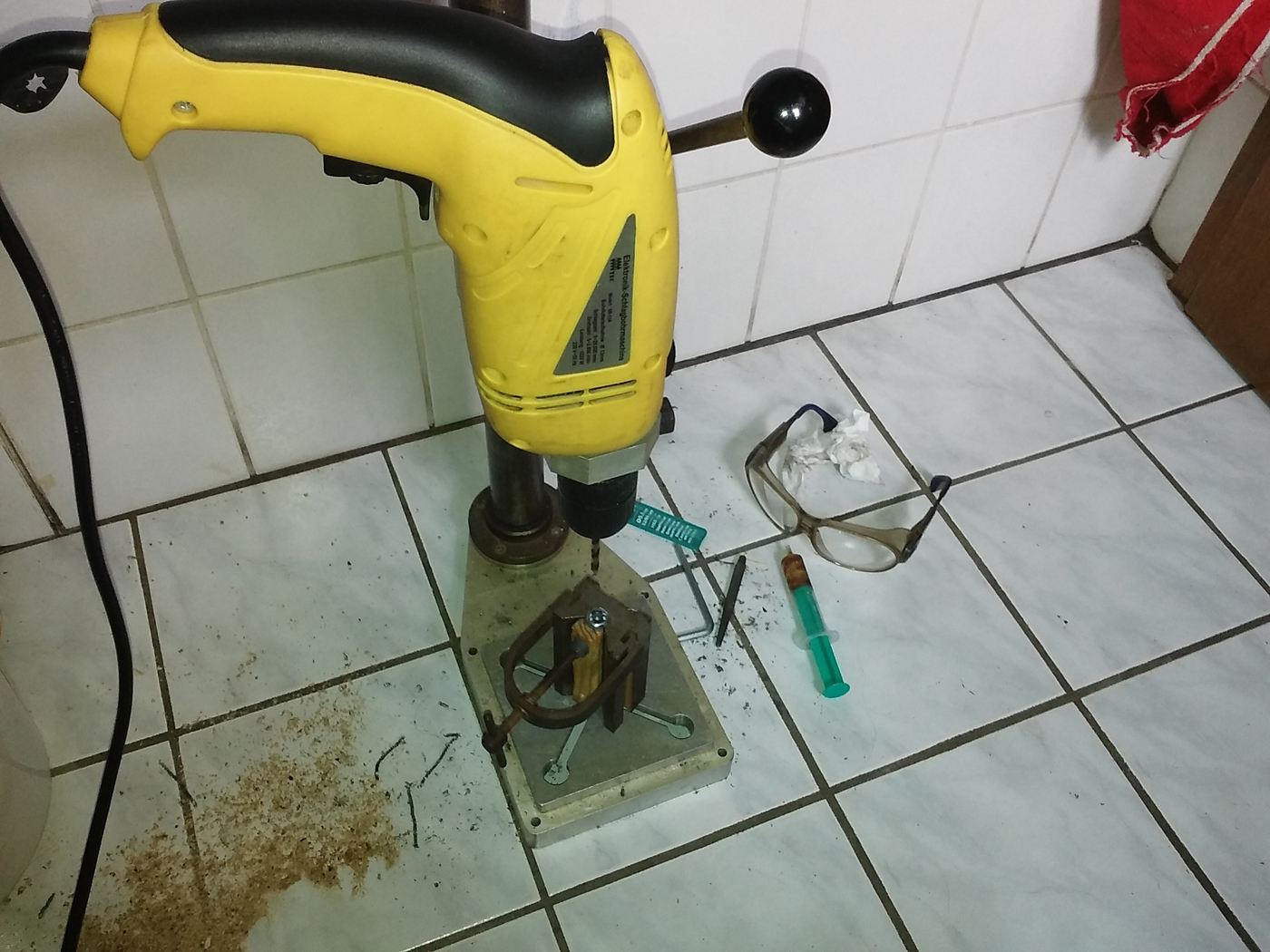

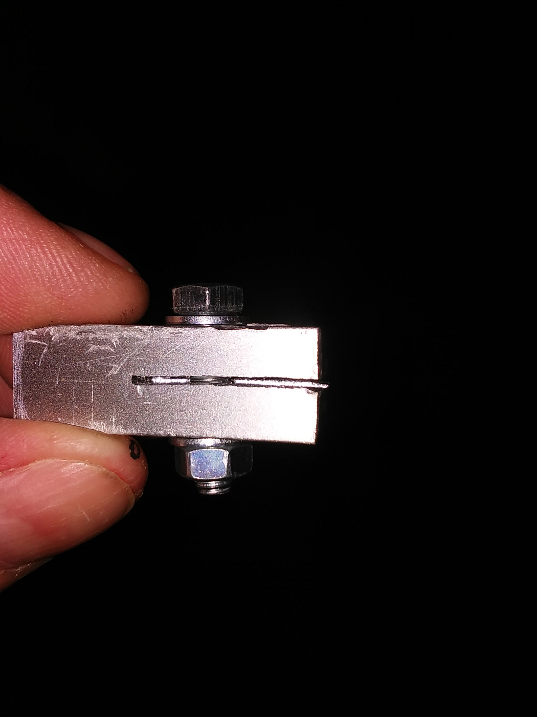

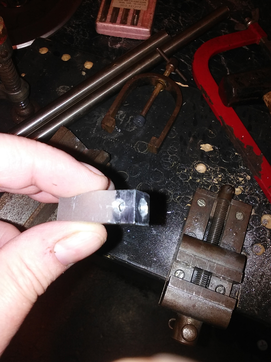

    Then I built the driver out of an aluminum square solid material.
    On the one hand I have a M6 thread drilled and on the other
    a 6 mm hole for the poti shaft.
    Drilled across a through hole for a screw and made a saw cut along.
    So I can squeeze the driver around the potentiometer shaft

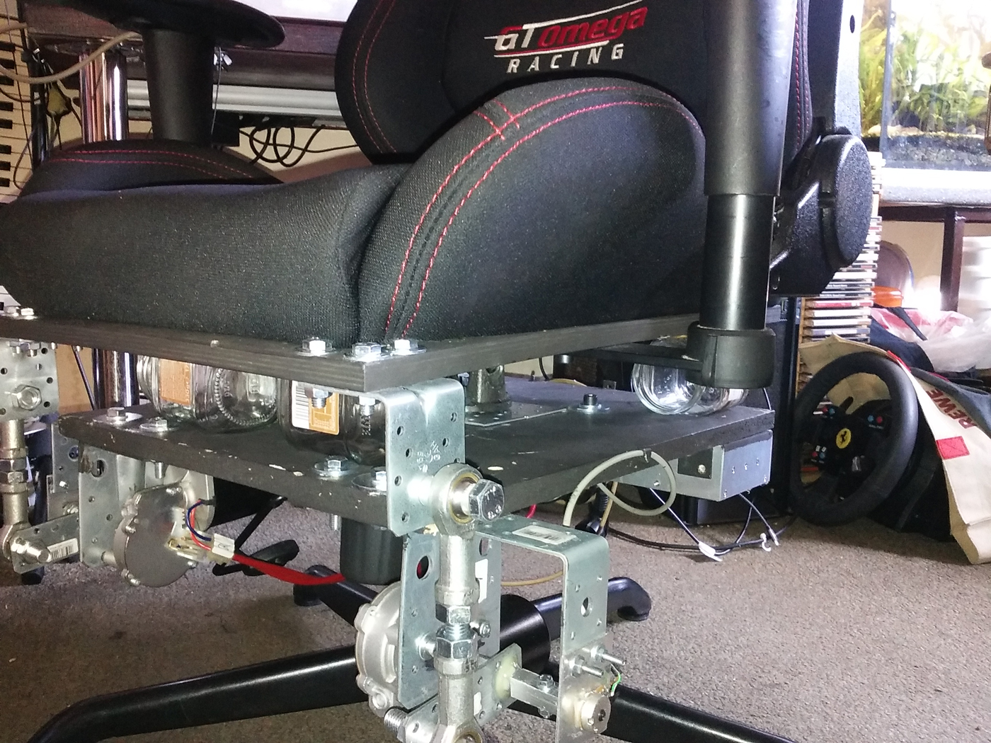

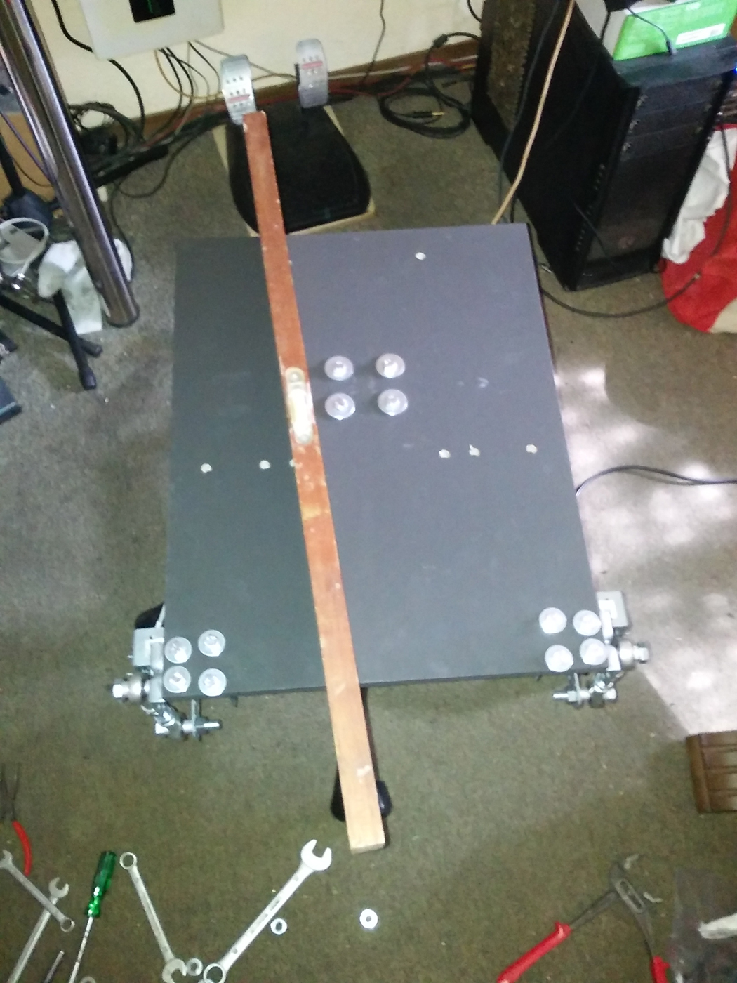

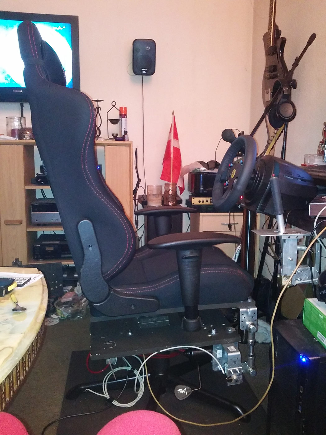

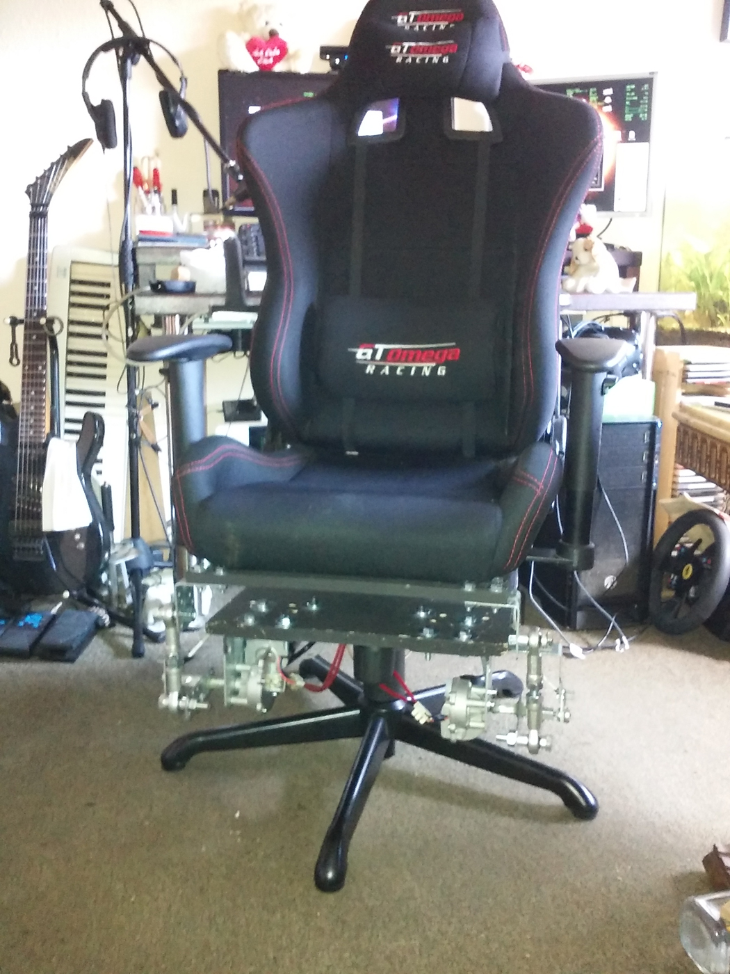

    After putting the motion module together and the positions for the brackets are ok for the moment,
    I added extra screws for better stability and then I placed and aligned the module on the turnstile.
    Then I removed the casterwheels from the turnstile, put it on a plate with a hole for the gas spring
    and mounted the seat.
    After taking seat for a while, I found that the whole thing was a bit too high for me.
    In addition, the chair with the large plate underneath is very difficult to move.
    So I removed the two spacer plates under the universal joint and replaced them with metal sheets.

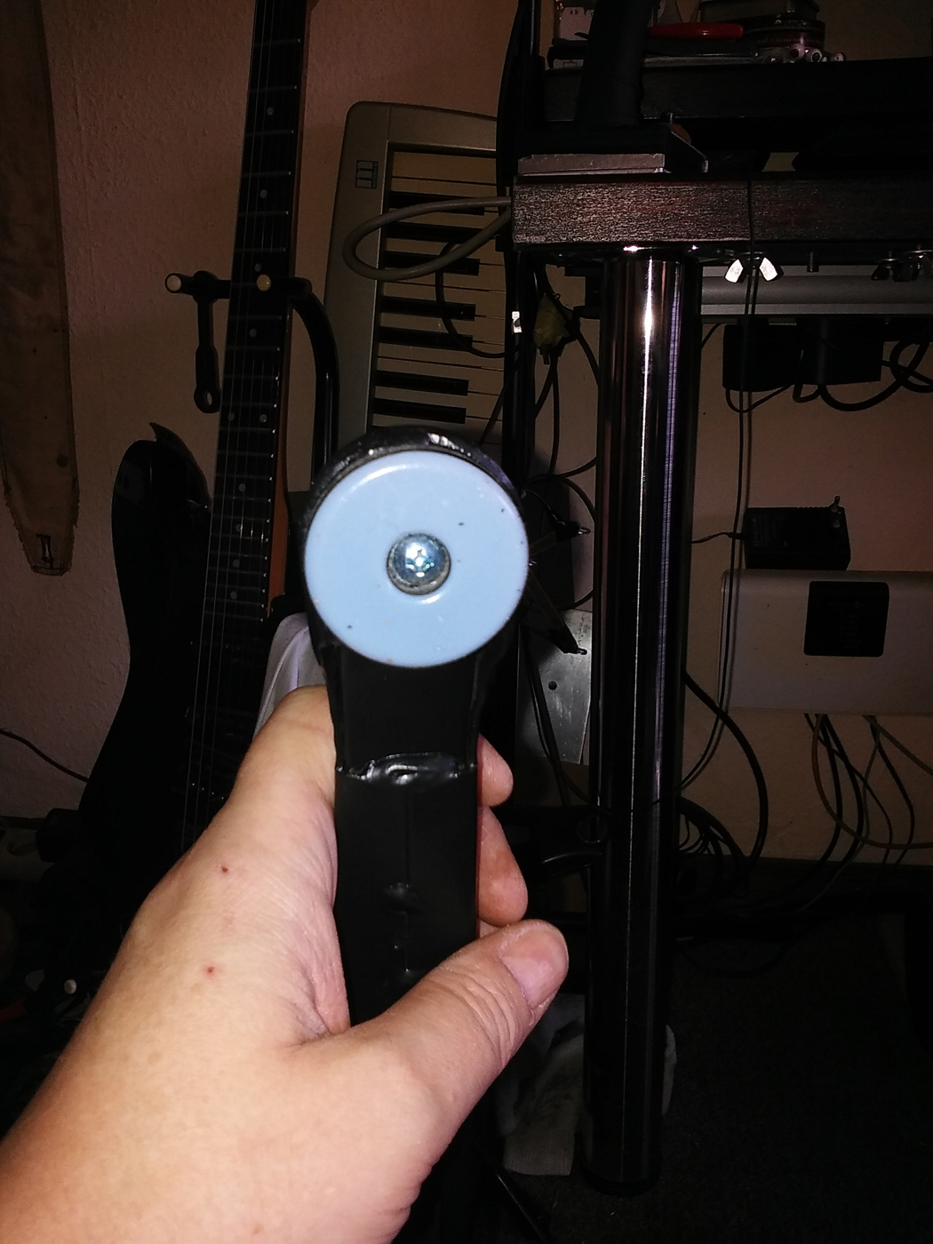

    In order to be able to move the chair better, I have removed the plate again
    and instead used sliding feet in the holders for the casterwheels.
    So I can move it better now.:thumbs

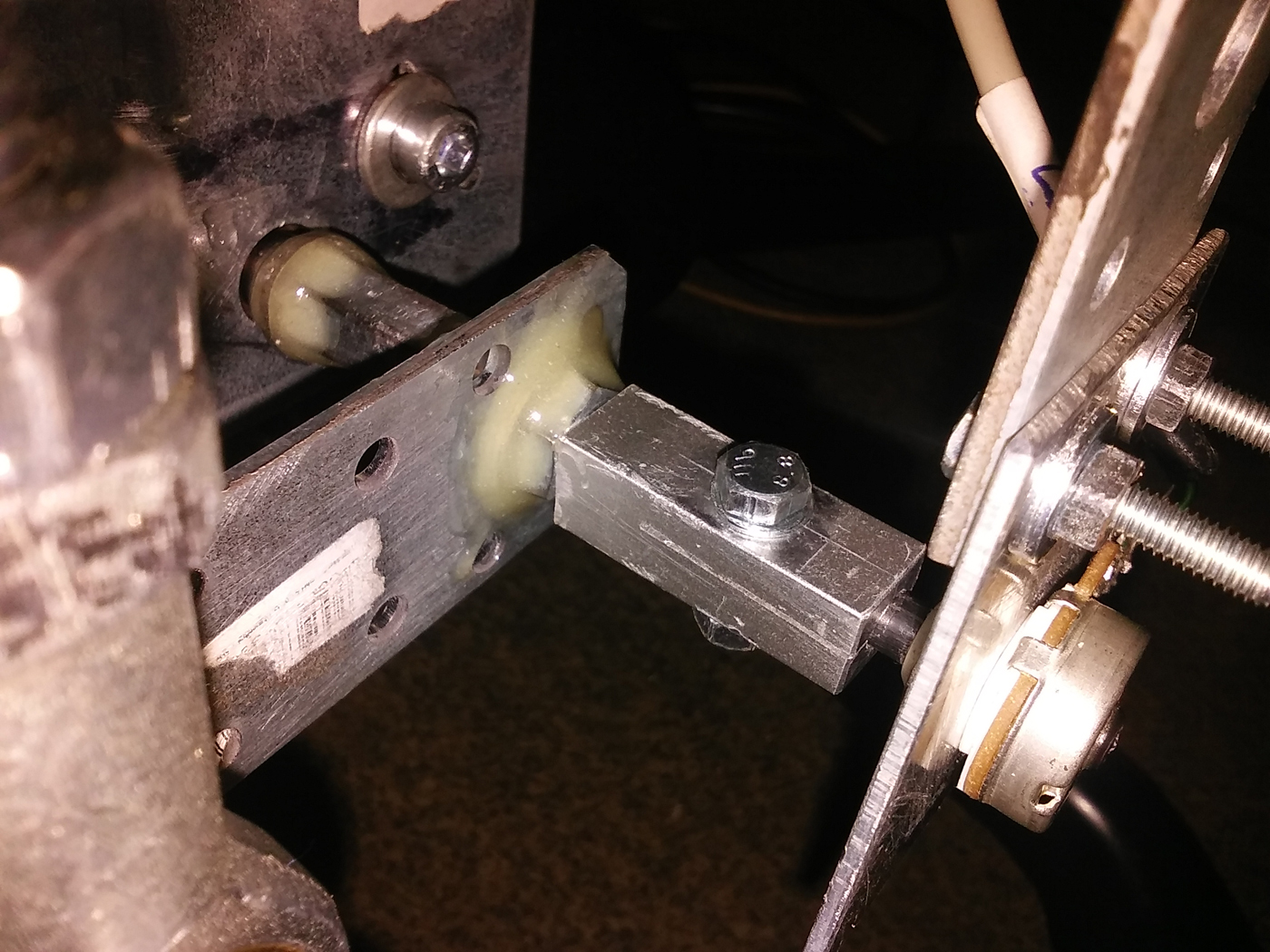

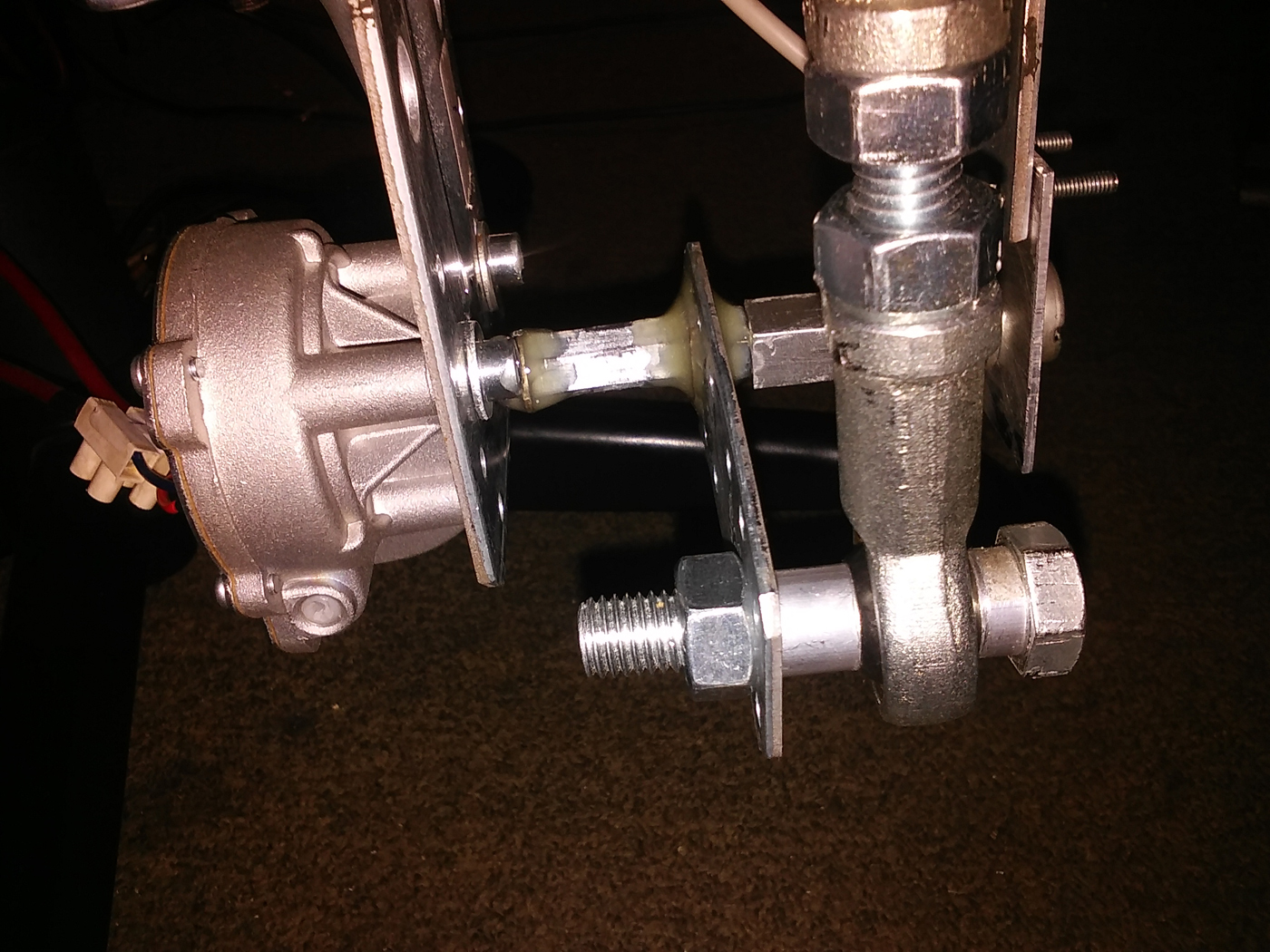

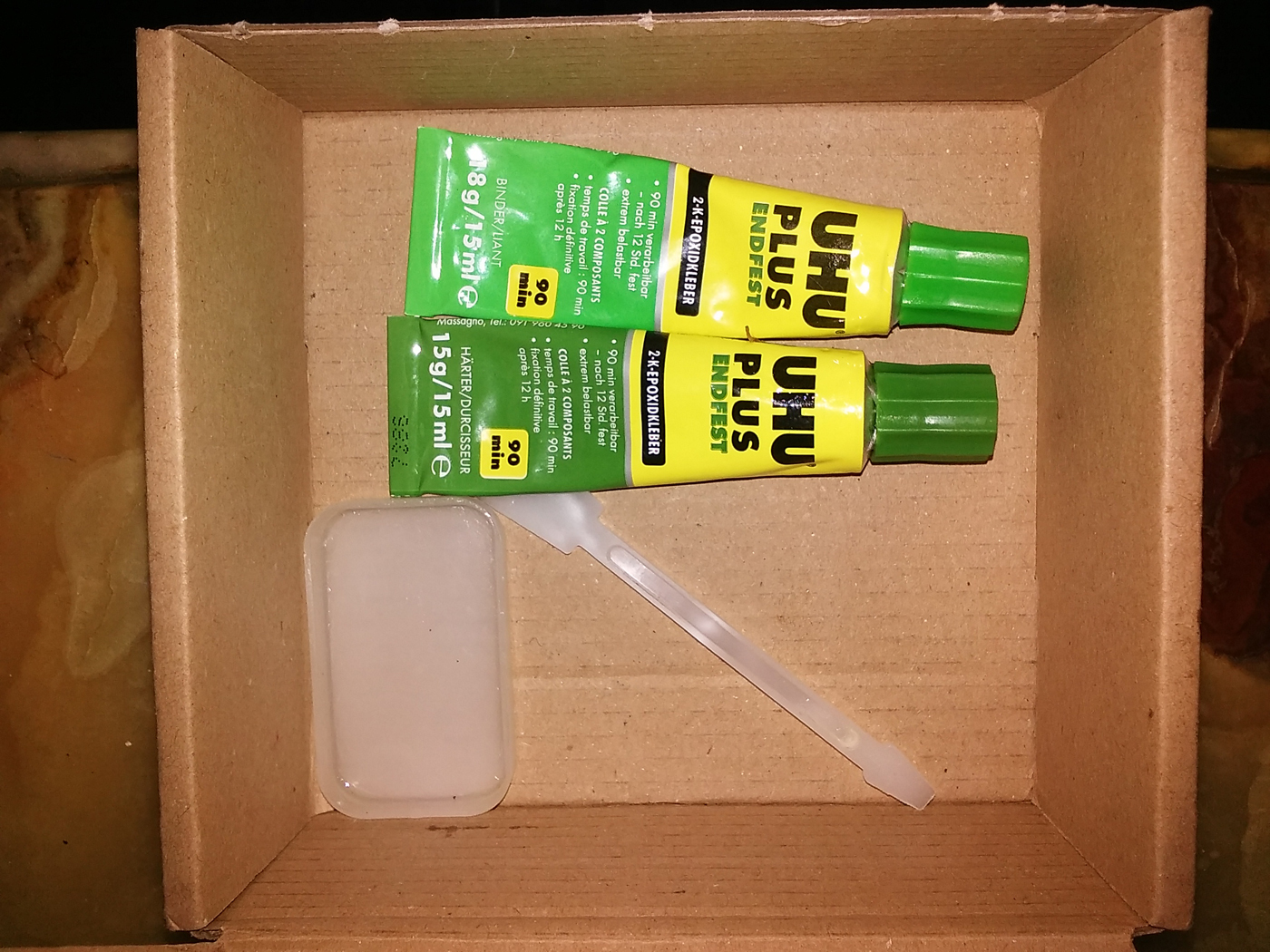

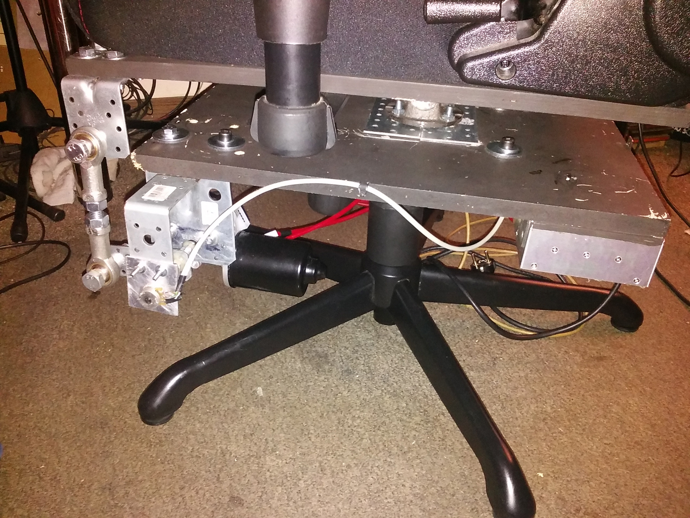

    Unfortunately, I can not weld because I can no longer work as a mechanic
    and I do not know anyone who has a welder. So I glued everything to
    a strong two-component glue.
    I filled the threaded sleeve with the glue and then screwed it onto the motor shaft
    and screwed on the lever. Then, from the outside, I gradually applied several layers
    of the glue and allowed to harden.
    Unfortunately, because the gears are not self-locking, I still have to think of a way
    to fix if I just want to sit.
    At the moment I put glasses under it. :grin
    So the trial version is now ready for the first ride.:cheers
