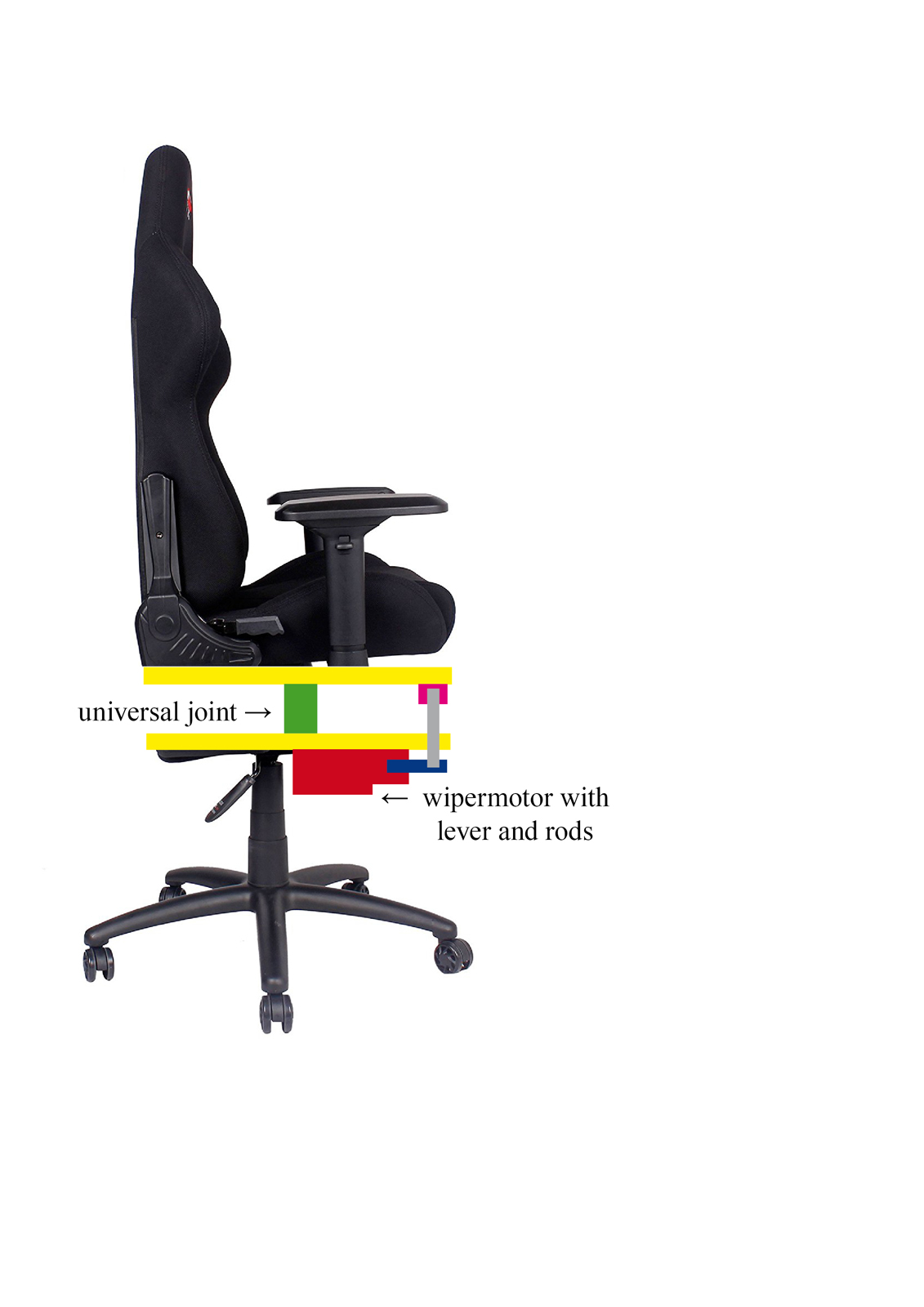

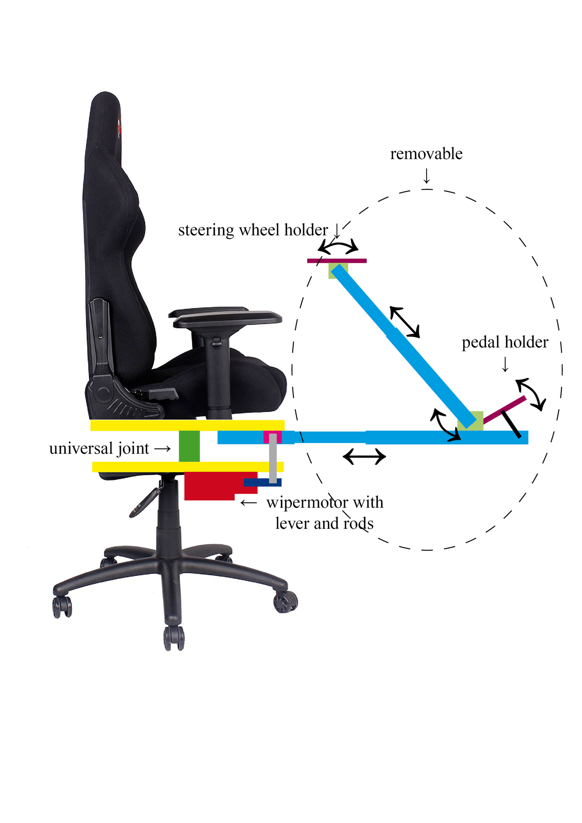

    At first i want to built it like that.
    But first a simple version for further testing than upgrade it with better materials.
    After that i want to upgrade it to this version.
    And maybe in the future i want to add a yaw axis.

    Thank you for the tip i will keep that in mind. The problem is i have to built it
    compact because of less room space. I already have the wipermotors
    so i try them first. When that doesnt´t work i will buy bigger ones.

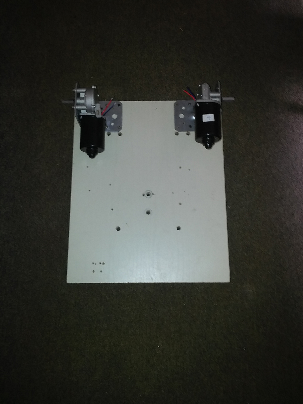

    Thank you, but i already have everything i need. At this time i built the motion module
    with mdf plate i found at home and some parts from the hardware store. When everything is
    as i want it to be i will upgrade it with other materials.

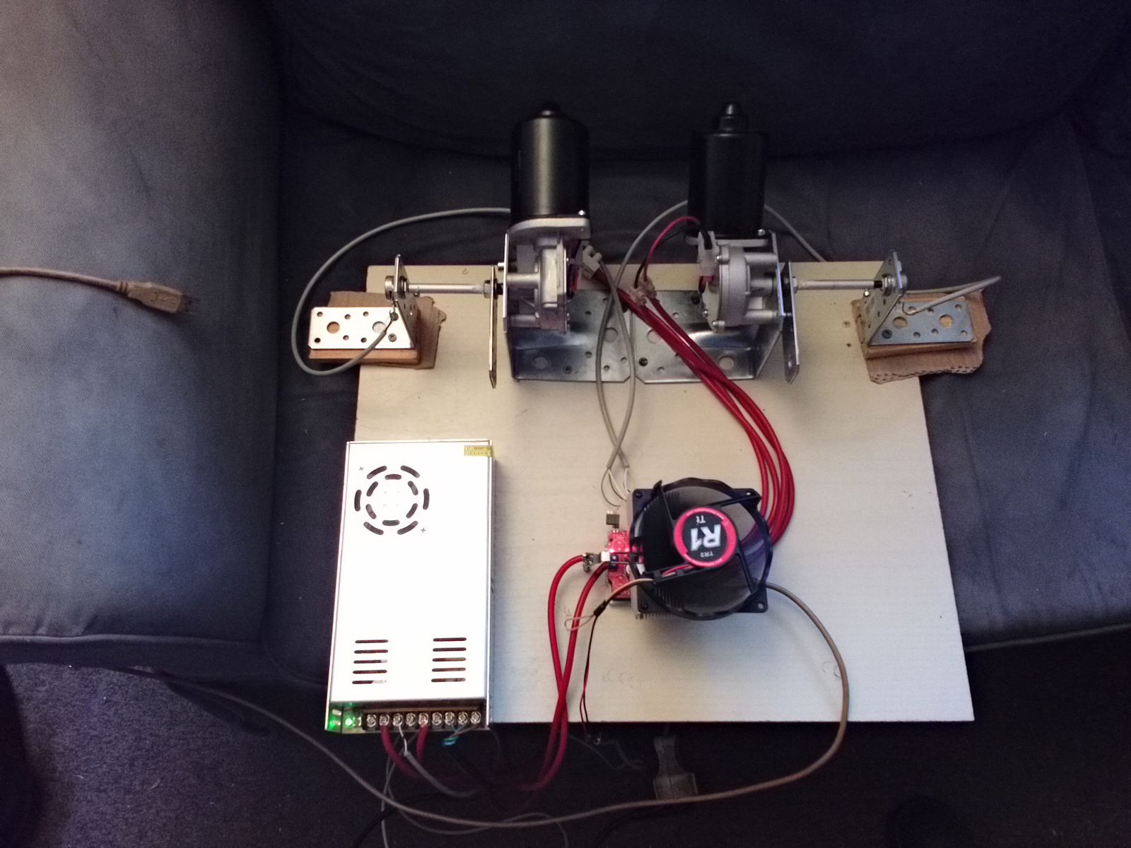

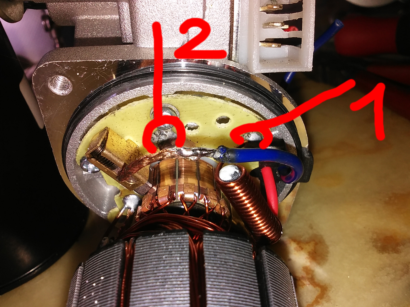

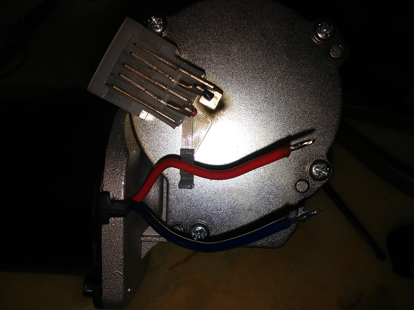

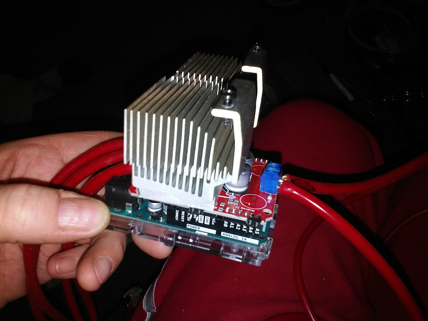

    I have bought an original arduino board and a monster moto shield clone.
    It seems to be okay. Could not measure it because my multimeter
    is broken. And i use a 12V 360W 30A power supply.
    First i choose to stack the two cards. Maybe i will wire it in a later version.
    For the cooling, I take an old boxed fan for AM3 socket and sawed
    through the cooling fins, so that it fits.
    I also ground isolate the Motors.
    I knew the blue cabel is for low speed so i cut it from position 1
    and i cut the ground from position 2 and soldered them together.
    So i have only 2 cables coming out of the motor.

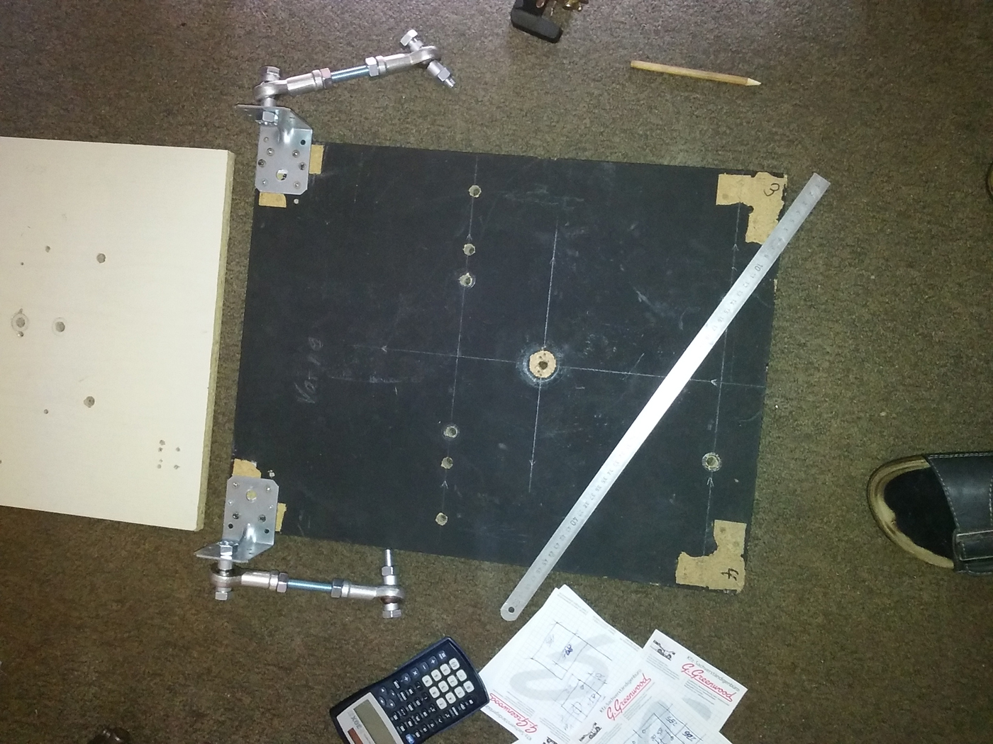

    And i have build a plate for the motors and electronics
    and one for the seat.
    Now i still waiting for the u-joint parts to arrive.

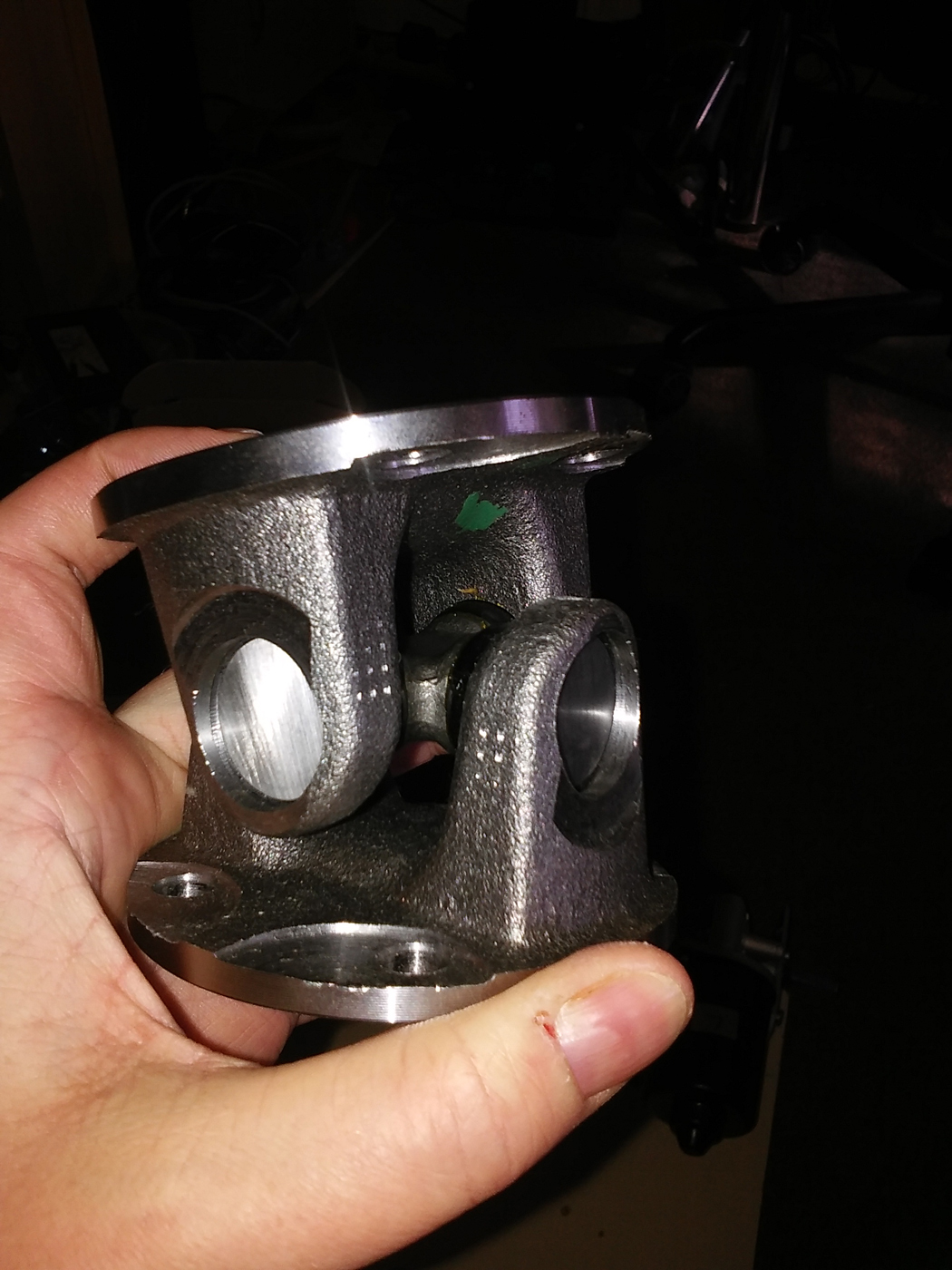

    The universal joint parts arrived today. :)

    do you mind sharing the links for the u joint you bought.
