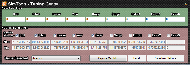

    iRacing works too :grin:grin:grin
    Setting the settings is 'interesting'!
    How do these look?

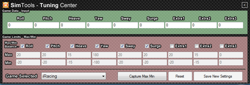

    Just to be sure I understood what you mean @noorbeast : you recommend to lower the Max/min value in order to lower % from each DOF to get 100-120% for all the DOF for one axis ? Very interesting !
    By doing that you will reduce the data range and big movements will be shaped ?
    When I start a new profile, I try each force one by one and I try to find the perfect value and then I lower from 10-20% to mix all effects. I am more than 100% for sure !
    This evening, I'll try your method and see if I can feel a difference.
    21,494
    150,584Coins
    +11,017 / 55 / -2
    It is a bit of a balancing act. As @eaorobbie explains "motion cue is lost because it pasts 100% of the Axis Total Movements".
    There are both design element that can affect allocations, for example a compact sim has more possible pitch percentage than roll, plus there can be a degree of cancellation between forces allocated to one axis.
    It would seem to be that problems start to really kick in if the total is 130+%, but best to get as close to 100% total axis allocation as possible.
    You can fine tune the effect in the Tuning Center. For some forces, such as heave, it is not unusual to have a setting less then 1 and in some of mine heave is 0.2- 0.5. I think the smallest possible Tuning Center setting is 0.001.

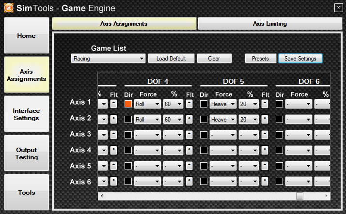

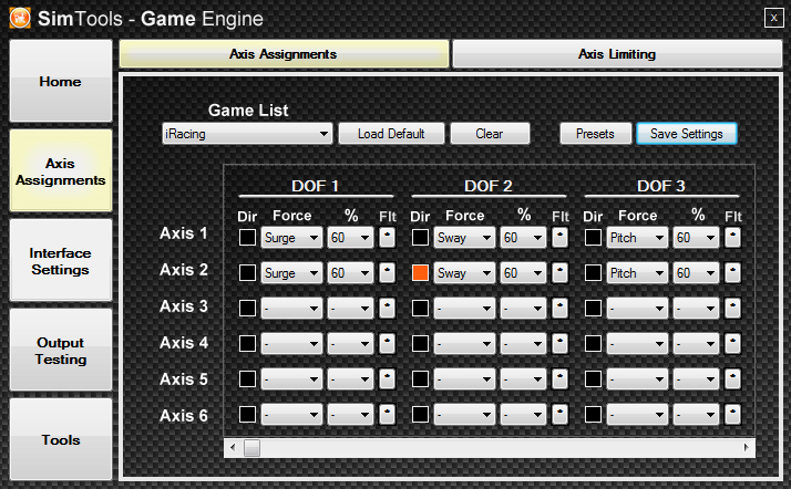

    Mine is improving, nearly threw me off the chair!
    However my pitch and roll are the wrong way round.
    When I accelerate the chair leans right, braking leans to the left.
    Also turning right pitches it forward and turning left pitches it back.
    Is there an obvious thing I did wrong? ( I only have Roll, Pitch and Surge set at the moment)
  14. Wanegain
    Wanegain Active Member
    Nov 6, 2013
    564
    Bruxelles
    1,997Coins
    +300 / 2 / -0
    If it leans right when you accelerate, it means your left motor is going up instead of down. Just clic on Dir next the surge DOF for your left motor (Axis1 I guess ?).
    If it pitches forward when turning right it means your left motor is going up instead of down. Clic on Dir next the sway DOF for your left motor.
    Edit : don't forget to Save settings...
