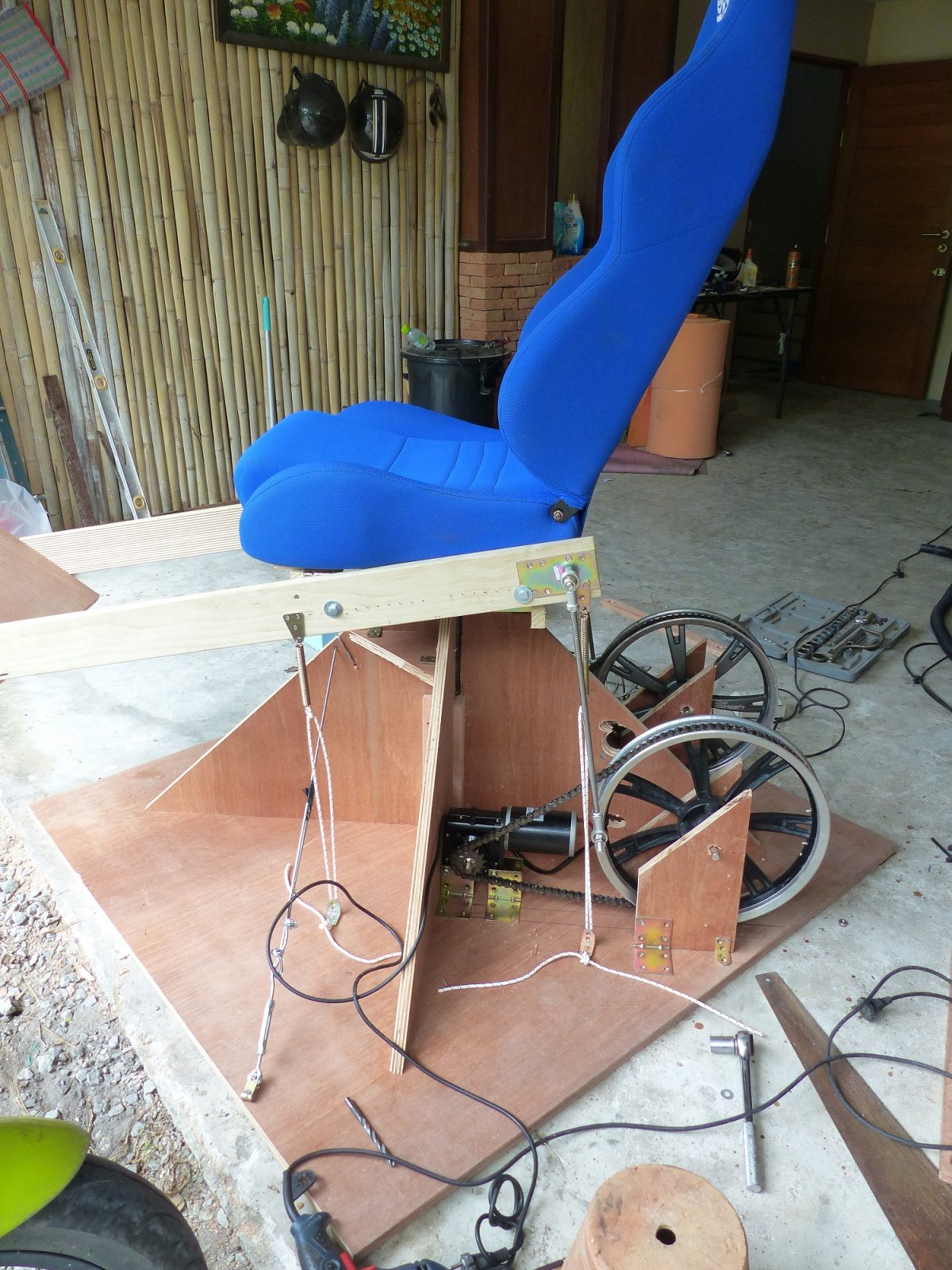

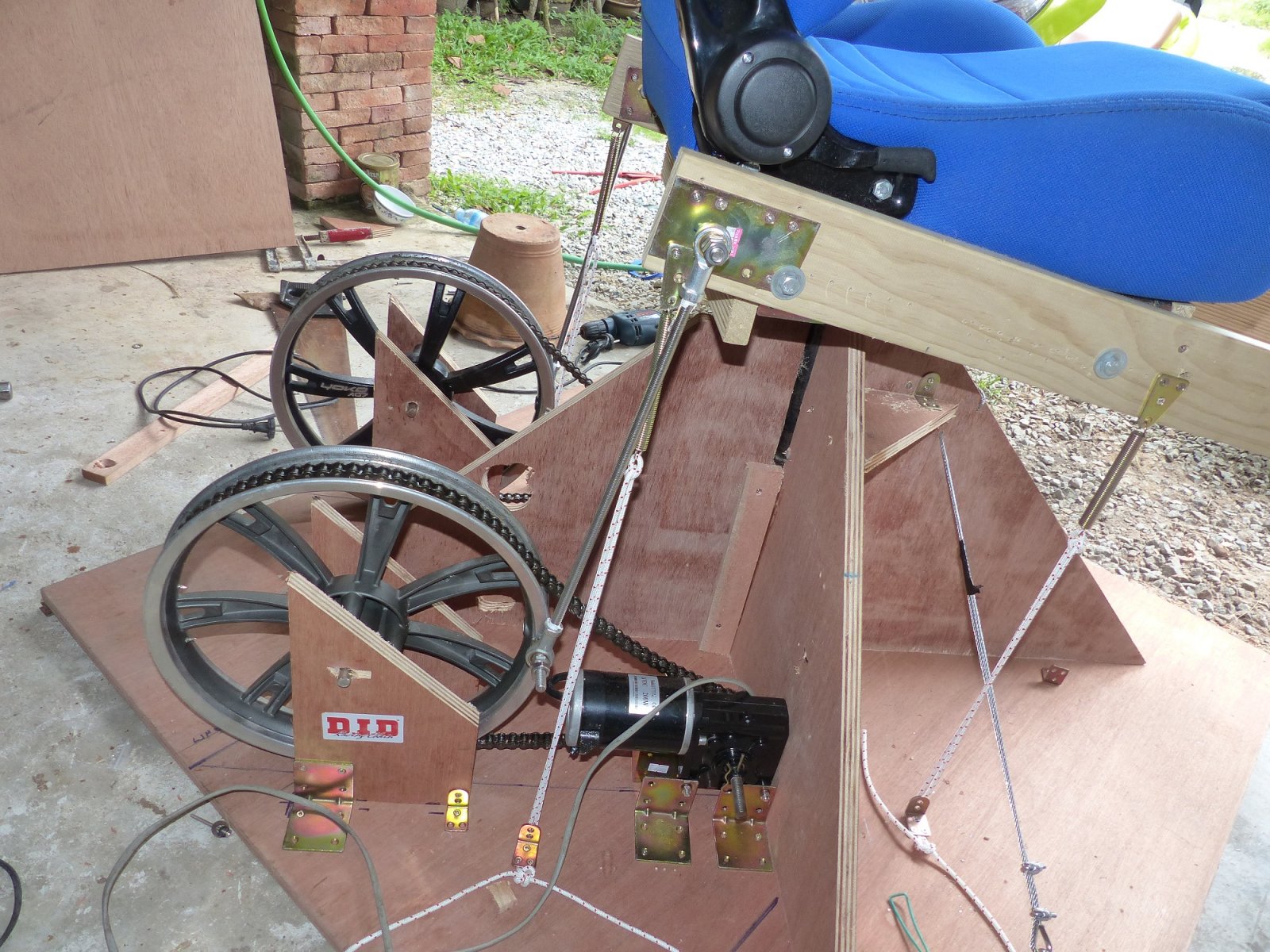

    so i have the mechanical part of my project working now so i thought i would start a new thread. i'm waiting for the arduino board and some other stuff and giving recent news in Thailand, i think the post office is going to running a bit slower than usual so that may take a while.
    anyhow, here is my design. it uses 2x 200w 24V worm drive motors and a 6:1 gearing system using motorbike parts. the gears get me down to about 400mm/sec at 140mm radius and 666N force to drive the chair, with a range of about 250mm. this gives me about +/- 30 degrees of lean which i hope will improve the sensation on flight sims.
    i can't drive it from the computer yet, but i hooked up the motors directly to a couple of car batteries while i wait for my PSU to arrive. it really moves me around with a lot pf power!
    the springs are designed to equalize the forces so it should be symmetrical in speed when going from level to full tilt and then back. the chair pivot is 700mm high to accommodate the +/- 30 degree tilt.
    the final cost, not including racing seat, is about $500.
    UPDATE, want to skip the BS as see it working?
    https://www.xsimulator.net/communit...s-tilting-chair-mosim.9181/page-3#post-118414
    and how i built it
    https://www.xsimulator.net/communit...s-tilting-chair-mosim.9181/page-3#post-118604

    Looks like you have room for a 60° tilt, which (if my fly lessons from '95 are still imprinted in my mind :nerd) is the "other" standard tilt in aeronautics
  3. MarkusB
    Jun 30, 2015
    552
    4,214Coins
    +597 / 2 / -0
    That's really an interesting construction! I'm looking forward to seeing it in action when it's hooked up to DCS. Hope you get your parts soon.
    Where do you plan to mount the pots? At the motor axis (which would probably need a multi-turn pot) or at the large wheels?

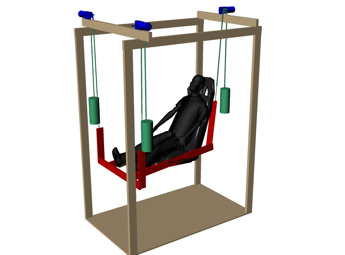

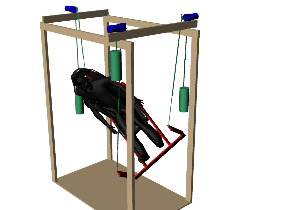

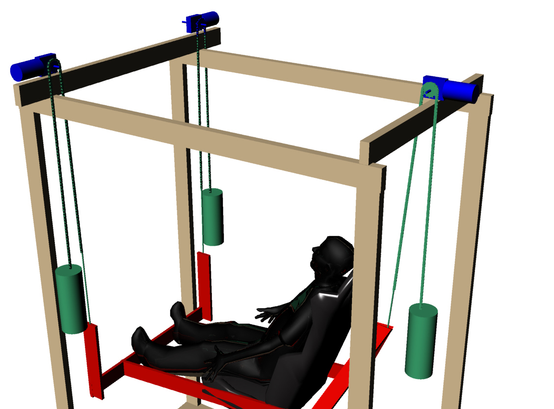

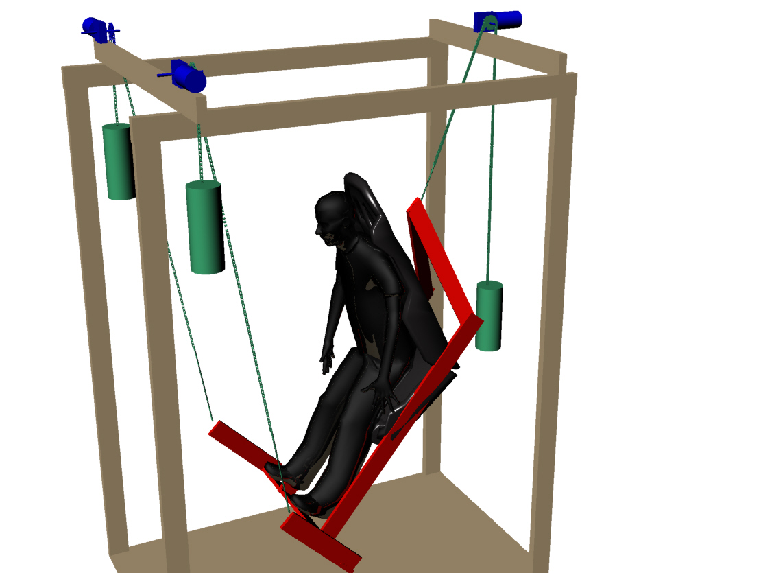

  5. steveh2112
    steveh2112 Member
    May 12, 2014
    104
    semi retired
    Phuket, Thailand
    1,147Coins
    +22 / 1 / -0
    the pots will go on the big wheels, they will turn about 140-160 degrees in normal use, so should be good range for my pots.
    i saw this video
    that thing looks amazing, i especially like that it goes up and down so much.
    i know i can't help myself, as soon as i get this current design working, i'll start on the next one
    i was thinking the push system on there is quite complex and needs to be very strong, but i have an idea that i've never seen before, maybe someone could point me to an example.
    my idea is i build a big frame with a plywood base and 2"x4" corner posts and top beams, about 4' wide, 6' long and as tall as i can fit in my game room, so about 9' high. at 3 points on the top of the frame are 3 of the same motors i'm using now with the motobike front sprocket.
    there is a 2m long chain hanging over each sprocket, connected to steel wire that connects to 3 suspension points on the chair which is dangling in the middle of the tall frame. on the other side of the sprockets, the chain is connected to counterweights, that make the chair and ridder statically neutral
    so the motors can lift or lower the 3 chair pivot points to give pitch, roll, and vertical movement, at about 500mm/sec. i think i should be able to get at least +/-45 degrees of pitch and roll and maybe more than 1m of vertical lift/drop.
    for position feedback i'd use a multi turn pot on the motor shaft.
    anyhow, it would be an awesome project and i think quite original, and i can reuse all the expensive parts of what i have now.
    P.S. just thinking about the math again, the 200w motors i have give 20Nm Torque, and the radius of the drive sprocket is 30mm, so that's 666N at 30mm. so there are 3 motors potentially lifting me and the chair, so that's 2000N lifting (or lowering) about 90kg for me, chair, joysticks, headset, etc. so that's 22N per kg. BUT, because of the counterweights needed to equalize the downward gravity force on the chair, the weight is actually 2x90 so 180kg which gives 11N/kg.
    One newton is the force needed to accelerate one kilogram of mass at the rate of one metre per second squared in direction of the applied force.

  6. Nick Moxley
    17,056Coins
    +2,506 / 30 / -2
    Napkin calculations, Oh how some like to learn the hard way.
    3 motor's.....500mm/s......45 deg.......urr ya good luck with that.
  7. mprofitt
    mprofitt Member
    May 27, 2014
    37
    230Coins
    +14 / 0 / -0
    I would like to see the napkin calculations. Can you scan the napkin?
  8. steveh2112
    steveh2112 Member
    May 12, 2014
    104
    semi retired
    Phuket, Thailand
    1,147Coins
    +22 / 1 / -0
    i was under the impression i'd spelled out all my calculations in my last post, the one where i came to the conclusion i should get 1G up or down (effectively, weightless down). did i miss something?
    on the CAD drawing i attached above, i verified that at least mechanically, +/- 45 degree pitch and roll is possible, but unless i can get a lot of height for the rig, it would be hard to get much vertical range while leaning.
    i think my next step is to build a scale model just to see what's possible.
  9. OZHEAT
    OZHEAT Active Member
    Oct 26, 2015
    208
    Australia
    2,459Coins
    +106 / 6 / -0
    3DOF, DC motor
    Looks like your cad drawings are depicting a mechanical swing.
    I also agree that your calcs are way off.
  10. steveh2112
    steveh2112 Member
    May 12, 2014
    104
    semi retired
    Phuket, Thailand
    1,147Coins
    +22 / 1 / -0
    i can't wait to see the corrected math
  11. OZHEAT
    Oct 26, 2015
    208
    Australia
    2,459Coins
    +106 / 6 / -0
    3DOF, DC motor
    Well for correct math you would need to provide specs on the motor and gearbox.
  12. steveh2112
    steveh2112 Member
    May 12, 2014
    104
    semi retired
    Phuket, Thailand
    1,147Coins
    +22 / 1 / -0
    https://www.motiondynamics.com.au/worm-drive-motor-12v-24v-200w-180-rpm-20nm-torque.html
    • 24v No Load Current: 0.9A
    • Rated Torque:20 Nm (Locked Rotor Torque)
    • Optimal torque: is 12.5Nm
    • Motor Speed:3600 RPM/160-180 RPM at Gearbox dependant on load.
    • Rated Current 12/24 Volts:16amps at 12v OR 8 Amps FOR 24v, No load rating of 1A
    • Holding torque : Low Holding torque, we've found these are quite easy to back drive, so if you need a worm drive with holding power this worm drive is not suitable.
  13. OZHEAT
    Oct 26, 2015
    208
    Australia
    2,459Coins
    +106 / 6 / -0
    3DOF, DC motor
    Typical sales bullshit!!!
    Rated Torque:20 Nm (Locked Rotor Torque) so they call stall torque, rated torque....Wrong(maybe thats what they base their BS specs on)
    Ok looking at the PDF specs on G180-12 (12v version), I know yours is the 24v version so approx half the 12v motor current.
    G180-12
    Voltage 12V-16VDC
    Motor Power 180W
    No Load Current 1.8A
    Rated Current 16A
    Stall Current 32A
    Torque 20N.m
    No Load Speed(RPM) 180RPM
    Rated Speed(RPM) 150RPM
    Gearbox Ratio 25:1
    No speed/torque/current curve graph so what they actually base their ratings on is a bit of a mystery.
    OK then.
    You cannot use Locked rotor torque for your calculation, it only applies when the motor is starting or stalled(locked).
    Once the motor is moving the torque drops off significantly at rated.
    If you take their Optimal torque: is 12.5Nm (which looks suspiciously like a calc that I will describe later) to maybe mean their Rated Torque
    Stall current maybe plausible 32A@12V or 16A@24, Hmmmm going by this spec a single MM isn't suitable and NO bridging 2 chips on the MM WILL NOT double the amp capacity. It will Halve the RdsOn value but that is another subject.
    Rated current 16A@12v or 8A@24v If we look at the stall current @32A, the rated current is half of stall current. Hmmm at that level I would say the duty cycle would be ~10 - 20% or 1 min ON, 9 min OFF to 2 min On - 8min OFF.
    A motor with 100% duty cycle will typically have a rated current of a third of stall current.
    When we look at their "rated torque" compared to their "optimal Torque" it looks like they worked that out by multiplying the gearbox efficiency of 60-65%.
    So there you are, your using BS sales blurb which doesn't make sense for your calculations.
    If you want to truly know what the output of the motor & gearbox you are going to have to do a speed/torque/current graph of your own.
    Cheers Andy
    PS, no comment on your swing design?
  14. steveh2112
    steveh2112 Member
    May 12, 2014
    104
    semi retired
    Phuket, Thailand
    1,147Coins
    +22 / 1 / -0
    ok, so if it is more like 12.5Nm, not 20Nm i used above, that means i would only get just over 1/2 a G with my design. not sure if that's enough to make it interesting really.
    anyhow, this 2nd idea is just something of a brain fart at the moment, the rig i have running now in the 1st post (the mechanical part at least) has easily enough power to move me around at about 120 degrees/sec which is about 1/2 what an f16 can do, so that's good enough for me.
