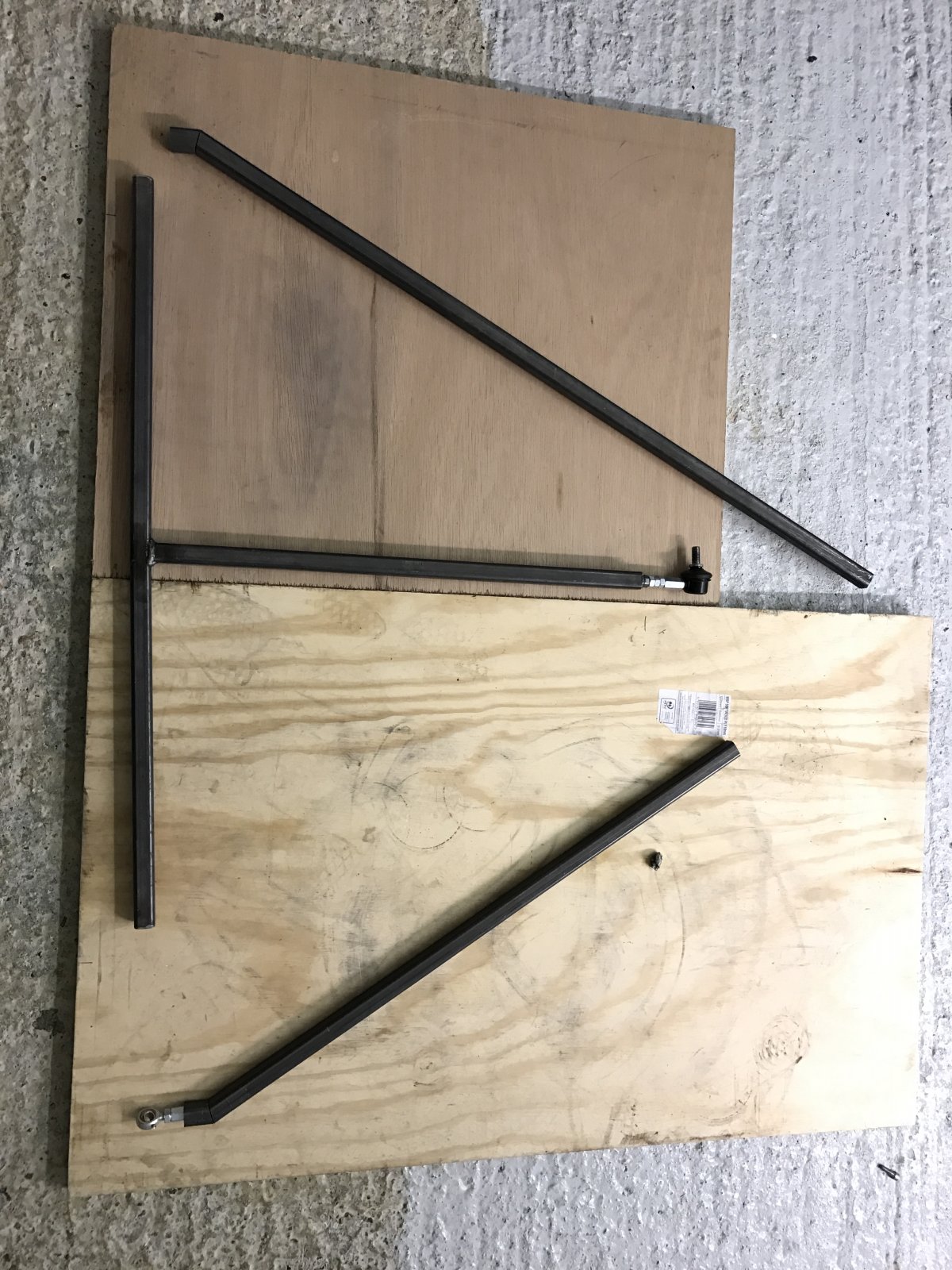

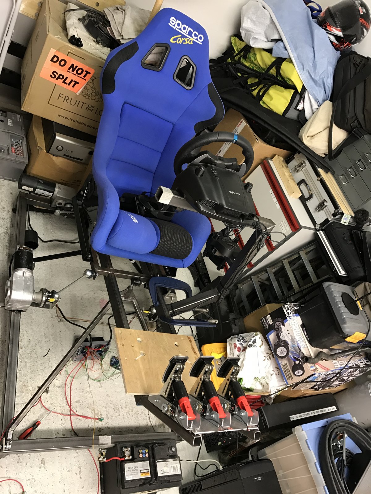

    Got my steering wheel and pedals fitted. Remade the front tie bar, triangulated it and put M8 rose joints at the front, it's much stronger now, when sat in the seat the hole things a lot more rigid.
    You can see that I bent the old bar!

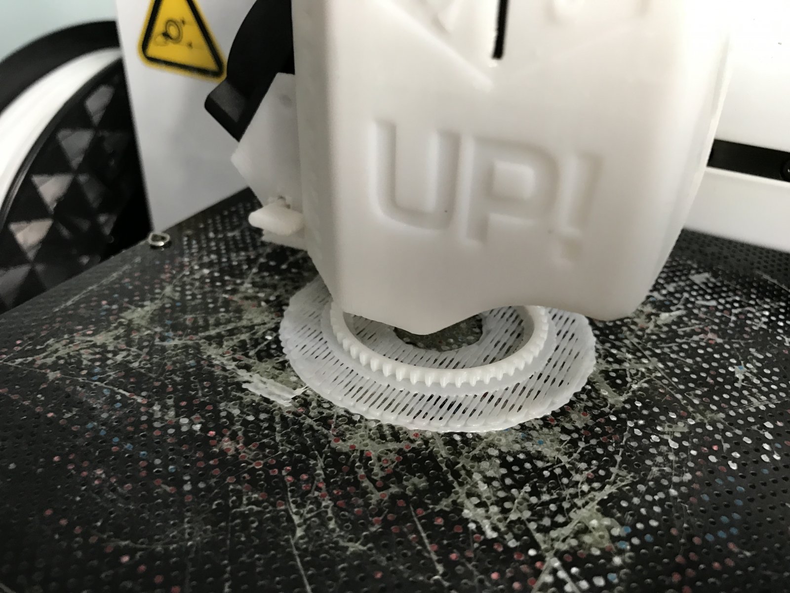

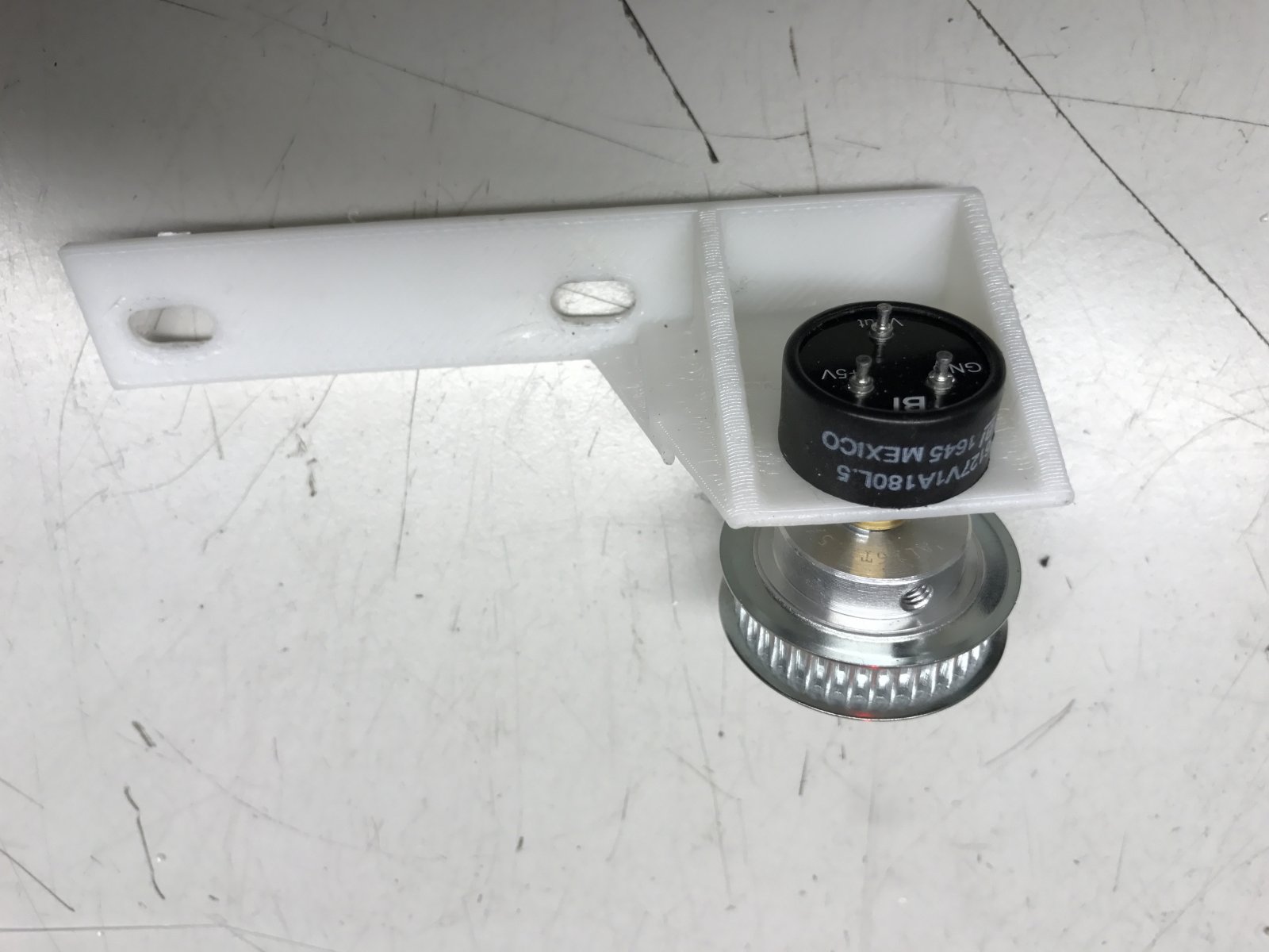

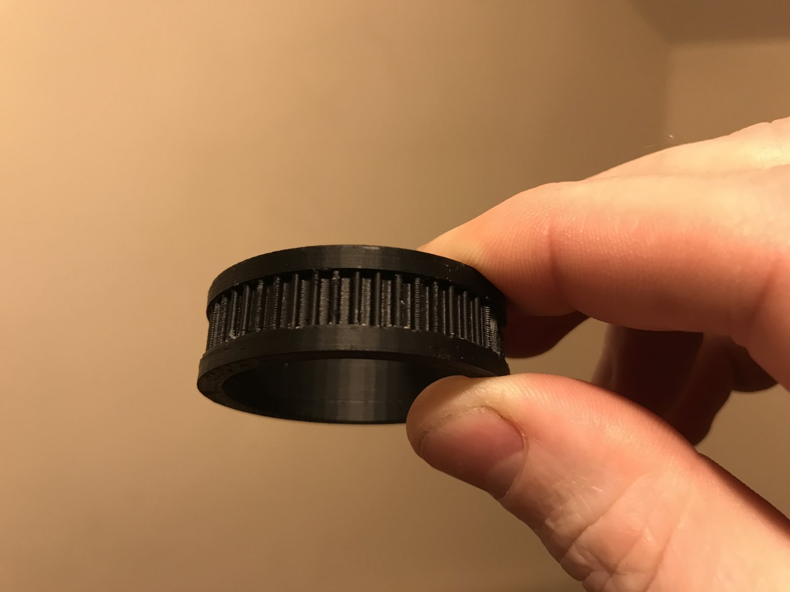

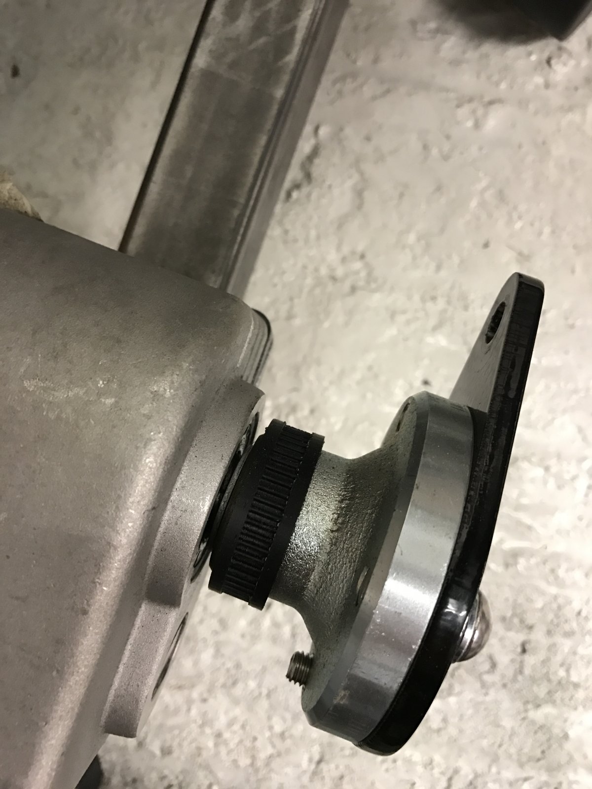

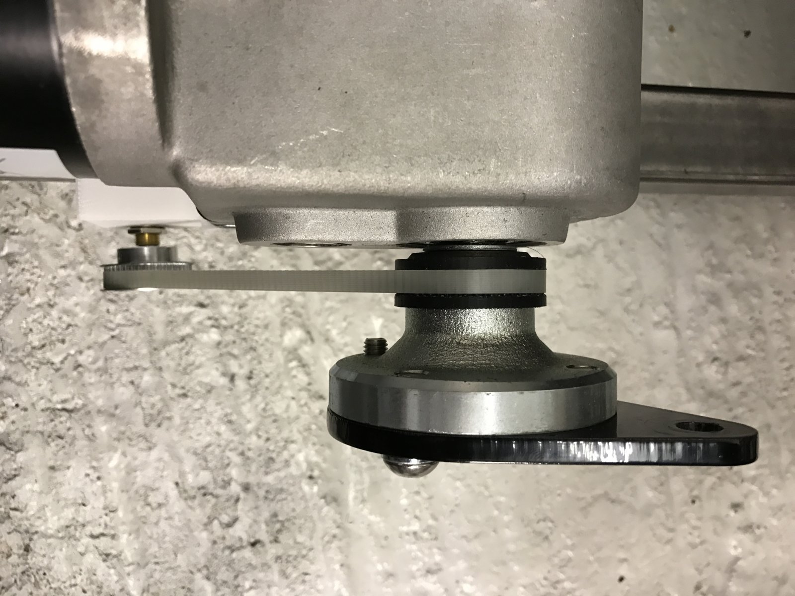

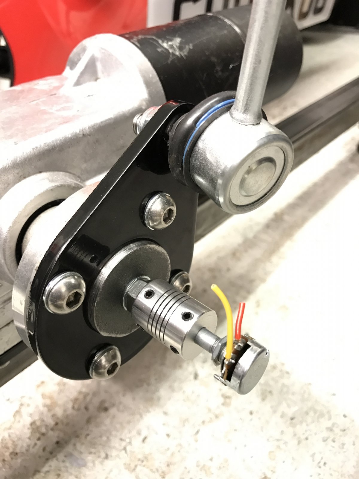

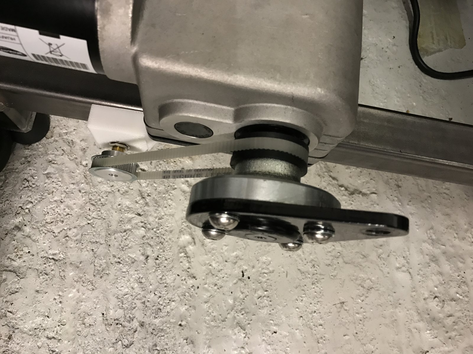

    So bit of an update, my feedback system is inherently floored, if my arm tries to rotate past the bottom everything hits. :confused: I've always known this was going to be a problem and planned to do it a different way.

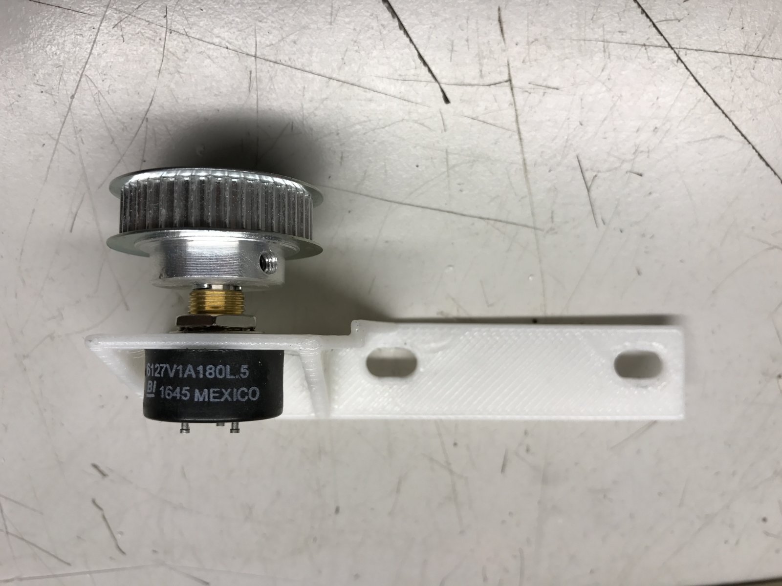

    So I've been working on trying to drive the pot with a belt instead. With the help of a 3D printer I started working on making a cog that would slide over the back of the hub.
    Eleven attempts later, I nailed it. lol

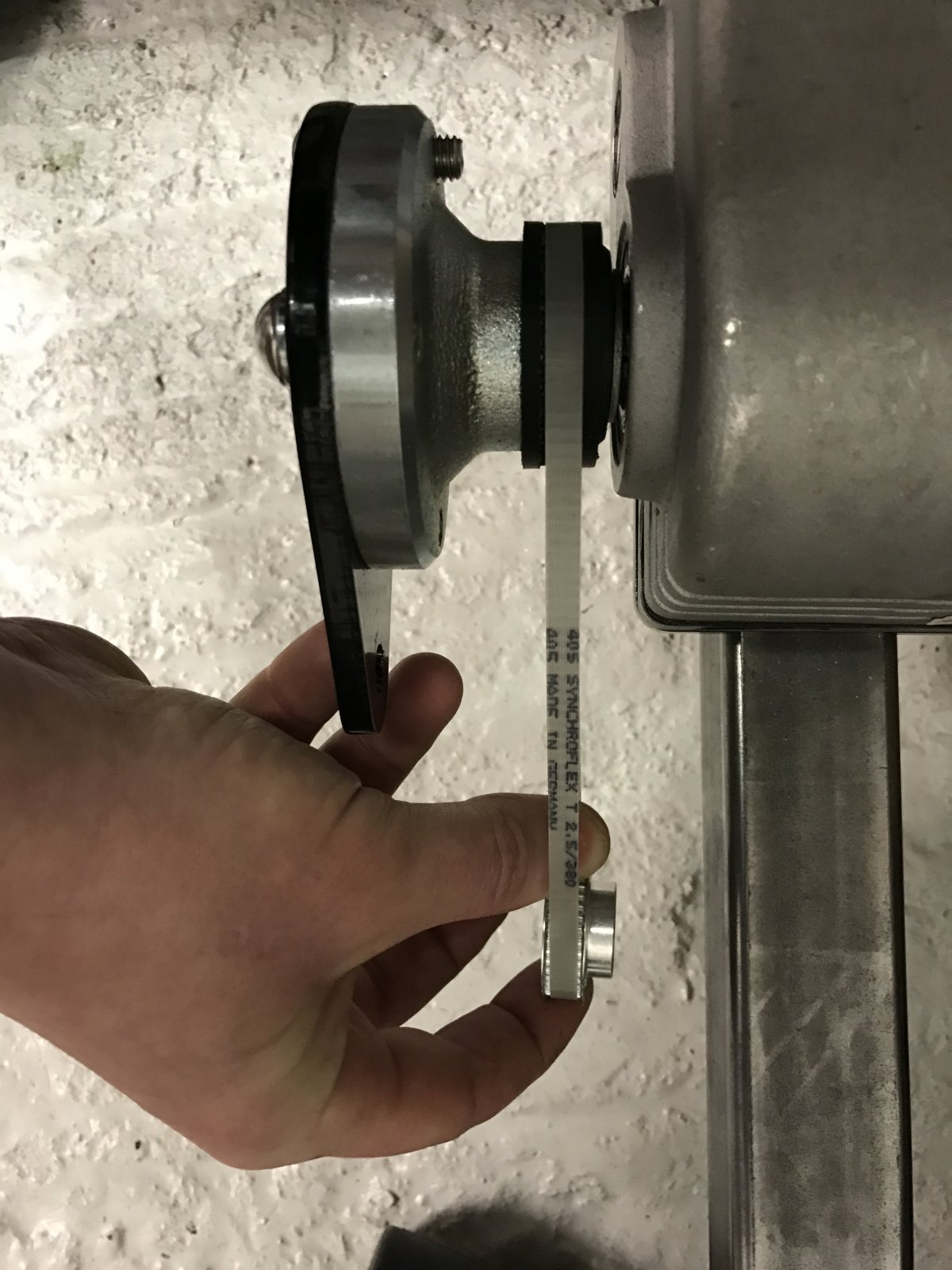

    I've used a T2.5 belt and pully from RS. 52 teeth on the hub and 40 on the pot, I did this to make the pot that little bit more sensitive, don't need the arm to rotate the full 180.
    I'm using a 180 hall affect pot, there's no stop on the pot so if my rig throws a wobbly the arm can rotate as much as it wants without damaging anything. :thumbs Also printed a bracket to hold the pot
    May rework the bracket, but it works for the time being! So now I just need to try and get the new Simtools working!!! :eek:

    I forgot to say, there's no backlash on the belt at all! :thumbs

    really curious to see weight bearing tests. I dont trust the strength of the arms you have extending to the frame from your motor arms. I also feel that you sideways lateral movement is going to lack power to bring you back to center. THose appear to be somewhere around 25:1 motors based on the speed and I would think you would want to be closer to 60/90:1 for the weight and momentum you will be trying to rebound from. Looks cool so dont think im just bashing here, just calling out from experience.

    The arms are anti roll bar drop links from a Ford KA, £8 a pair from good old eBay :thumbs
    My thinking is that when you hit a pot hole at 50 mph this little link stands up to it no worries! All its strength is in push and pull, I'm not getting out the calculator! ;)
    But so far they've held up pretty well!
    My father has been helping with the test driving and has been putting it through it's paces rather enthusiastically!!! :grin

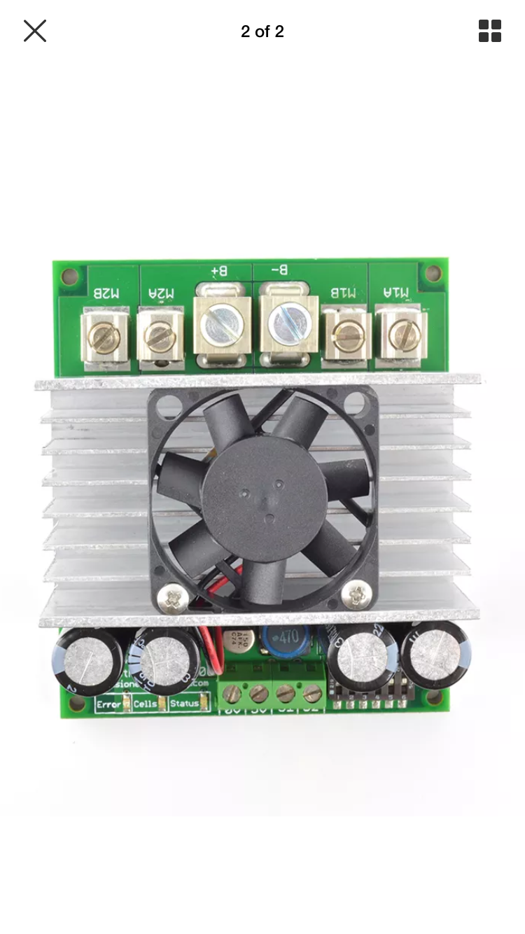

    The motors do lack a bit but I think I may need some better controllers IBT-2 are meant to be good for 43A but I have a 35A fuse supplying both and it hasn't blown yet, so I may well be able to throw some more current at it yet, after about 30mins the motors are only marginally warm. Also I'm only running the front two motors at the moment, when I'm happy I'll start with the back ones, will post a video very soon. :)

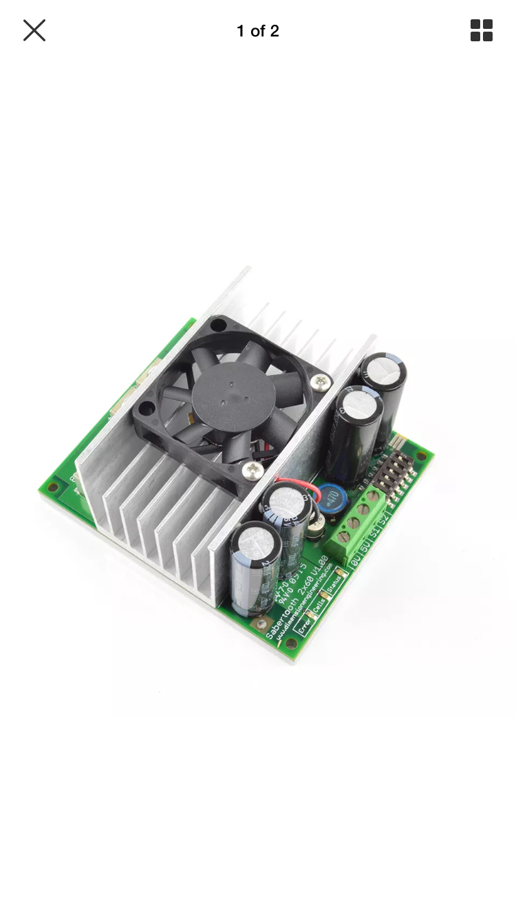

    Anyone doubting power I had 13.5amp 125w 12v motors on a 15:1 gearboxs running my 6DOF. Maybe you possibly will need a couple of 100nm gas struts at most but deffo try without first.
    Althoigh I think you will have plenty enough power in the motors/gears but you really seriously absolutely need to look at getting some sabertooths. :D
    I detest those IBT's they couldn't lift rat sh1t off the floor. That's just my opinion which doesn't mean much lol :D

    @MWB Those pots will fail i had a similar hook up in testing and the bearing in the pot fails everytime. instead try this aproach.
    https://www.xsimulator.net/communit...w-arduino-and-mm-smc3.8479/page-5#post-111392
  16. Nick Moxley
    17,057Coins
    +2,507 / 30 / -2
    Those are the Hall effect's we all use, they don't have a bearing but rather a Bronze bushing.

    I haven't been able to mesure peek current being pulled through the IBT's yet. But am very tempted with the Sabertooths. Is it these ones you're using on your rig?
    Sabertooth Dual 60A. I've been looking at the 2x32A ones, but then I'm thinking should I future proof and just go 60A :think
    Anyway thanks for the compliment, means a lot coming from you mate, your rigs immense!!!

    Is that a GT2 belt your using? I found with the larger pulleys, you only need very little tension on the belt, because there are so many teeth in contact at one time, also I found the T2.5 belts to be made of almost an elastic material, so although it looks like it, there really isn't that much tension on my belts, but thanks for the heads up, I will keep an eye out, and let you know how I get on. :thumbs
