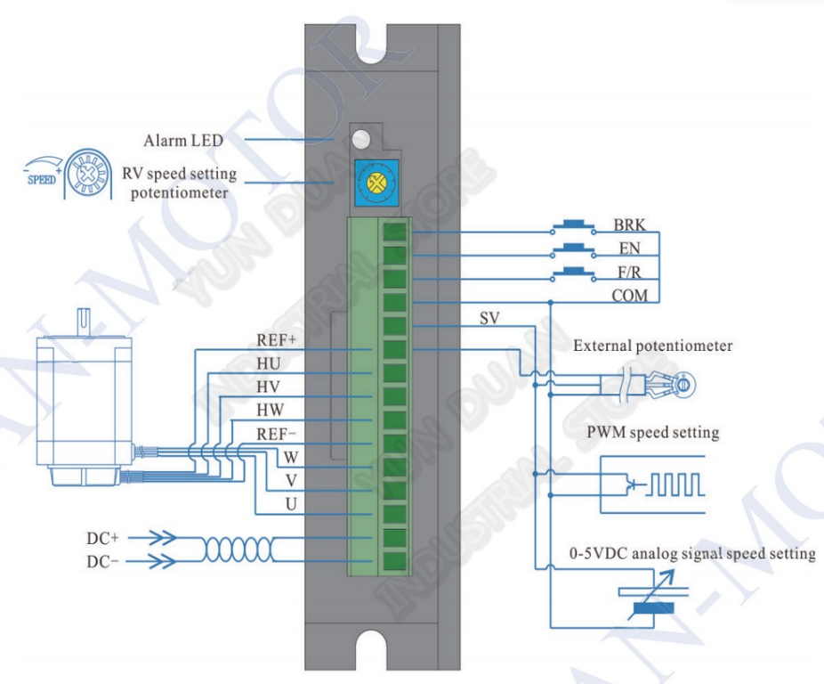

    I didn't like the low speed of the linear actuator. After measurements, it was only 110mm per second. At first I was a little upset, but after carefully studying everything, I found my mistake. ESP32 has logical units (high level) 3.3 volts. I thought the driver of motor would understand this signal. But it turned out, judging by the scheme, both digital and analog signals can be received on the driver pin.

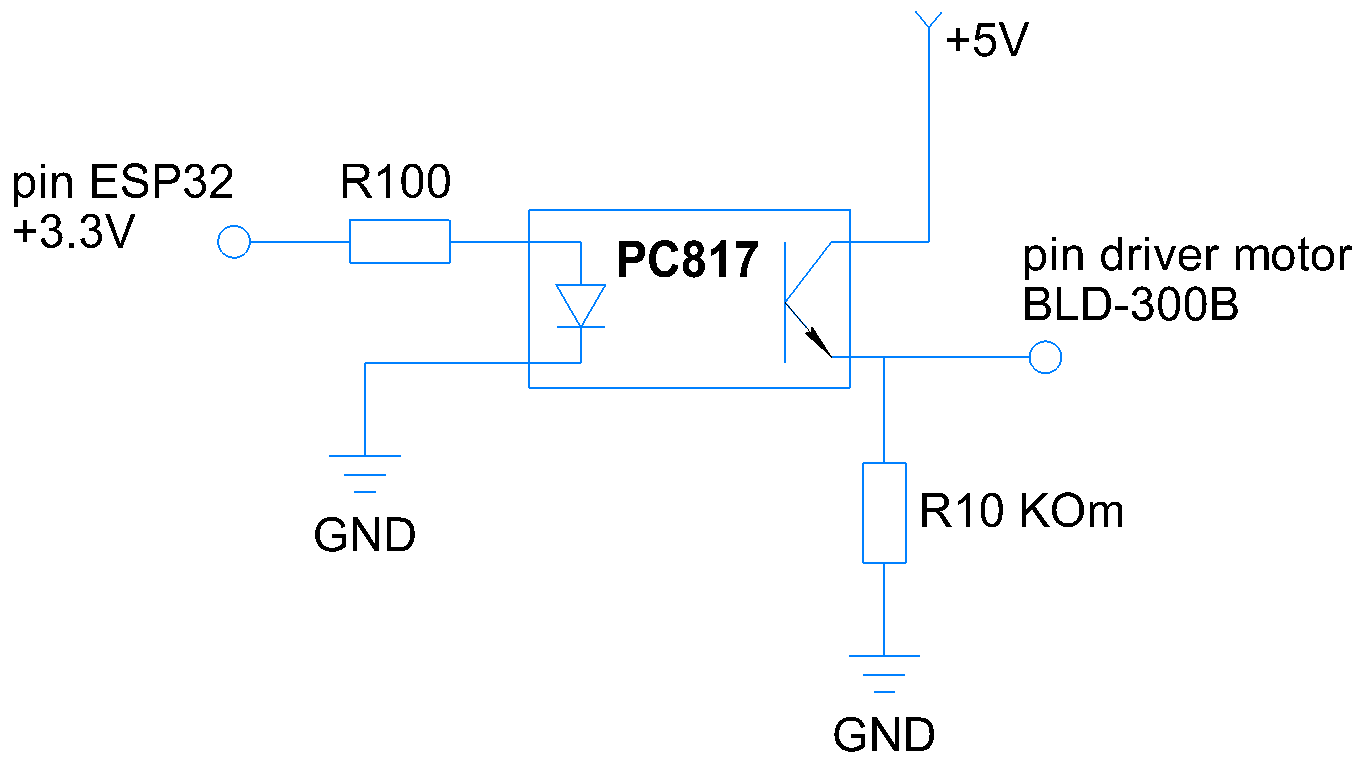

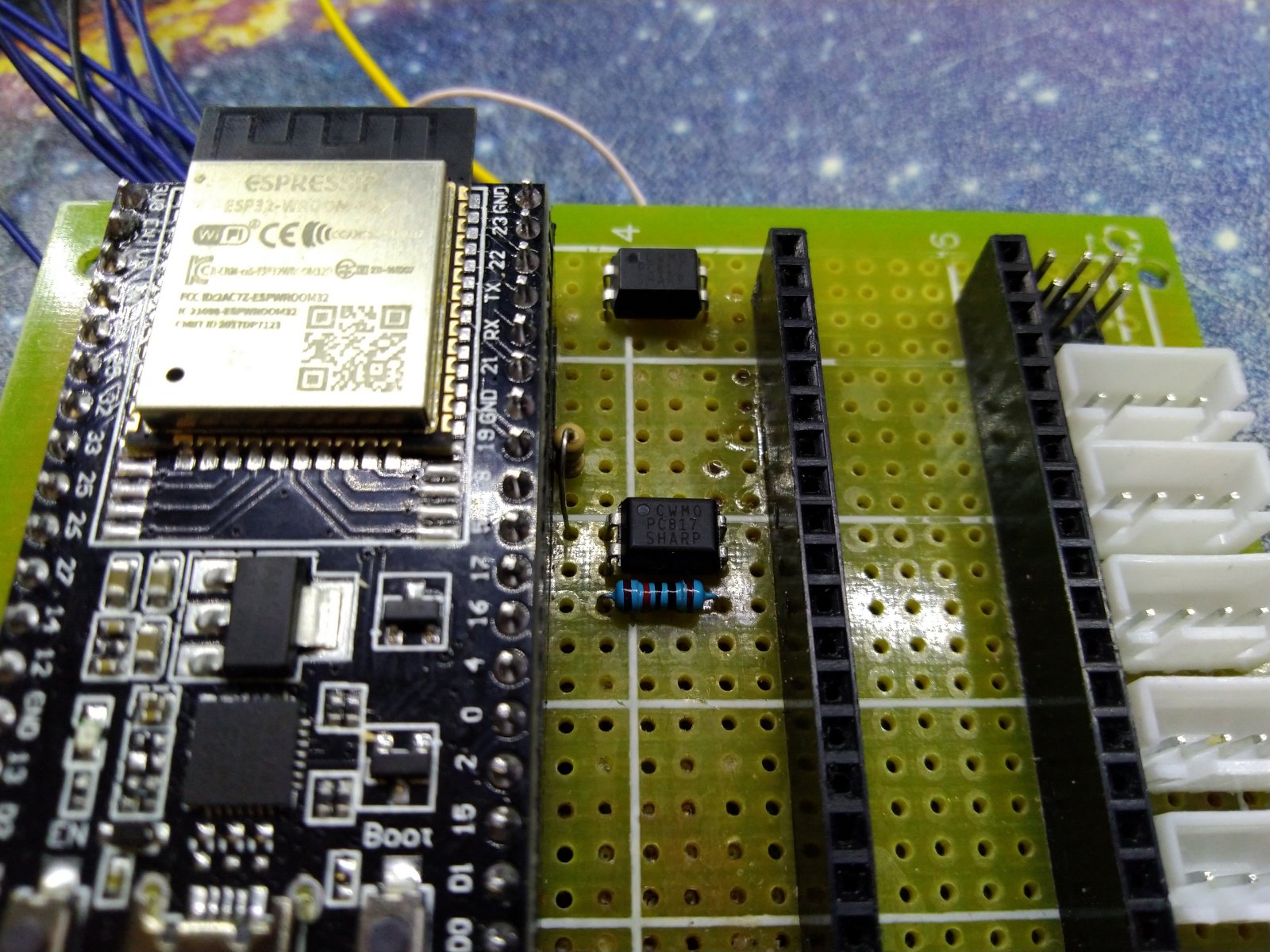

    It turns out he leveled my PWM signal with a level of 3.3 volts and perceives it as an analog signal of 3.3v (5v maximum). Apparently this is done for the versatility of the driver control (it understands both digital and analog signals). At home, I did not find transistors in order to make keys. Found the PC817 optocouplers. Below is the connection diagram.
    I soldered one optocoupler for the sample and it worked. The maximum speed became 320mm per second !!! plus galvanic isolation for pin ESP32. I think the torque is now okay. If you understand what I wrote here, then be careful

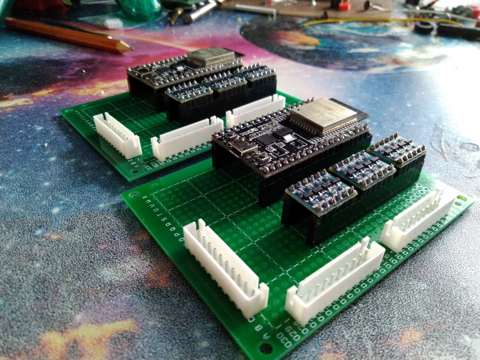

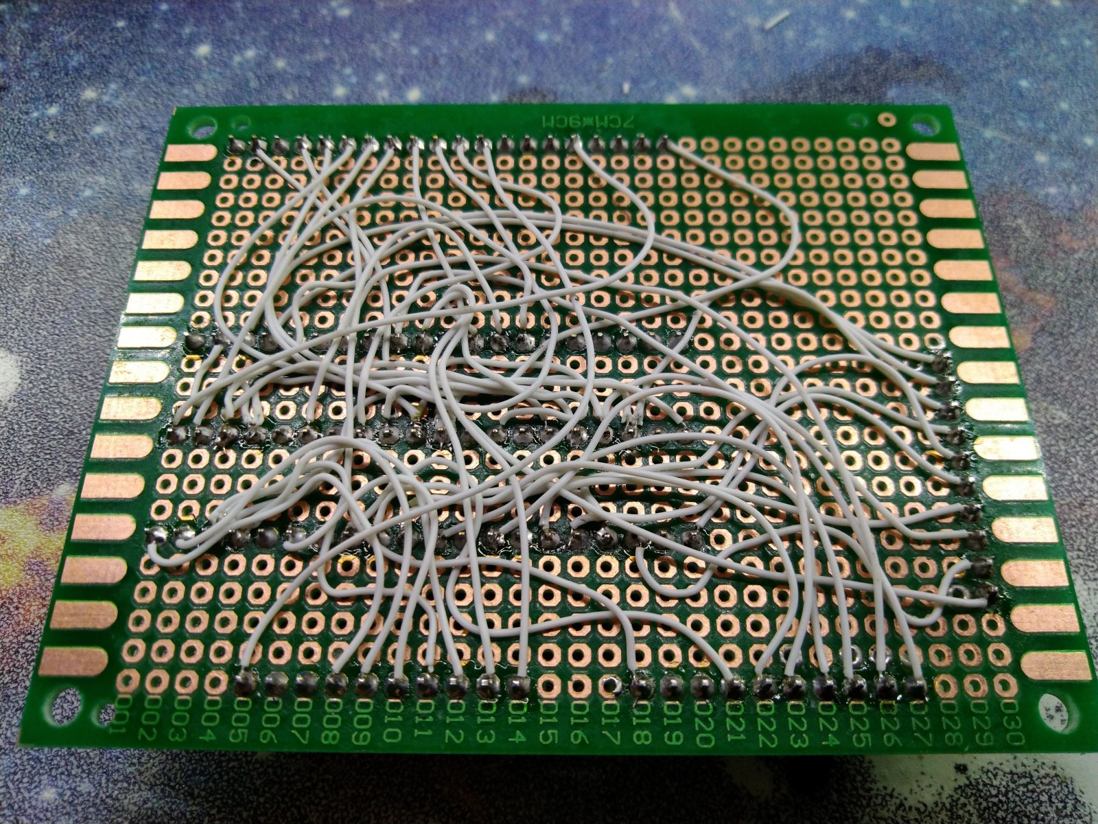

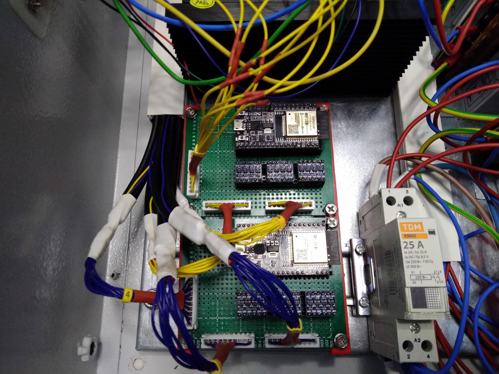

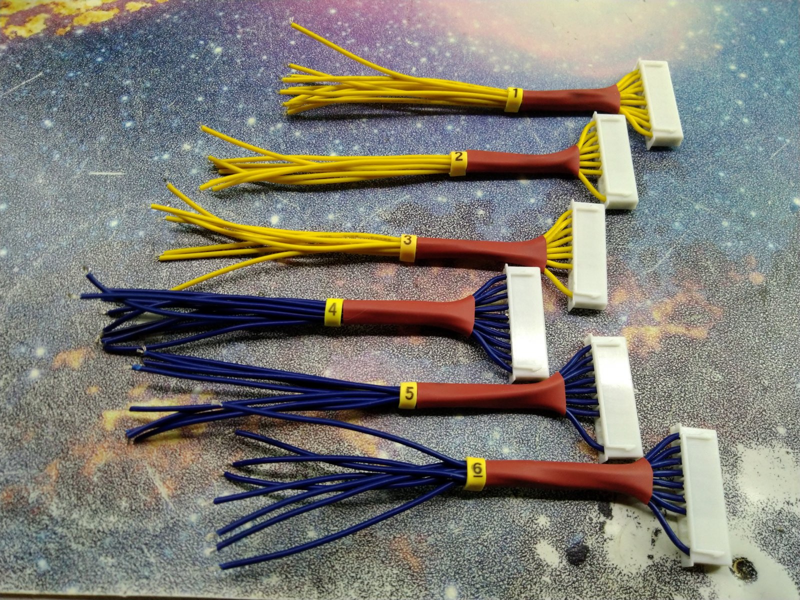

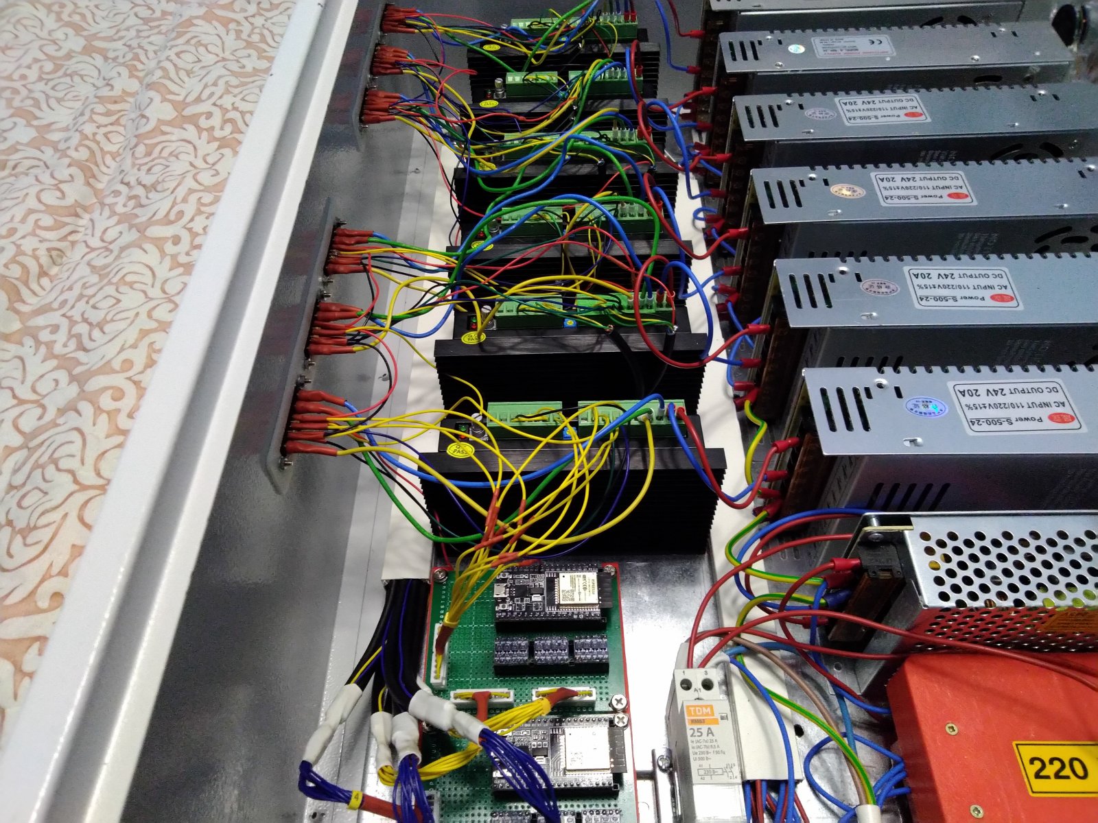

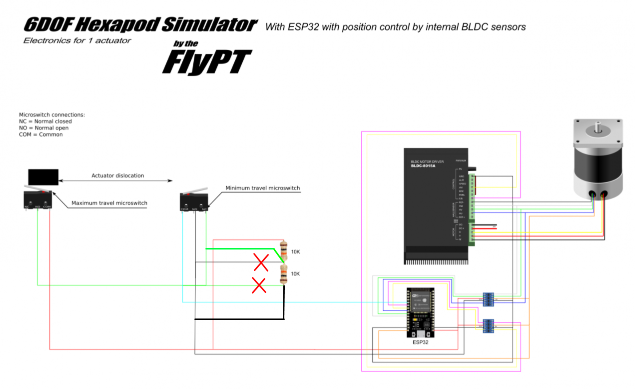

    I'm tired of these potentiometers! I delete everything and do it like on the internal Hall sensors of the motors. I redid everything in a couple of days and this is what happened. I now have two ESP32 boards that control six drives. Signals from the Hall sensors through voltage converters are converted from 5 to 3.3V and transmit information about the rotation of the motor to the ESP32. I removed the potentiometers themselves and instead soldered a voltage divider from two 10K resistors. When the maximum limit switch is triggered, a voltage of 3.3V is issued (or 4095 in a 12-bit ADC), with a minimum limit switch - 0V, and in the middle position - half of the voltage from 3.3V. All information on code and everything else from the @pmvcda project https://www.xsimulator.net/community/threads/flypt-6dof-brushless-diy-actuators.10799/. The only thing that seems to me is that the voltage divider is shown incorrectly. It didn't work right away until I redistributed the voltage divider. Делитель напряжения.png
    IMG_20210618_203150.jpg IMG_20210618_203230.jpg IMG_20210619_083356.jpg IMG_20210619_130329.jpg IMG_20210619_211810 - копия.jpg IMG_20210619_211810.jpg IMG_20210619_211832.jpg
