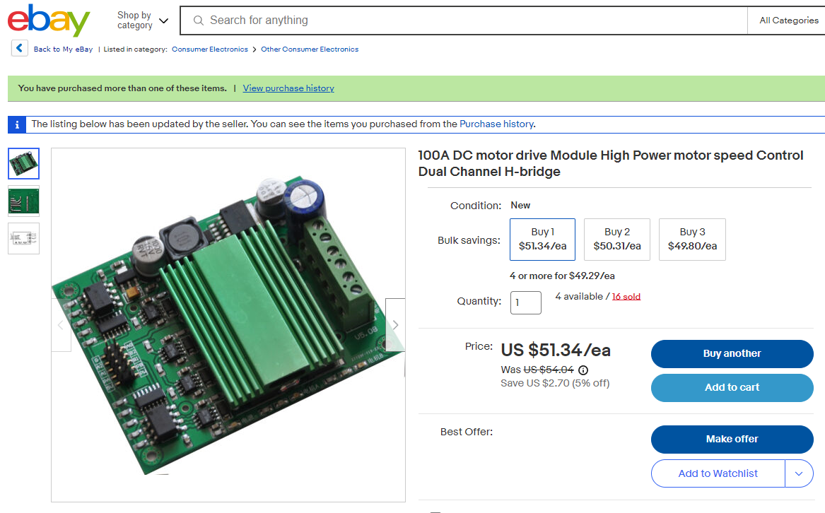

    Not sure what you mean by PID or how to set it, sorry. I'm using SMC3 and I have the KP set to 400 and Fpid to 1. Pwmax at 60 and Pwmin to 5. Like I said it's working well right now (without a load). The motor is a 12V 40A 50:1 gearmotor that is used for tarping dump trucks. It will throw 90LBs off of the sim chair if I connect it directly to the battery (don't ask how I know this). Supposedly the motor produces .8 HP and 44NM. I posted the specs for the motor a few messages above. Per your suggestion I will attach my clamp meter to the motor lead and test it, though I've never used my meter on DC, only AC. I hope it is DC capable.

    Sorry, initially they were IBT2. 10 of them. I tried doubling them per your suggestion but they fried as well. The latest 2 were the 100A controllers suggested by Gadget999
    21,677
    151,706Coins
    +11,045 / 56 / -2
    There is something really wrong if you are frying controllers like that, check your wiring really carefully.

    As I mentioned above, the rig is working fine on a single new 100A controller with 90lbs of weight in the chair. I am hoping the other 2 axis will also work when I receive the 100A replacements. I used a clamp meter on the 12V motor lead per Gadget999 suggestion and it read 14 amps at peak with me pressing down an additional 30-40 lbs on the platform. Without pressing down it only reached 9 amps. The new controller did not even get warm and seems to work well thus far. I think having accidentally left PWmax to 255 when connecting the new controller initially is what fried them but I am not certain. Maybe they were just bad. Right now my Kp is 450, Ki is 0 and Kd is 0, Ks is 1, PWmax is 80 and PWmin is 10 and it seems to track pretty smoothly. Thank you for your help. I will update the post when I receive the other controllers.

    Ok you have tuned the pid wrong
    In my opinion you need to start again
    Set pid to 1 - the motors should not work
    Set pwm max to 200
    Slowly increase kp till the motors start moving
    Increase the number till it tracks on the screen with the rig loaded
    I suspect your rig was moving too fast and overshooting back and forth using too much energy. You may have ended up in a situation where it tried to go forwards and backwards at the same time and short circuited
    Get those p numbers down
    By limiting the pwm max you are just masking the problem

    Ah. Perhaps having my Pwmax set to 255 and having the KP up at 500 or so is what fried the 2 controllers then. I will try your tuning method as soon as i get the new controllers. Thanks.

    I received my new replacements and they work! I lowered the Pwmax to 80 and wired in both of them and they worked just like the other one that is still working. After I was sure they were working stable I used the PID tuning method suggested by Gadget999 and lowered Kp, Ki, Kd to 0, raised the Pwmax to 255, Pwmin to 1 and Pwrev to 255. I put SMC3 in Motion mode and slowly raised Kp until the rig started moving. Mine started at Kp of 80. But I found to get a good trace of the potentiometer I needed to go to Kp of 150. With my weight in the rig I am running Kp at 180. I have not changed any other settings except to raise Pwmin to 10 and I have deadzone set to 1 on the traction loss motor as there seems to be quite a bit of mechanical slop (5mm to 7mm) on that axis due to the lever length and gear lash in the motor.
    Overall the 100Amp controllers seem good so far. I for one do not recommend the cheap IBT2 on ebay as all of the ones I purchased eventually failed. Even doubling them did not work for my motors. I am assuming that the true amp load on the cheap IBT2 is not as high as they state or my motor is drawing more current than the clamp meter is showing. I will provide an update on the new 100A controllers once I have used them for some time.

    If you are using the same 100A controller pictured I would make sure your Arduino sketch is in Mode 1, then follow the guideline in the previous post. When my 100A controllers failed, they actually emitted a cloud of smoke and fizzled... I had to pull the plug or I think they would have caught on fire.
