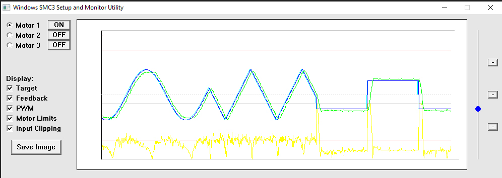

    Hi noorbeast, yes I have already tested the H-bridge, it works correctly, I had also used it a few weeks ago with X-Sim, it worked perfectly.
    The problem is that I have some problems with "SMC3 Utility".
    In particular, I noticed that, while the motor is rotating counterclockwise / clockwise and I change the PID or PWMmax values, the motor stops. I noticed in the upper left that "Motor 1" goes to [OFF] and I can't bring it back to [ON]. I don't know if it's a bug with the program.
    Later I tried to unplug the USB cable and reconnect but the motor still remains off, in the top left I still see "Motor 1" [OFF].
    I tried to restart "SMC3 Utility" but the motor is still in [OFF] (see attached image)
    I think something happens inside the Atmega328P (EEPROM), in fact I reprogrammed the Atmega328P with SMC3 v1.0, I set the PID and PWM values in "SMC3 Utility" (see attached image) and it starts working again.

    As soon as the green feedback line goes beyond one of the the red limit lines, SMC3 turns the motor off, which is a protection measure.
    For turning it on again, you need to bring the feedback line back between the red limit lines. For achieving this, disconnect the potentiometer and turn it by hand until the feedback line is centered again. Then connect it to the motor again.
    Now before turning the motor on again, you should reverse the motor cables, because it seems that the motor turns the potentiometer into the wrong direction.
    (This procedure is explained in the second bullet point within step 9 of the SMC3 setup instruction, which you have attached as second image.)

    Ok, at first one question: Have to reversed the motor cables, so that the green "feedback" line now follows the blue "target" line and after this the motor stops? The feedback line should not anymore go beyond the red limit lines. Is this the case?
    If you have achieved this and followed all 10 steps of the instructions, you can fine-tune the parameters.
    For doing this, you find some helpful information about all the tuning parameters in this post.
    About your question about which of the "out modes" you should use:
    I would start with "Manual", because with this mode you can carefully drag the slider by hand.
    If you get more confident, try "Sine", "Square", and "Motion". Tune the parameters until the motor follows the curves as well as possible.
    Oh, and you need to do the final tuning while you are sitting in your simulator, because the optimal PID settings are completely different for an empty rig compared to the rig with you inside.

    Yes, the green line follows the blue one and follows it, and the engine perfectly follows the trend of the graph (see the graph).
    But I don't know what the yellow graph is .... Is this normal?

    The yellow line is the PWM signal. I may be wrong, but I think you can ignore it.
