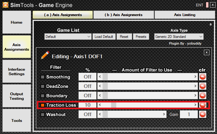

    The washout filter worked fine, but the traction loss one would not activate.
    (does now thou!)

    'Sorry, Im confused. I dont know which washout filter. I am using Extra1 for TL on iracing's plugin and it works fine in the last update and this one. What changed?

    The traction loss filter now washes out as needed. (washout speed depends on your min/max numbers.)

    I just saw that Washout filter below Traction loss - didnt pay attention to them before. I'd have to play with them to see what they do. I think i left it at 0 for Traction loss.

    The Gain above is only for washout.
    With the traction loss filter, you just adjust the min/max numbers as needed.
    (Centering to fast, use bigger numbers, centering to slow, use smaller numbers.)
