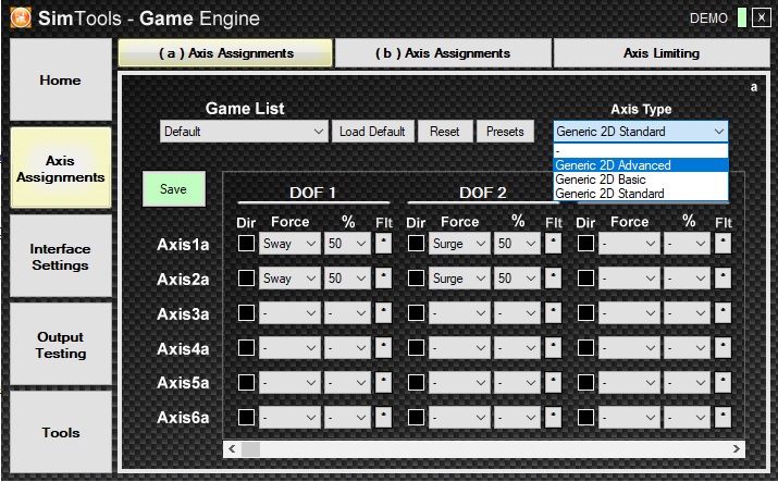

    hi i have a problem with the new version i dont have 2d advence generic. do you know how to do it?
    22,211
    154,729Coins
    +11,213 / 57 / -2
    Selections are in the Axis Type drop down menu:
  10. pierre
    pierre New Member
    Feb 8, 2018
    11
    102Coins
    I found it was disappearing when I loaded my backup axis settings in it must unzip the backup and ignore the files that have the same name and it works.

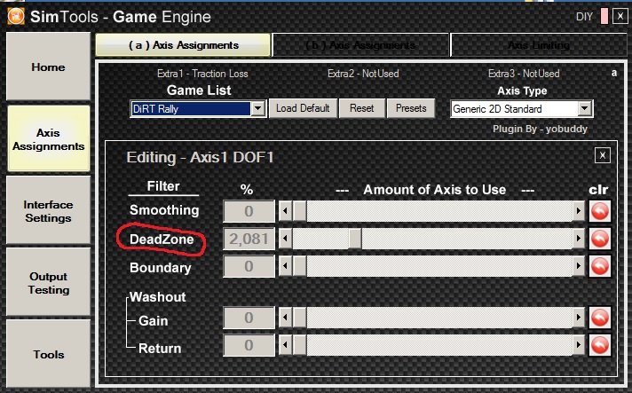

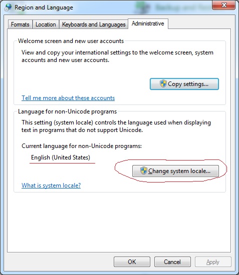

    Hi
    help please!
    in new version Simtools 2.3.1 does not work DeadZone. ?
    I have an old version Simtools 1,3 DeadZone work fine.
    why the new version does not work DeadZone?

    @shaman,
    Until v2.4 comes out (which hopefully fixes the issue) please set your PC like this.
    Should fix the problem.
  18. shaman
    shaman 2dof sim Gold Contributor
    Nov 25, 2015
    43
    Moscow
    - 984Coins
    +14 / 1 / -0
    thanks, it worked!
