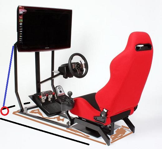

    Hi guys,
    I am looking at converting my current sim to 2dof motion
    Currently looking at building a new base with pivot point under belly button position while racing. With 12v 200w worm gear drive motors either 50:1 or 60:1. Either attaching arms to rear of seat or rear of top sim itself. Will start getting parts soon but plan is to build this fully early in the new year. Shifter position will change aswell as removing the table and will need new brace put on it for pivot to attach too.

  9. bsft
    it might help, however, a TV is between 5-10kg and thats quite a bit of weight up high. And also taking into account your actual weight as well. Your head may weigh near the same as a TV, but most of your weight is lower than the TV, so even 5-10 kg extra that high will move, but you need to consider re-enforcing the TV mount as well to stop flex.
    I did built a PVC pipe full frame a while ago and motioned it.
    The frame was lighter than steel and very sturdy, but again, I didnt have a TV on it .
    As Mario found out as well as another guy , lee, screens , no matter how light can be moved, but the problem is that you are trying to move extra weight higher on the frame.
    Both guys ended up taking the screen off and making it still.
    That being said, again, frame design will need to be taken into account of how you plan to motion it.
    If you use a really light seat like under 10kg, that will help.
    I think maybe you could look at mounting the connecting arms at the front, again up as high as you can , like behind the TV.
    Remember, with a full frame, it will flex under motion, and from experience I found it needs a LOT of extra steel to re-enforce it to support it.
    You could support the whole thing on a bit of 19mm plywood to stiffen it up. Heres my suggestion
    Mount the motors at the front but up right behind the tv, re-enforce the TV mount part and toss the whole frame on a sheet of ply, then pivot under that for balance point.
    Maybe that helps a bit.
    Cheers, David.

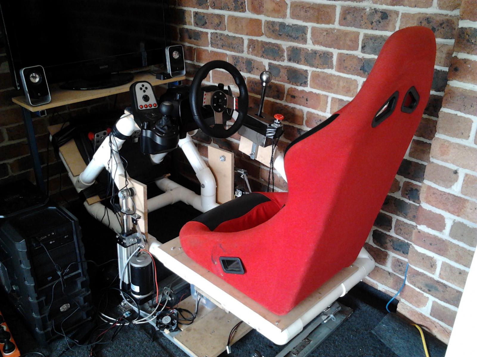

    yes 2 of those motors will do it, heres Lees with 25:1 boxes, but internals are plastic. So under great strain they may fail over time. Although I have not had that issue.
    Shoulder mount at rear.
    however he chewed out gearboxes, so I suggest 50:1 or 60:1 with yours as the internals are metal.
  15. bsft
