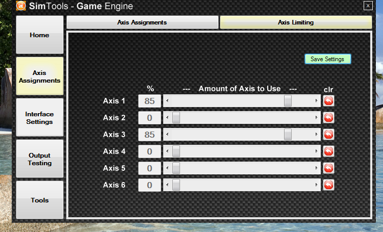

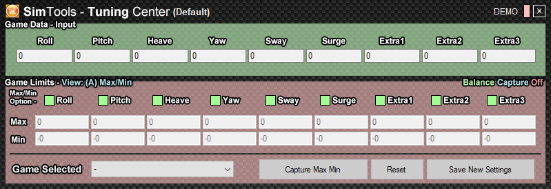

    Hello again. I thought I had my motion platform working fine but guess what, it's not. When I check my motion using the Utls. Program they both work fine however in game number 3 which is really #2 does not move with corresponding movement of aircraft. I would think that if it works in one than it should work in game also. Please see attached pictures.
    hpwells1
    21,595
    151,233Coins
    You need to provide a lot more detail.
    What code are you using and does it function as expected?
    Does SimTools Output Testing work as expected?

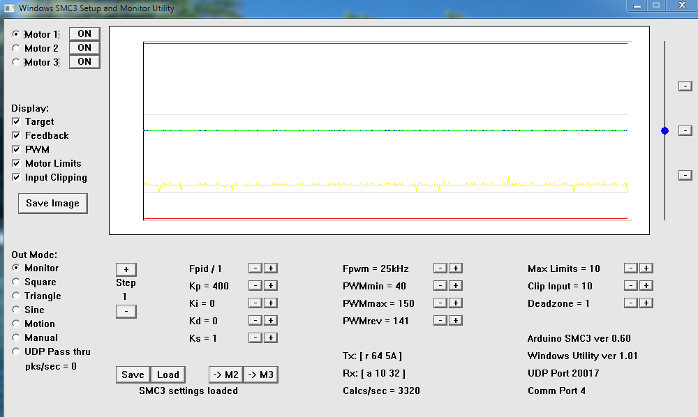

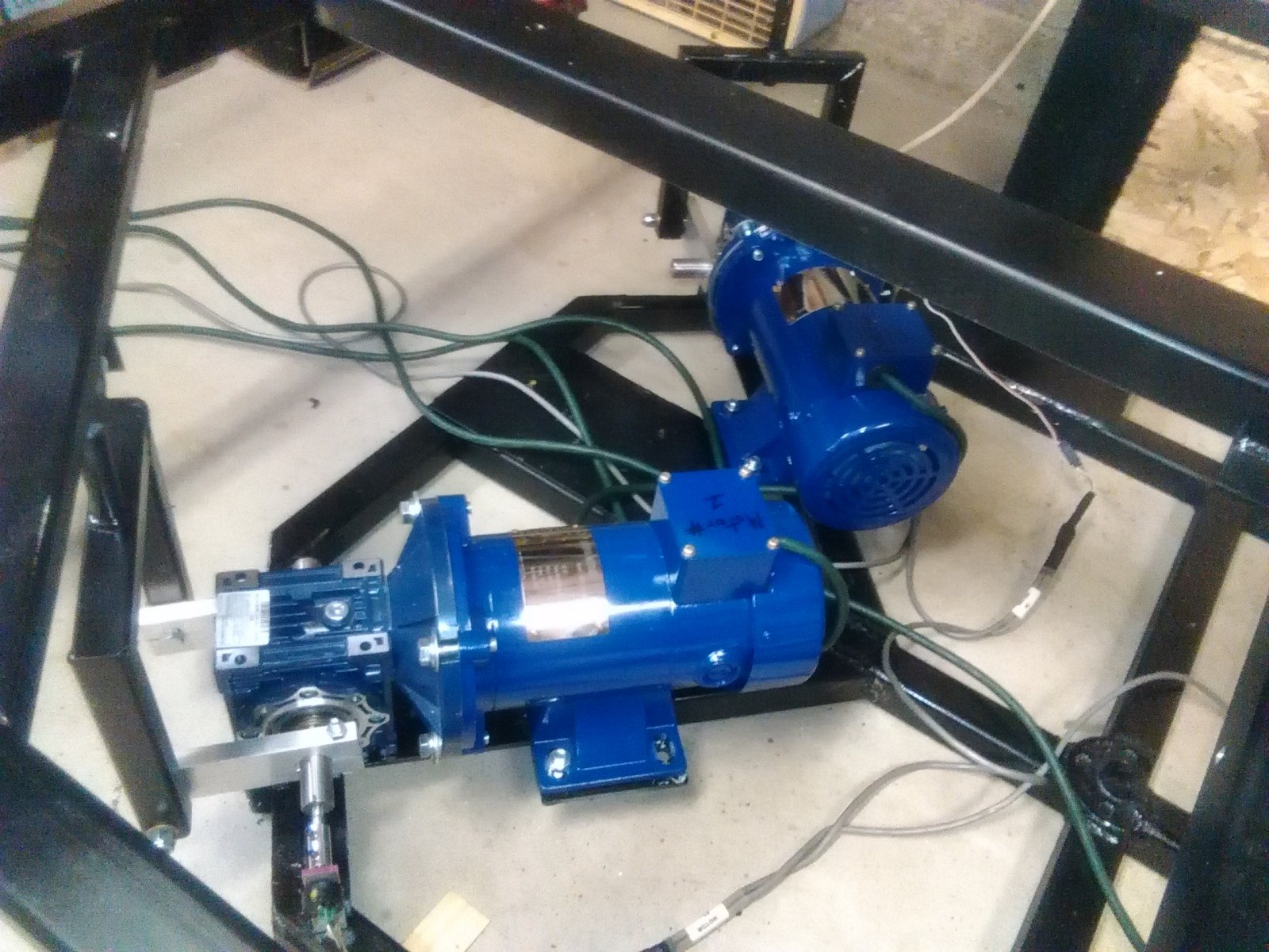

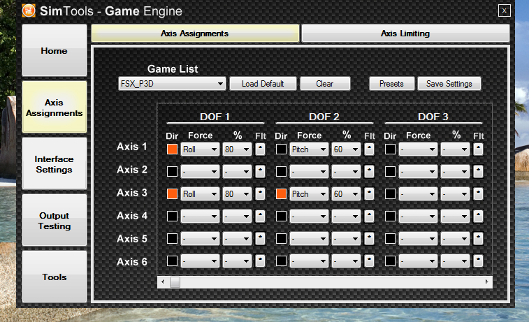

    Well I am happy to say that the motion is working. (I did not have my Axis Assignments set right) I have pitch and roll however the old problem I had before did not go away and that is that when the accurators reach the max or minimum they do not return to center. I installed a reset button on my platform so that I can get them to center as I am flying. I would prefer not to use the reset as a fix. I don't know if it is the settings that I have or one of my controllers are bad. They are the cheap ones and I probably should up grade to a better one. I will tell you I have the old version of Sims Tools installed 2.1 but it has worked well for me before I switched to the worm gears and new motors. I have posted my setup utils using motor #1 and #3 and from the picture I posted above you can see I have them setup in a "Y" arrangement. along with a swivel post center. Any help with this is appreciated .

    I changed out some settings and controller board and thought I had solved my problem. But not. Here is what
    I can tell you:

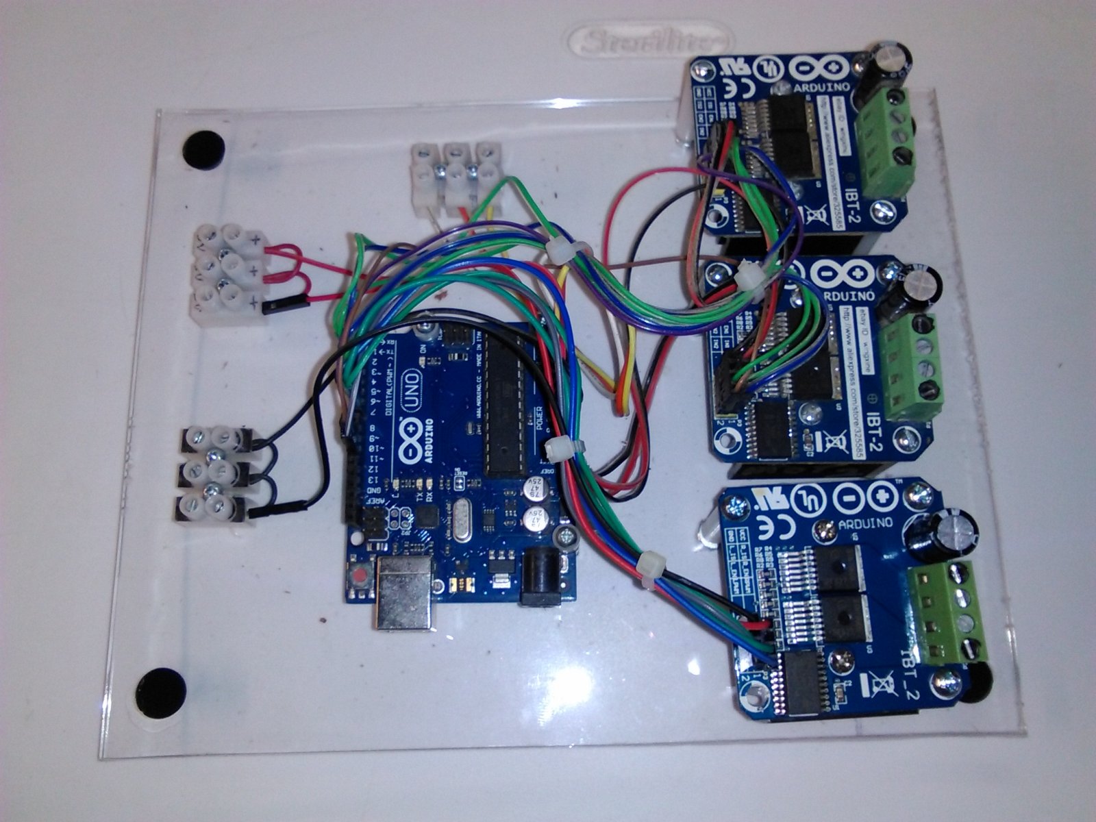

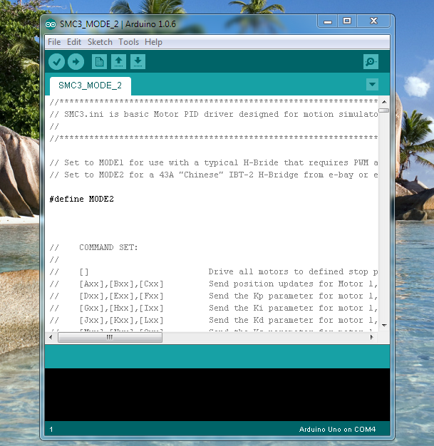

    I am running Sim's Tools on two computers using Arduino sketch SMC3 mode-2. The motor controller board assy. consist of 2 ea IBT-2 Arduino 43 amp cards. 1 ea Arduino Uno board powered on com-4 and my power supply is a Power Max 12vdc 55 amp output.

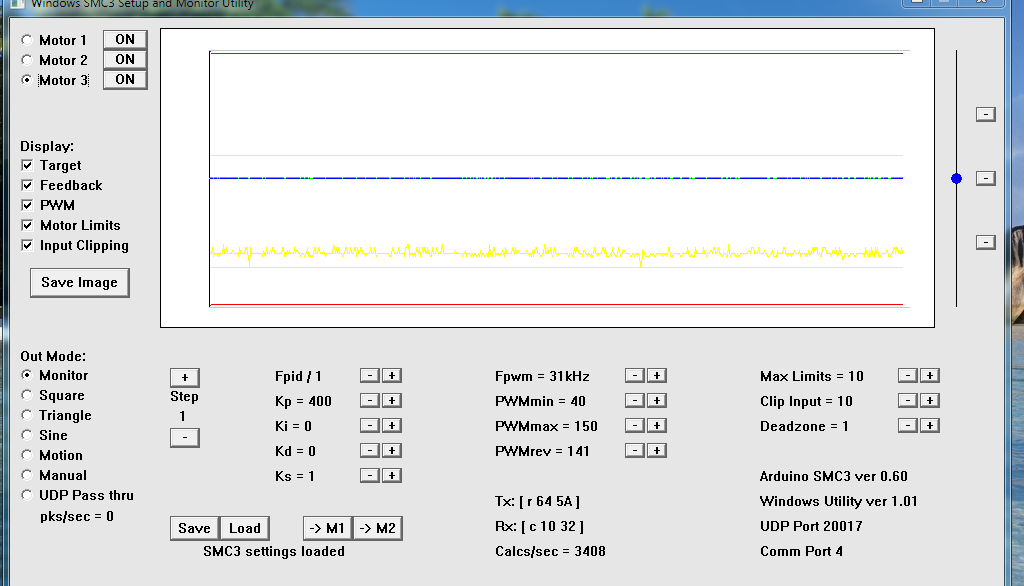

    here are my SMC3 utils settings for both motors.
    FPID=1
    KP=400
    Ki and Kd=0
    Ks=1
    FPWN=25KHz
    PWMmin=40
    PWMmax=150
    Max limits=70
    Clip limits=75
    Dead zone=1
    It seems to me or in fact it does hang up when I do a bank right or bank left. I need to push the reset button to get the accurators back to center. One note, this worked when I was using the 12vdc winch motors but since I changed them out with 12vdc 1/4hp 56C TEFC permanent magnet motors along with the worm gear reducers I have had a problem. It works when I use the SMC3 utils program. I can run manual ,motion,sign waves and all is good. It just don't work in game.
    Thank You
    Terry
    21,595
    151,233Coins
    You can possibly have game related settings and circumstances where the motors reach and exceed the limits set in SMC3, which will result in a motor shutdown, for safety reasons. Is that what is happening?

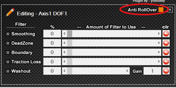

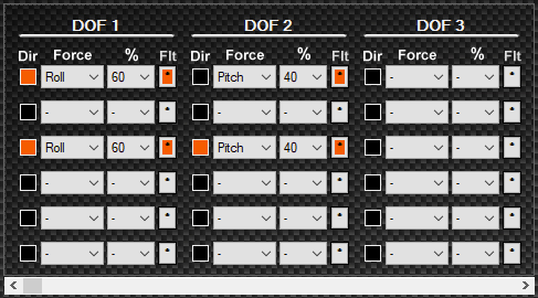

    Maybe try using SimTools v2.5.1 and the Advanced axis plugin, so you can use the anti-rollover filter.
    I'd try settings like this.
    With the roll's at 60% and the pitch's at 40%, this way you are using 100% of the axes (and not more, avoid top out's)
    Next click the 'flt' button for each one and set the anti-rollover filter for each.
    Next go into youy Max/Min setting for the game and set roll and pitch Max/Min to 90/-90.
    Test out the new settings, it should have motion no matter what you do in the plane.

    I am confused by what you say Next go into your Max/Min setting for the game and set roll and pitch Max/Min to 90/-90. Is this the axis limiting you are talking about?
  12. yobuddy
    5,408
    50,691Coins
    +5,166 / 19 / -0
    Hi @terry wells,
    In this section buddy.
    Click 'Capture Max Min' and change the max and min roll and pitch settings to -90/90 and then click 'Save new Settings'.

    Thank you @yobuddy for the advice. I have a question to ask, if I am using ver. 2.1 Sims Tools do I need to have the fit. set in the edit axis and if so would that be all or just the smoothing and what would you recommend to set it to? btw I set the min and max to 90 and motor #1 still stops working when the actuator is in the upper most position, I need to use the reset button.

    If it works without you on the sim, maybe the new motors take more power when in a full tip, and is unable to deliver the power needed to return to center?

    seems a little strange because the motors I have now are much better than the winch motors I was using early and had no problems like this.

    It is likely more a case of control, the more powerful the motors the greater the need for accurate control.

    @noorbeast thank you. After thinking about it for a while I see where the newer motors may need more power. I am going to try some things and see what happens next. Do you think I should up grade my motor controller boards and if so what would you recommend I use for a 12vdc system?? Will the FSX and P3d plug in work in the demo mode??
