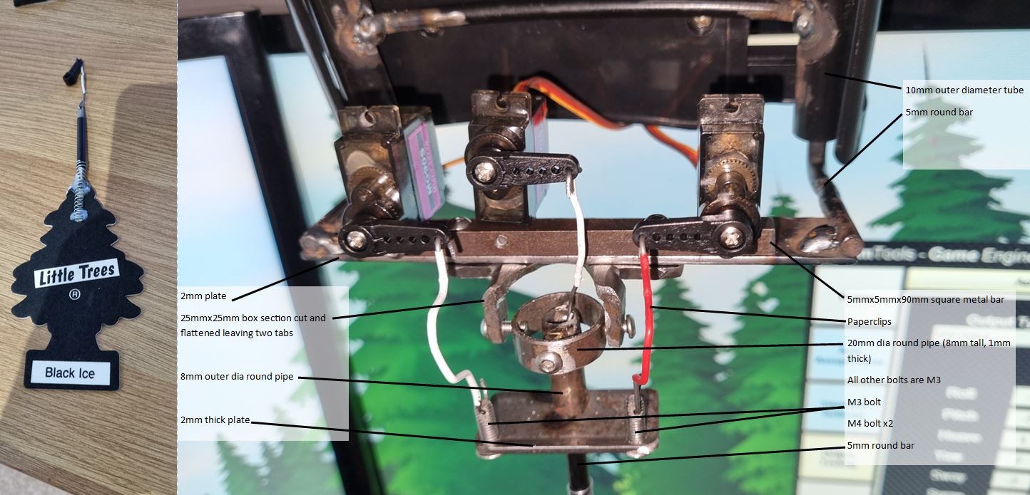

    V3 of the scented tree rig.

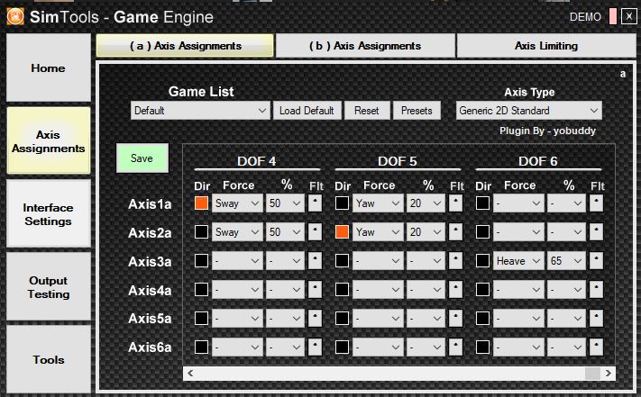

    made a small metal frame to hold the servos which can be attached to a flexible mobile phone holder i had. I've added a third servo to the design which can deal with heave movement and allow sharp up downs for bumps etc. To allow the tree to still flex a little its attached by spring, but i think its possibly too loose as it droops a little in the banking corners.
    this is my settings, i think i could get more cornering rotation, but i found when i set it too high the servo jumped to default position then would operate out of position, is this common and an easy fix? i assume setting limits or the like?

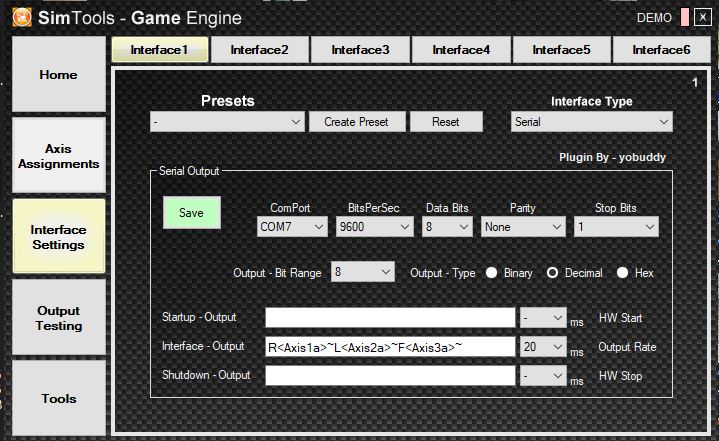

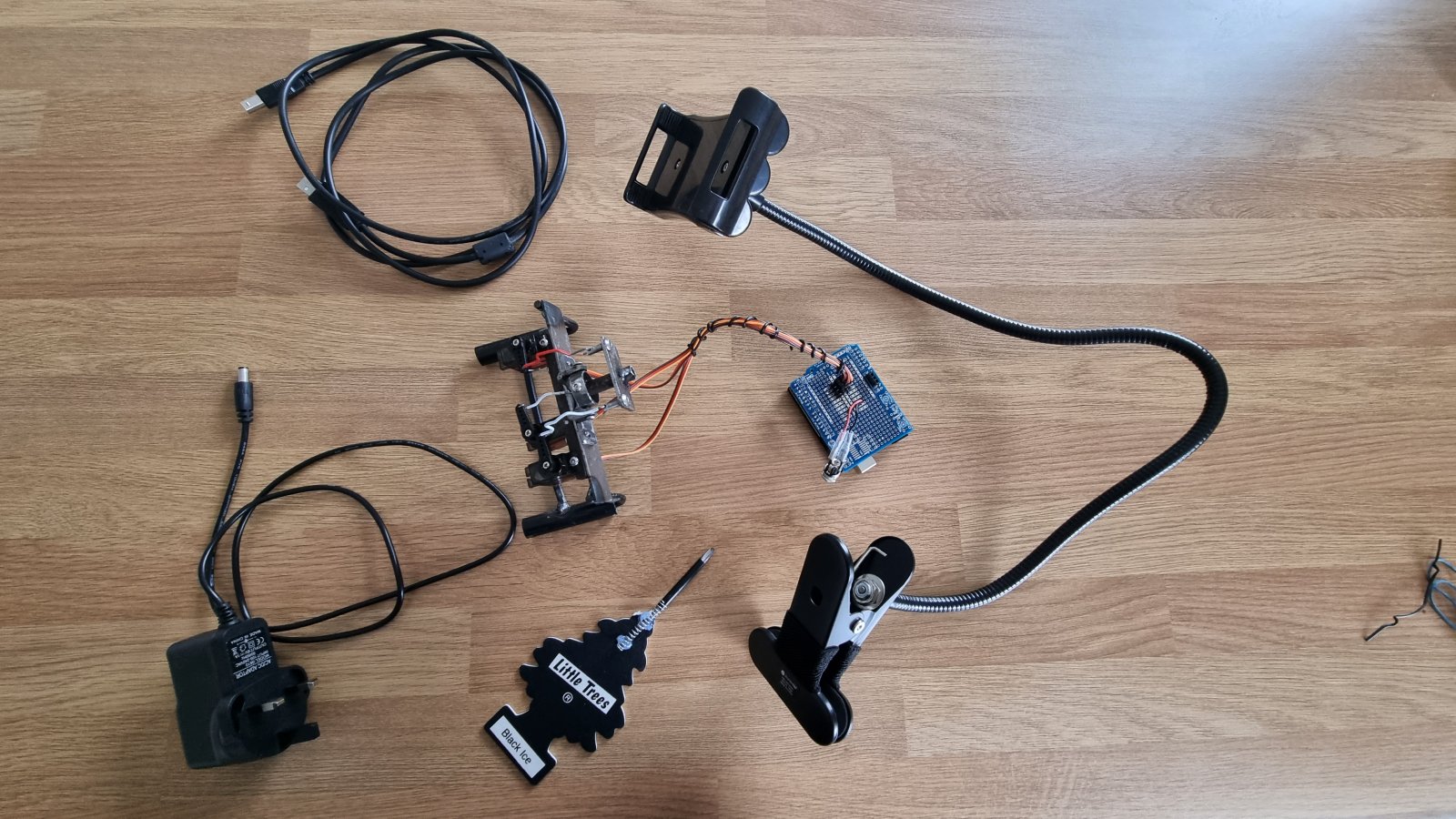

    while this is much less serious build than the typical projects on here, i did find it a very good introduction to Simtools. if anyone else would like to build their own version i've compiled a bit of a build guide and pulled in some of the FAQs which helped me along the way.
    Total parts list
    Arduino Uno, MG90 Micro servos, 6v DC power supply, blank Arduino uno shield and PCB header and scockets (though a servo shield would probably be easier) goose-neck phone holder, scented tree, paper clips, small spring (roughly 40mm long, 7mm diameter), assortment of metals i had laying around (see servo mount section), m3 bolts x9, m4 bolts x2

    The main difference between my design and a typical motion rig (or mini motion rig like @insanegr ) is because this is hanging, and only supporting a small length of round bar, spring and scented tree, it can have a servo dedicated only to heave motion. see video below and picture showing what each component was made from. I'm aware its a little rough looking but it was made from scraps and i'll probably do some more testing then paint it.
    The tree i just used a spring with a slightly smaller inner dia than my round bar so friction holds it in place then used a hot glue gun to attach the tree
    The goose-neck phone holder clamps onto my montior arm, and the servo mount simply clips in like a phone would and the phone holder alows full movement to align everything to the screen in game.

    The Arduino code and was thanks to @eaorobbie which can be found from this post which also includes a circuit diagram, though i also added an additional servo which Insanegr also explained how to do.
    http://www.xsimulator.net/community/threads/2dof-simulator-servo-model.6851/#post-7727
    For neatness i made my own Servo shield but would probably be easier just buying one
    Simtools
    As someone new to xsimulator.net and servos and motion rigs i found the following sheer volume of FAQs a little overwhelming at first so have listed a handful i got the most out of
    https://www.xsimulator.net/community/faq/rtfm-start-with-the-official-simtools-documentation.117/
    https://www.xsimulator.net/community/faq/steps-to-create-a-motion-profile.228/
    https://www.xsimulator.net/community/faq/tuning-centre-and-axis-settings.240/
    https://www.xsimulator.net/co-ordinate-system/
    Remember to run a race in LFS before using simtools.
    here are the settings i used
