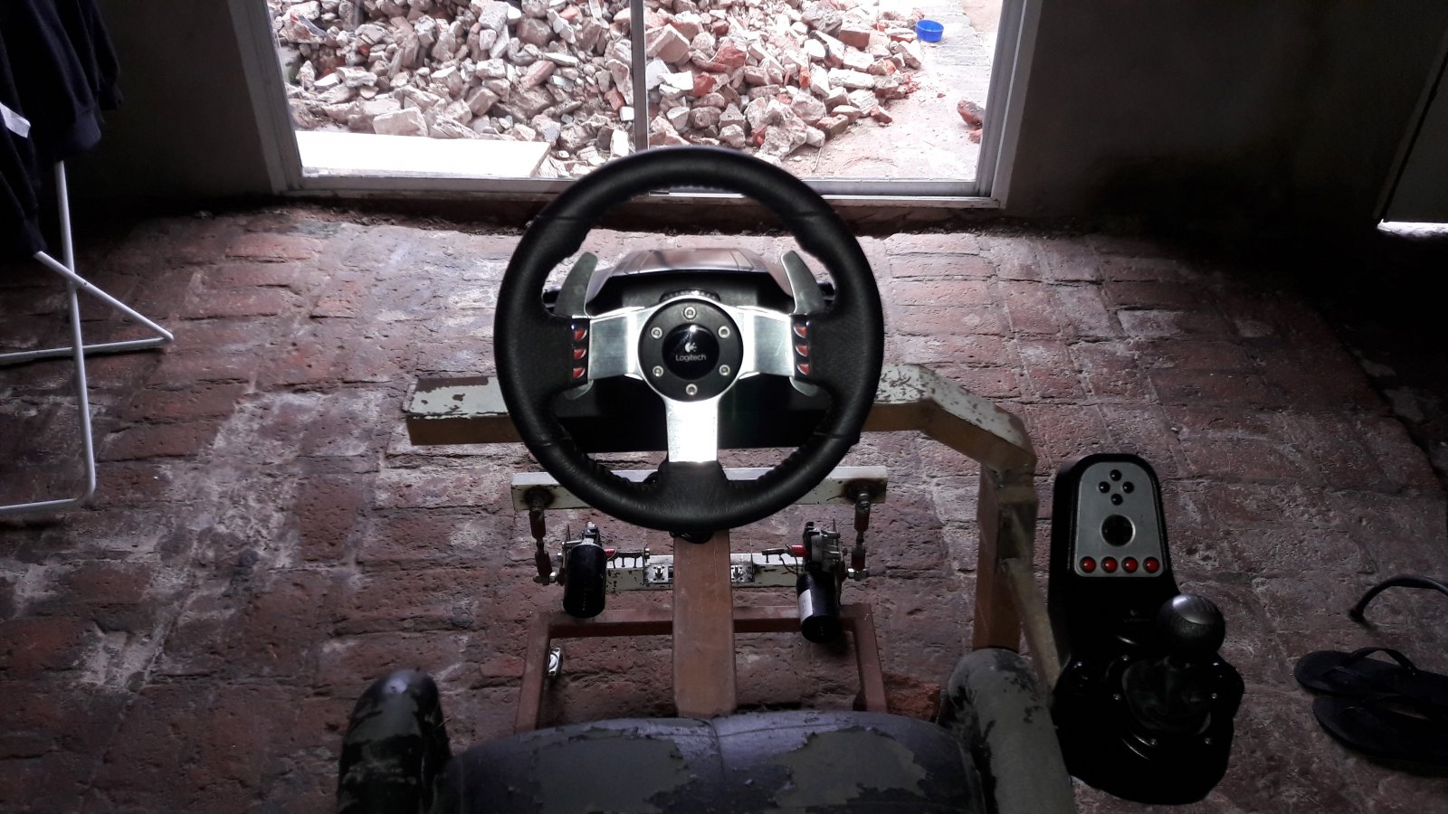

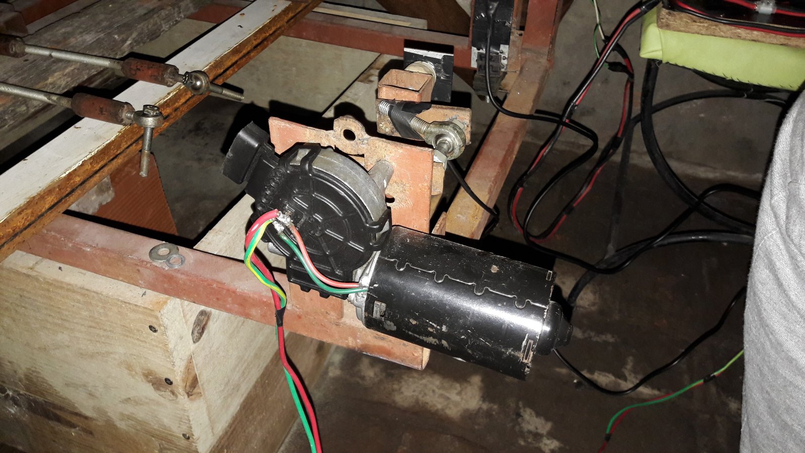

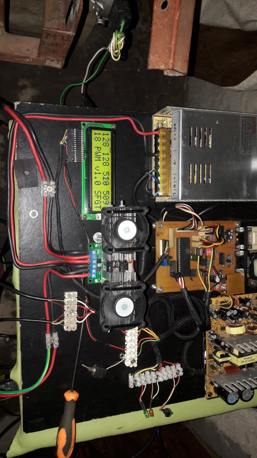

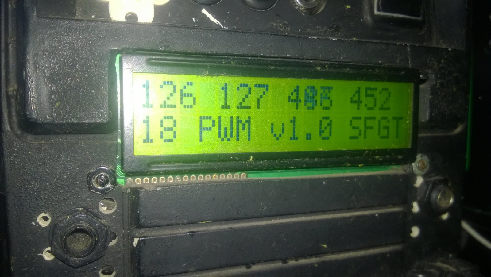

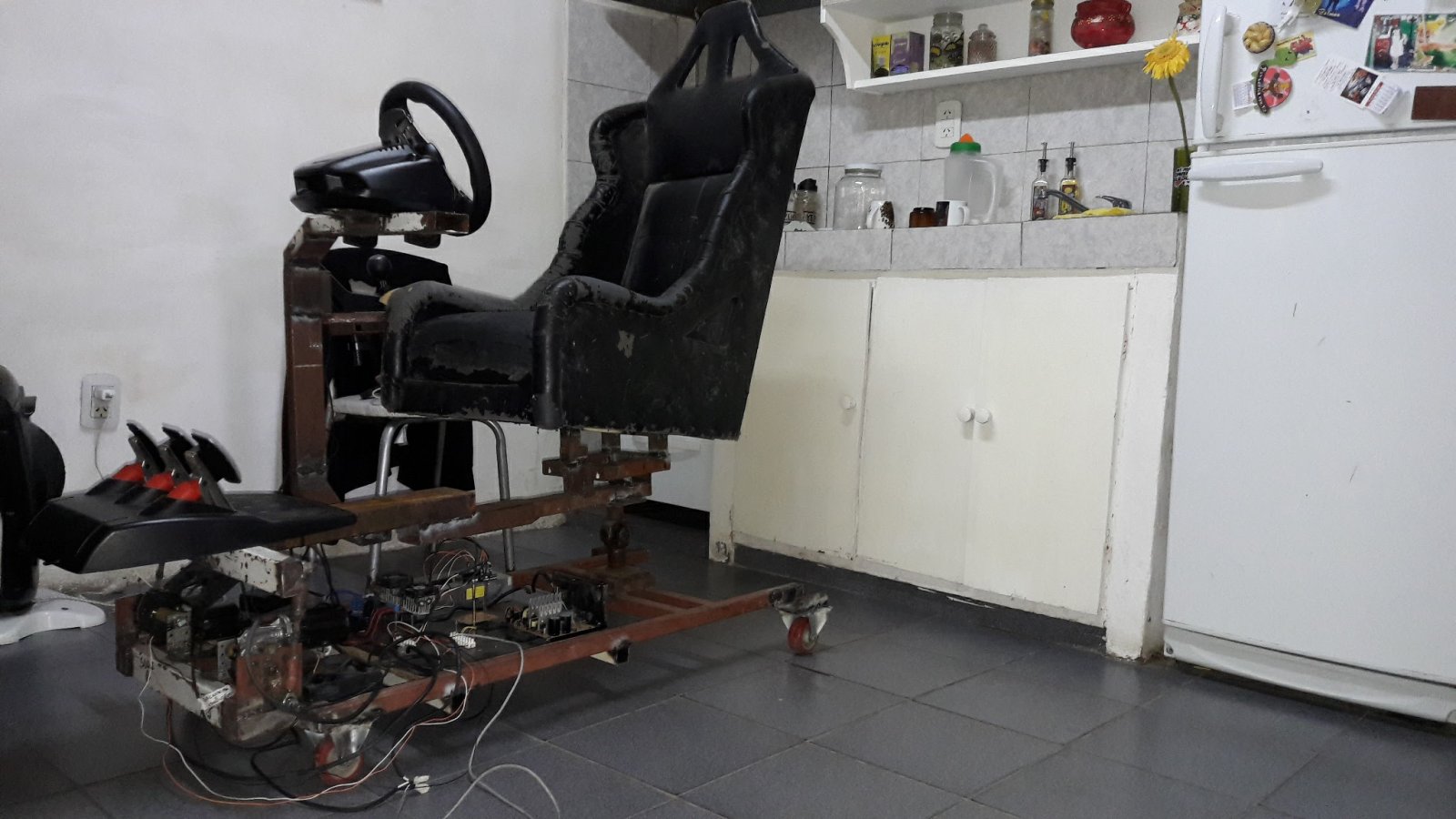

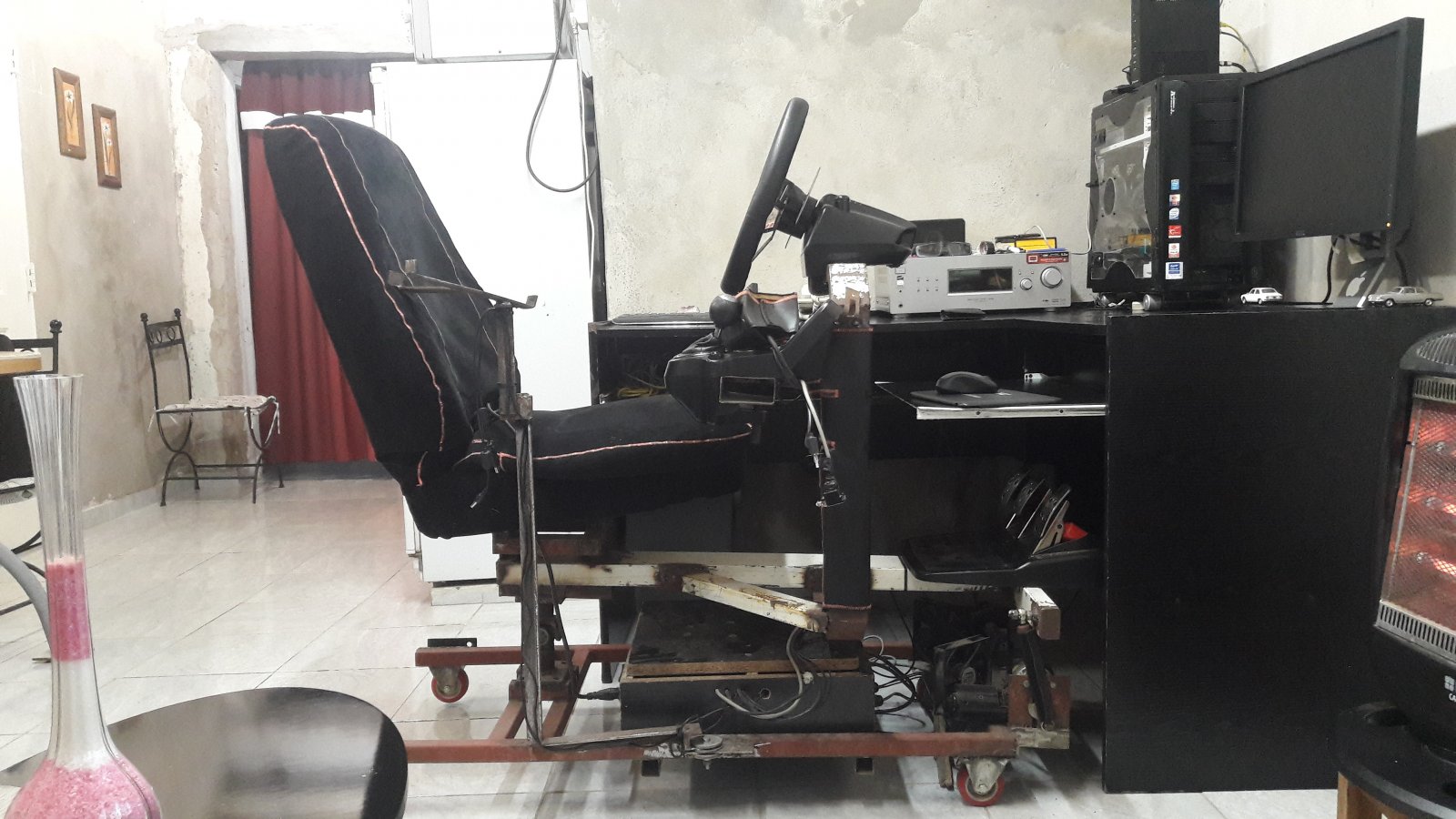

    Les muestro mis videos desde mis inicios con el mundo de la simulación y con simtools ... gracias a los miembros del foro por permitirme ser parte de este mundo de simulación que para mi es parte de mi vida. primero pongo videos y luego pongo un par de fotos de mis inicios que ya llevo un par

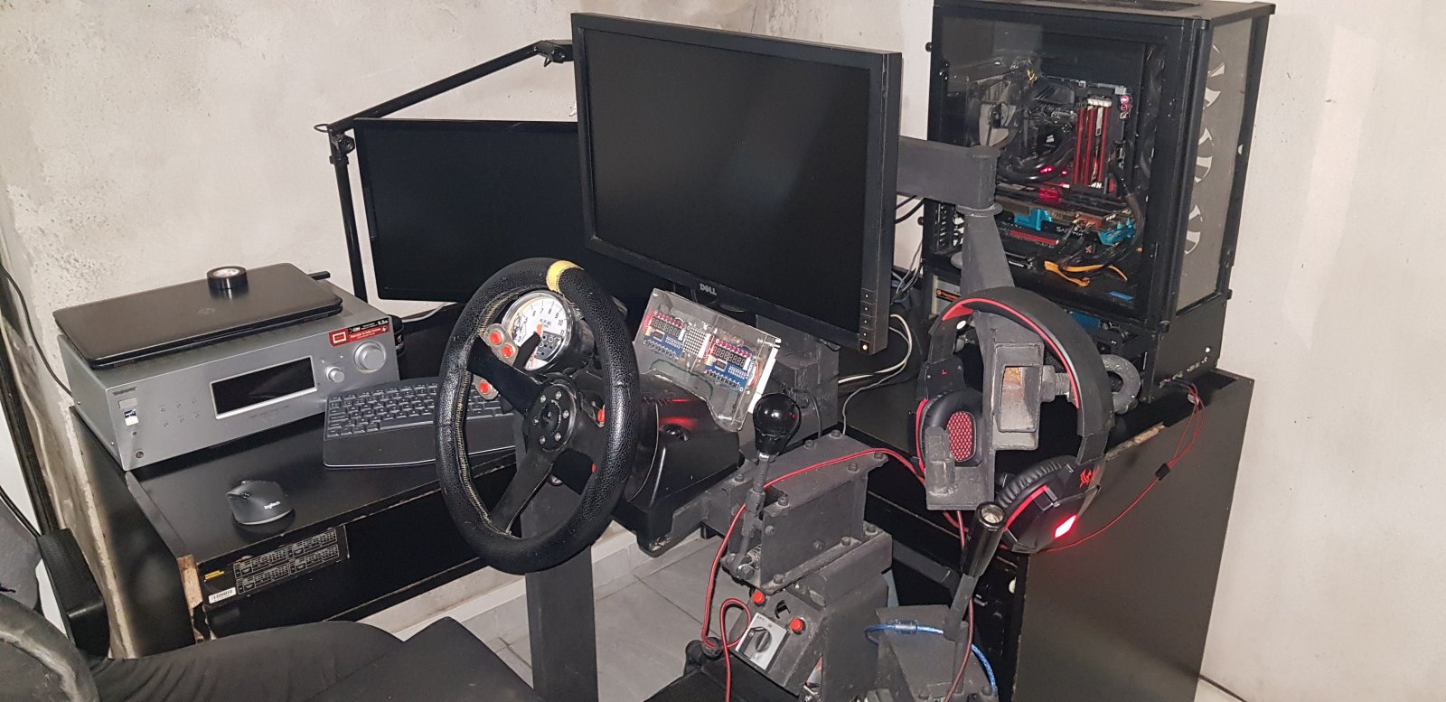

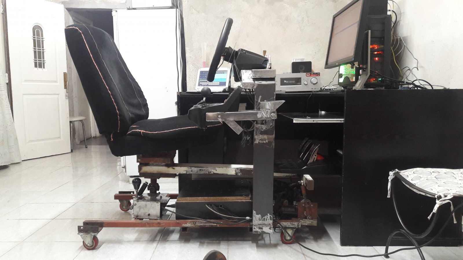

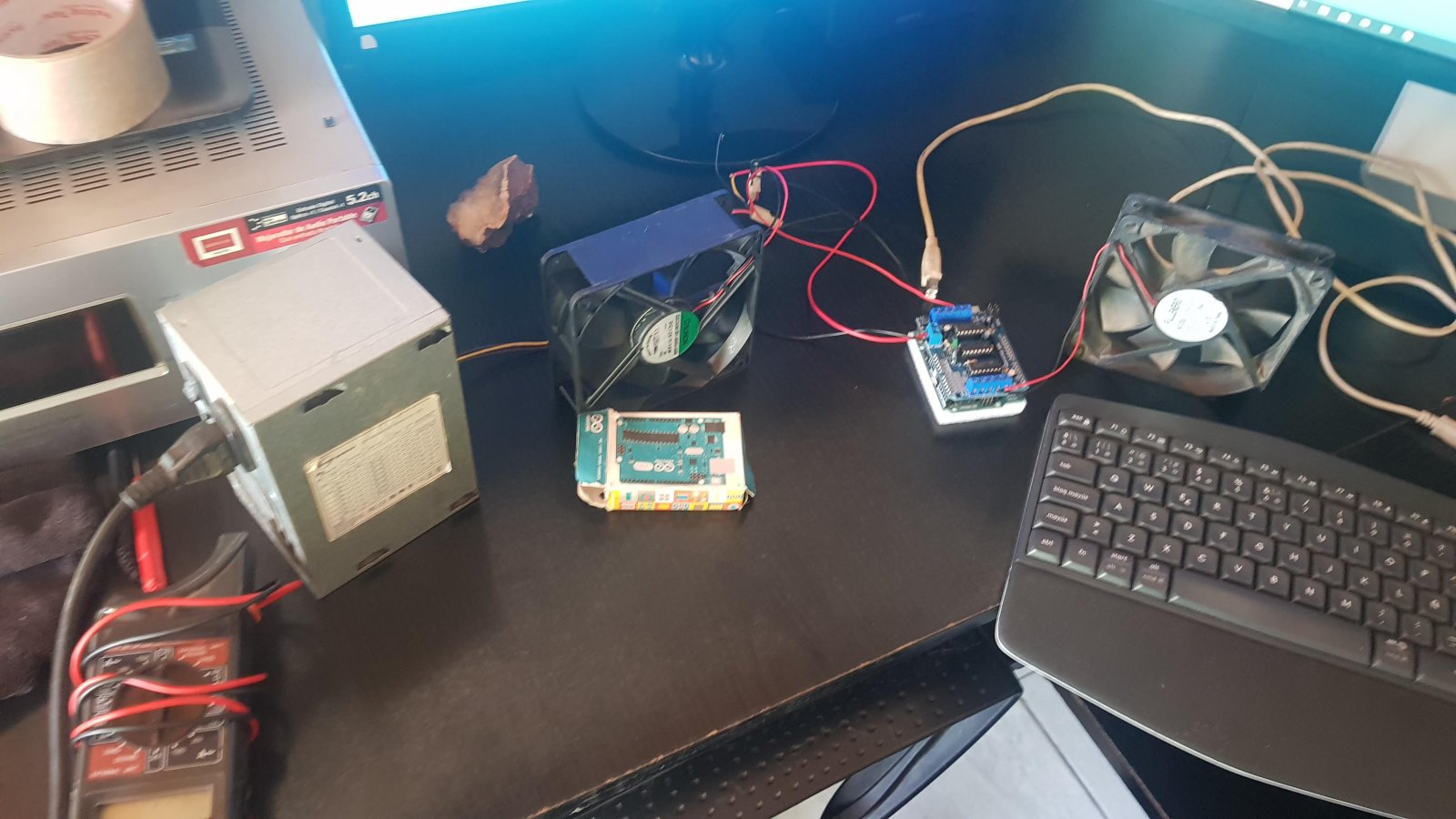

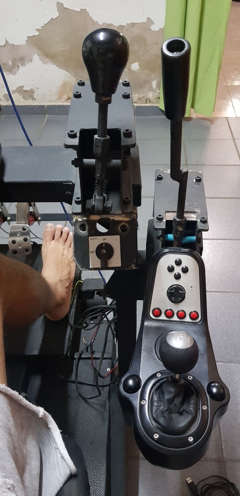

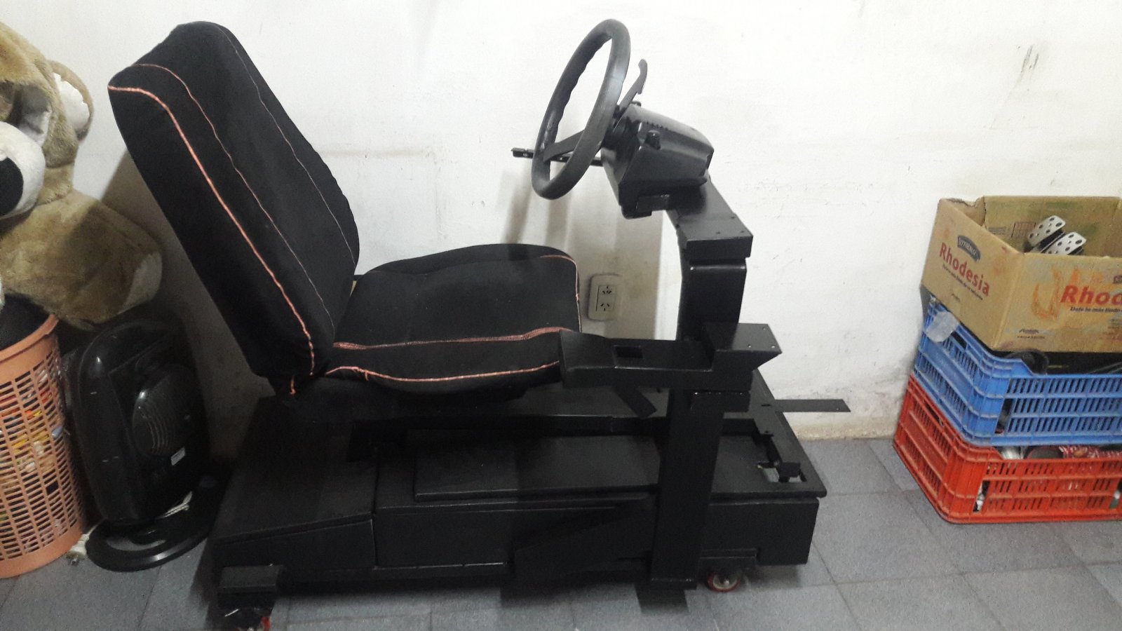

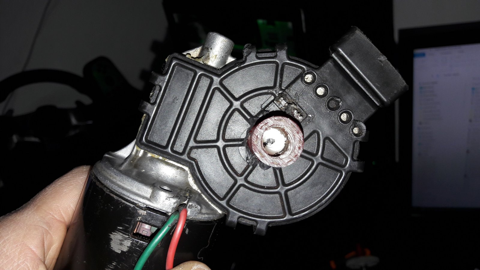

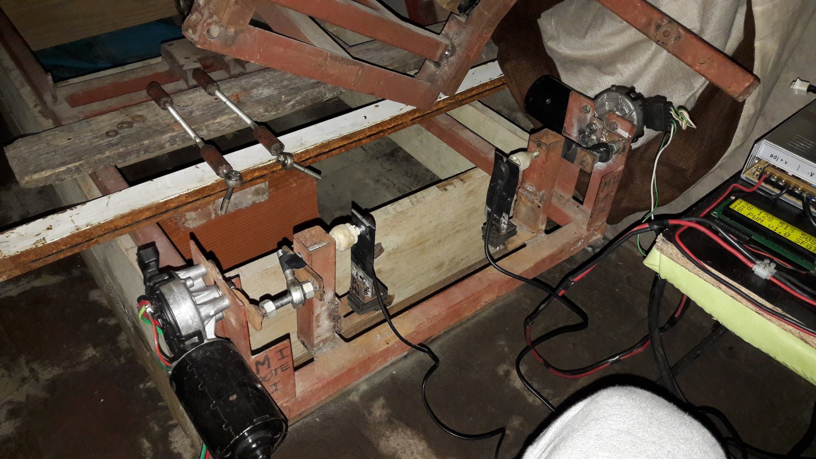

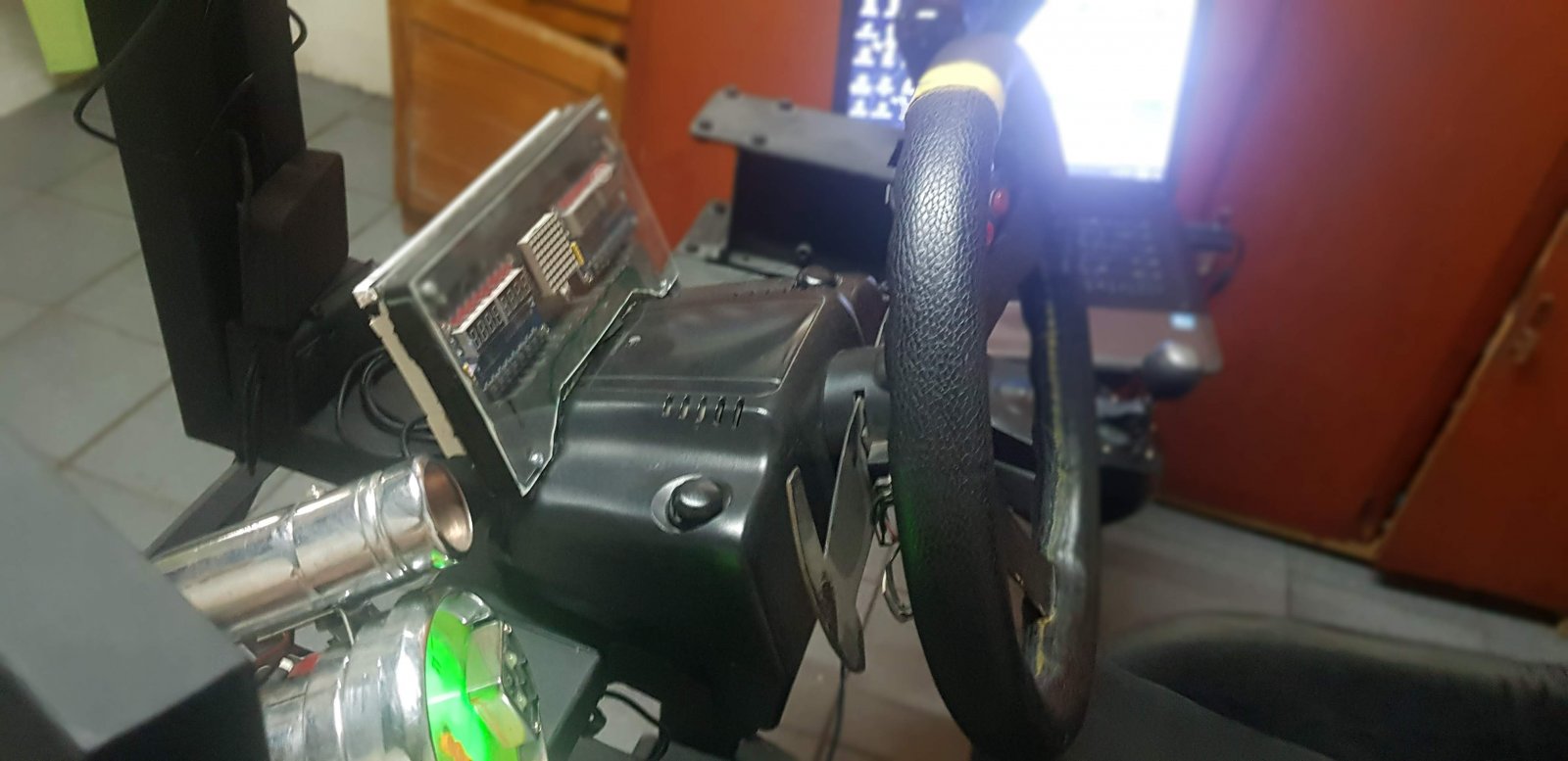

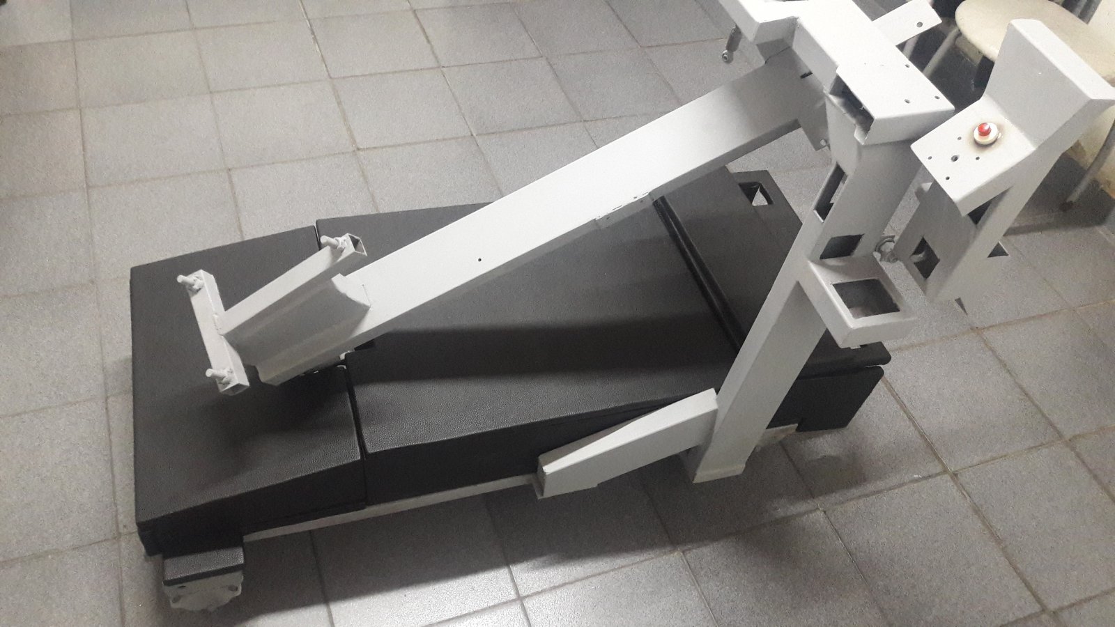

    01.jpg 02.jpg 03.jpg 04.jpg 20160717_202431.jpg 20160717_202438.jpg 20160717_202446.jpg 20160722_220223.jpg 20160722_220245.jpg 20160723_121617.jpg 20160728_232021.jpg 20160729_110239.jpg 20160729_125023.jpg 20160730_180618.jpg 20160731_012939.jpg 20160731_122713.jpg 20160820_161116.jpg 20160820_161158.jpg 20160925_122927.jpg 20161114_193234.jpg 20170201_224325.jpg 20170629_214055.jpg 20170924_220802.jpg 20170928_221615.jpg 20170929_221754.jpg 20171118_235511.jpg 20171119_115746.jpg 20171128_191134.jpg 20171202_232406.jpg 20171210_235236.jpg 20171210_235255.jpg 20180221_220954.jpg 20180313_202647.jpg 20180320_194626.jpg 20180320_194717.jpg 20180320_194724.jpg 20180320_195340.jpg 20191222_083859.jpg 20191228_225920.jpg 20200124_215324.jpg 20200124_215609.jpg 20200209_134949.jpg 20200209_135009.jpg 20200209_135022.jpg 20200323_202108.jpg 20200323_202123.jpg 20200323_202137.jpg 20200413_183306.jpg 20200413_183310.jpg 20200703_021633.jpg 20200703_021639.jpg 20200819_234253.jpg IMG-20191222-WA0055.jpg WP_20151014_002.jpg WP_20151014_005.jpg

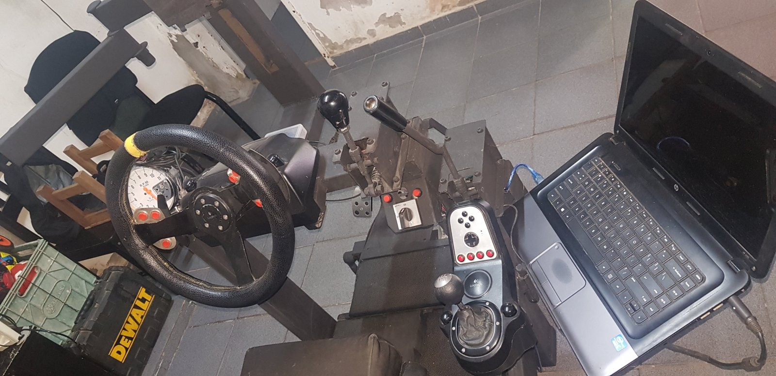

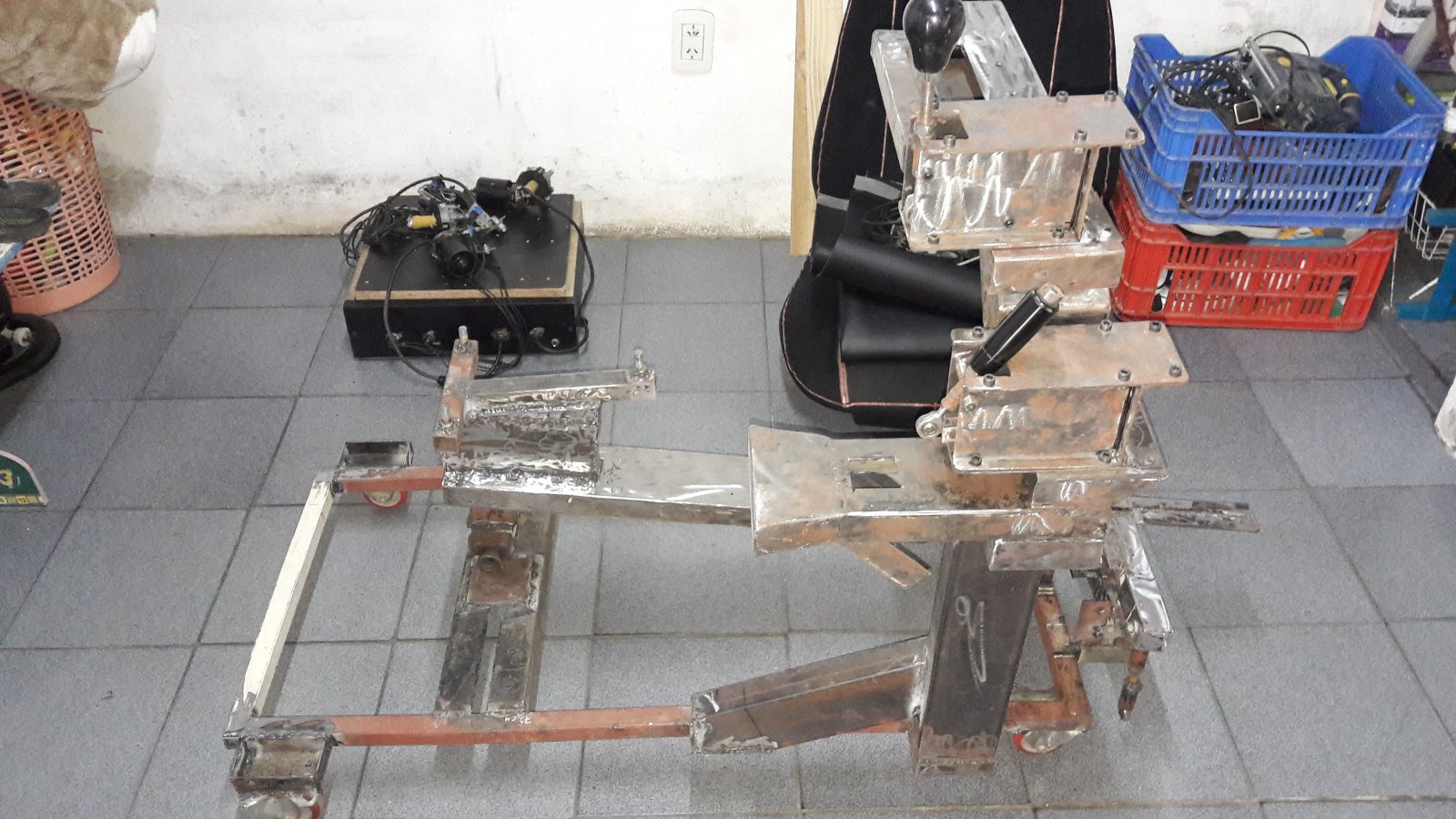

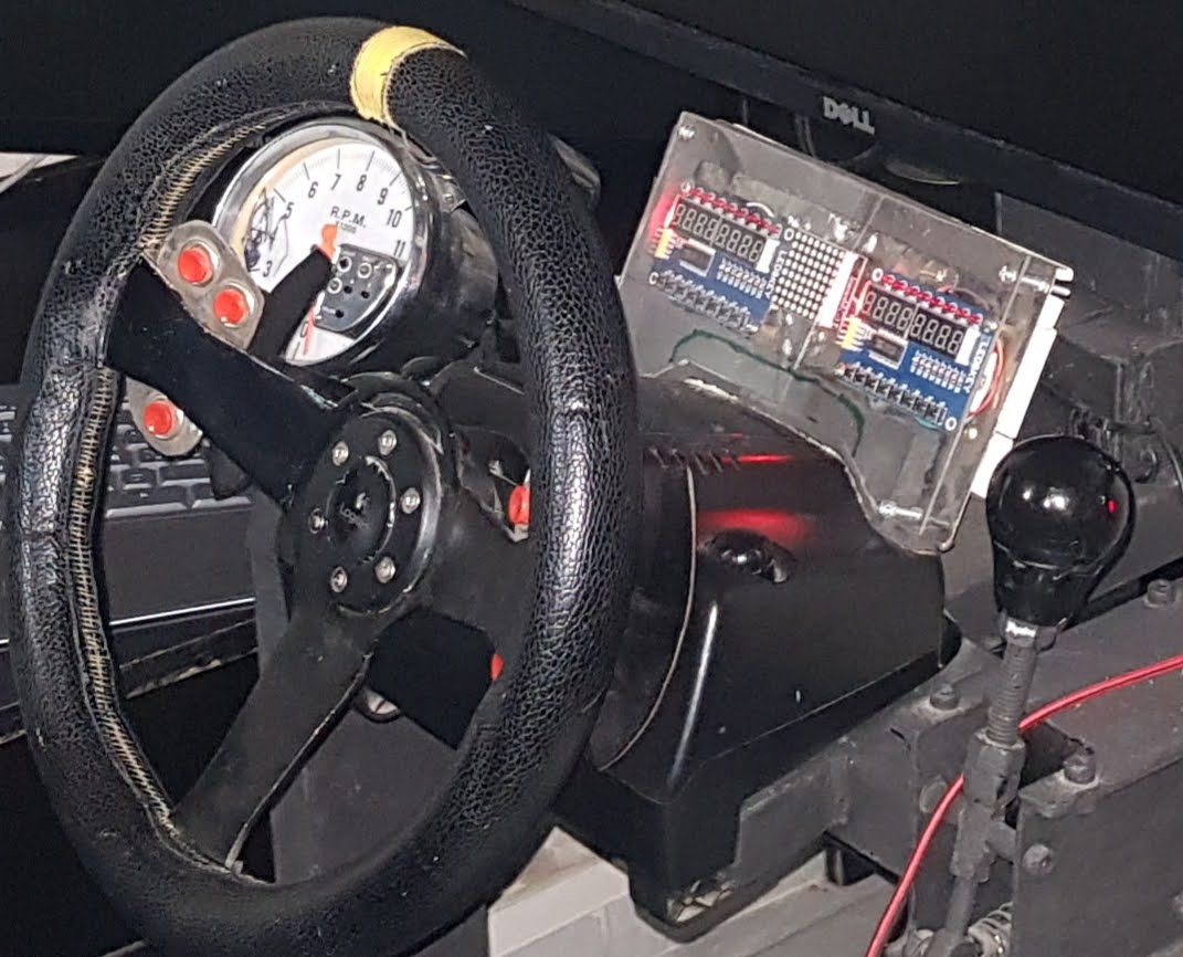

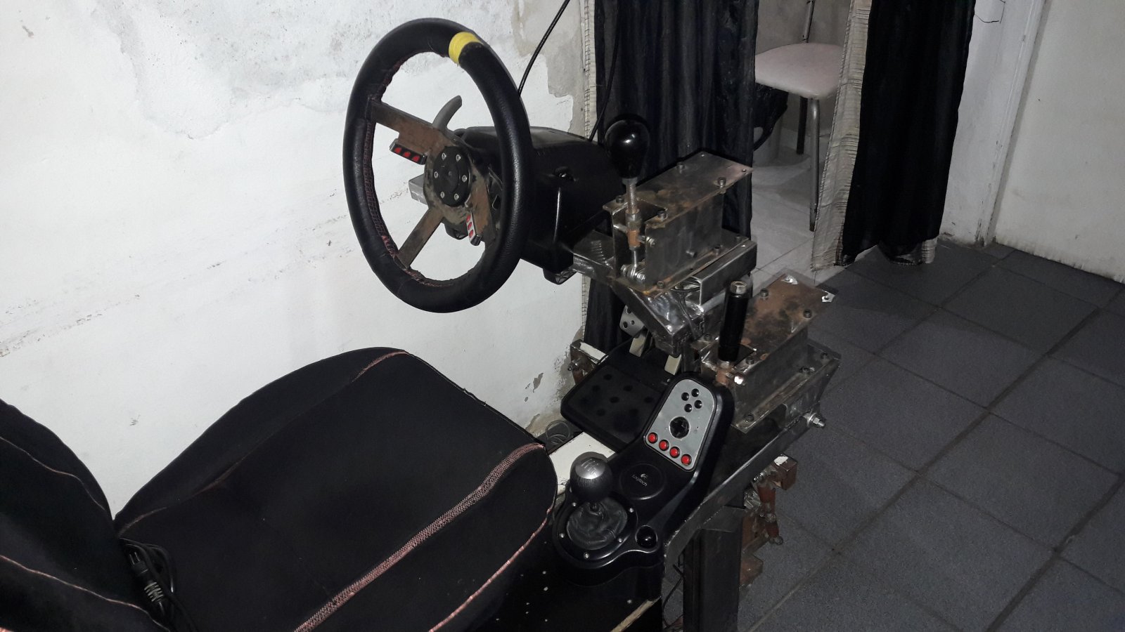

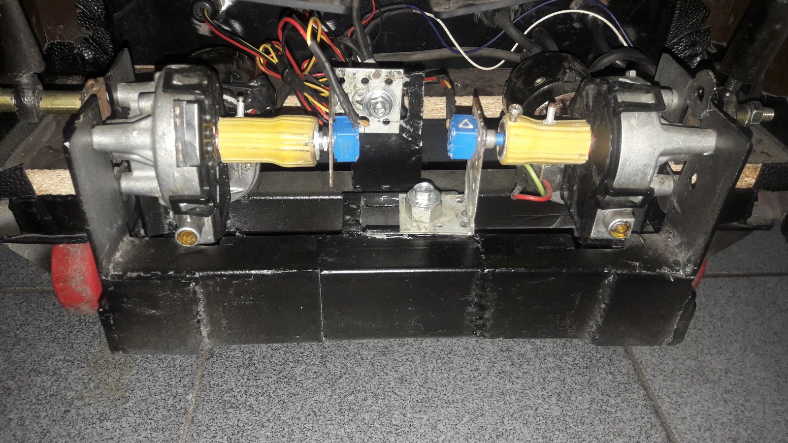

    Here I have a couple of photos of my beginnings, a couple of long years passed and changes of all kinds happened a couple of problems like everyone who got into these projects ... but that is the best thing that happened in my life entered this world thanks to simtools.

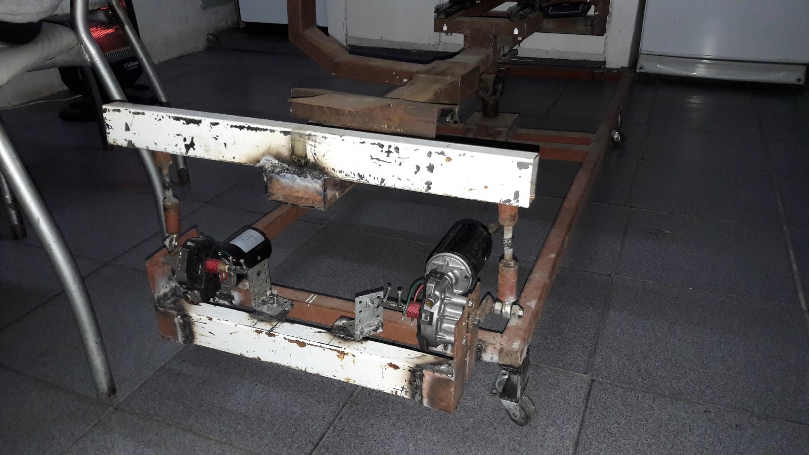

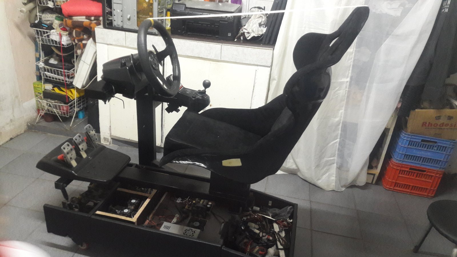

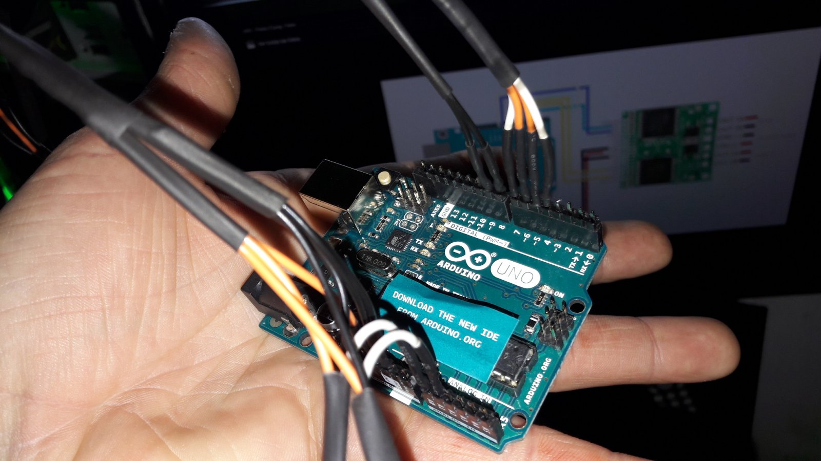

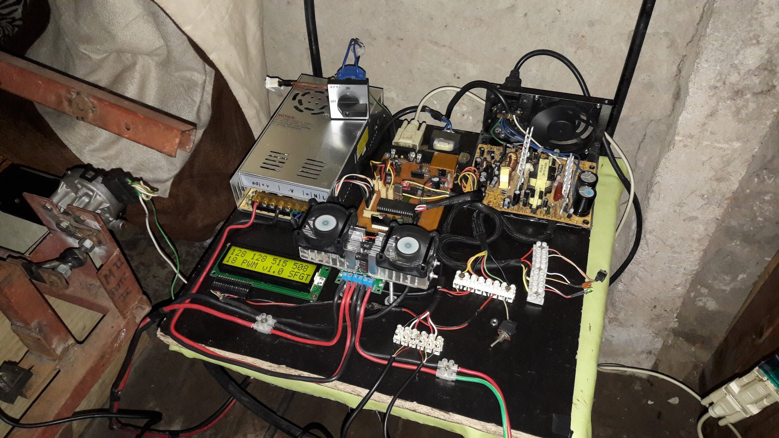

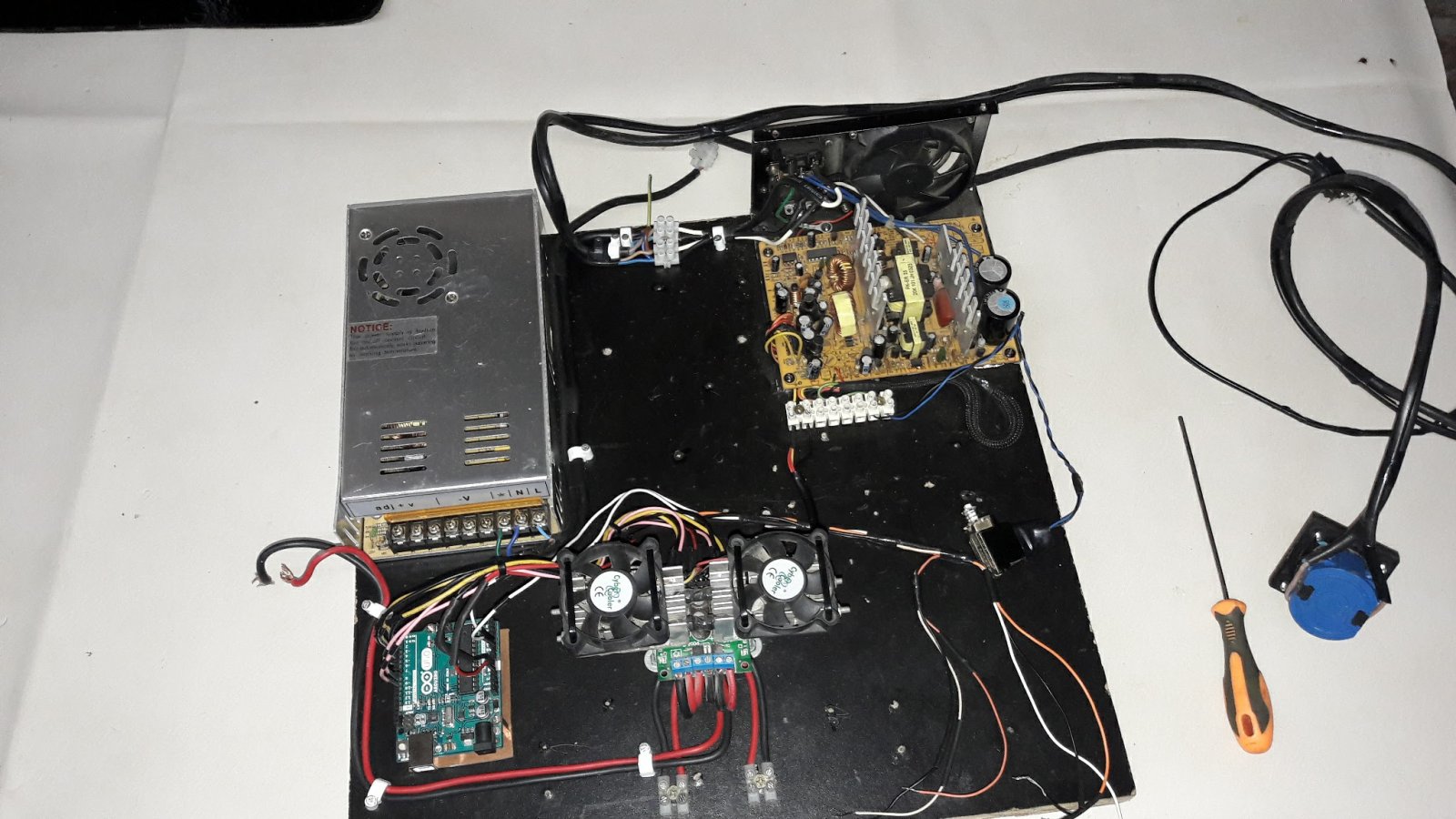

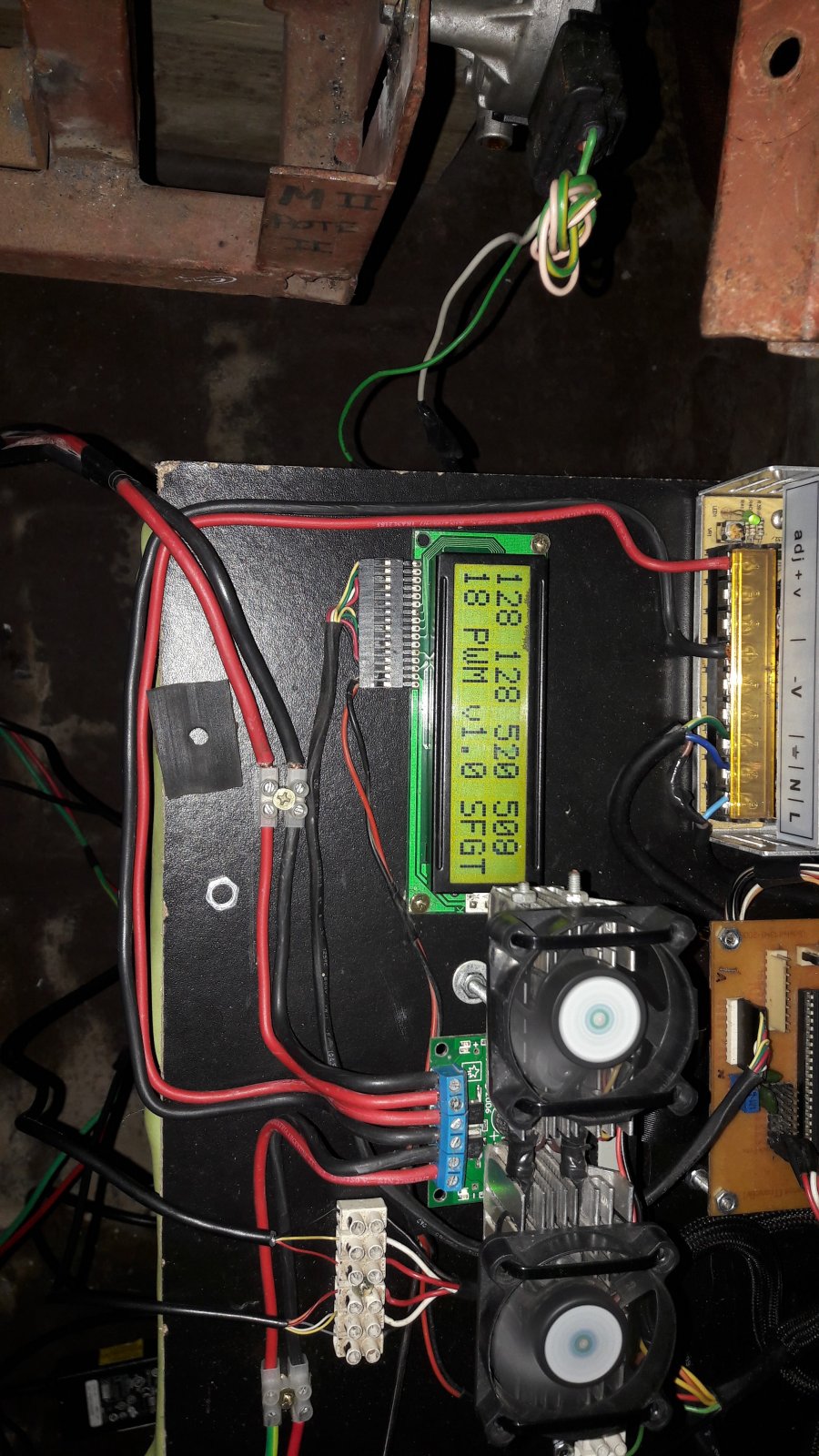

    I want to ask a question to the references of the forum or to anyone who has a 4dof I would like to study how I could update my simulator from 2dof to 4dof I want to know what arduino code I have to use to transform it into 4dof ... my idea is to put a second arduino board in the game engine interface2 with a monster shield VNH2sP30 and two more 12v electric cricket motors or what would be the arduino code that works best for 4dof
    20,549
    145,112Coins
    +10,778 / 52 / -2
    What 4DOF design and axis movement do you have in mind, could you please post a picture of what you would like to build as an upgrade?
    There is no problem adding and Arduino and controllers, that part is very straight forward.

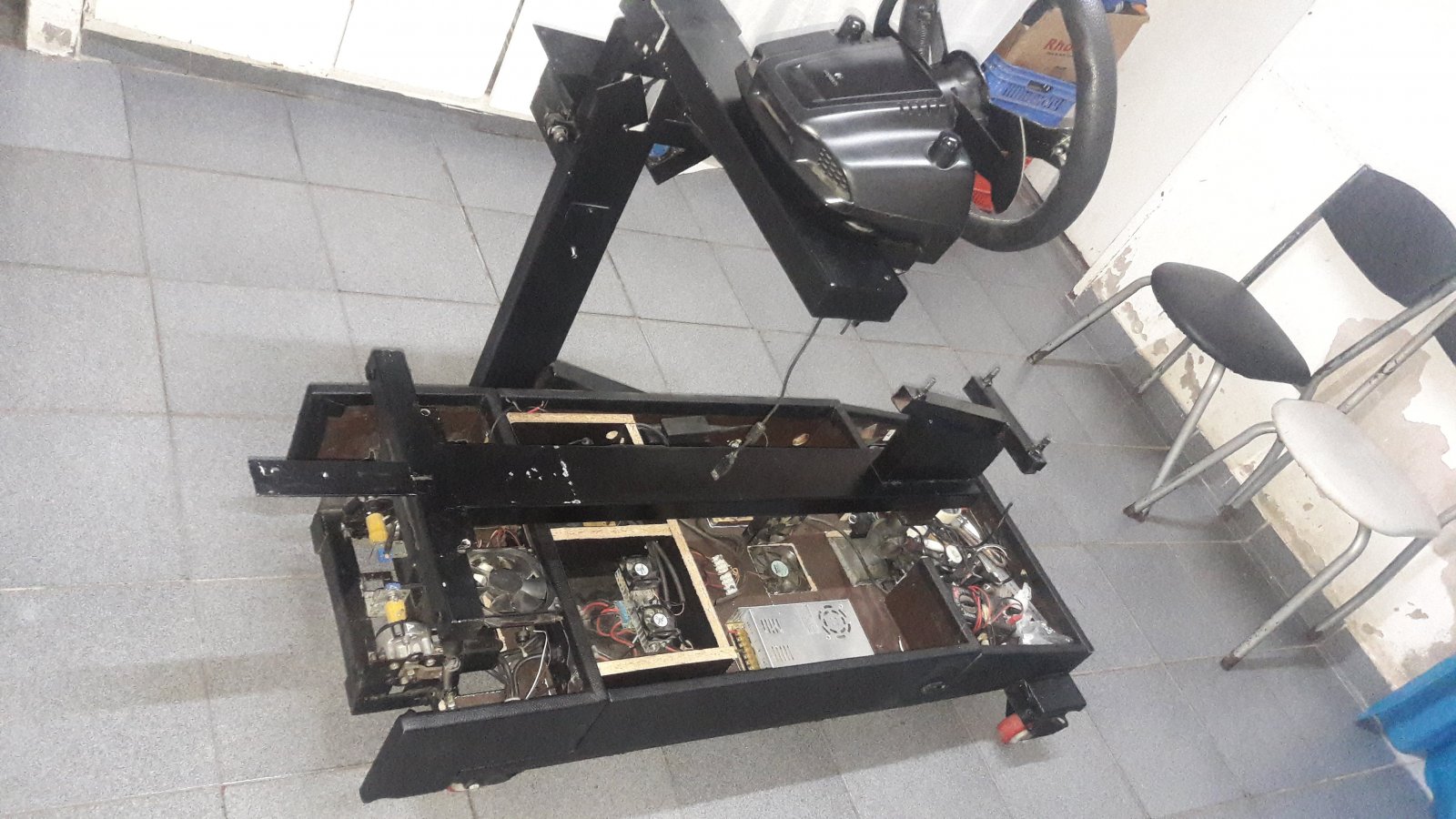

    I still do not have photos but my idea is to do the same as I go forward .... the two motors that I have now I have put them under the pedalboard and the other two would be behind the seat like the ones from VESARO I like those a lot I would have to change arduino code
    20,549
    145,112Coins
    +10,778 / 52 / -2
    The VESARO is a peg leg 3DOF design.
    Do you intend building actuators using your existing motors, or use rotating levers like on your existing rig?
    Personally I doubt the wiper motors have the torque to drive a 3DOF, without some sort of heave assist.

    no, I already updated the wiper motors I'm using electric cricket motors they are powerful they lift a ton each one I want to continue with that type of motors I want to put two more motors but in the back and the seat, the pedal board and the gear lever would remain suspended with a motor at each end ... so I can continue using the arduino code that I am using which is 3dof.
    20,549
    145,112Coins
    +10,778 / 52 / -2
    What are the specifications of the cricket motors?

    Now my question is that I can safely use the arduino code that I am using from 3dof and I can also use another arduino on interface2 with a monstershield with two of the same engines I already have ... I would use this configuration on interface1 with the first arduino [ A <Axis1a>] [B <Axis2a>] and interface2 is [C <Axis3a>] [C <Axis3a>]
    that it would be more convenient to use a second arduino with its h bridge and two motors connected in interface2 or change the connections of the first arduino with the two h bridges and the 4 motors ... to make a 4dof.
  12. noorbeast
    20,549
    145,112Coins
    +10,778 / 52 / -2
    Yes you can safely use another Arduino, but in Interface Settings use the Interface 2 tab and configure the second Arduino there, including its correct Com Port.

    So it is more advisable to use another arduino with its h bridge and its motors than to use an arduino alone with 2 h bridge ... another question and as for the arduino code I can continue using the same 3dof code in the second arduino.
    20,549
    145,112Coins
    +10,778 / 52 / -2
    Yes you can use the same SMC3 code on the second Arduino.
    As I understood it you would be adding 2 extra motors and if so an addition Arduino with another h bridge like you already have would be the way to go.

    yes .. I want to add a second arduino with its hy bridge and two more motors ... and I can use the same code from SMC3 DE 3DOF the other question that turns me on my head is I currently in the first arduino I have in interface - output [A <Axis1a>] [B <Axis2a>] that engine 1 and 2 works perfect for me ... and I want to know how it would be for the interface - output configuration of the second arduino it would be like this [C <Axis3a>] [D <Axis4a>].
  16. noorbeast
    20,549
    145,112Coins
    +10,778 / 52 / -2
    Yes you would configure Interface Settings like that for the second Arduino and two additional axis.

    well the parameters that I set for the second arduino are fine ... did you mean? and there are two new axles added to me that would be motor 3 and motor 4
  18. noorbeast
    20,549
    145,112Coins
    +10,778 / 52 / -2
    What I meant was that [C<Axis3a>][D<Axis4a>] will work fine for the second Arduino Interface Settings, just ensure you also assign the correct port.
