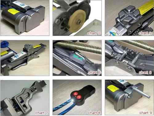

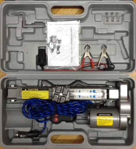

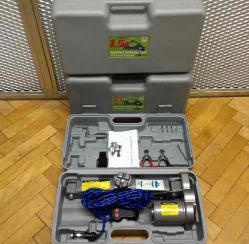

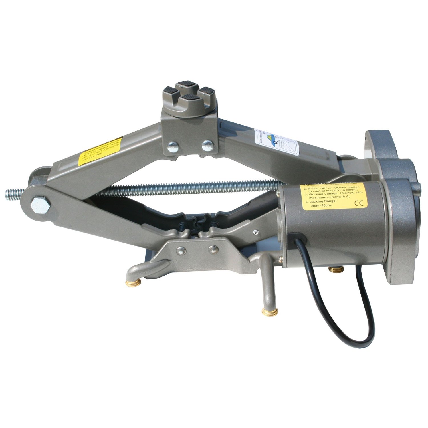

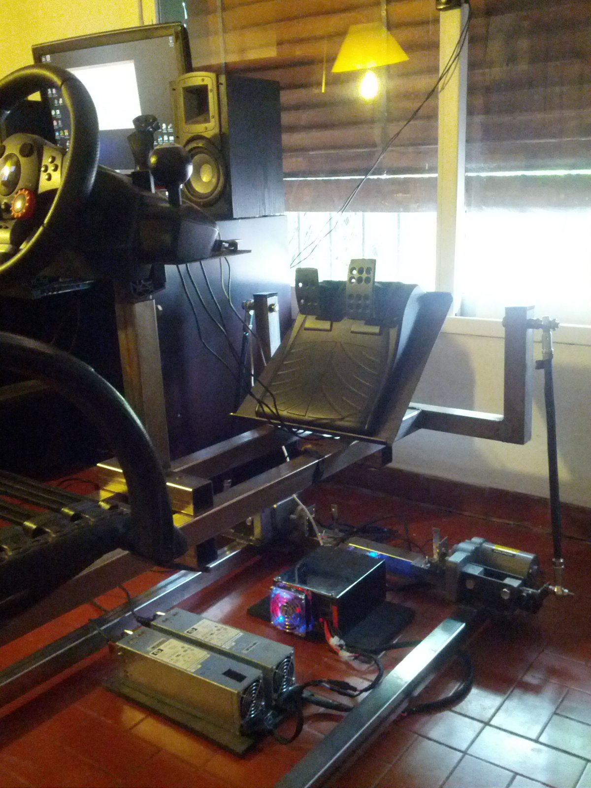

    For those fellow members that lives in countries that it is difficult to find suitable motors other than pitty wipers, there is another cheap alternative, introducing the "2Ton Electric jacks"
    These are 12v 120watts motors, using a 50:1 gear box (or near that...) and around 55RPM
    criquet-electrico-para-autocamioneta15tn-2tn--160501-MLA20337614733_072015-O.jpg criquet-electrico-para-autocamioneta15tn-2tn--13554-MLA133966356_9014-O.jpg 71xu9IH8jlL._SL1500_.jpg
    You can find these ones on Amazon for U$S60 http://www.amazon.com/Black-Bull-EJ212-Automatic-Electric/dp/B0027Z6F3W/ref=pd_sim_sbs_263_2?ie=UTF8&dpID=41lqJukJ9eL&dpSrc=sims&preST=_AC_UL160_SR160%2C160_&refRID=0S0KQBTFYEK0HV6YA7YP
    I got mines locally for U$S35 new .

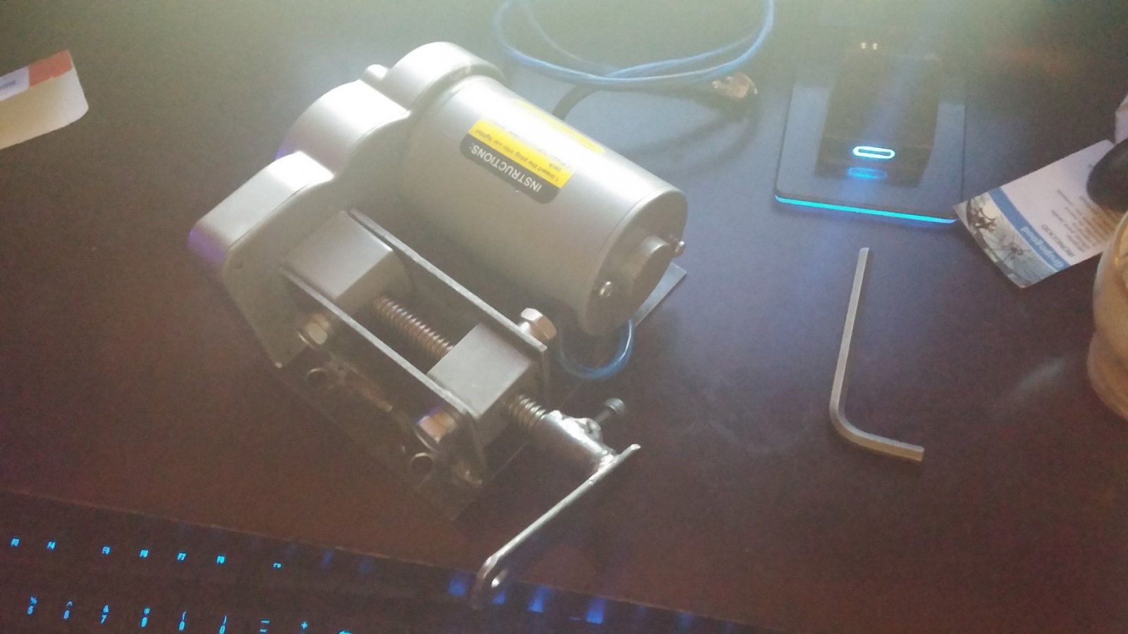

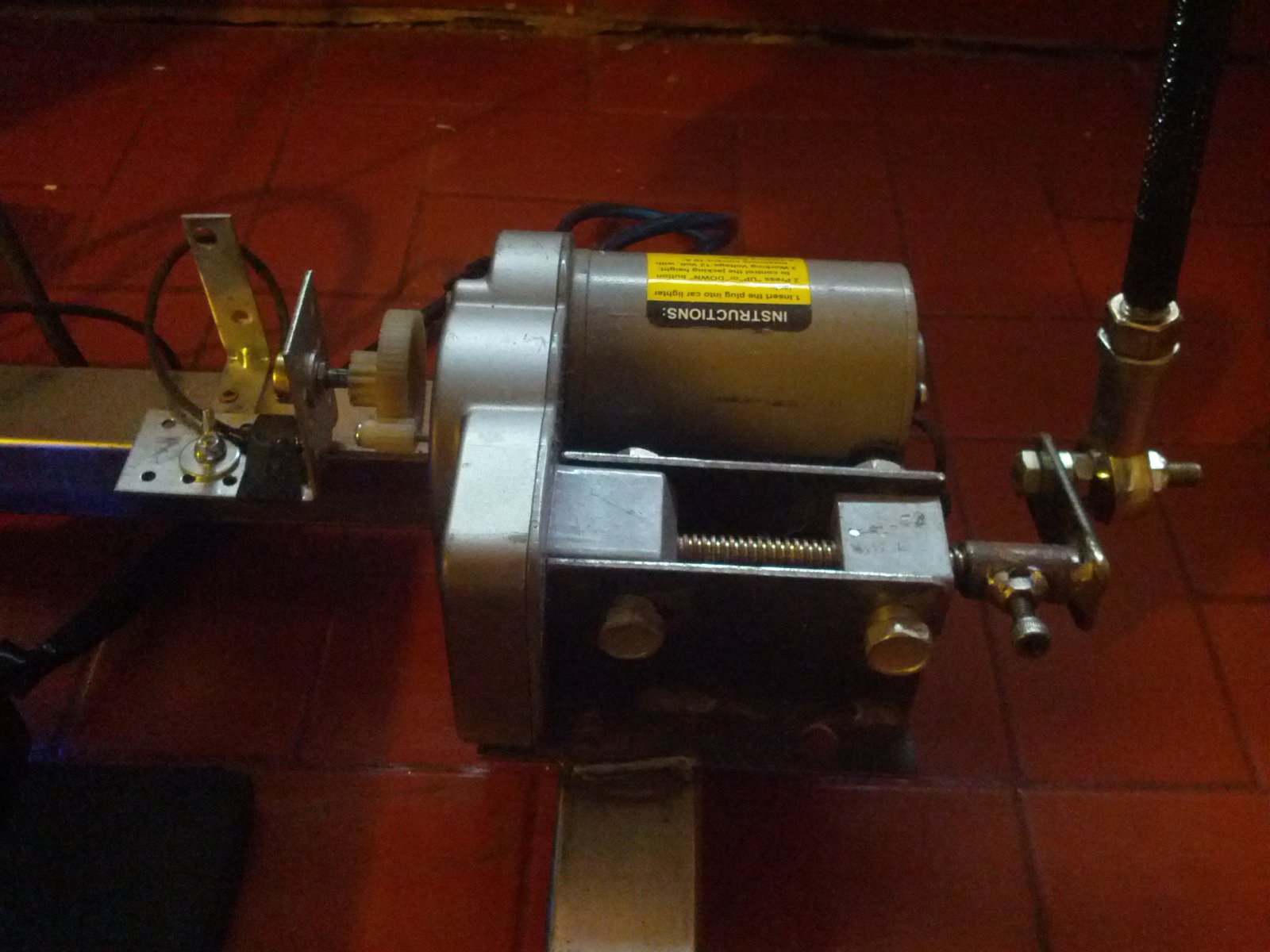

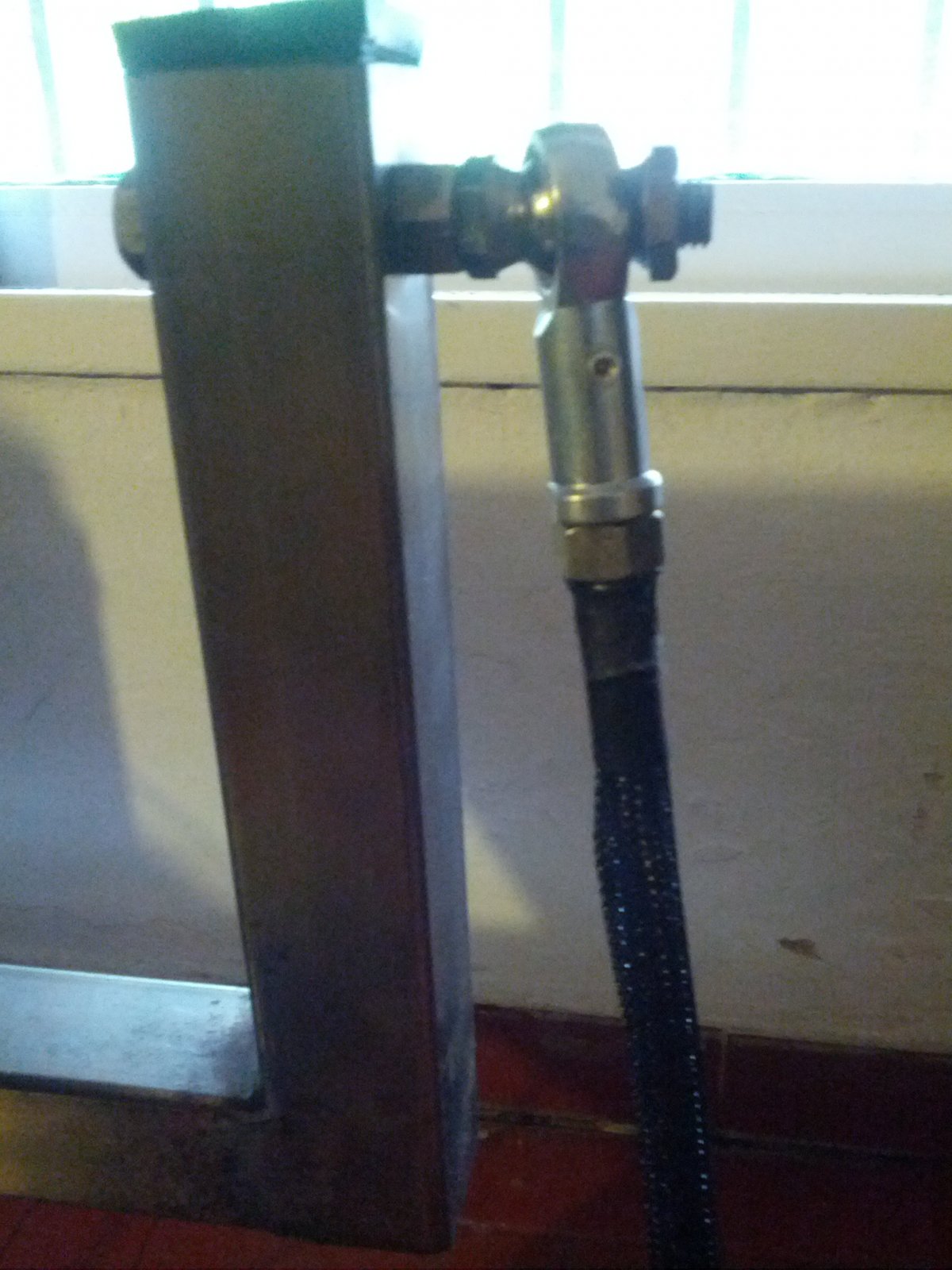

    The mod is simple, just remove 4 bolts to free the motor, cut the shaft to size, you have to make a new mounting and the lever, to get something like this:

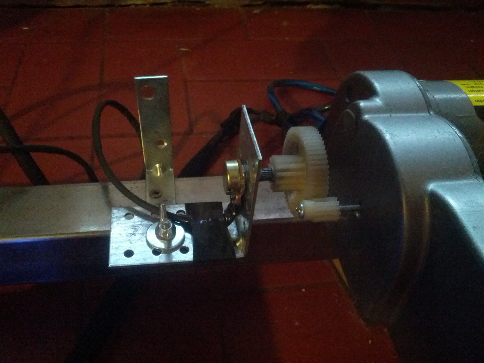

    About the pot mounting, I decided to drill a hole in the center gear to put a 1/8 screw, and mount a gear there. That gear does 1,5 turns to get the 90 degrees we usually use for our sims:
    The end result:

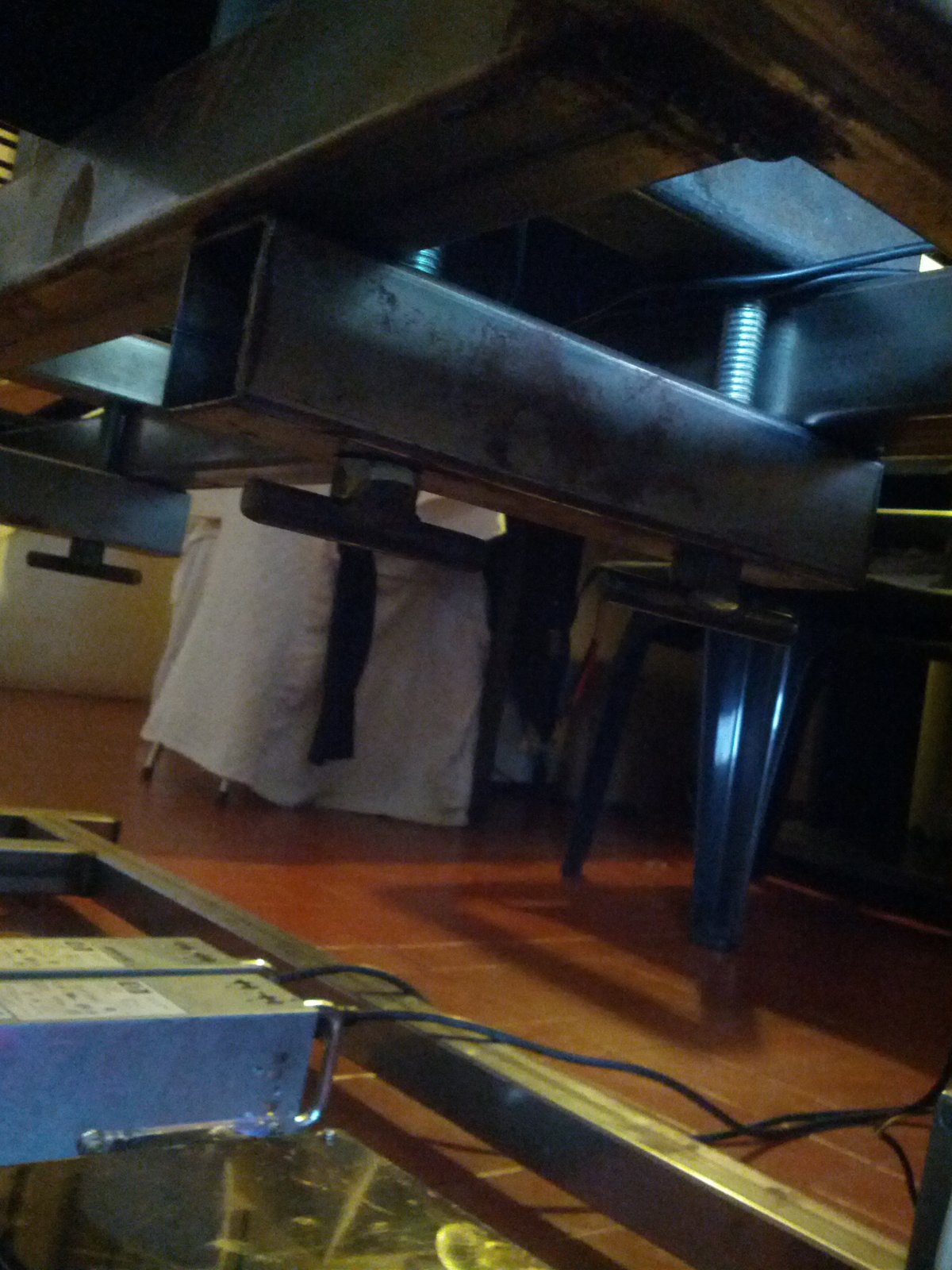

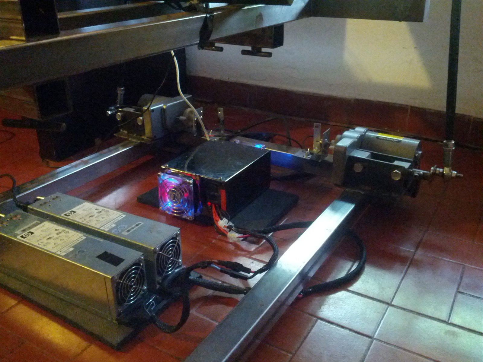

    Also, the jacks comes with two limiters, that someone with a little more knowledge than me can use to stop the levers to get out of range.

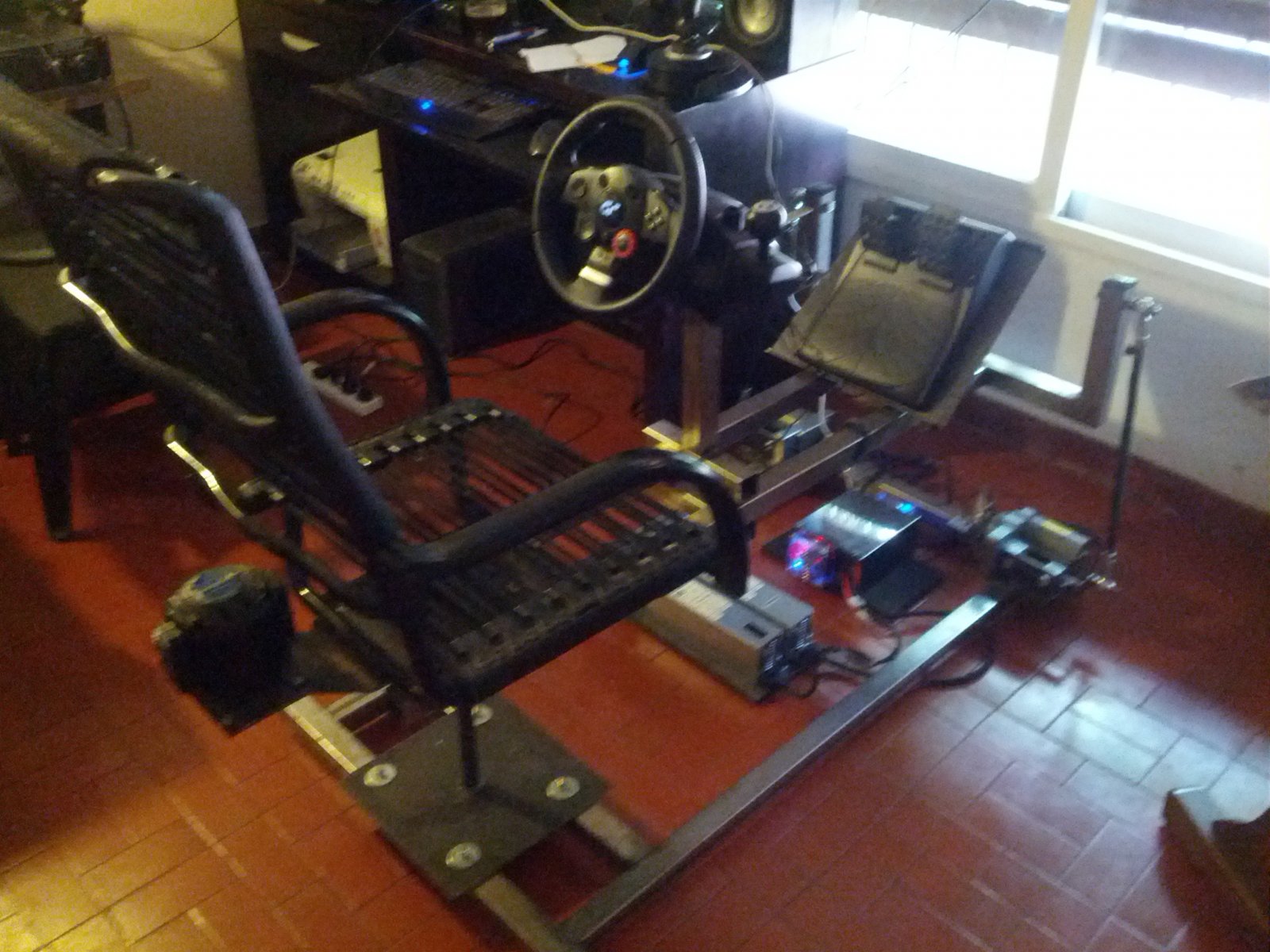

    Some more pics of my WIP sim:
    (Sim based on @Archie 's foot mount fim)
    Buttkicker LFE mounted at the rear with a metal plate to add effect:
    IMG_20151101_162422.jpg IMG_20151101_162443.jpg IMG_20151101_162505.jpg IMG_20151101_162522.jpg IMG_20151101_162537.jpg IMG_20151101_162838.jpg
    The nuts were lathed to add freedom of movement to the ball bearings.:
    Pedals and wheel mounts can be moved, the wheel also can go up and down:

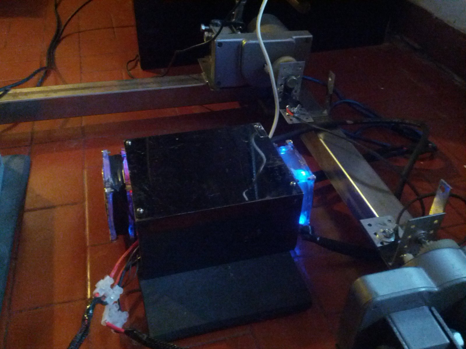

    I'd just finished to redo the control box, adding a second MM, so now each Jack has his own PSU and MM.
    First test of the new box with SMC3:
    I want to thanks to all the guys that helped me in the way, specially @Pit @noorbeast @Archie @bsft and for sure I'm forgetting a lot more!
    • Like Like x 8

  19. noorbeast
    21,592
    151,215Coins
    The torsional twist is significant and will soak up a good deal of accurate motion.
    As it is a uni joint where is the torsional twist originating from, does the slim mount post twist or is it something else?
  20. mariano68
    mariano68 Active Member
    Nov 15, 2014
    576
    builder contractor
    Argentina
    3,339Coins
    +395 / 2 / -0
    2DOF, Arduino, 4DOF
    Mmm that can be... I will check and if it is originating there I will be forced to add heave :D.
    Anyway, the jacks does their work fine, don't you think?
