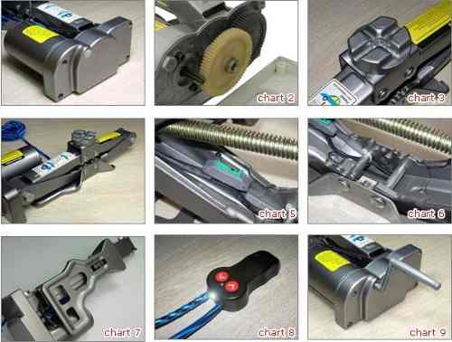

    BTW, here is really difficult/expensive to get decent motors, but I found that the motors on the electric car jacks are about 12watts and has a double gear already mounted, and I can get them for about U$S60 locally, I mean using only the motor and gear and cutting the rest.
    http://www.ebay.com/itm/ELECTRIC-CA...601?pt=LH_DefaultDomain_3&hash=item2ee2b264a1
    This one is rated 12v 15Amp, so about 180watts... confusing as it also says "POWERFUL 100 WATT 12 VOLT MOTOR"

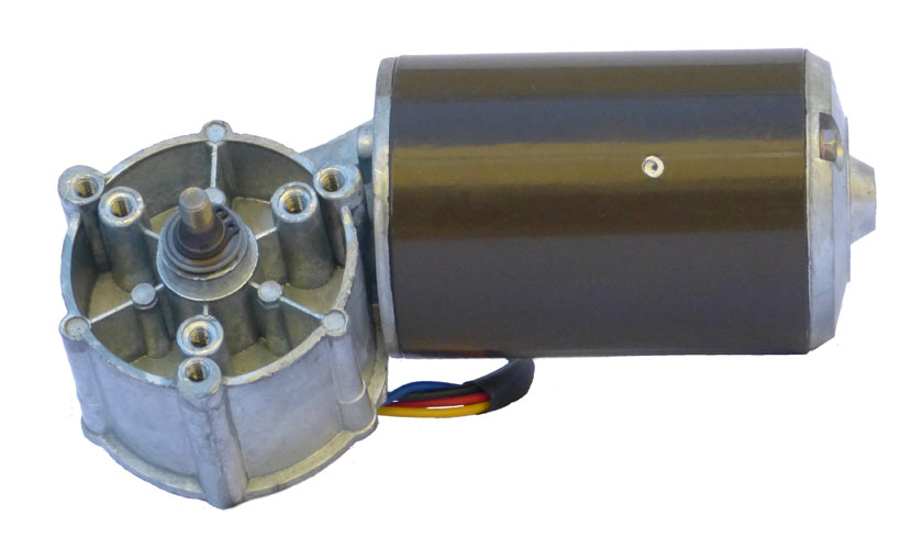

    My unit will be a foot mount motors, full sim without monitors (Oculus rift here) and about 125kg pilot and platform.
    Problem is that I can't get any really good motor locally or importing it for less than U$S350 each, my options here for around U$s100 each:
    1-12v 50NM 65RPM, about 80watts (I'm almost sure that 50NM are stall torque and no real torque, more like 20NM top) U$S120
    2-1500kg Electric jack, about 100watts 60RPM, the idea is to use just the motor and gearbox, not the jack. U$S60
    A 2Tn 12v Winch for U$S180, but noisy and I can't do that noise at nights.
    Please Advice me guys!!! :sos
    PD Also I can get 100 or 400 watts 12/24v skate/scooter motors, but without gearbox.

    Thanks, already read that thread, but I usually play at night and as much I can minimize the noise from winches, it wont be enough :(
    And about the gearboxes alone, yes, but they costs here about U$S200 each.
    I tried to avoid at all costs to use the rear mount model as I really don't like it(aesthetically speaking), but looks like it will be my only choice with this kind of motors.
    21,597
    151,245Coins
    A foot mount design also has good leverage, so you have choices there.
    You could plan on a future upgrade to more powerful wormgear motors. Or just bite the bullet and get them at the onset where it may be a significant cost, but as @eaorobbie has pointed out is still a bargain price compared to alternatives like Dbox and SNN5-6s.

    I'm intrigued on the electric jack motor, I think I will buy one to test it.:)
