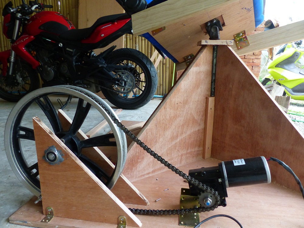

    i don't really understand how linear speed is a useful measurement in a rotating system, i suppose that linear speed is the speed of the linkage arm between the motor and the chair? if so, and if the linkage is say 40cm distance from the UJ, then 150mm/sec translates to 3.58RPM which is 21 degrees/sec.
    so i just went shopping and got a motorbike front chain sprocket, chain and a 14" wheel. that will give me a gear ratio of about 10:1, so 960 degrees/sec will come down to 96 or so, which should give me about 670mm/sec, so i think that should be spot on.
    also, i was thinking about the forces, that motor is rated 20NM, so with a 10:1 reduction gear that will go to 200NM. since the distance from the axle to the push rod arm on my final drive is about 20cm, i think that means i will have about 200x5 newtons of force on the pushrod = 1000N. is that right? maybe i need to draw a picture to explain?
    anyhow, one newton is the force required to accelerate a one kilogram mass at a rate of one meter per second squared. the rig with me in it will be less than 100kg, but lets say 100kg to keep the math easy, so i think that gives me about 10m/ss right? which is basically 1G.
    but that's assuming the motor is lifting my entire weight, but it isn't really because its pivoting on the UJ, so i expect i'll get a bit more than 1G acceleration
    steve

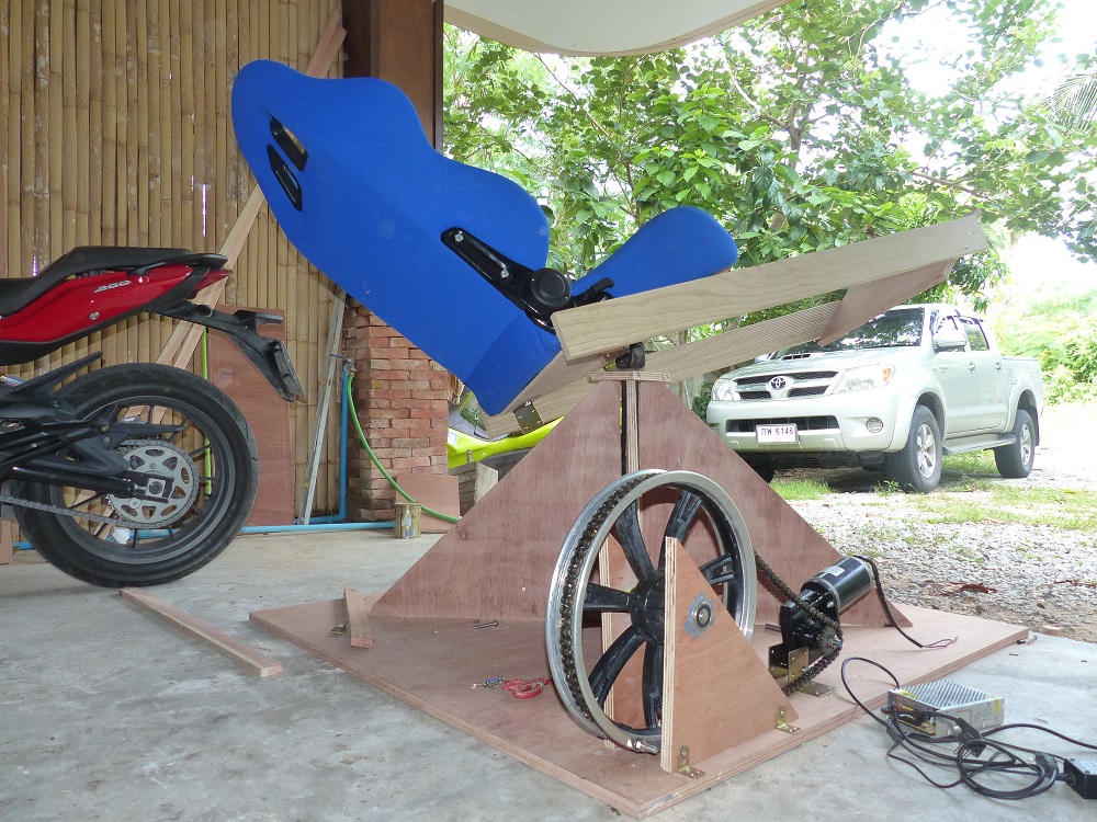

    i did my first test of the gearing system today and the math seems ok. i'm getting about 160 degrees/sec on the final drive wheel, so depending on the distance i put connect the push rod, i can get about 300mm/sec linear speed at the wheel rim which is 180mm radius.
    so 160 degrees/sec from 960 means i'm getting a 6:1 gear reduction, so i think that gives me a 6x torque boost, so i should get 20x6=120NM torque now. so at a radius of 180mm, i think that means my force is 666N (the number of the beast by the way!)
    hopefully that is enough to get me moving?
    as you can see from the pics, my seat is quite high, 70cm, that's so i can get up to +/- 30 degrees of pitch and roll, i want to see how that feels.

    The linear velocity is how fast the motor lever moves for a given Center To Center distance.
    If I understand what you have done it is to take a 180 rpm motor and then further reduce that by 10:1, so in effect the rpm is 18.
    While that does increase the torque it kills the speed for a given CTC lever that you may attach to the wheel. It also increases the mechanical loss.
    So the linear speed for a leaver attached to the motor with a 40mm CTC hole spacing would be 750mm/s.
    The linear speed for the same lever and CTC attached to the shaft of your wheel would be 75mm/s, disregarding mechanical loss, which would be significant.
    You don't get something for nothing in physics.

    maybe you didn't see my most recent post, its actually 6:1 ratio (30mm radius on primary, 180mm radius on secondary). so the loaded speed on that motor is 160RPM and if i dive by 6 i get 26.6RPM.
    using this
    http://www.calctool.org/CALC/eng/mechanics/linear_angular
    it says i should get 490mm/sec at 180mm (which is the tangential speed i think), the actually linear speed will fall to zero as it approaches the +/- 90 degree point as is a cosine function. this also has the benefit that i should get more torque as it approaches the +/- 90 degree point, which i think will help overcome the top heavy, loading of the me and the chair.
    anyhow, i measured linear speed at about at 300mm/sec over a range of about 140 degrees, and i get a usable linear range of about 200-250mm which i think will work well in my design.
