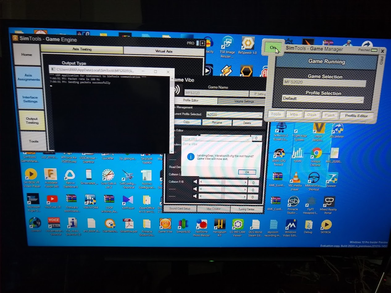

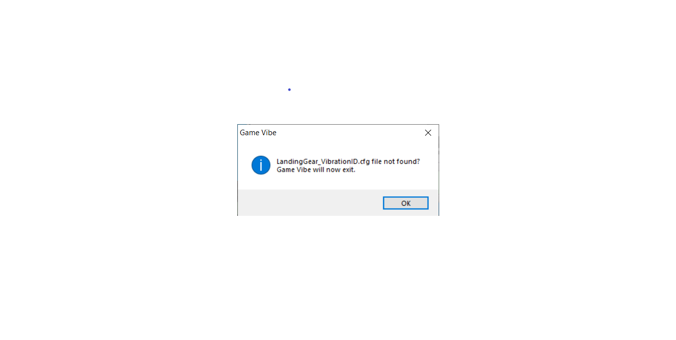

    @Icy7CE Thanks again for all your work.. The motion is working well. I just started setting up GameVibe and I am getting this error.. It shuts down gamevibe...
    Any thoughts?

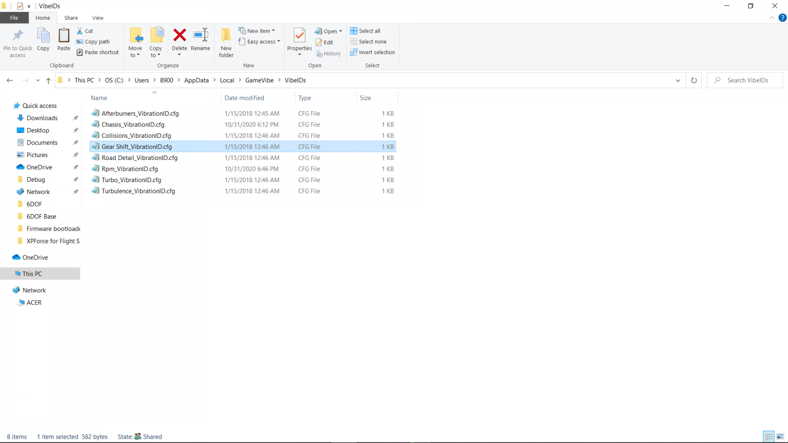

    I haven't seen this error before, so I'm not sure. I have a file in AppData\Local\GameVibe\VibeIDs called "Landing Gear_VibrationID.cfg" (note the space). Do you have this file?

    Ok I got it working I think....:o:
    I made a copy of the Rpm_VibrationID.cfg and renamed it LandingGear_VibrationID.cfg and copied it back to the \VibeIDs directory. I was also missing Flaps_VibrationID. cfg so I made one of those also. It looked like most of the cfg were the same inside.. :thumbs
