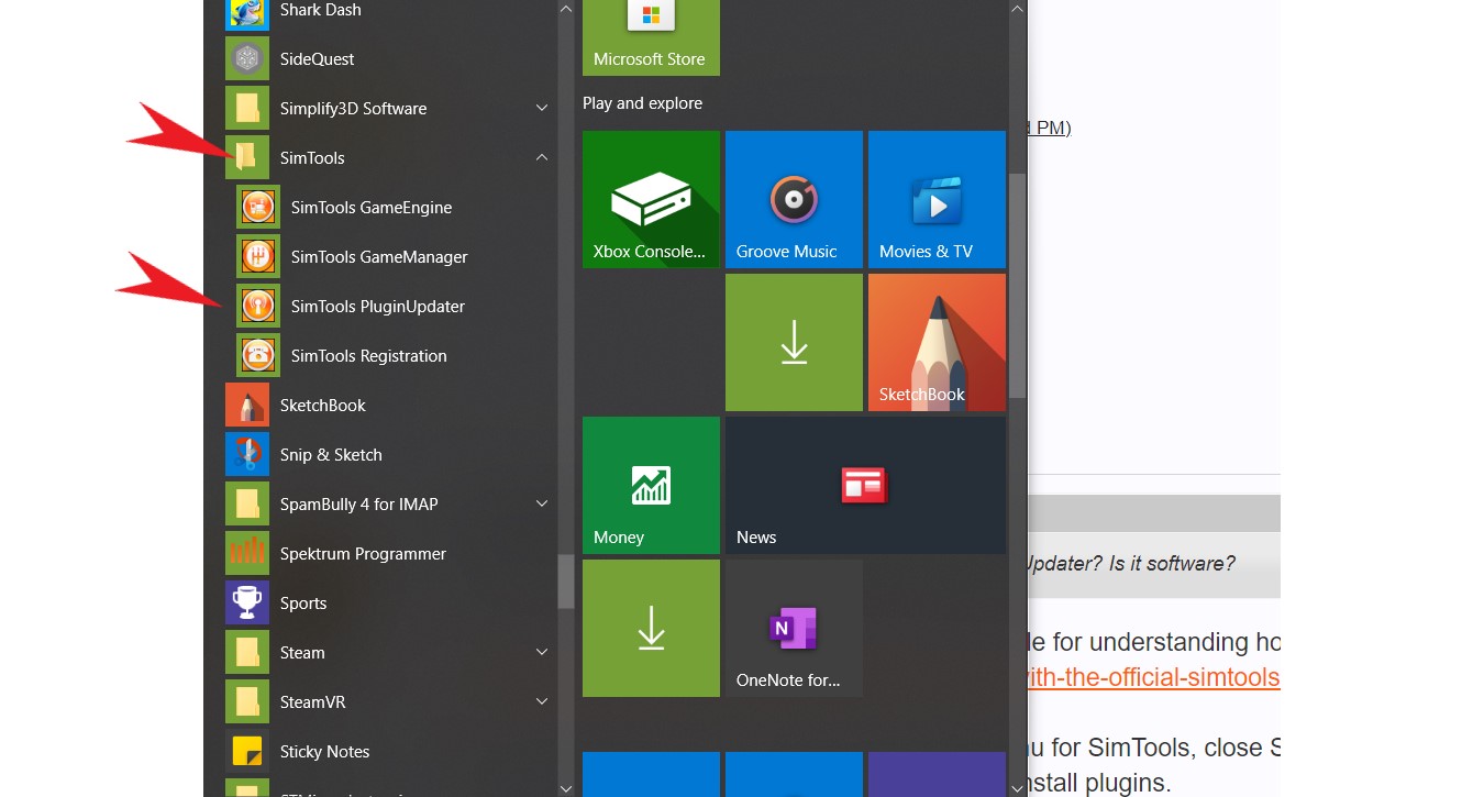

    Hello and sorry for the ignorance but where do you find PluginUpdater? Is it software?

    The start menu is in the very lower left of your computer screen.

    Thank you very much for your help. I did not understand the principle. Now I have the updated plugin and the MFS2020 patch. Unfortunately the Racing cube still does not work but I will look on the forum if I can move forward without disturbing you. Otherwise I will come back to you cordially

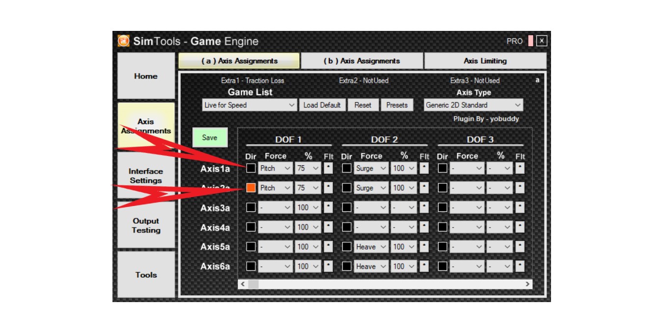

    That's it, the racing cube works with MFS2020. Just one last question, in the manual I can't find how to reverse an axis. The Pitch is reversed, the seat goes down when the plane goes up. Thanks for your help

    Click on the box below "DIR" to reverse direction of the actuator.
    See how it turns "ORANGE"
    Be sure to click the save button after any changes

    Many thanks for your help it's ok now

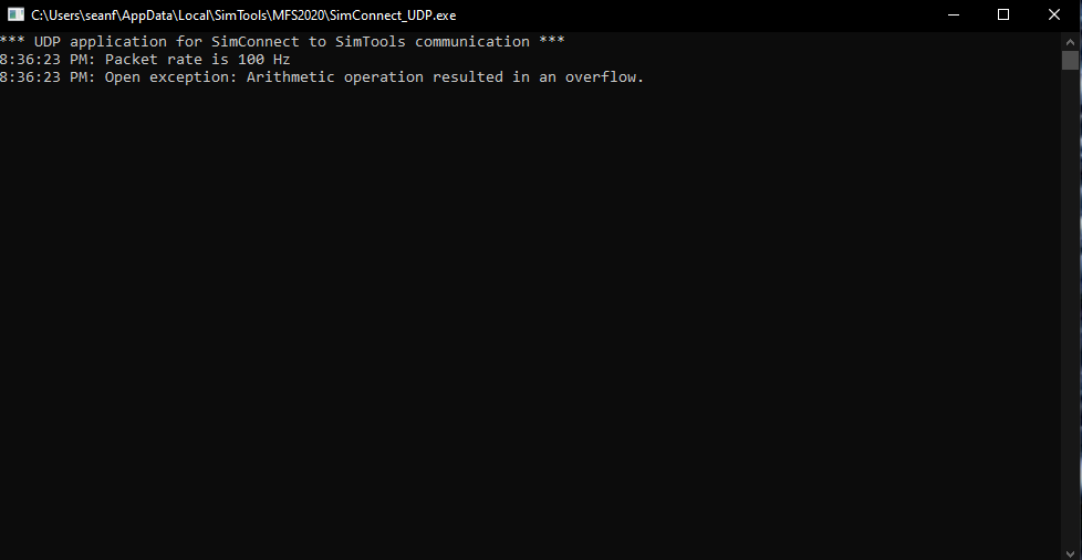

    Also, I am getting this error:

    That error always comes up when the game is loading, but should go away when you get to the main screen.
