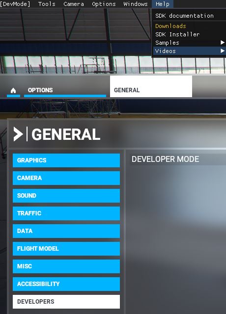

    I cant seem to find SimConnect.dll. What i do find is Microsoft.FlightSimulator.SimConnect.dll. This does not patch for me. Any suggestions. (this is the MS version not Steam.)
  7. caddyboy0103
    caddyboy0103 New Member Gold Contributor
    Mar 24, 2019
    13
    11Coins
    You have to enable the developer mode in general settings. Once enabled, you will see a menu at the top left hand side of the screen. Under the help menu there should be an SDK submenu from which you can select install SDK. Once it’s downloaded, you can install it, and the files are installed in C:\MSFS SDK, from there I can’t remember where, but simconnect.dll is there.

    I turned on Developer mode but the is no help menu or sub menu. i also rebooted and looked again. Developer mode is on with no other menu or options. Any suggestions? thanks

    hopefully this image helps, it links to an auto download

    It absolutely did. I missed it at the top of the screen as the print was so small. thanks so much for your help. :)
