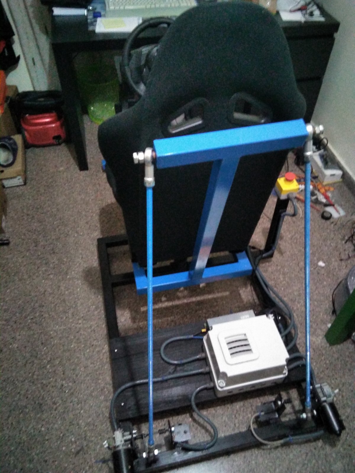

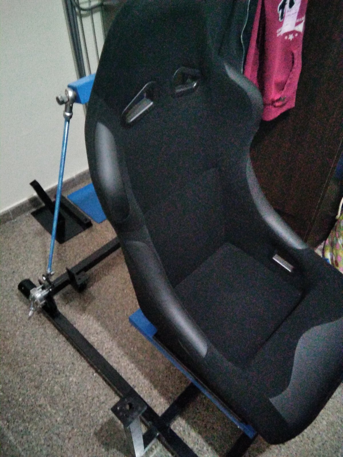

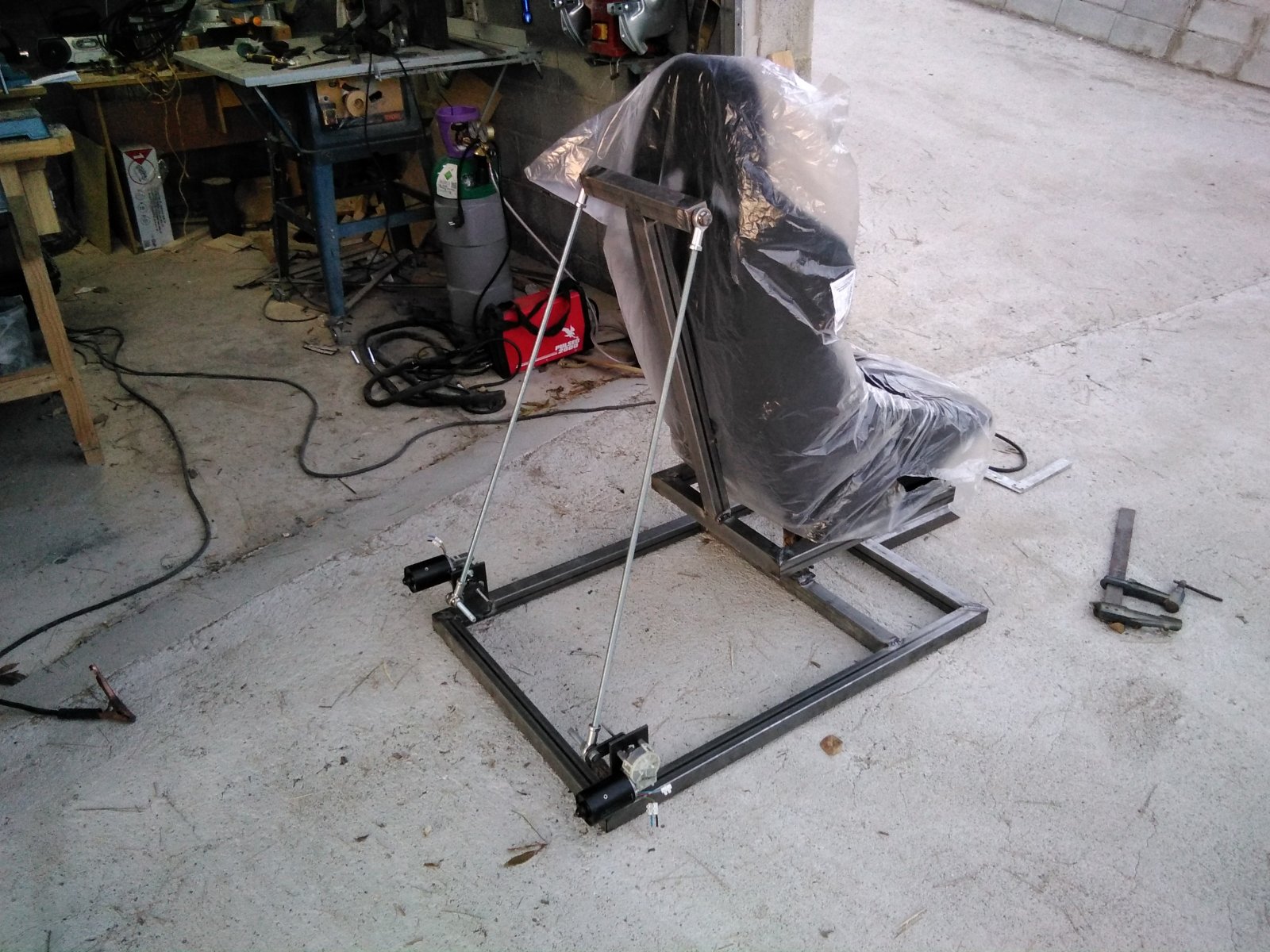

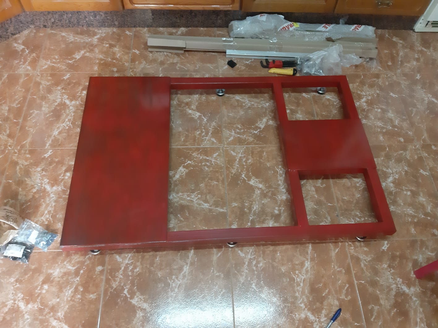

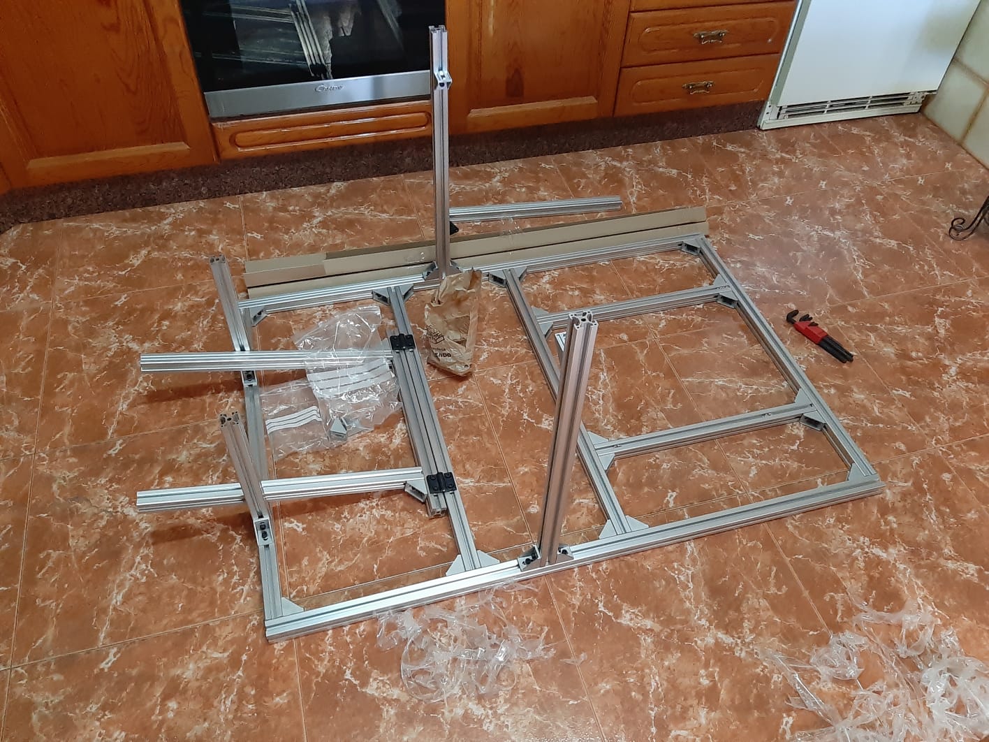

    I present my project of the 2DOF simulator
    I already have the finished chassis, I will attach images, I am currently looking for the right software to give life to the simulator, I have decided to use the one of the companions of x-simulator
    I have it mounted with arduino and monster moto-shield and a power supply HP-750W
    I hope to make it work

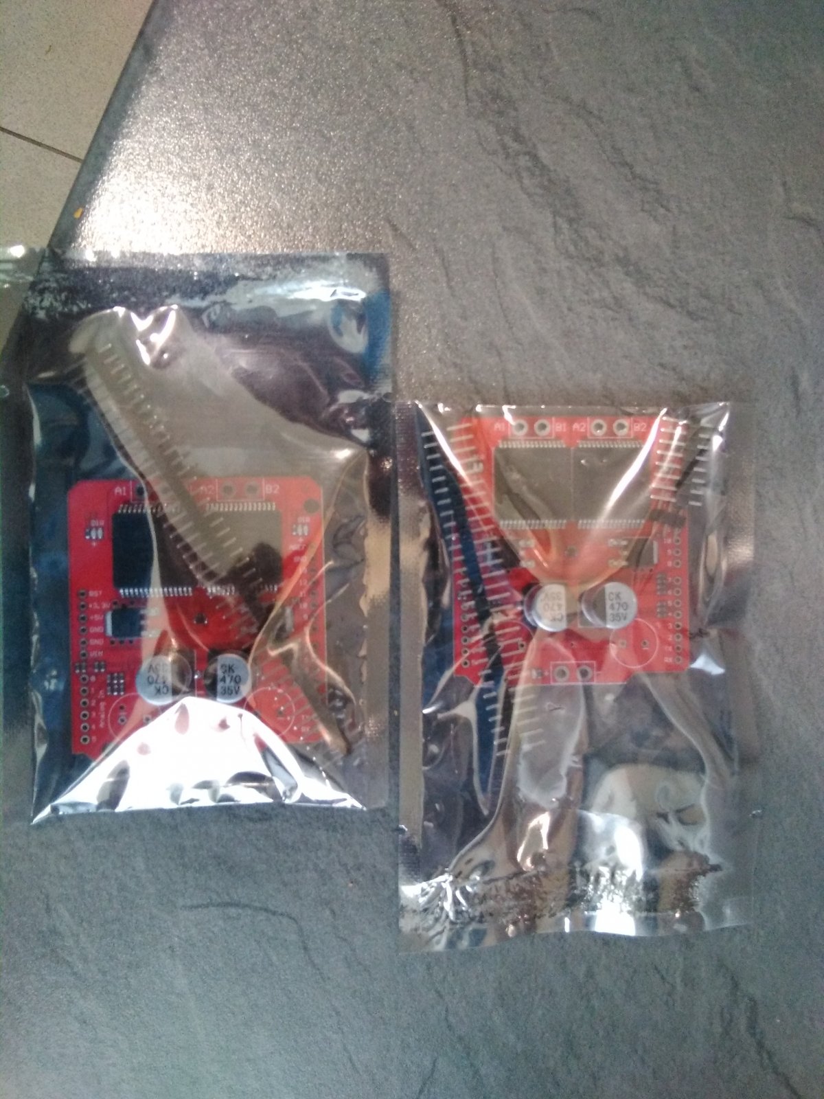

    I put some picture of the electronics used

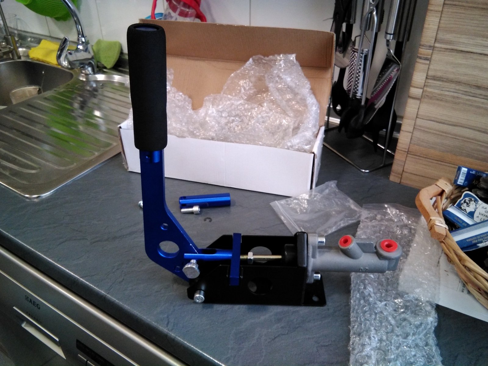

    And I'm also in the project of a handbrake

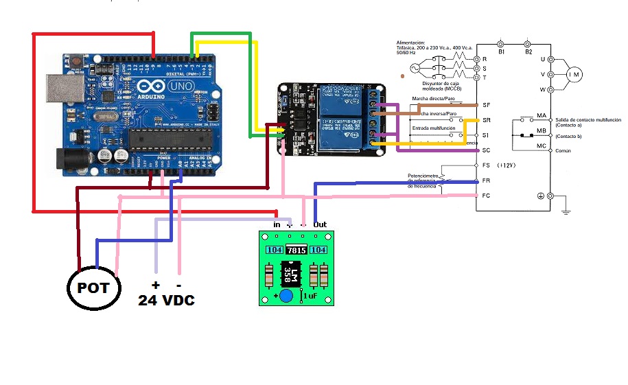

    I leave an image of a test I am doing to drive the variable speed unit with smc3 1 mode. The problem I have is that when adjusting the potentiometer to 50%, the 2 relays are activated and the disk has problems to have direct and reverse gear at the same time, the speed reference works perfectly but the problem is that the 2 relays are activated . , Any suggestions? or is it impossible to make it work this way? Thanks in advance

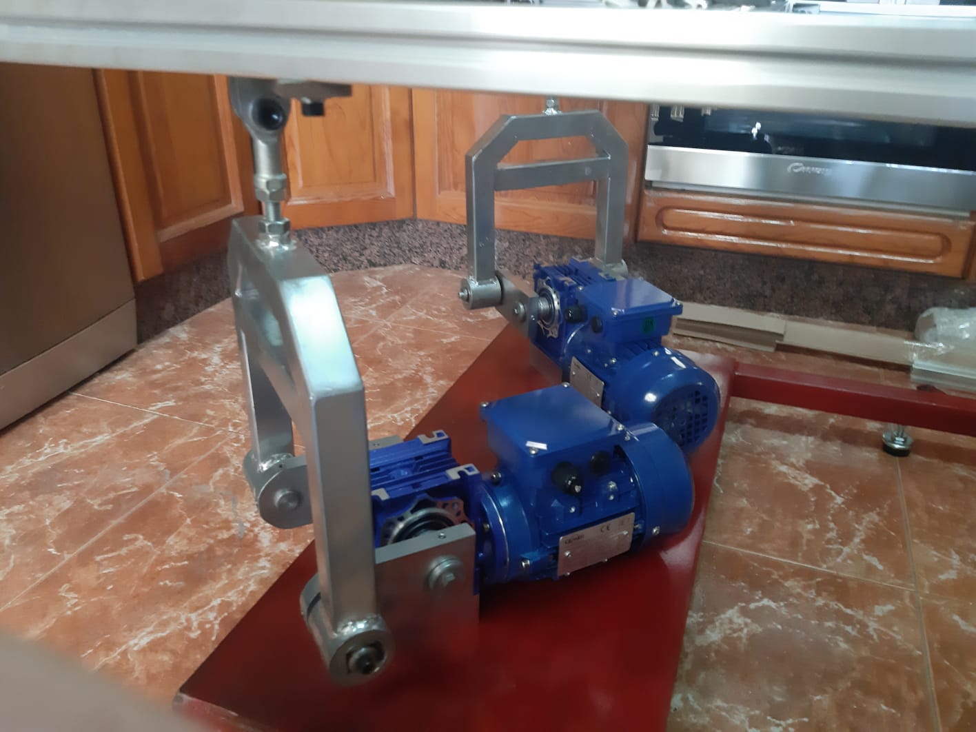

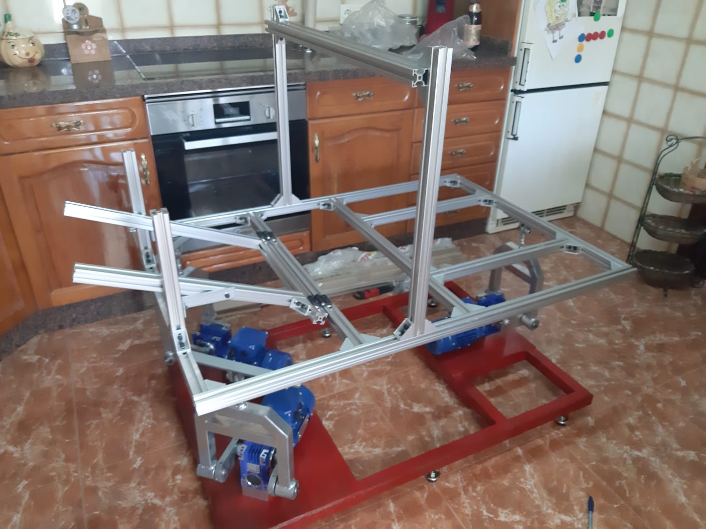

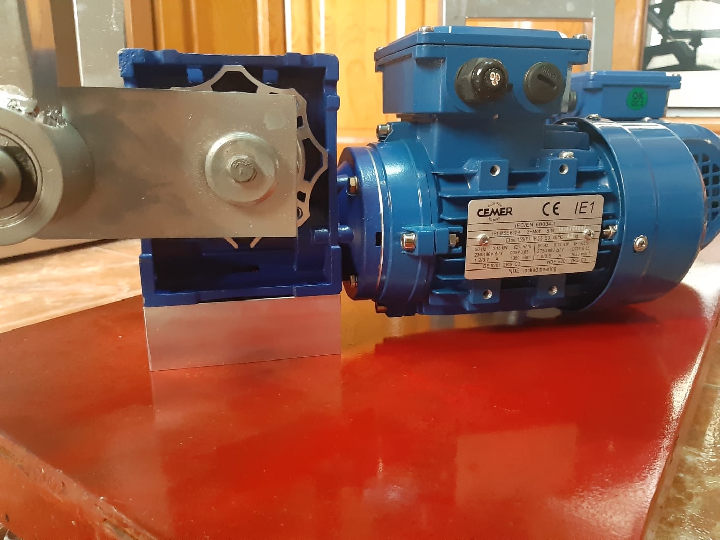

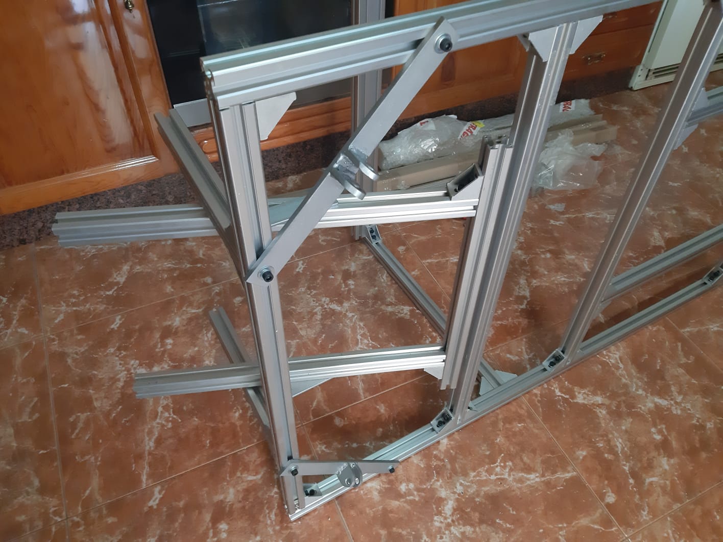

    Well, after a while I decided to start with the reform of my simulator 2dof to 3dof with three-phase motors and speed variators, I will attach some images so you can see the development
  13. zapata_h
    zapata_h Active Member
    Dec 25, 2013

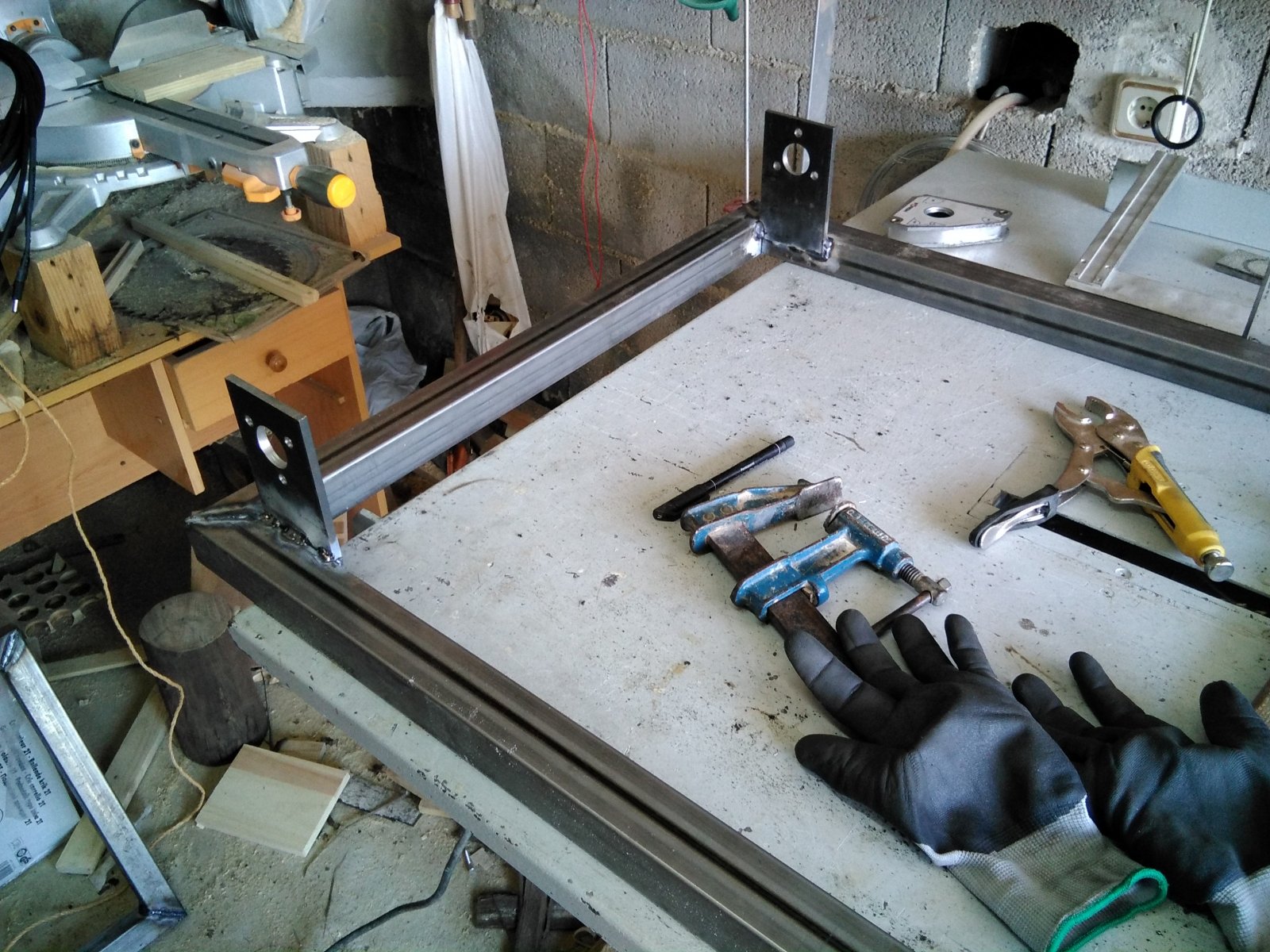

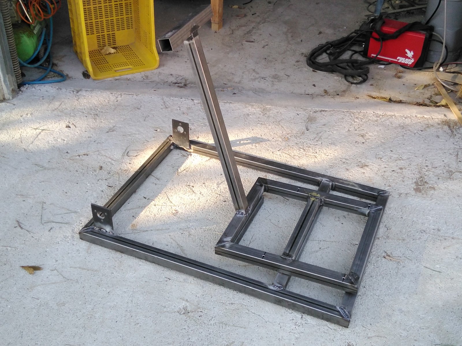

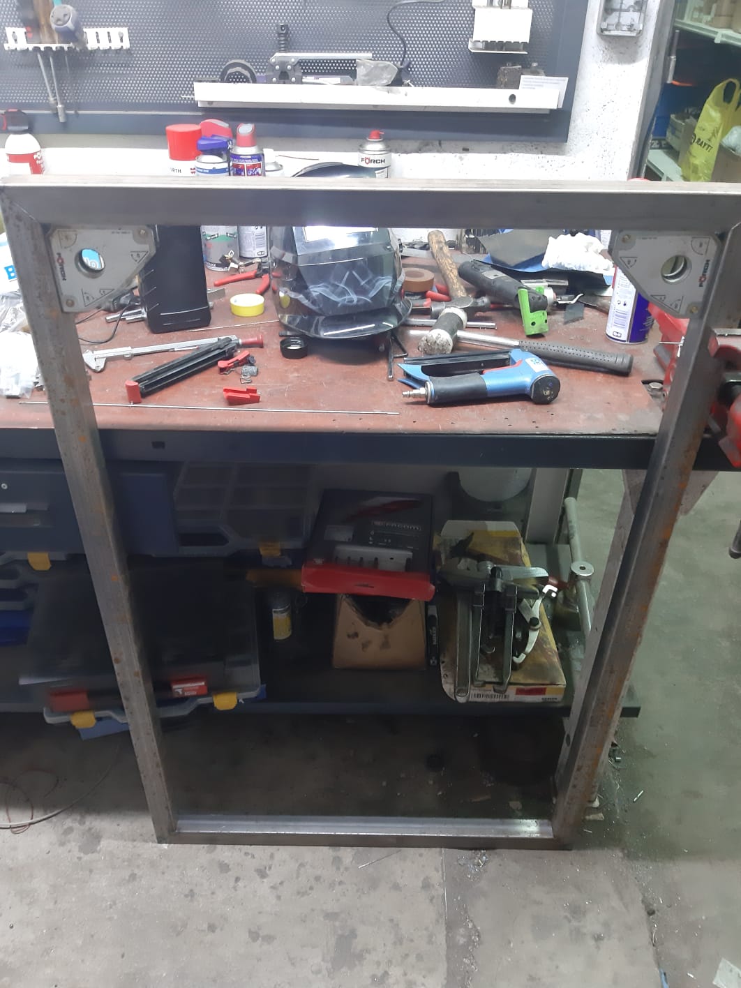

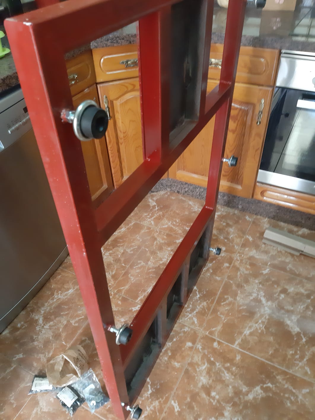

    I started by building a very sturdy base to support the weight of the platform and avoid a possible turning

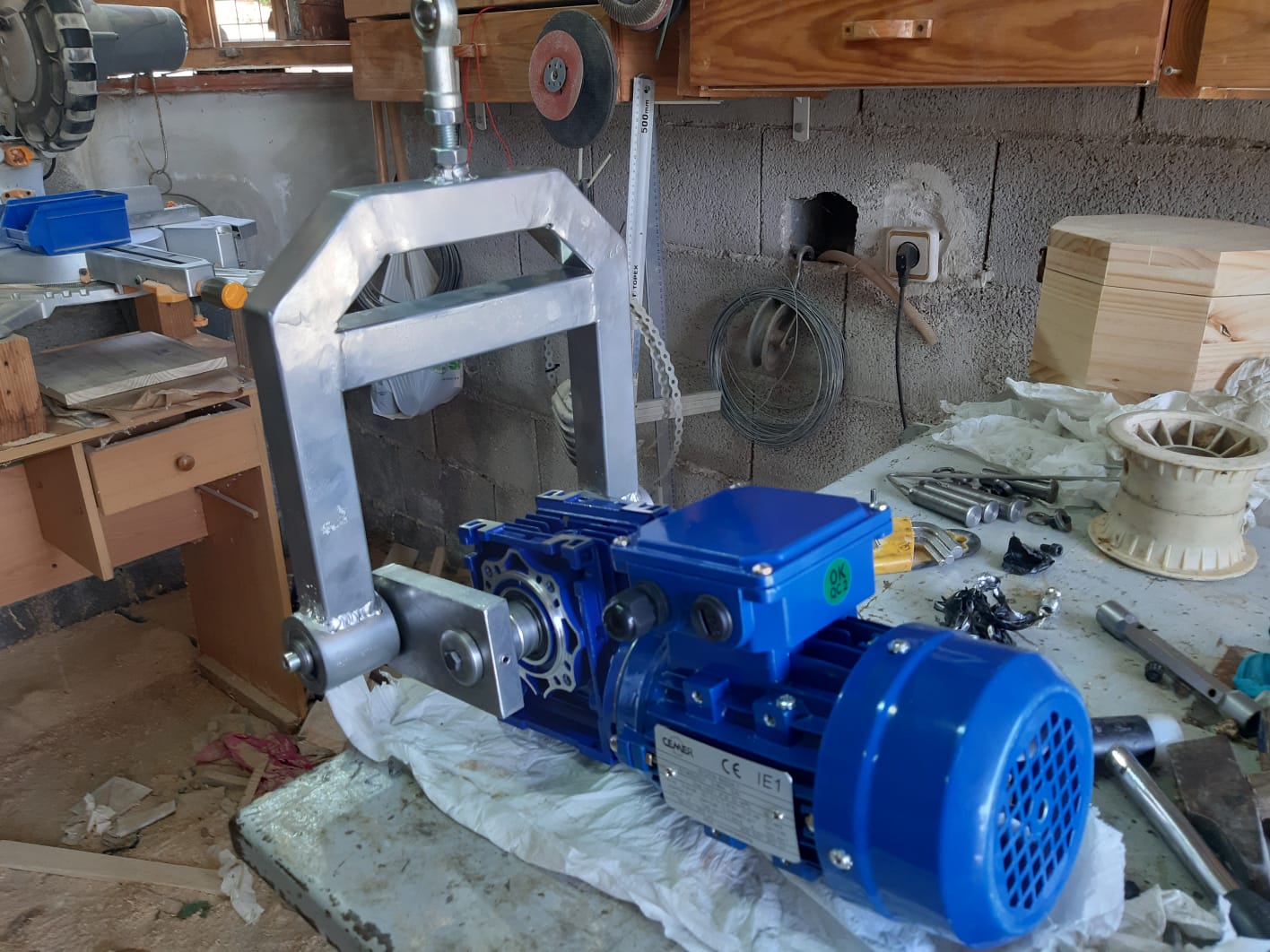

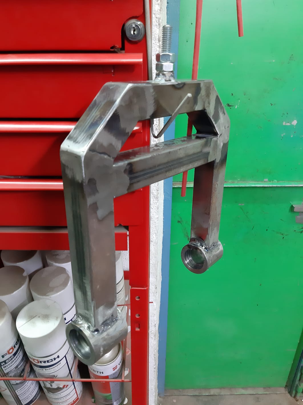

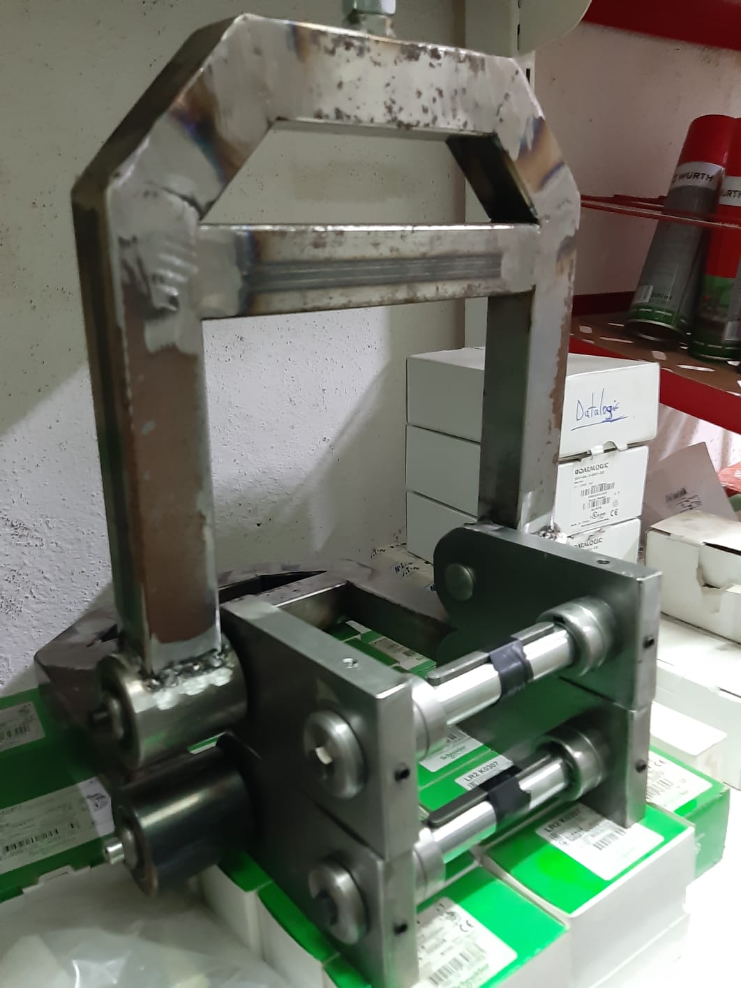

    I have built some pretty good rods in my opinion, with built-in bearings IMG-20190611-WA0002.jpg IMG-20190611-WA0006.jpg

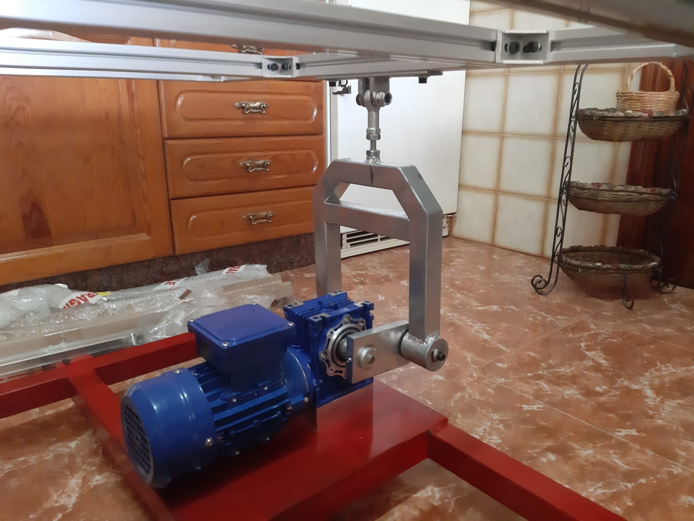

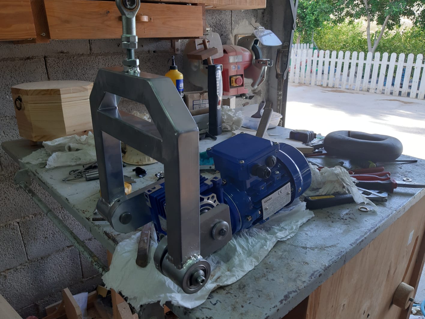

    This is what the connecting rod mounted on the engine looks like, I think it has been pretty good, I hope it does its job perfectly

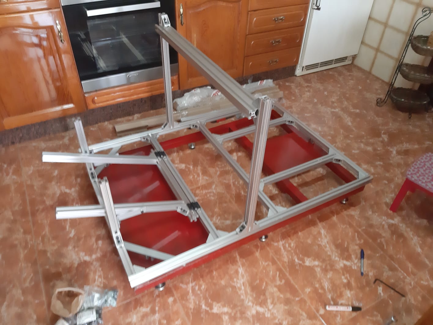

    And this is the platform that I am building, I saw some images in the forum and I liked them a lot and starting from there I started to build the platform with some small change

    I hope to soon upload some more image of the construction, I am waiting for some spacers to be able to hold the reducers to the lower frame, which has 6mm thick plates, it will be enough to hold the movements of the structure

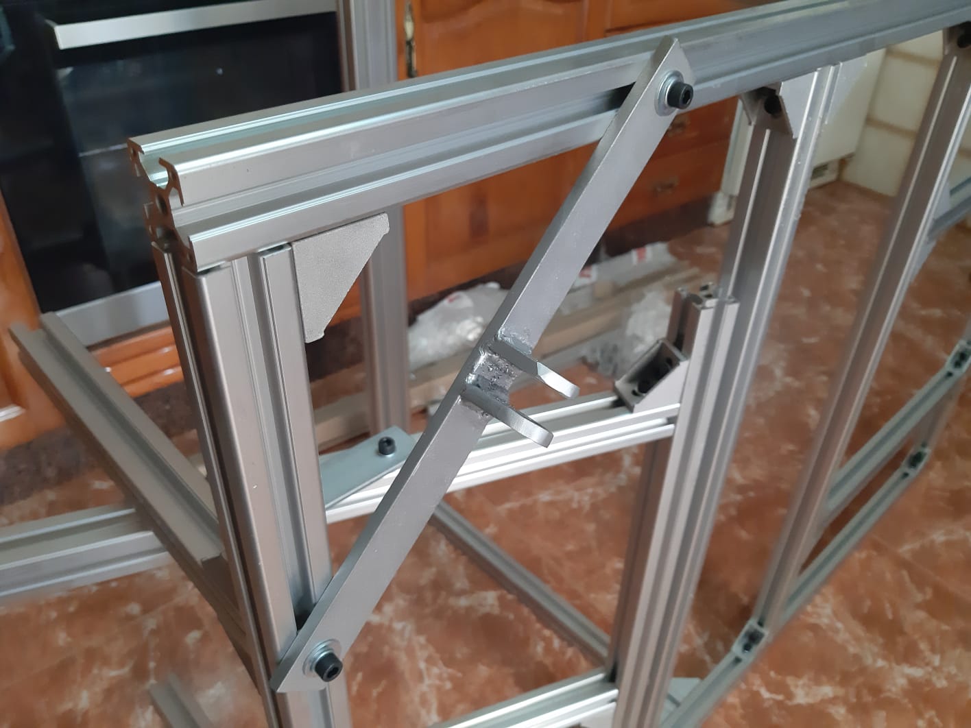

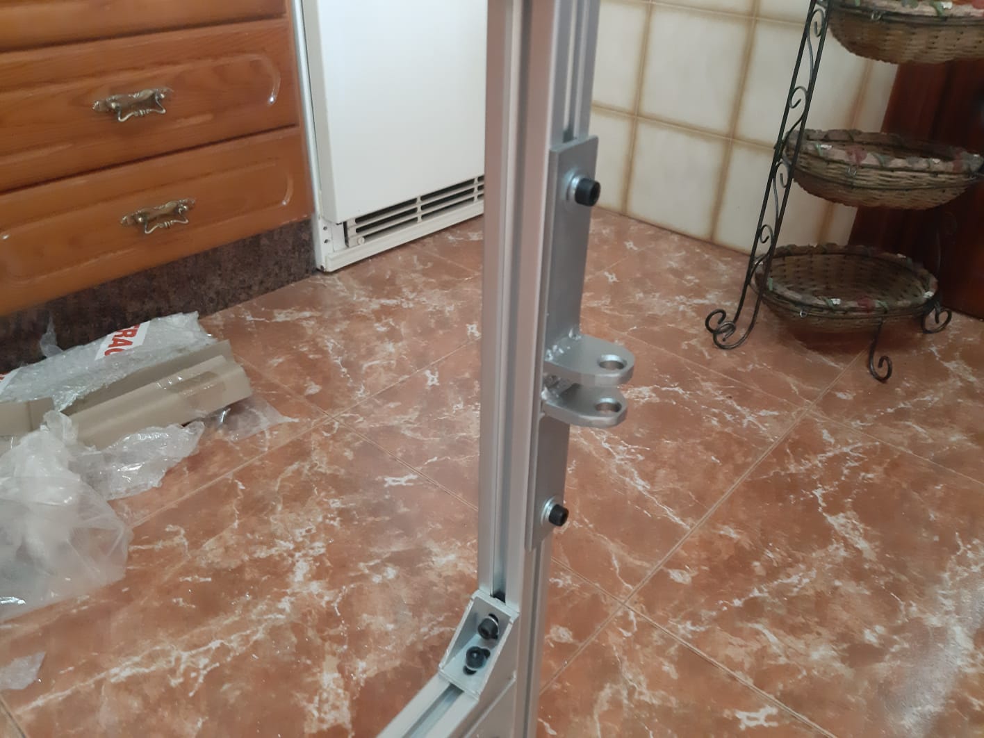

    This weekend I followed with the assembly of the platform

    It has been a very strong structure and no slack in the joints, only remains to manufacture the support potentiometers and begin to assemble the electrical part
