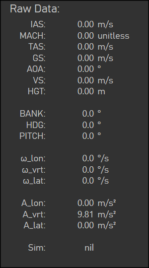

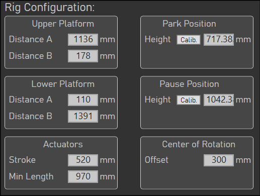

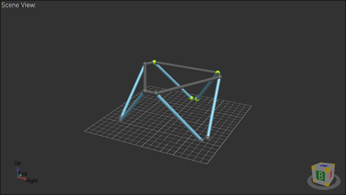

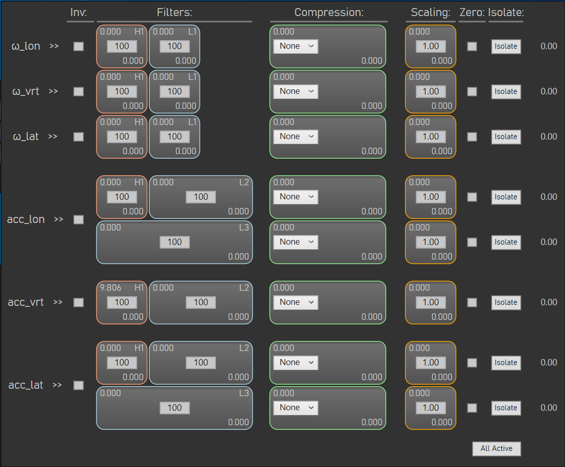

    I've been working on my motion engine for the past year or so and it's coming to a point where one-by-one all the parts are coming together real nice. :thumbs
    FiltersWindow.png RAwDataWindow.png RigConfigWindow.png SceneView.png SerialWindow.png
    So far, it's been working great! I've been driving my new rig with it for a few months now and I would love to have a few other people take a look at it, to get some feedback. You know how it is: Sometimes one is so deep into the weeds of something that it's hard to see it through a "virgin" users eyes.

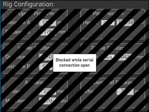

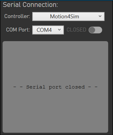

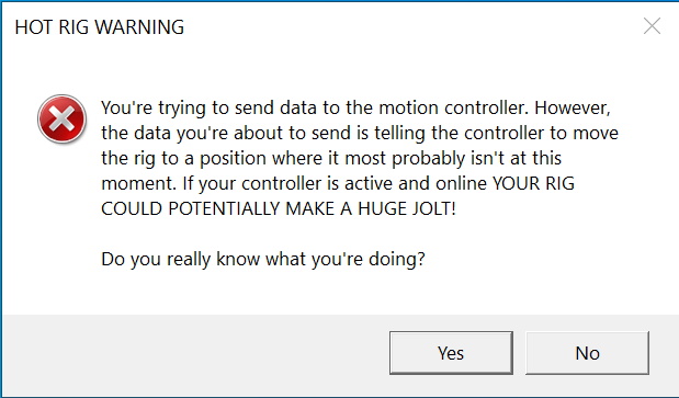

    The UI is still a bit rough around the edges, but the motion engine internally is looking solid. I'm fairly confident that it provides essential safety features for the user. I haven't had any "surprising hard-overs" in a while, because the software warns/blocks the user if he attempts anything too silly:

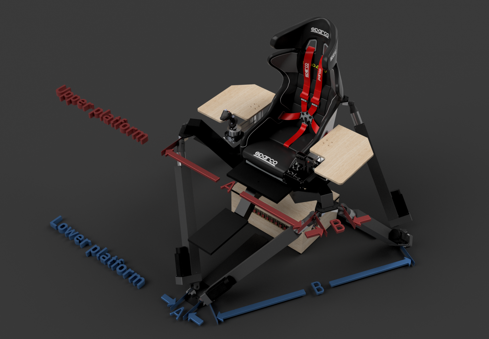

    I am working on a manual, but that is still very sketchy, so only a few pics here:

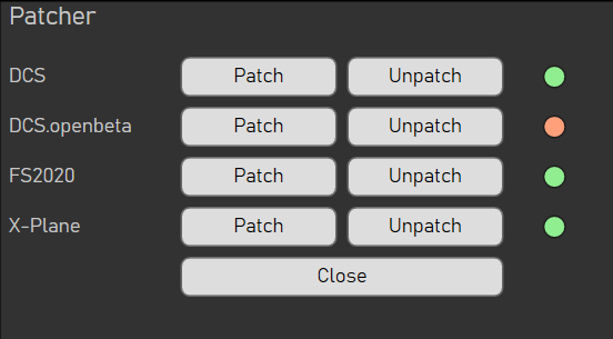

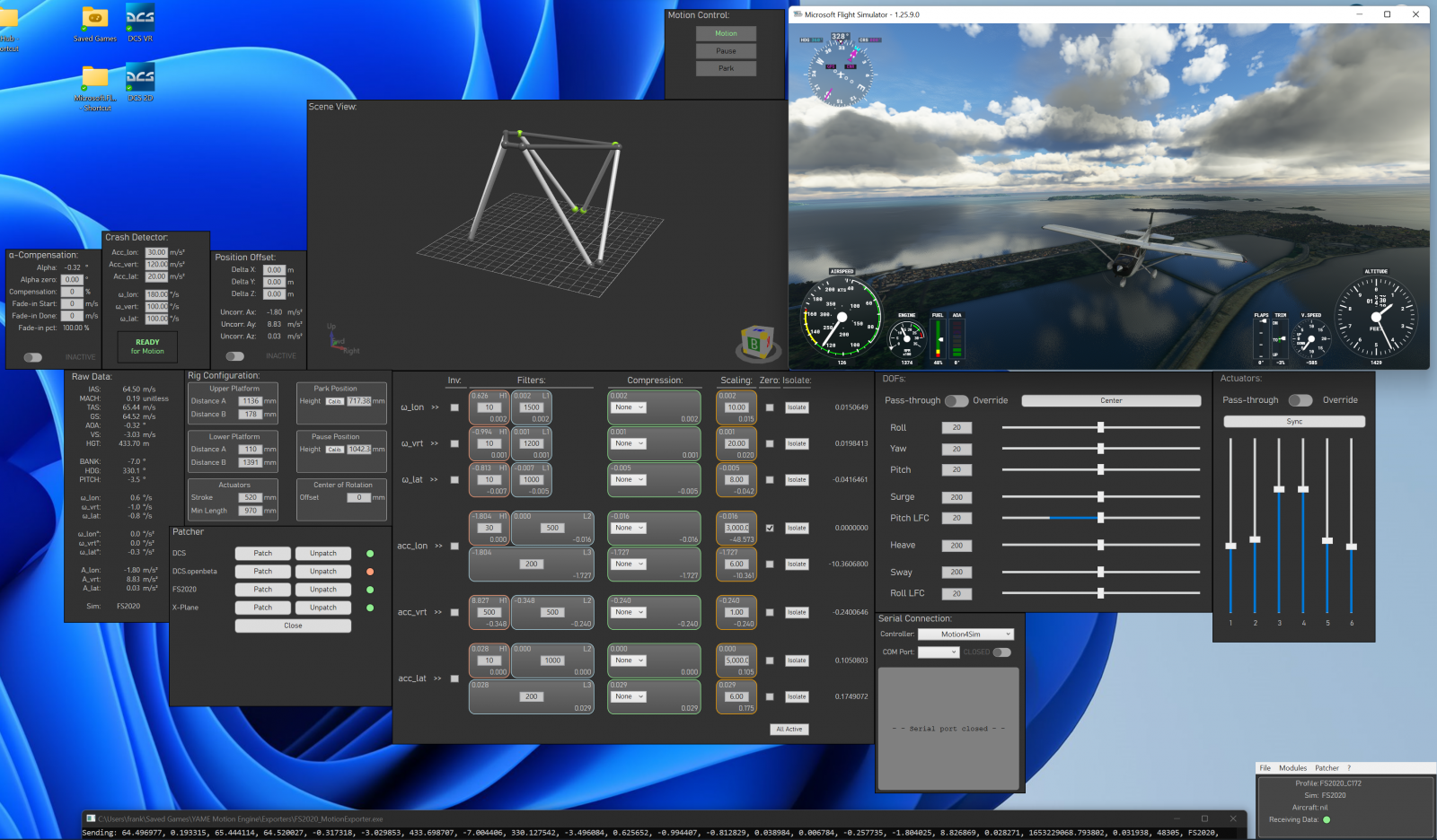

    I have recently added support for MSFS2020:
    It still doesn't provide the correct data natively right out of the physics engine, but at least the data that is there is now correct, so that the necessary values can be calculated easily.
    YAME now has "convenience patching" (as I call it), where you can see and change the patch status of each sim with a single click:
    Some minor changes under the hood as well as quite a few UI improvements.
    Cheers,... Dirty

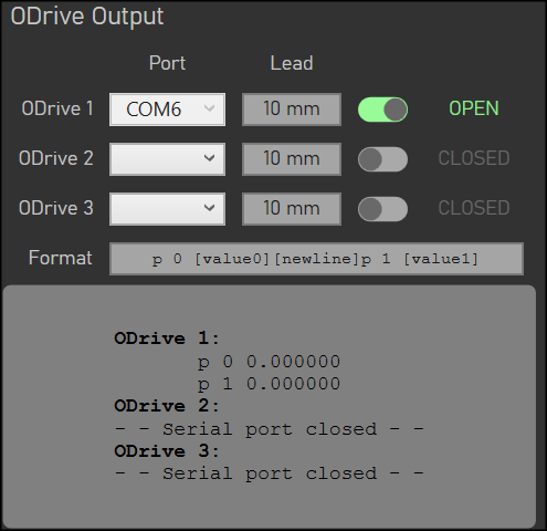

    That is planned, yes. :thumbs
    I have recently gotten an oDrive lent from @PeterW to play around with and it turns out it's really easy to interface with. I'm planning to add support for it in the near to medium term future. It's not the very top of my priority list just yet, but certainly a feature I want included. :)

    :) Turns out I enjoyed playing around with that ODrive so much that I finished the module in one go:
    So far, I only tested it with a single channel ODrive in a mock-up here on my desk, but not yet in a finished rig. Hope to be able to do that soon though ;)

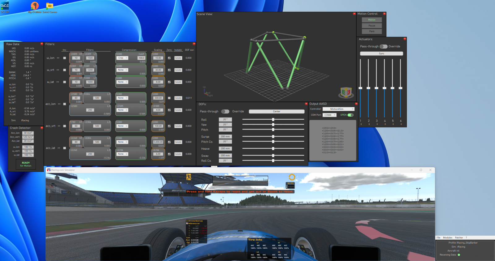

    Added support for iRacing :) So far, I have only done a few cautious tests, but luckily found no surprises. The update will ship some time in January.
    I will be tipping my toes into racing in the coming months, but since I have no professional experience in the field, it's going to be a learning experience :)
