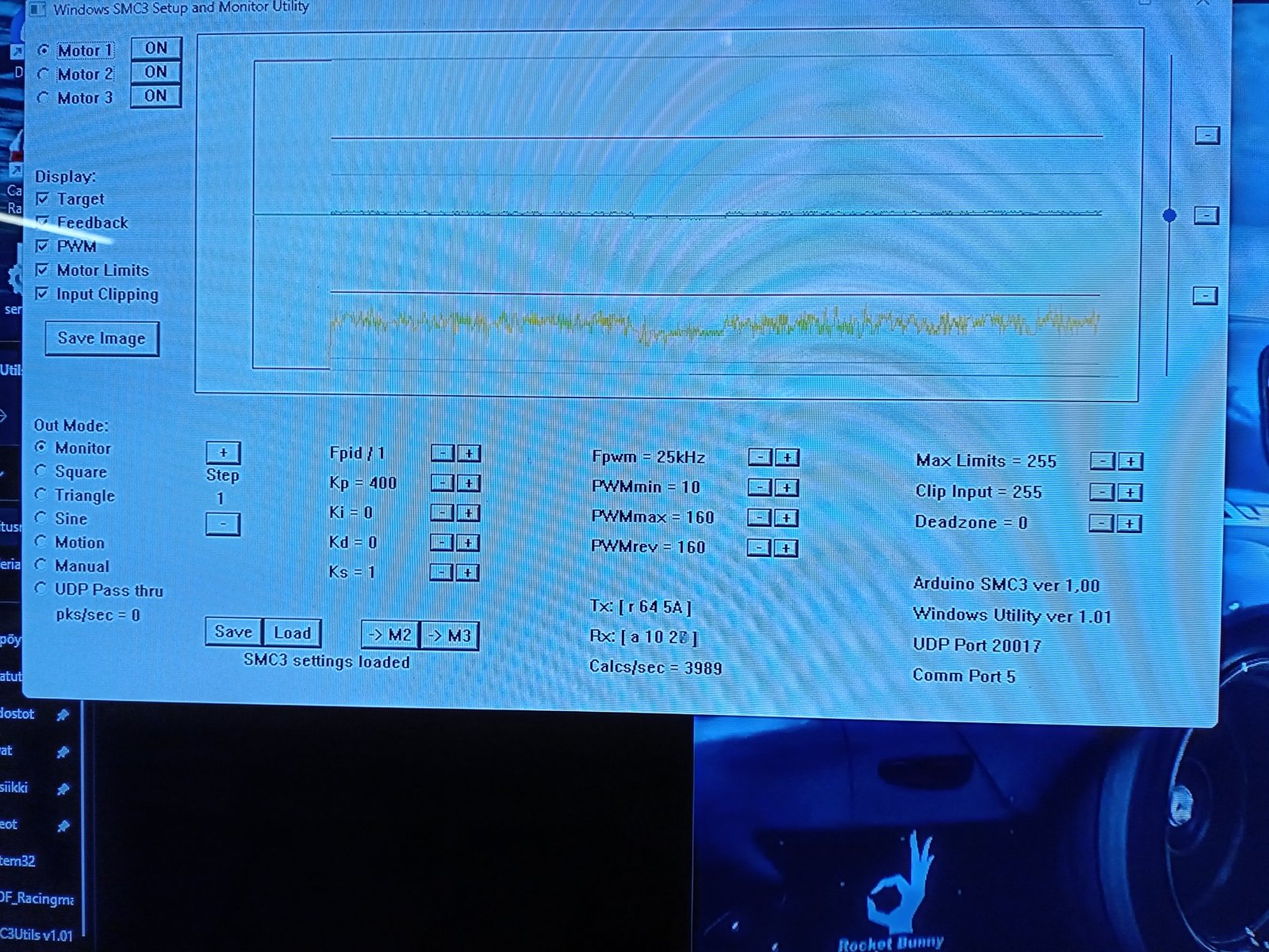

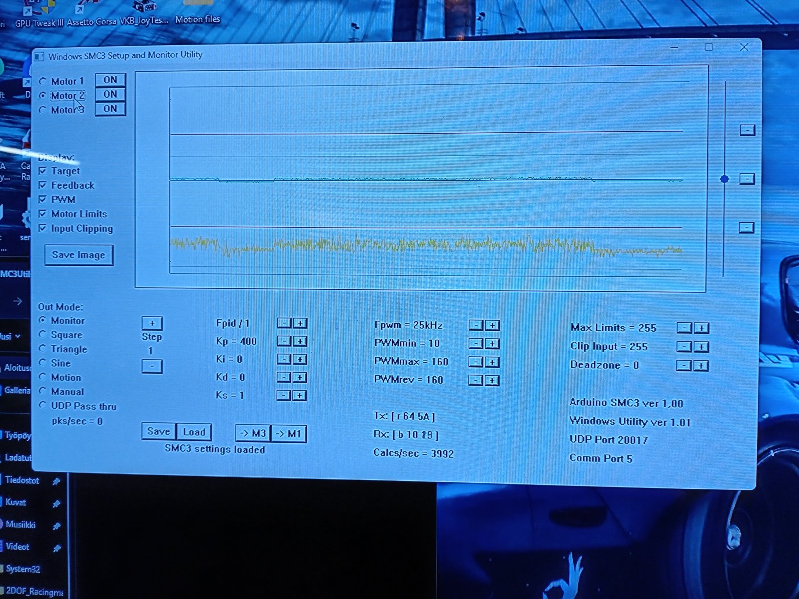

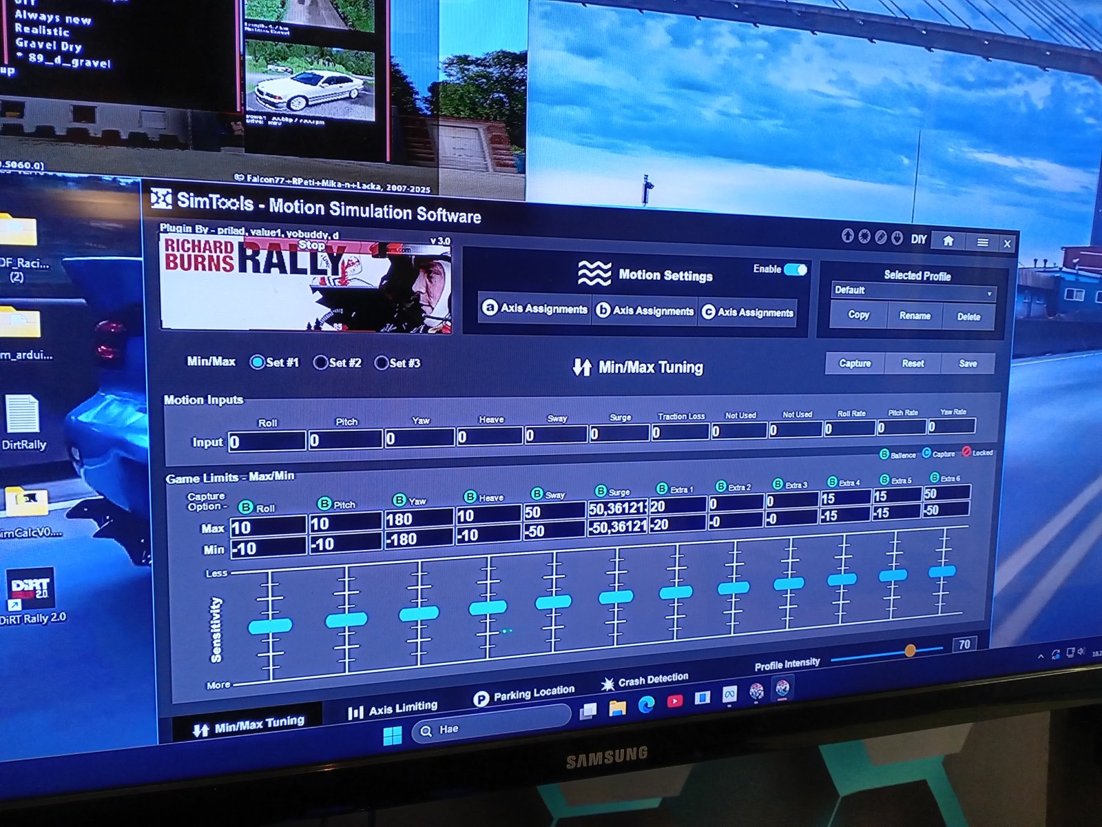

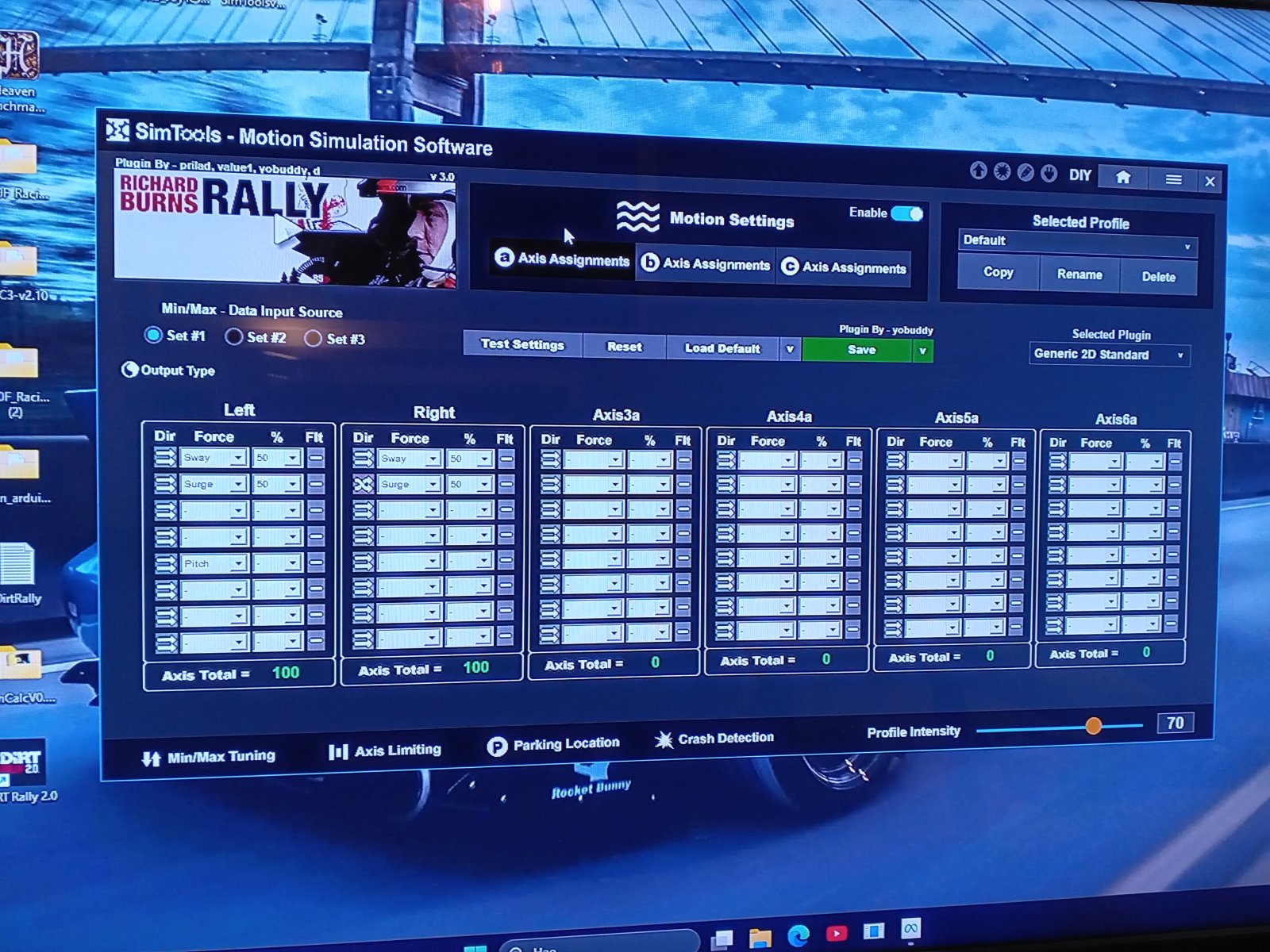

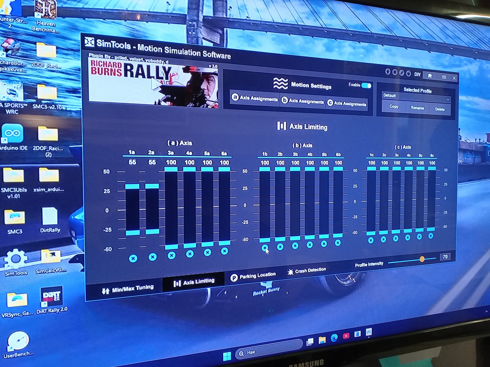

    I have changed many settings but not getting my rig to move like I want to.
    Problem is this:
    In sim tools testing all the movements works fine. But in game, surge movement is very low. It doesnt matter how much % I put In surge force, movement is always very small In game. Is there something I dont know about this thing?
    21,487
    150,542Coins
    +11,017 / 55 / -2
    Can you please post pictures of all of your settings, including the Tuning Center while the game is running.

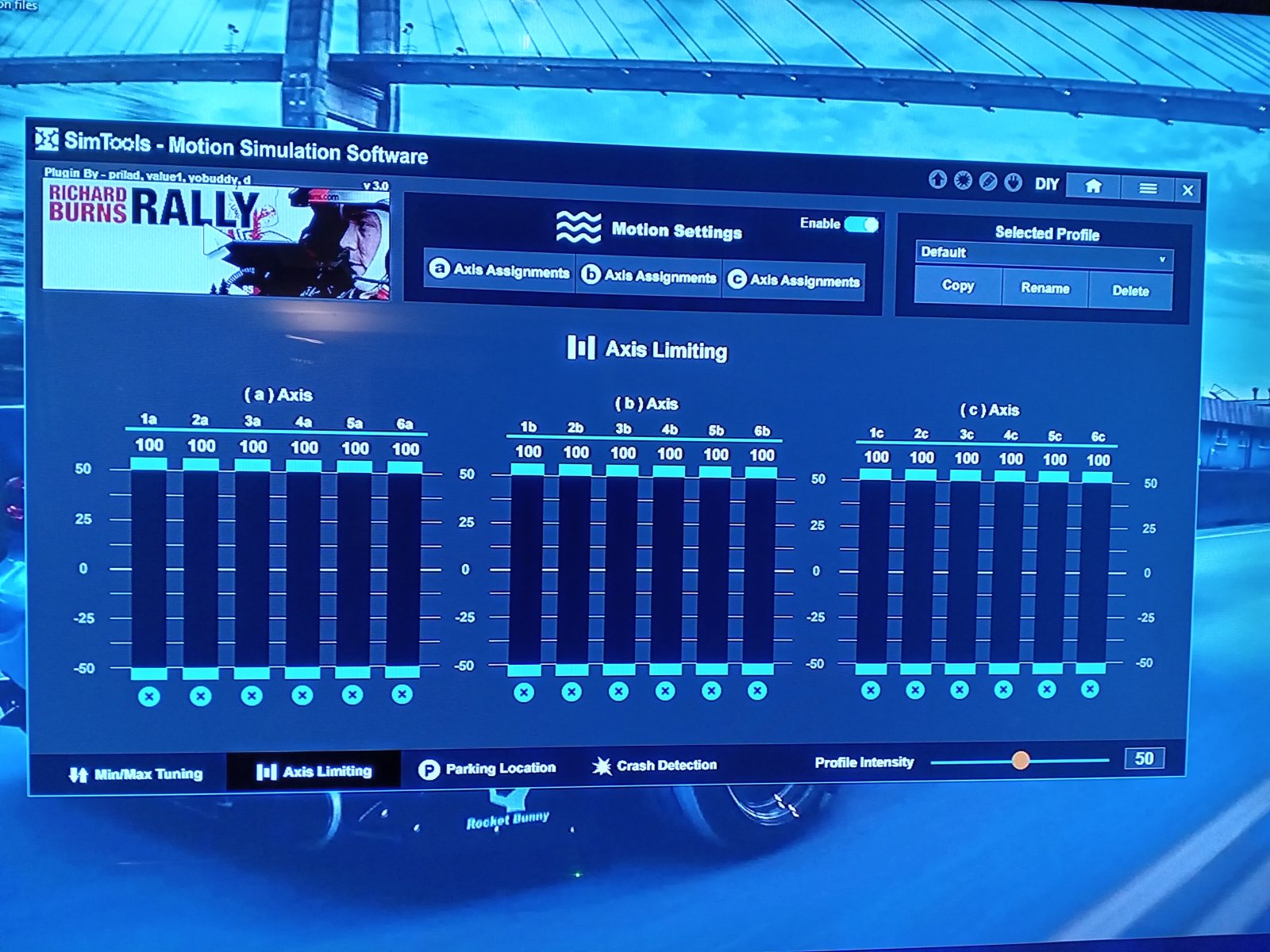

    Is there a reason you are using Axis Limiting?
    As there is no telemetry in the Tuning Center I am guessing the game is paused or in menu.
    While written with SimTools 2 in mind the tuning tips and tricks still apply, including tuning one axis at a time: https://www.xsimulator.net/community/faq/steps-to-create-a-motion-profile.228/

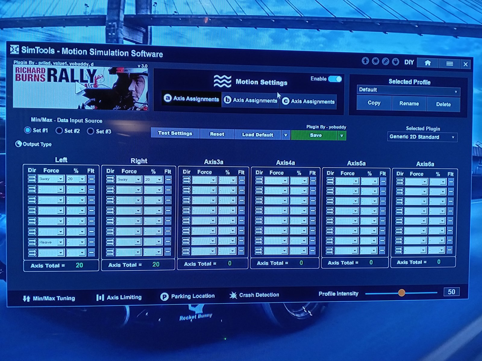

    So start with Surge set to 20% in the Axis assignment and a much lower Tuning Center value, say 2, just to check you have motion. You can Capture the Min/Max values in the TC and save then tweak from there.

    I tried to change min/max settings but always when I get sway to move, it somehow shoots seat to other way after movement. When I turn left, seat goes to right like it should, but after turn, it swings seat to left. I just cant understand What is wrong with this cause with my seat mover it worked like it should.

    Normally with sway either the Left or Right Dir is checked opposite the other, unless a motor is wired around the wrong way.

    But why it works like it should In assetto corsa without sway checked opposite? This problem is only In Richard burns rally..
