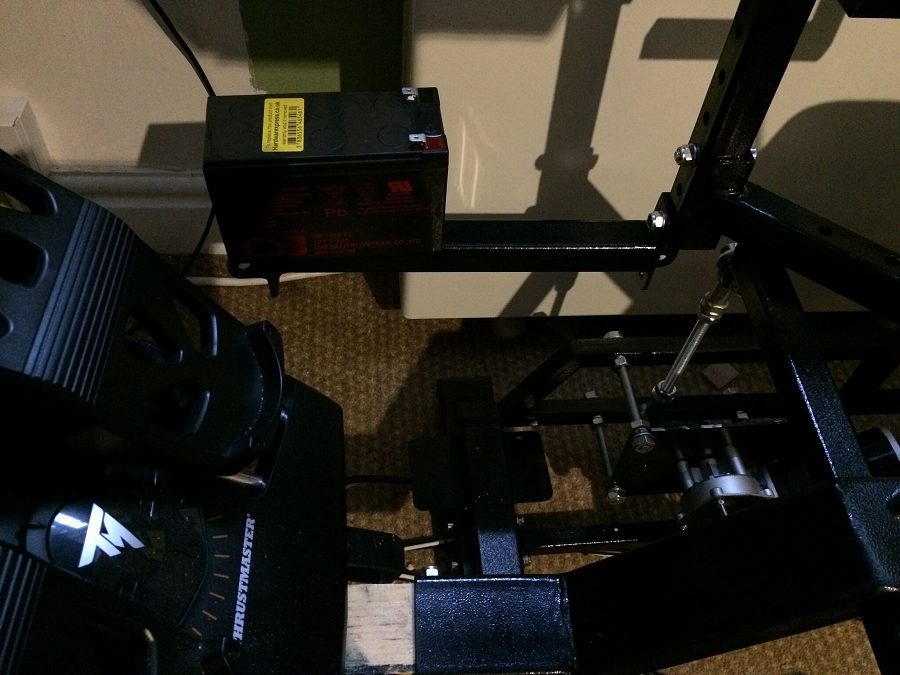

    I'd be grateful for some advice on dealing with the slack in the gearing with this platform. When the platform resets to neutral everything is fine and level, but when I sit in it, the centre of gravity shifts to behind the pivot (unavoidable with my height). The left hand motor/gear stays fairly fixed when this happens, but the right hand motor rotates back about 20 degrees putting the seat on a tilt to the left. If I was driving a lot and bouncing around perhaps this wouldn't matter, but I got this platform for flight so I'm straight and level most of the time, which means that I'm leaning uncomfortably to the left hand side. I was thinking that if I tweak the neutral for the right hand axis it could account for the slack but I can't find anything in SimTools to adjust the neutral point. Even if I do though, I wonder if I'll then lurch to the right as soon as I pitch forward any significant amount. I really wasn't expecting this much gear slack.

    Thanks for the suggestion, though my issue occurs even with the platform unpowered. Springs sound suitable for yaw but I don't think I'd want to give the vertical axis motors that much more work to do. See attached picture for this morning's brainwave - a lead acid battery counterweight.
