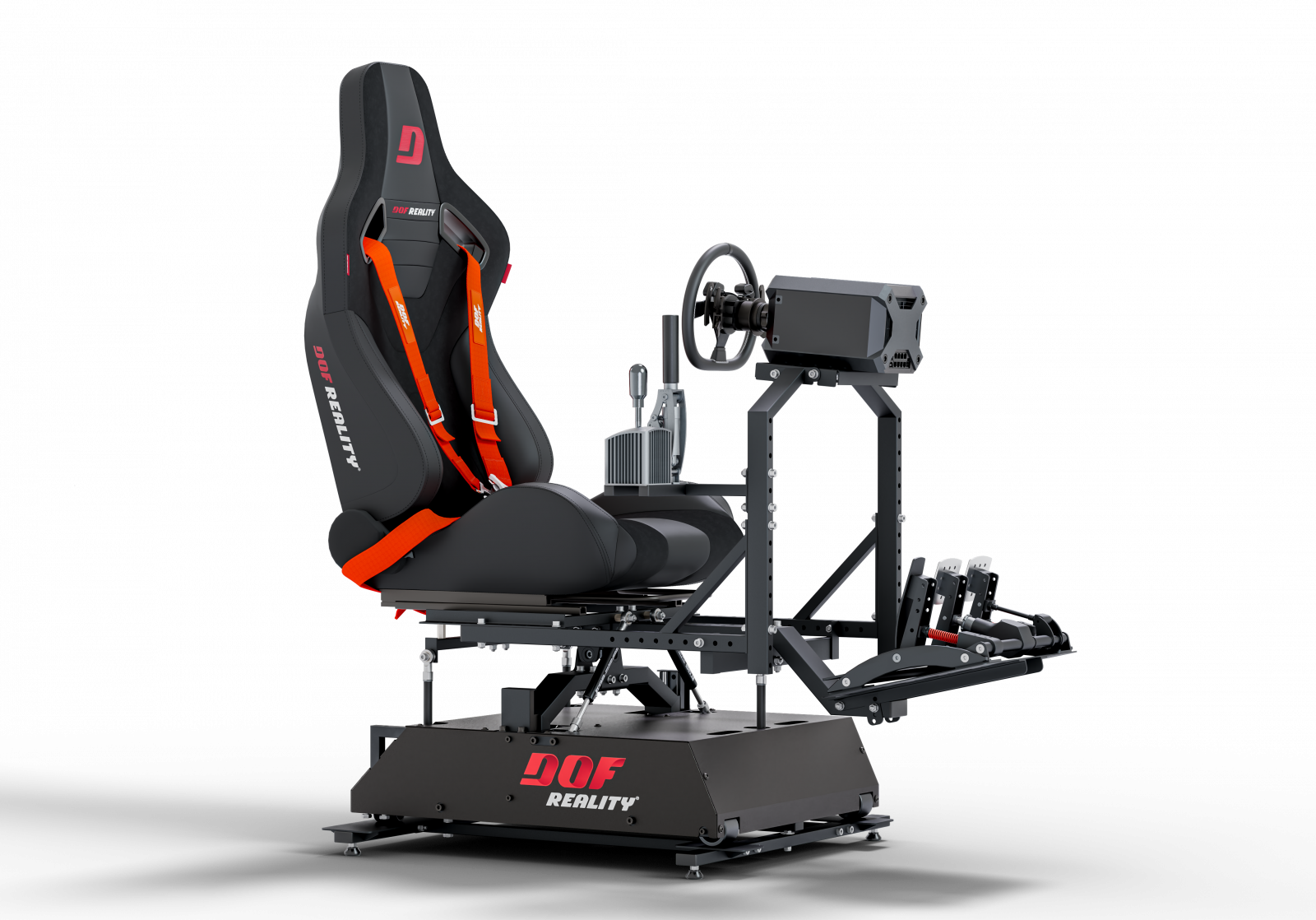

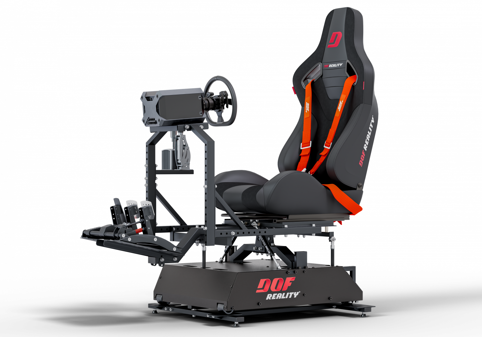

    Hello everyone!
    We are excited to announce the upcoming release of new motion simulator models featuring 4 Degrees of Freedom (4DOF): Roll, Pitch, Yaw (Traction Loss), and Heave.
    The lineup will include the DOF Reality H4, and the DOF Reality P4 will also be available — both platforms deliver enhanced motion realism and a deeper level of immersion.
    https://youtube.com/clip/UgkxmZTJCy5liVTiI_pI8TjdH_d-bkvFO0x8?si=SMgK4o7vo9QUy3mn
