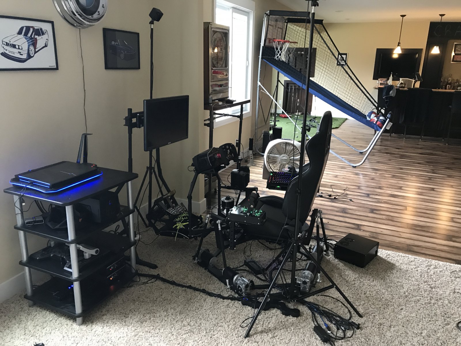

    Hi all, got my DOFReality H6 about a month ago. Pic here:
    My left control box was DOA, so don't have any feedback on movement. Haven't used the rig motion yet because replacements are on the way to USA from Ukraine....
