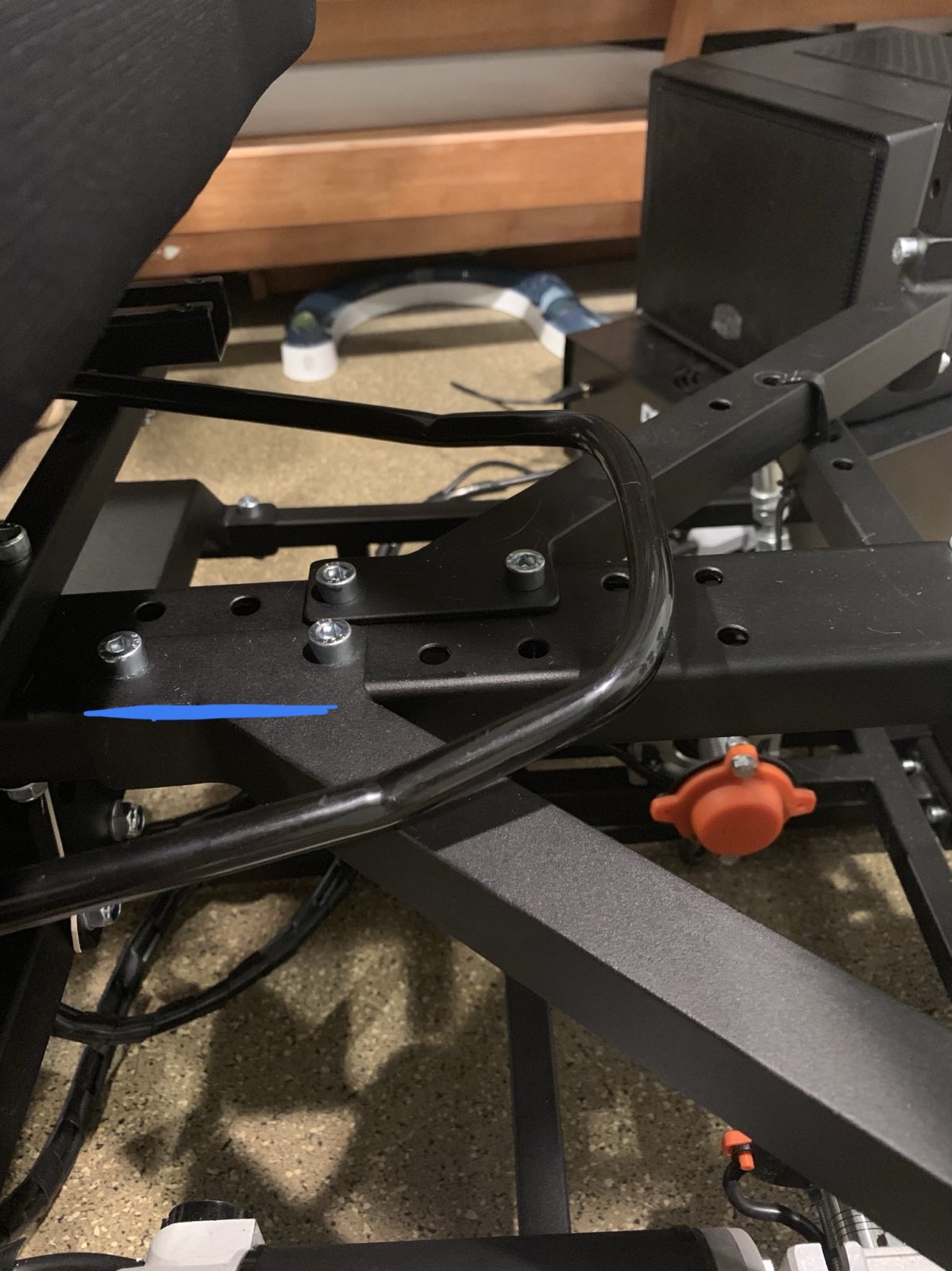

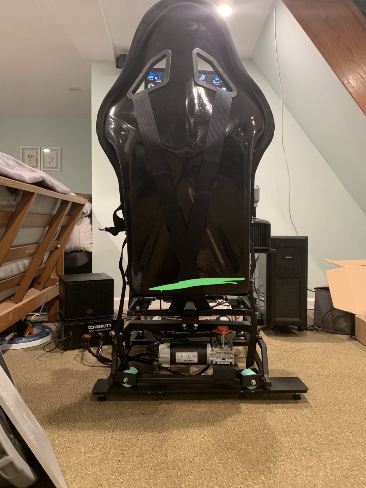

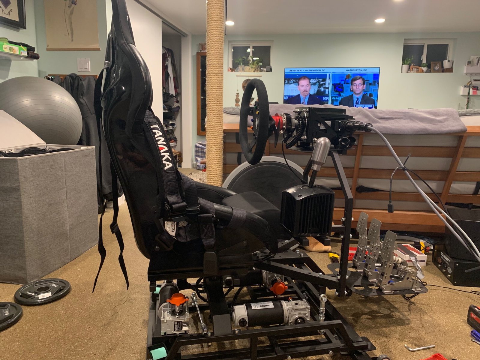

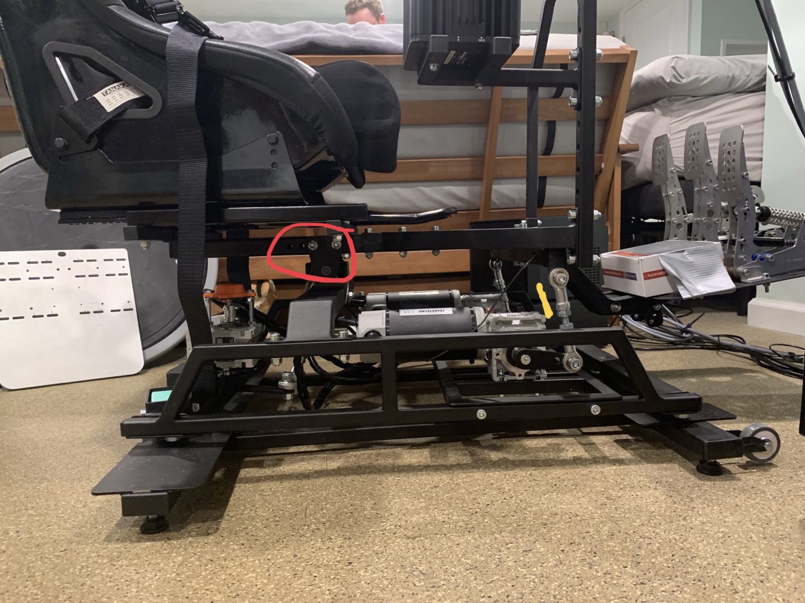

    Hey all. Just got the p3 a few days ago and have it setup and running ok but can't get balance right. I have the wheel and pedals moved back as far as possible and I am still forward heavy when in the seat. I can move the seat back more but will not longer be the right distance to wheel/pedals. Any suggestions, does my frame look like they are in the proper holes?

    i have mine p3 balanced right with 2 friends helped me..
    you need to disconnect the 2 front rods and then your friends can tell you in which direction the rig is balacing.
    one friend in front of the rig holding and one on the back holding.
    when you have put your seat back you must come with wheel and pedals also back..
    you can also help out with springs on the back that push the seat back...so that you are balanced!
    It need some time , but this way you can do it right!
    if you have question , write me PM! maybe i can help you out!

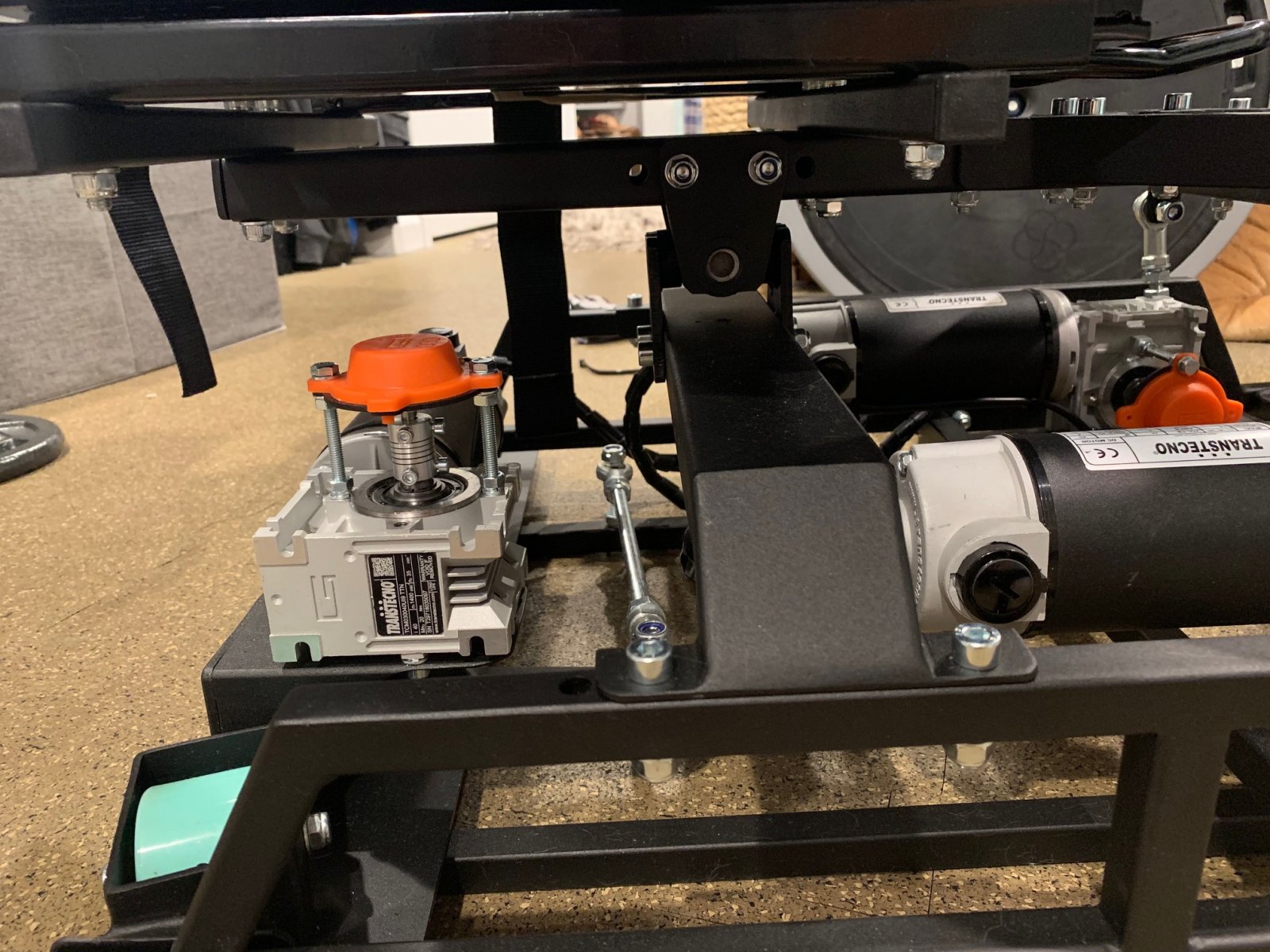

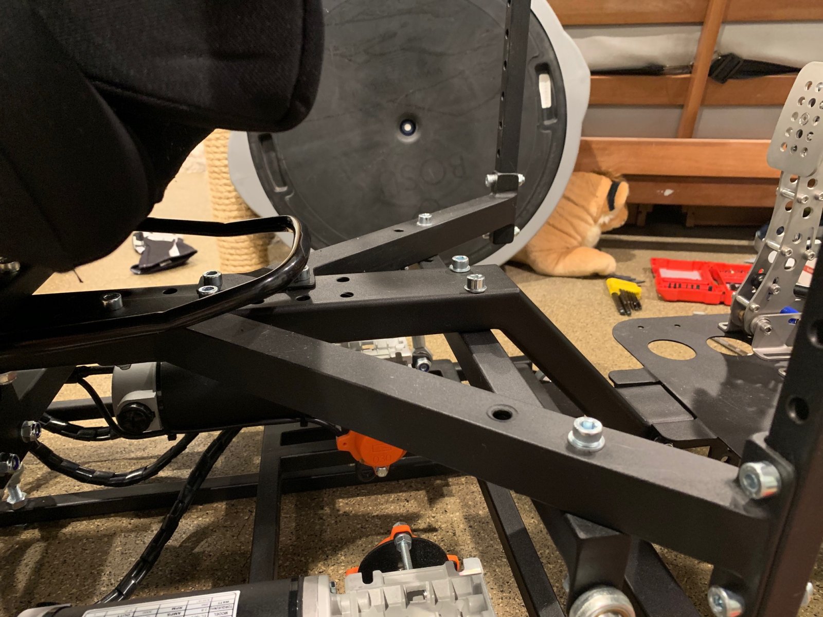

    I moved the center joint to back holes (red).
    And the wheel post (blue) to back holes.
    The front to back and side to side is very close to balanced when the motor rods are disconnected . Maybe slightly forward but only a tiny bit compared to before.
    Is the angle of front motor rods (yellow) ok?
    The seat always seems to lean towards left (green) even though it is balanced side to side with motor rods off.
