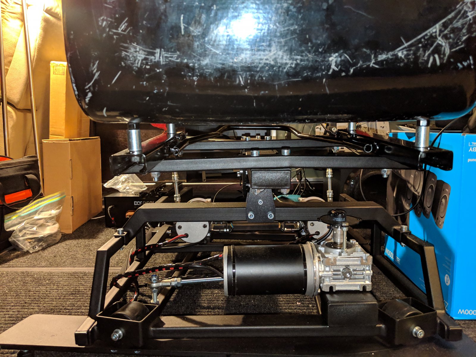

    Has anyone had any issues with bending in the frame pieces that support the seat?
    Starting to see that happen on mine after less than a month of use, i'm not a heavy guy!
    Attached a pic, look at the area below the centre bolts.

    That is worrying.

    DofReality obviously think they can charge more for the product which is obviously going through a cost cutting exercises. Unless of course your idea of 'not a heavy guy' is different to a Ukrainians idea of 'not a heavy guy'.
    Most of the box section is too thin really with the section deforming when the bolts are tightened but I think that's a step too far.
    I know that those seat frames were quite thick when I bought the rig because it was quite a lot of work for me to join up all the holes so they became slots.
    I'm quite heavy really (90kg) and those rails didn't bend in that location for me.
    I would be going back to DofReality and asking what the hell is going on.
    I was just looking at your photo and I think there has been quite a lot of cost saving along the way since the version I have. Motors and gearboxes seem cheaper, no covers on pots. Im sure there are all sorts of other changes.

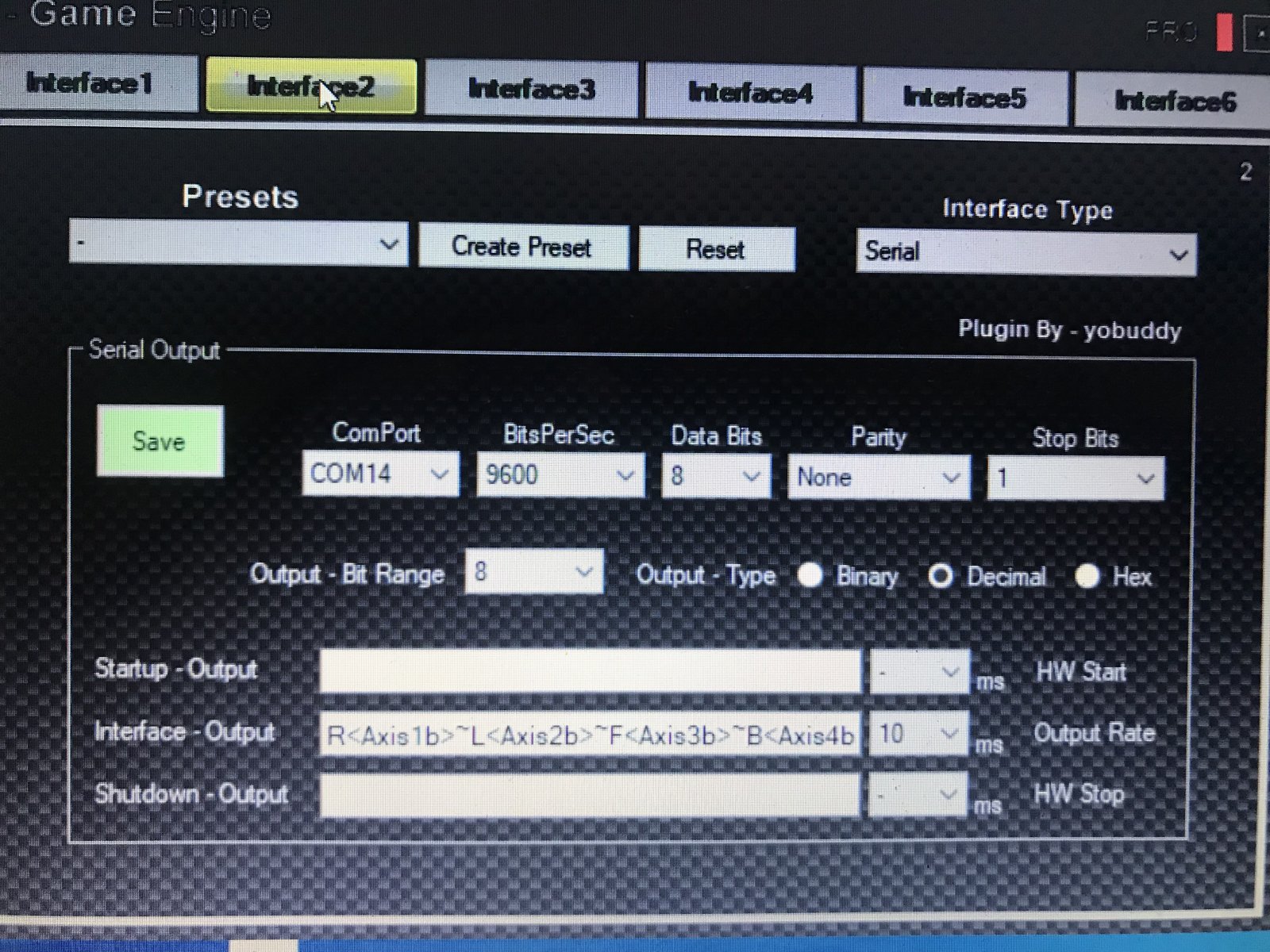

    Here are my Arduino code for the G-Seat for up to 6 servos
    Interface Type : Serial
    Comport : is at every individual
    BitsPerSec : 9600
    Data Bits : 8
    Parity : None
    Stop Bits : 1
    Bit Range : 8
    Output Type : Decimal
    Interface Output : R<Axis1b>~L<Axis2b>~F<Axis3b>~B<Axis4b>~G<Axis5b>~H<Axis6b>~
    Output Rate : 10ms
    this setup works well for me
