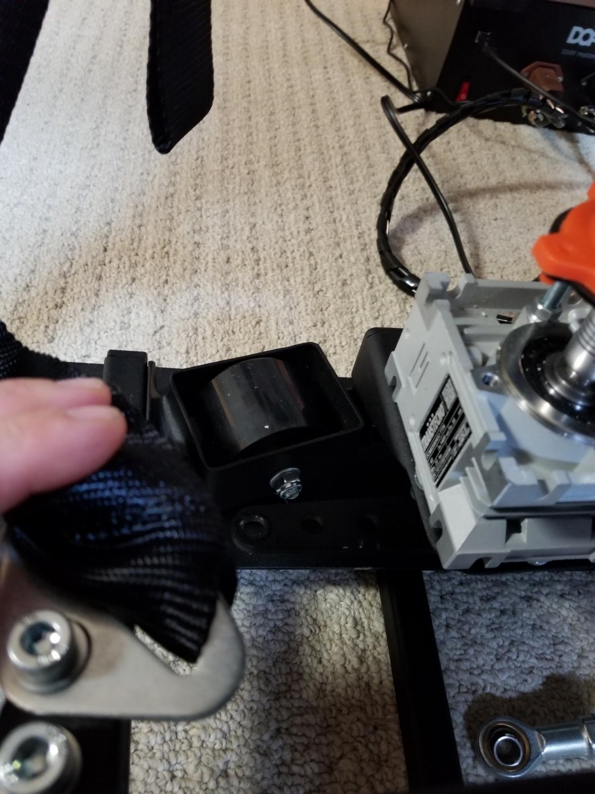

    I have a 4 point harness that I want to use with my racing seat. Does anyone have any recommendations on how to attach the harness to a P3 system?
    21,723
    152,051Coins
    +11,063 / 56 / -2
    As per my previous reply he simplest and most common way for most sims is to attach the two lap belts directly to the bottom frame and use a spring between the two shoulder straps and the bottom frame.
    But members such as @SeatTime have gone even further and created motion driven harness that loosen and tighten in response to motion: https://www.xsimulator.net/communit...int-harness-on-racing-seat.12331/#post-160962

    I have this rig and I attached lap belts to sides of seat - top of frame NOT bottom.
    I had it ties at the bottom to begin with and it felt awful when the seat rolled etc and the belt would slack and tighten .
    Worked much better when attacked to the seat as the pressure was then constant and even but I did attach the shoulder straps to the bottom non moving frame with a thick cable tie - no spring . Works great and if your strapped in properly the straps tighten (seat pitches forward)
    as you brake and it feels bloody good! ;)

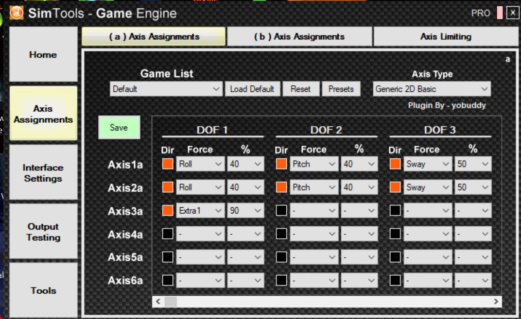

    Got my P3 setup. Installed the sw and ran the output test. I have no movement on the Yaw (slip) or heave axis? The back motor arm is not moving at all and is stuck in the back position?

    So, when the nP3 first powered on, the back (slip) actuator arm moved completely to the left (facing sim) causing the back of the sim to shift right. Using the default settings in Game Engine I cannot get the back actuator (slip) or heave to work?

    The DIR being checked orange or not determines which way an axis moves and yours are all mixed up @greatg67.
    There is a link in the first post of this thread to settings for some common games: https://www.xsimulator.net/communit...ject-cars-2-can-anyone-share-me-theirs.11273/
    But to get the most out of your rig you will need to learn how to develop motion profiles, as many for the DOFreality rigs have such high axis allocations that they will induce clipping, see here for the steps involved in refining a motion profile, and you do one axis at a time: https://www.xsimulator.net/community/faq/steps-to-create-a-motion-profile.228/
    Once you get the basic issue and profile sorted you can refine traction loss even further: https://www.xsimulator.net/community/faq/traction-loss-in-simtools.175/

    That will work. But my traction loss actuator is not moving? When in game engine default settings I get no movement from this actuator. As I mentioned, when first power on, it moved to full left and hasn't moved since?
