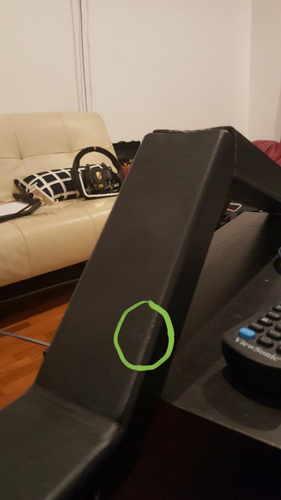

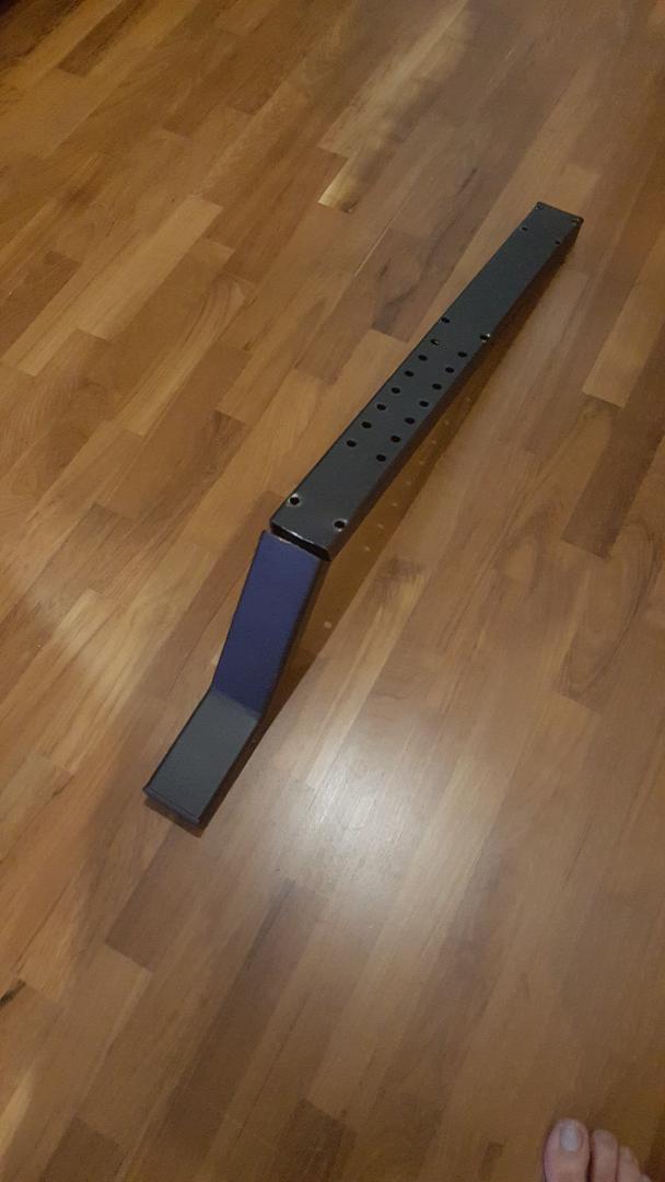

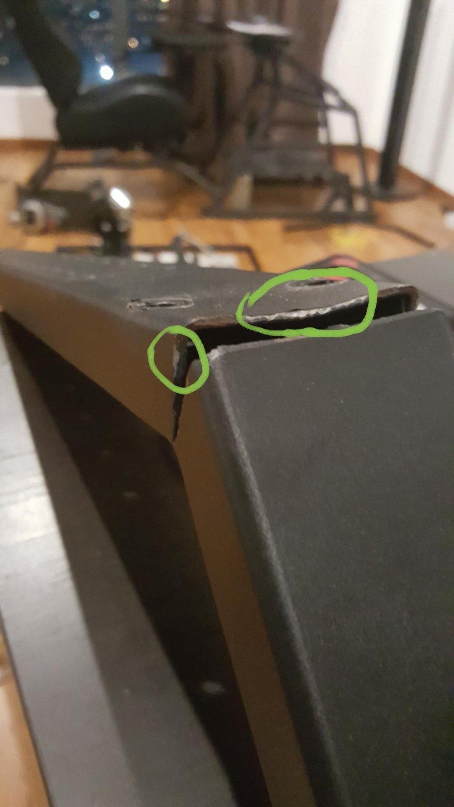

    Gentlemen - Watch your Welds
    [​IMG][​IMG]
    Anybody with a heavy set of brakes please take note.
    Igor told me at the time of purchase the welds had been strengthened but it looks like its still not enough.
    Maybe Logitech or Thrustmaster pedals may be ok but I suspect any Load cell pedals or high end hydraulic pedals are likely to be prone to a failure at some point in time.
    I mean, it's OK, I can get the joint re-welded and strengthened but I think DofReality need to look again at their design.
    For me, that's Traction Loss roller failure and now major weld failure.
    Keep a look out guys, these things wont last forever
    Andy

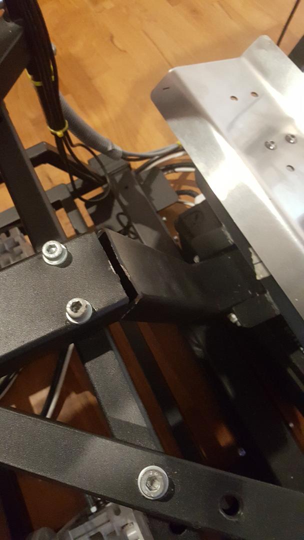

    First we are sorry to see this happen.
    This is the only second time in our over two years and hundreds platforms sold practice.
    Was there any specific reason for it? did you put more weight compare to your original design ?
    as we see that this profile was blended before crack:
    Anyway, we always eager to help our customers and can ship you or other customers with same issue extra welded replacement parts and rollers, no mater when the purchase was made and even if the warranty already expired.

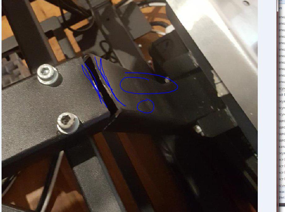

    Obviously it was fine before the failure. The first photo clearly shows that.
    Before I purchased the rig I told you guys what kit I was installing and at no point did you suggest it was too heavy and you told me at the time that part had been strengthened because of the earlier failure. There is no additional metal in the area of the fracture so other than possibly improving the quality of the weld which You may or may not have done, you do not appear to have made any modifications to the design as a result of the first failure that has occurred.
    Im an engineer and part of my job is associated with failure analysis so I have some idea what Im talking about. That stress point should have additional metal around the two joints of the dog leg.
    The deformation at the failure point I would suggest is down to stretching of the metal as the crack propagated along the weld. The other areas you highlighted are not dents mearly finger marks. Just look closely at the other photo to see nothing. It has not been damaged prior to the failure and I dont like your suggestion that I'm being unscrupulous.
    I have generally provided +ve feedback to people who have asked about the Dofreality rig on this post citing good value for money and good customer service from Dofreality however I've had cheap crappy rollers fail and now I've had weld failures and the first thing you do is imply that I was doing something I shouldn't be doing. Of course there was metal deformation at the failure point. It clearly didn't fail instantly across the whole weld, but started to fail at the corners (the stress risers) and as the crack propagated, the remaining metal stretched because clearly that box section isn't strong enough.
    Don't you dare suggest it was me.
    Good customer service does not include instantly saying "it's not our fault, its your's"

    Lets first have a look at your suggestion that there is other damange
    The only damage you can see (other than the weld failure) is from manufacture and under the paint.
    Now lets have a look at the weld failure
    The highlighted areas are where the weld failed. The other darker areas are where the weld had failed some time ago (or not a full penetration weld at all). The deformed area as obviously where the metal has streched.
    The wall thickness of that box section just isnt strong enough. The quality of the weld is poor and there is no strenghening.
