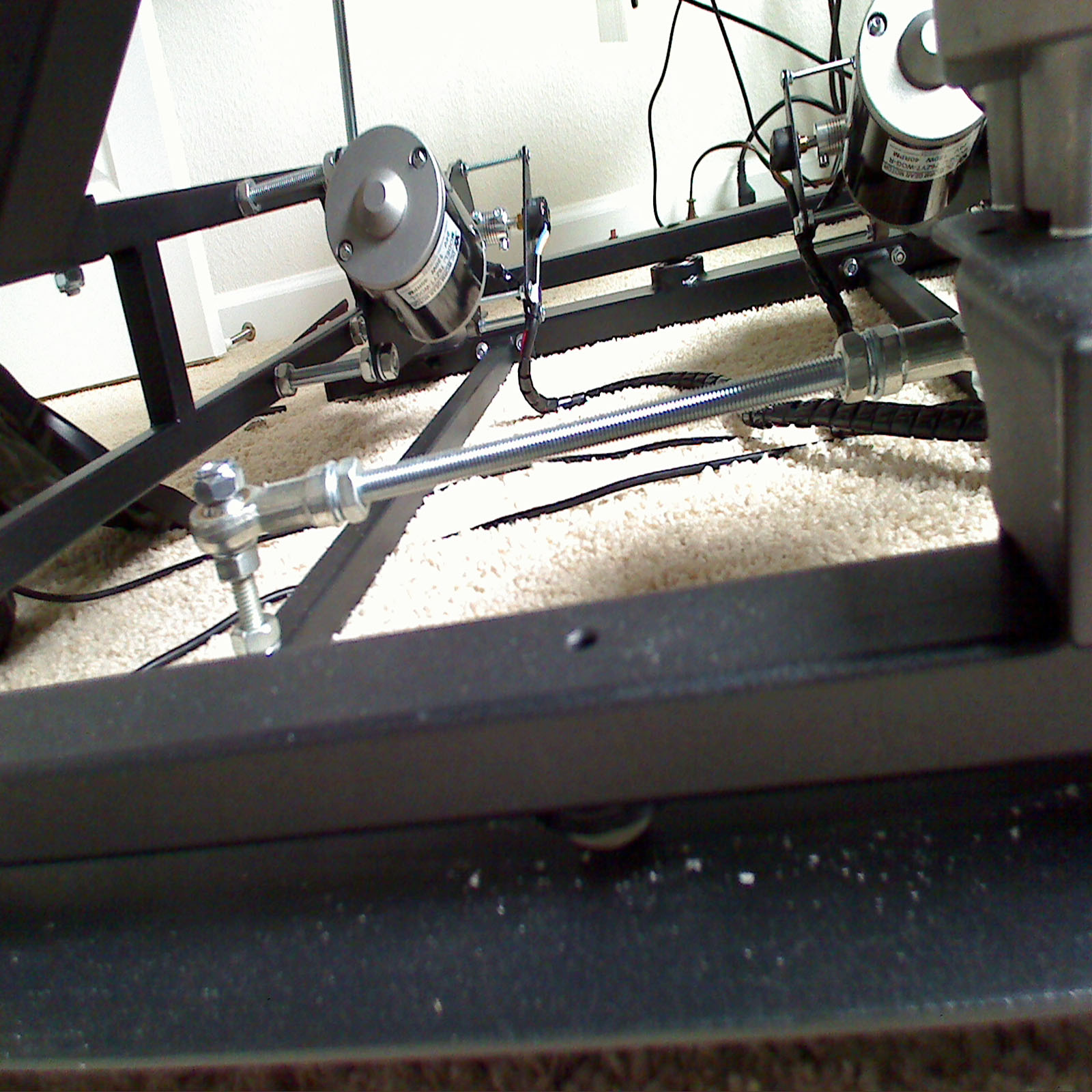

    Has anyone had issues with the tractionloss wheels? I have started seeing "chips" coming from the wheels, primarily the center wheel. See picture. I have sent an email to Igor with this picture, but, have yet to hear from him.
    Anyone have any experience replacing these wheels?

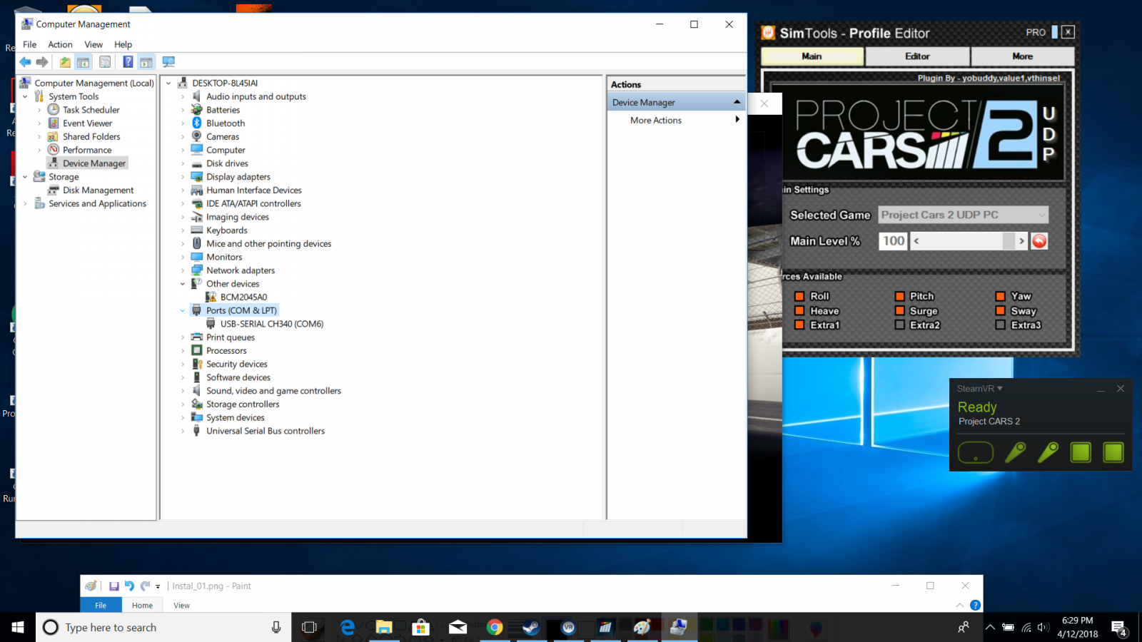

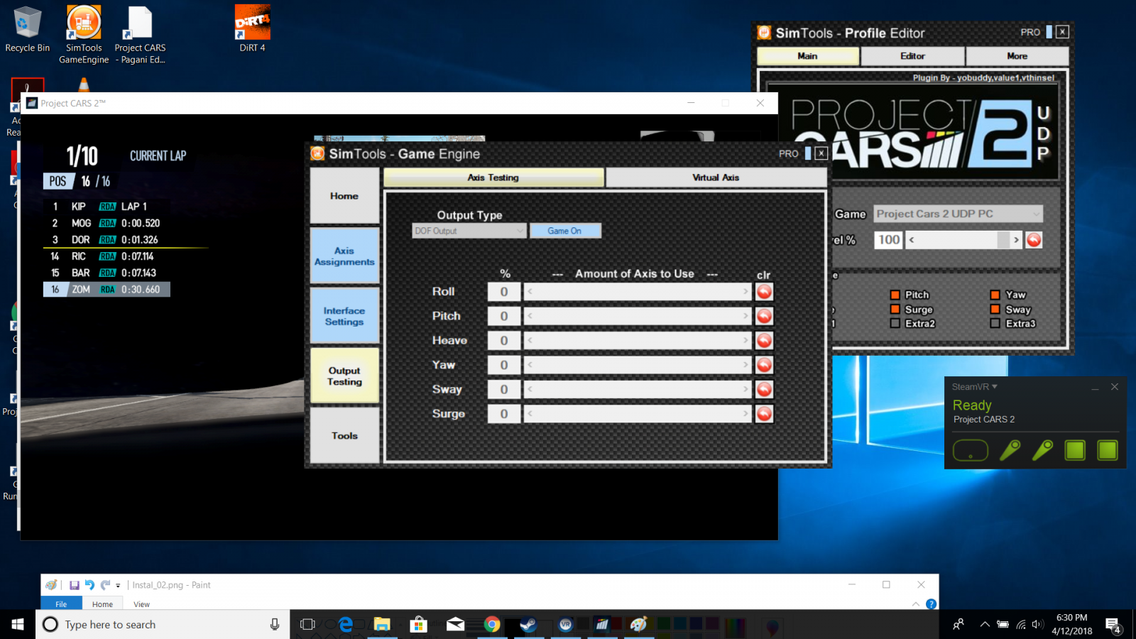

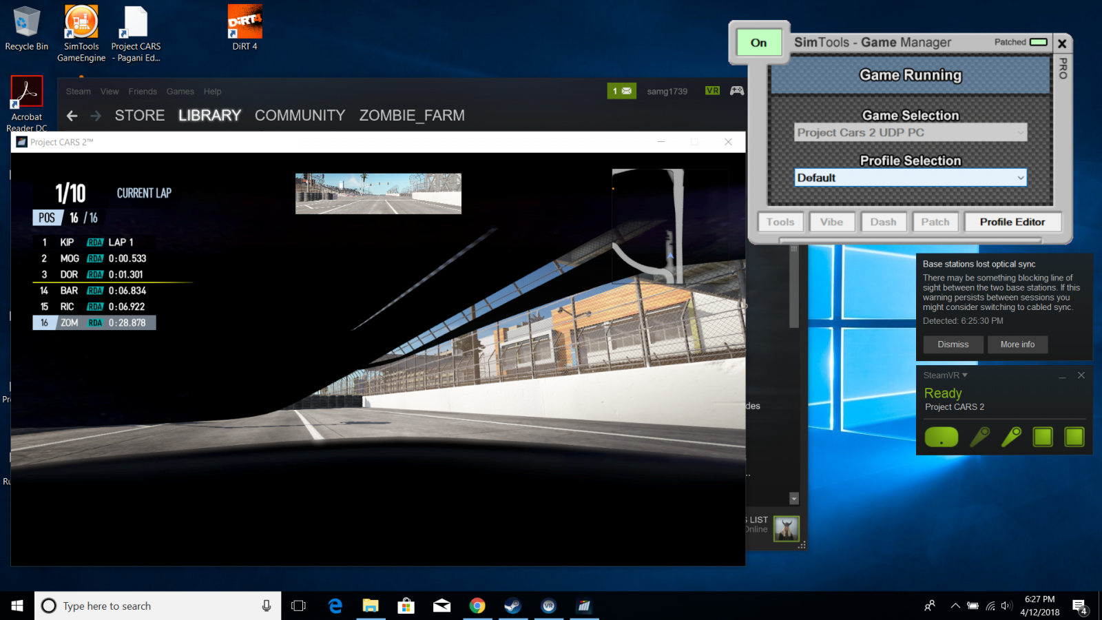

    Problems with setup -
    I feel like I'm missing something simple. I have everything put together. went through the docs and videos several times. Is there a missmatch between the PC2 UDP and the plugin I installed. I noticed there were 3.
    - Uninstalled and re-installed sim tools.
    -Ran game engine and game manager in administrator mode
    - output is working when testing pitch, tilt, heave ...(except traction loss, not sure why)
    -Patched the game
    - played over an hour of the game (PC2) with no motion for data save
    (both game engine and manager were running...bad??)
    -formatted and put a clean ver of windows 10
    - uninstalled any and all firewall/ antivirus thinking there may be some block.
    - I even get a "game running" status while in the game.
    again this is probably something simple I'm overlooking, below are screenshots of my sys before and during game play.
    Still no movement.
    Any help would be appreciated.

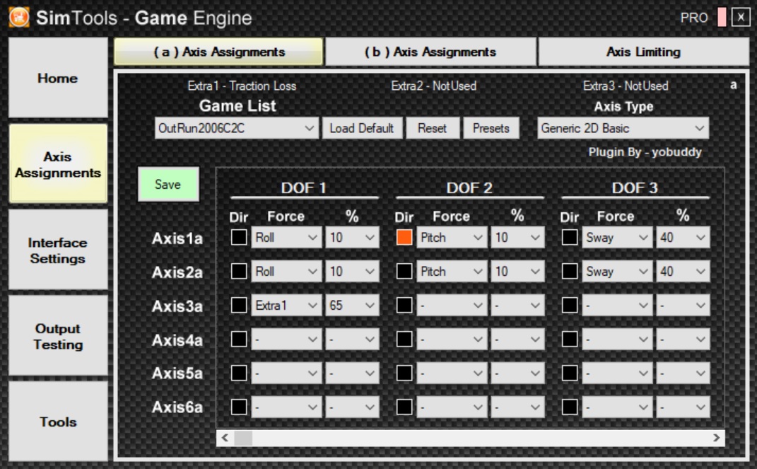

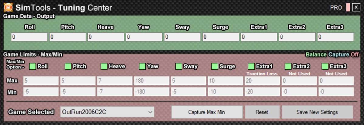

    As a recent H3 owner I'm still easing my way into SimTools. After some initial frustration with "why don't things just work.." I thought I share my what I have learned with my preset values for OutRun 2006 (you can find the game free on google at the time of this writing). This game is best played with a wheel set to about 200 degrees of rotation (even if your wheel supports 900 or 1080 degrees you can change it in the control panel or in your wheel's setting app). Please note that the axis presets are similar to the Dirt4 presets included by DOFreality. I've also shorted the min/max values within the profile to give more of that arcade feel.
    outrun2006-DOFReality-axis_preset1of2.jpg outrun2006-DOFReality-axis_preset2of2.jpg outrun2006-DOFReality-profile.jpg

    As a rule of thumb you should run a game before patching, not after.
    As a general rule you should not need admin mode.
    Does the rig move in Output Testing and follow the conventions SimTools expects: https://www.xsimulator.net/community/faq/which-way-to-set-simtool-axis-movements.230/
    Have the in-game Pcars2 options been set: https://www.xsimulator.net/community/faq/projectcars.188/
    Are you using the DOF reality game presents: https://www.xsimulator.net/communit...ject-cars-2-can-anyone-share-me-theirs.11273/

    Yes thats pretty normal. The rollers used are designed for wardrobe doors and not designed for taking the weight of you and all that kit. First thing i noticed was when my traction loss stopped working when I was sat in the rig. I thought it was the moto and gearbox at first and it was only when I took things apart to examine the motor and worm drive that I realised
    Have a look at one of my earlier posts (page 14 of this thread post dated 3rd May) where I provide a drawing for replacement rollers made from nylon. With all five rollers replaced I have had no problems.
    I guess the problem is getting the rollers made. I was lucky to have a friend with access to a machine shop and he turned a set for me amd a set for himself (although his rollers have not failed yet).
    Yo do have to dismantle the back end of the moving frame (remove the whole moving frame if you want to replace the rollers at the front as well) and prize off the roller and the central roller axle. Replacement in simple and reassemble is easy enough. The most difficult part for me was getting the fromt of the moving frame out of the forward pivot bearing.
    Andy

    Andy, thanks for the reply. Things haven't failed as yet. It does appear I should start looking for replacements though.

    Pls look at the nylon wheels look among the spare parts where was bolts and nuts.
    @Spacebar did you enable UDP output in game settings?

    Radioproffi: Thanks for the reply. I did see one extra wheel with the spare parts. Are the wheels that come installed in the platform nylon?
