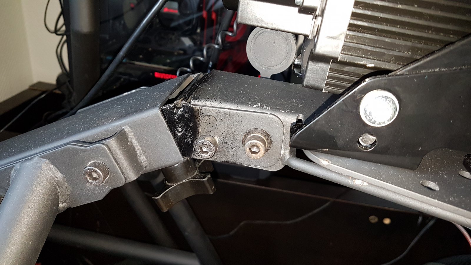

    Andy the bolts are tight and the motor arms are uninvolved when sitting still.
    So this morning I pulled the u-joint out and found that there was much play between the bearing caps and the frame parts. I would call it a very sloppy fit and lots of grease as well. Cleaned the grease off and found the interior of the cap holders to be poorly/awful machined or drilled out or however it was made. I shimmed the holes with aluminum tape or aluminum flashing in some cases. I don't know how long that will last. Put it all back together and am amazed how there is NO play at all.
    I imagine my lap times will be better as I won't be fighting the fishtailing.

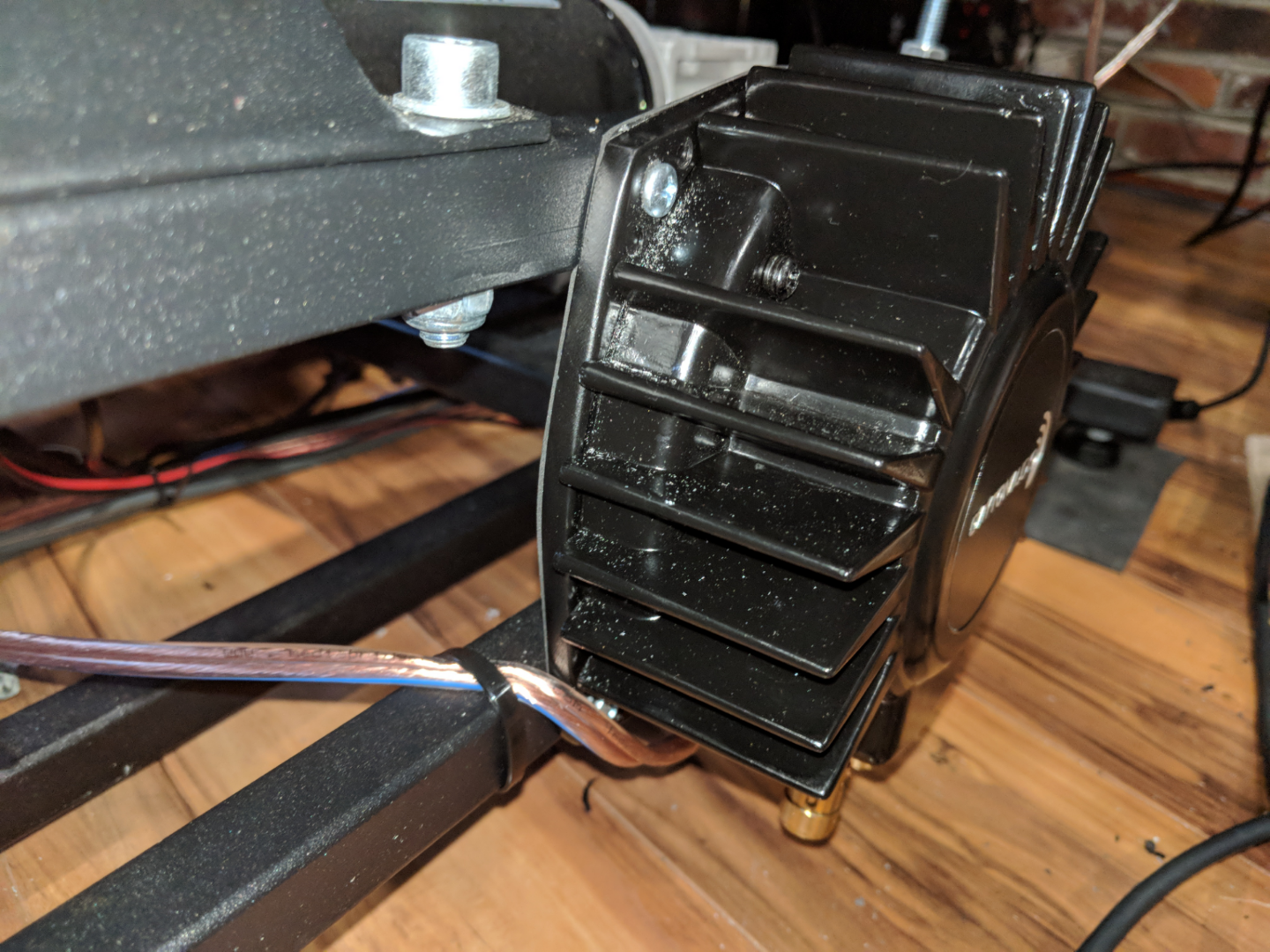

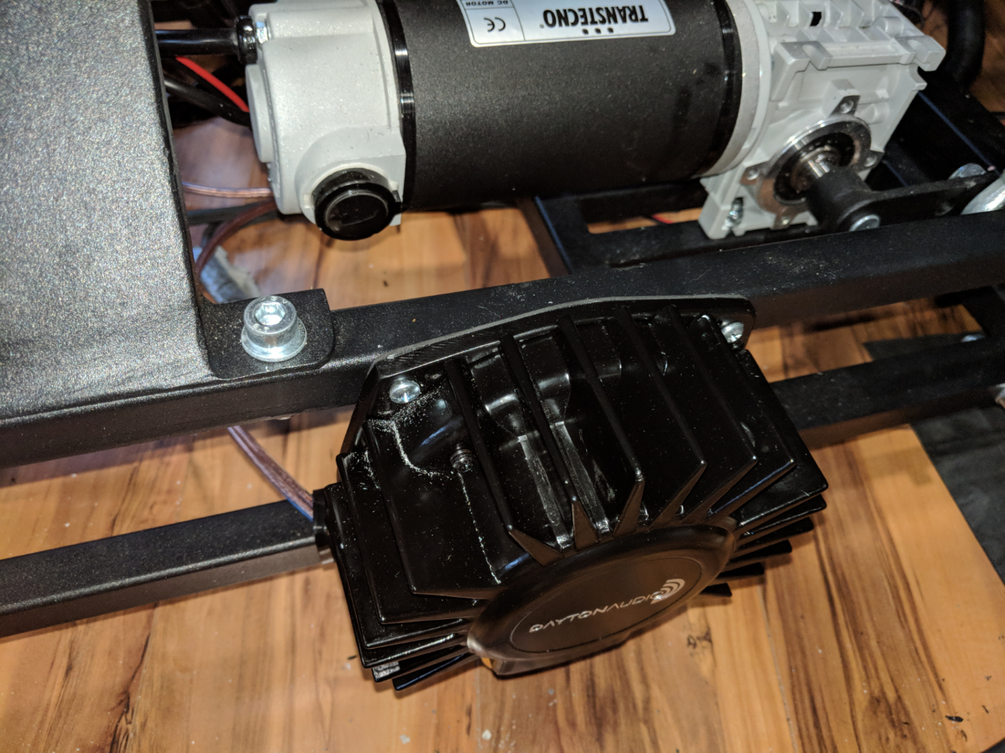

    I have aurasound bass shakers which look almost exactly like your daytons. Do you feel them where they are placed? do they act as the wheels..? and can you please take a close up of how you attached the to the side like that..?
    Also, three bass shakers on the pedals alone? woahhh isn't that overkill lol..?

    Only 2 on the pedals. A mini lfe and a Clark synthesis.
    The reason it's not Overkill is they do different things. The mini LFE Only Hits the hard notes. And the Clark synthesis vibrates through all frequencies. so you got all the nuances of the road and the engine. when you hit a wall or another car or a big bump is when the butt kicker kicks in.
    No I cannot feel the effects from side to side because I currently only run everything through my stereo. So it's just one big mess of vibration but it is badass. Eventually more towards winter I plan to mess around with simvibe for that realistic effect.
    I used self Drilling sheet metal screws to attach it straight to the frame. The entire back of the Dayton has a rubber backing. If it did not I would have used some kind of rubber washers in between the frame and the Dayton's. I actually plan to put these somewhere else but didn't realize how big and heavy they were. sketch-1532473283151.png sketch-1532473294244.png

    The wheel deck has some play to it back and forth. You can strengthen it up with a few pieces of aluminum angle bar. It does the job, but to the bare minimum out of the box.
