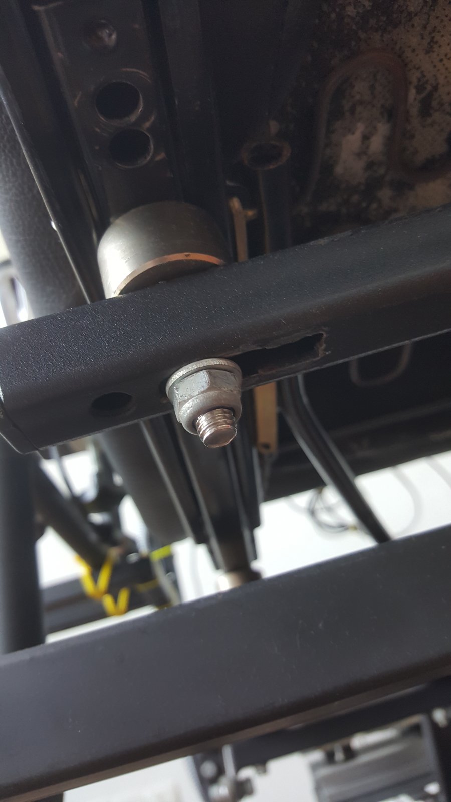

    I think they are just 6mm bolts.
    Te bolts attach the seat to the runners and then the runners bolt to the DofReality seat frame. You will see in photos I'll get to you over the weekend that I also used some spacers.I had to do that to allow the seat runners to work properly.

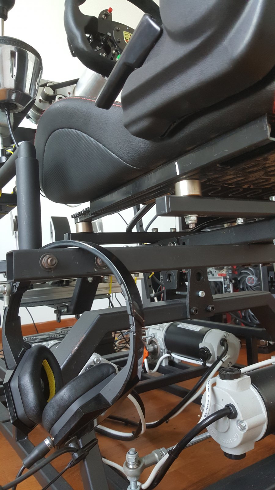

    Here is a photo of how the seat mounts to the frame
    I slotted the seat rails to provide some side to side adjustment
    Yeah, I know the slotting wasn't very neat and tidy.

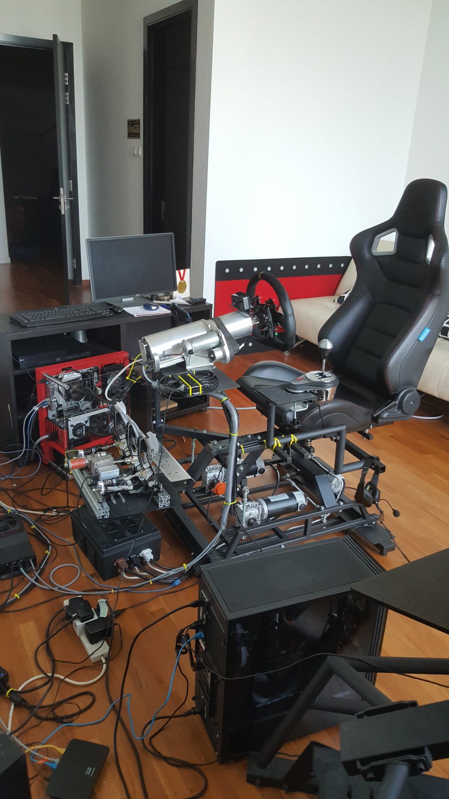

    Hi Marco.
    Not all the wires you can see are related to the rig, but most are.
    I sometimes wonder myself what they all are and why they are there.
    There are actually two computers. The red pc is the gaming computer which connects to the motion rig, wheel, pedals, shifter, wheel mounted button box, digital display, keyboard, mouse, second monitor projector and small tablet display. The second black pc is my Assetto Corsa server allowing me to run Assetto corsa races without it drawing resources from the gaming pc.
    It's probably all a little excessive but it all works ok. I guess you could get away with a lot less.
    It wouldn't be a five minute hid to disconnect the rig from the pc however I have two powered usb hubs mounted on the rig so other than the displays, all the comms between the pc and the rig are on two usb cables only. One usb hub covers the the wheel, shifter, button box and digital dash. The other usb has two cables for the DoD reality, pedals and small tablet display which I use as an additional button box.
    The sixdof does look interesting. I do like the low level design. Most sixdof rigs seem to be very tall. Would be even more wires though.
