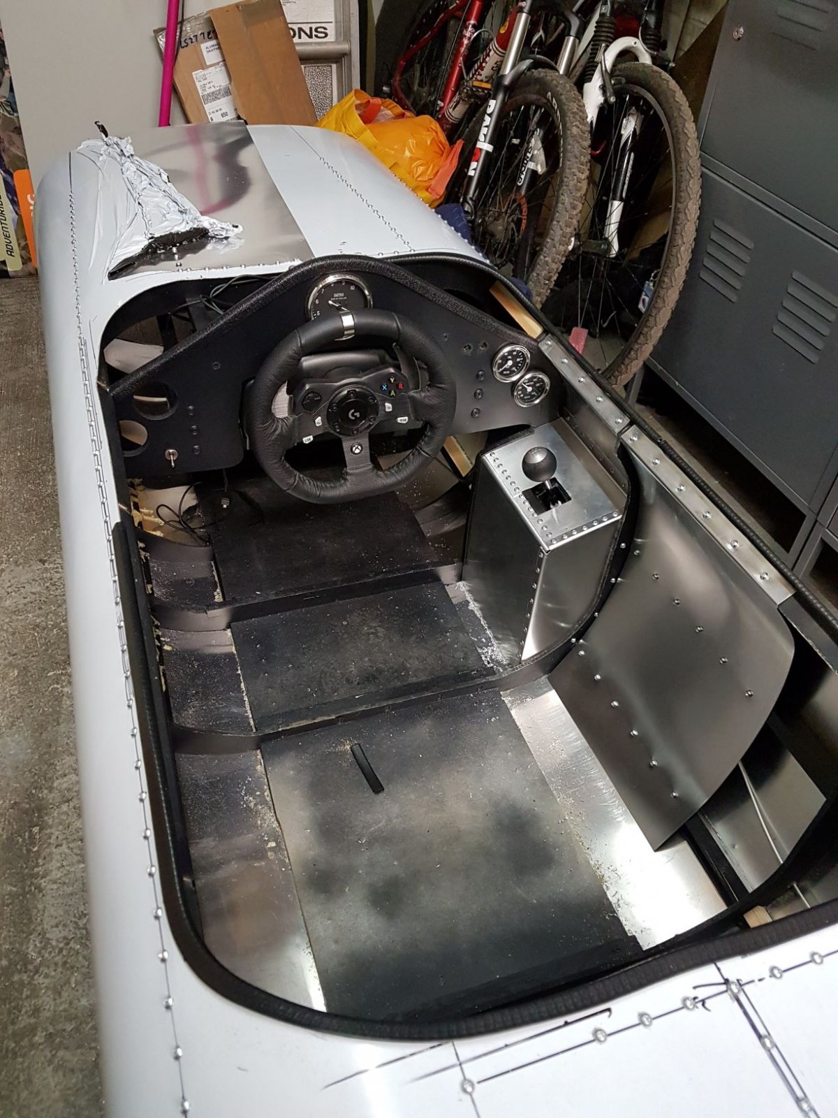

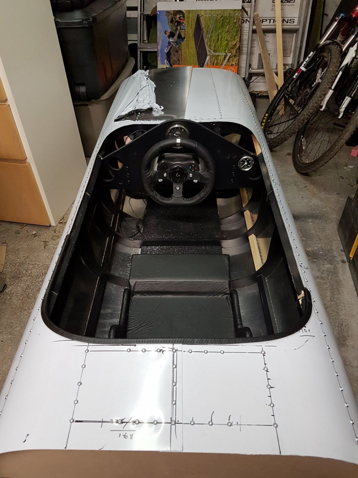

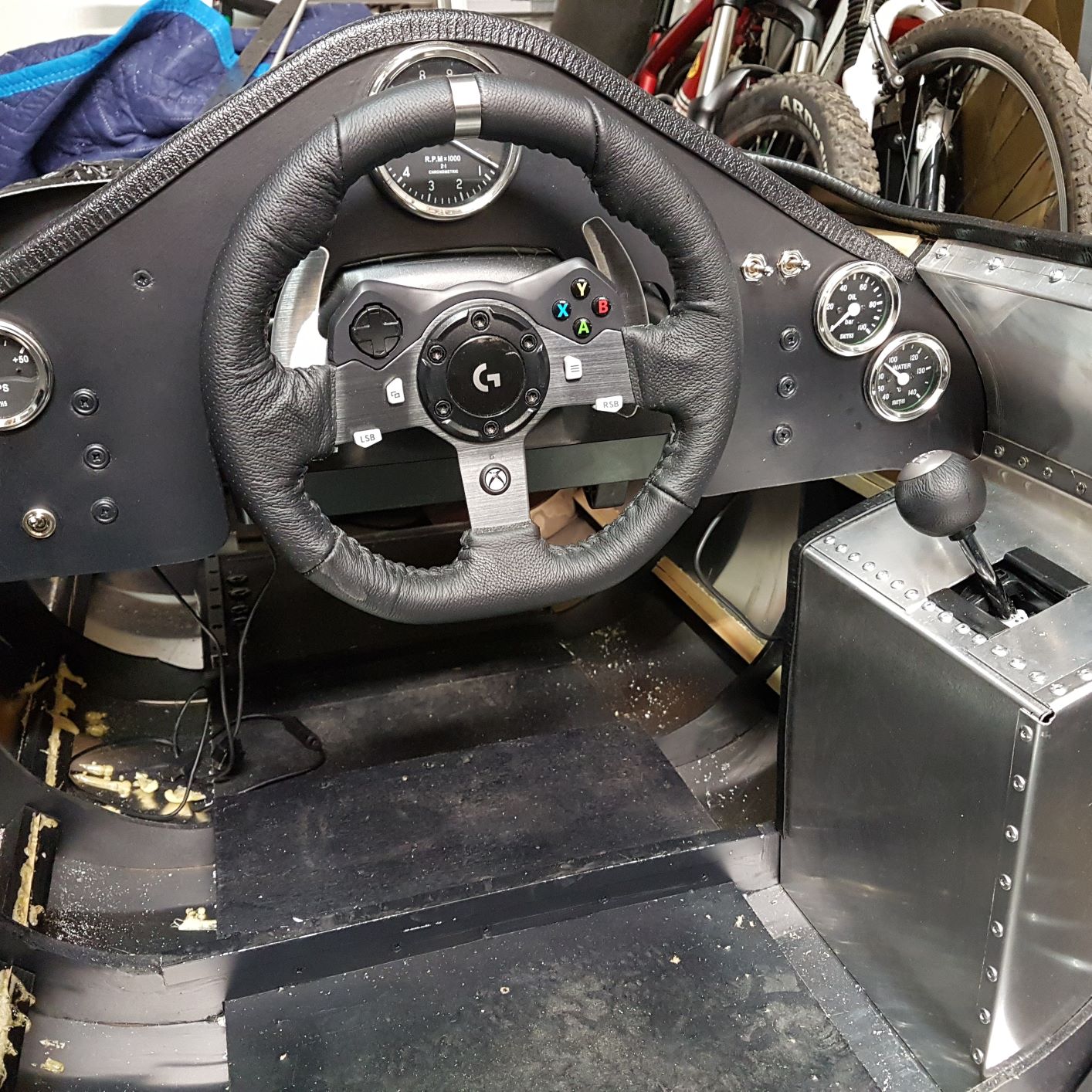

    Hi , Just a post to introduce myself.

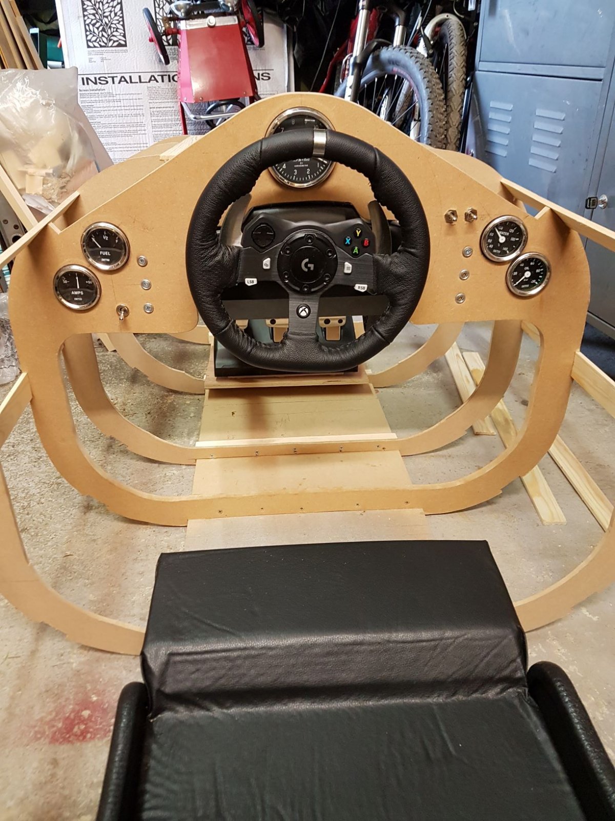

    I Happened across this site whilst searching for DIY motion simulator racing rig. I am currently building a Lotus 49 cockpit simulator, this project started off a few months ago as "Why don't we get a racing game for the new office?" To which I replied , "no problem, I will have a look into making one"

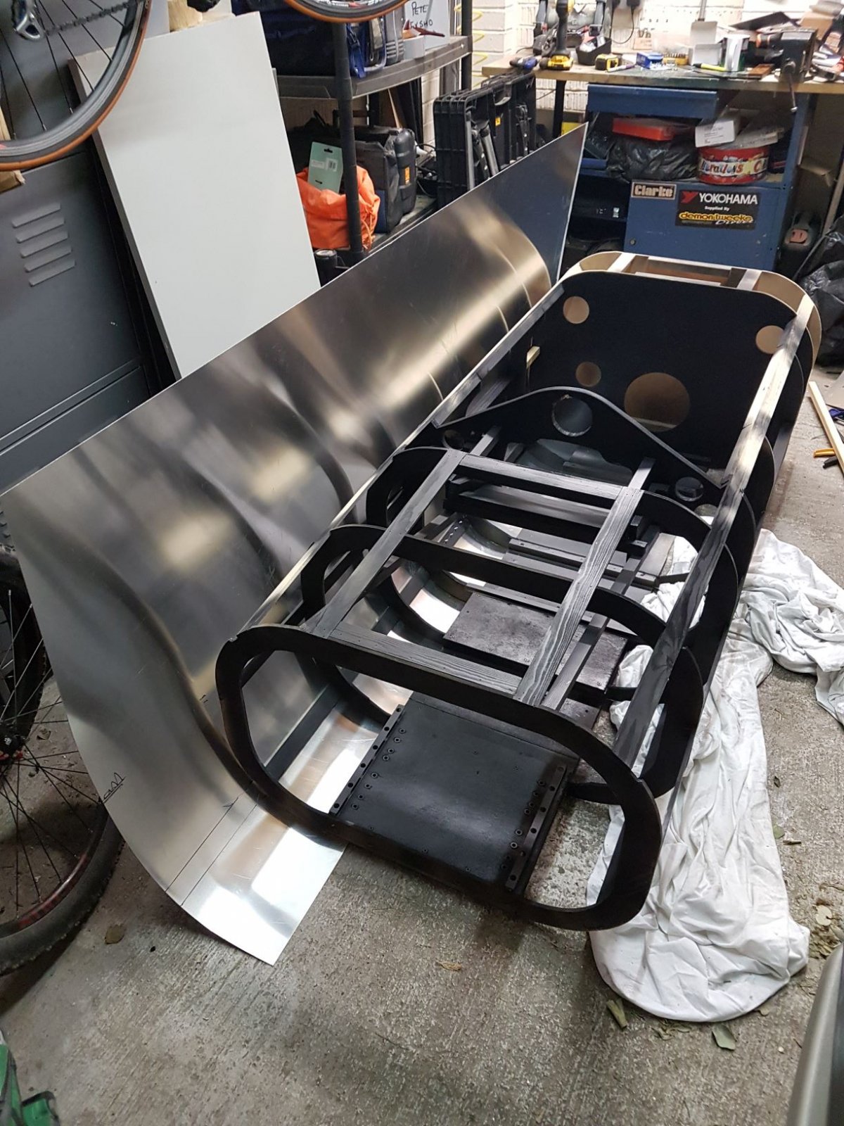

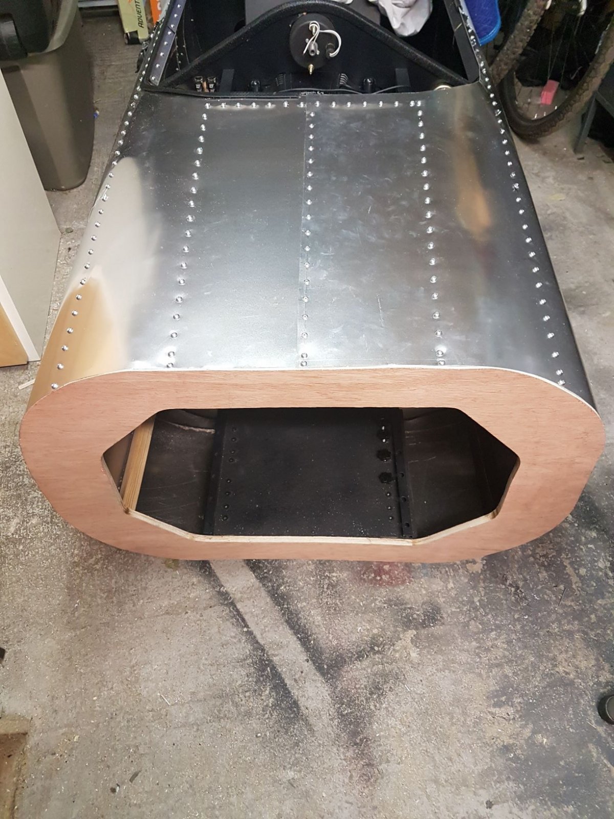

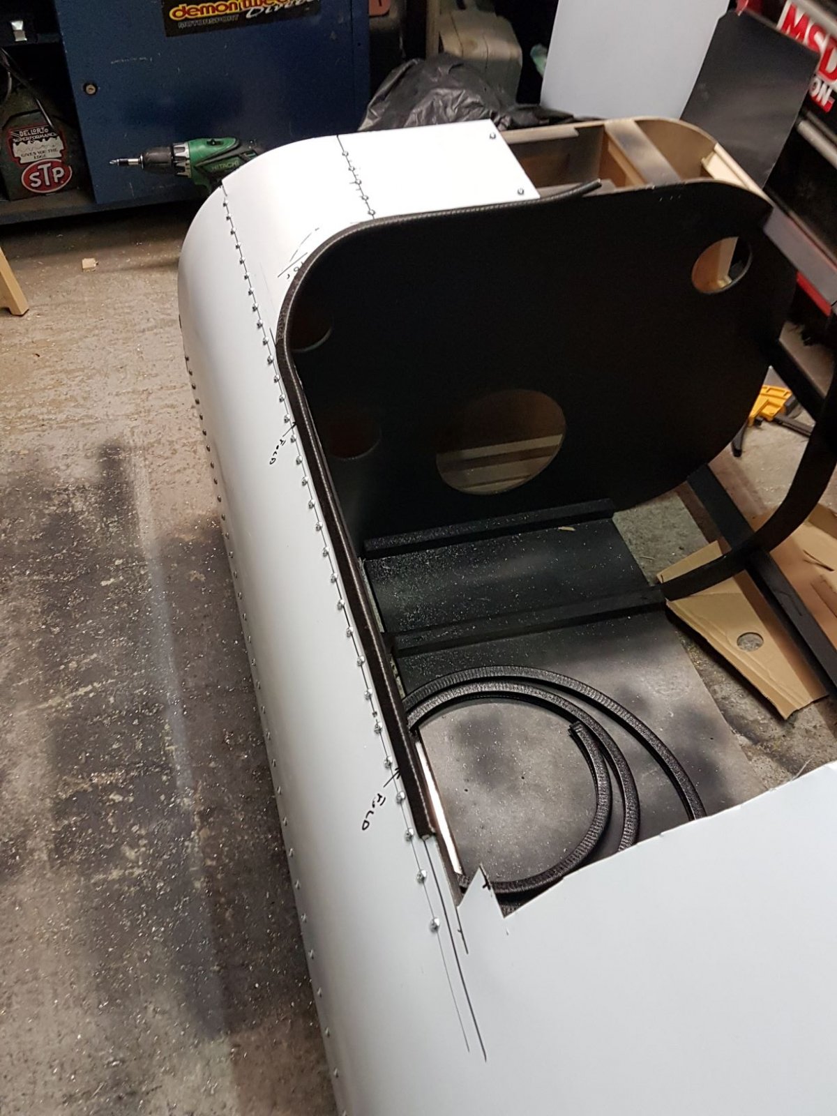

    Three months on and I have nearly finished a 1:1 scale cockpit of a 1967 Lotus 49 F1 car. Built from a wood skeleton frame and clad with aluminium panels.
    DIY made seat, dashboard and gear housing.
    The car will be painted in British racing Green with yellow stripe of course.
    I didn't intend for the sim to be a full motion sim but now I have gone this far with it, I may as well give it a go.
    The original intention was to use the Xbox one Forza 7 as it has some nice classic F1 cars including the Lotus 49. I realise that I will need to use another platform if I go for motion sim.
    Currently thinking of using assetto corsa as that has the correct circuits and cars I would want to use but happy to take advice on this.
    Any advice appreciated on where to start with this.
    My background is I have a HND in electro mechanical engineering. My day job is in electronic security so can turn my hand to most things electronic, soldering, programming PLC's as well as the mechanical stuff. I have built several kit cars and race cars so I know where to bolt the wheels on.
    A few pics of the build to date:

    Superb craftsmanship, your rig is an awesome basis for a motion rig :thumbs
    Keep in mind that you also have additional options to consider, like including a G-Seat and motion driven harness tensioner: https://www.xsimulator.net/community/faq/gseat.20/category
    Plus you can use Game Vibe to drive transducers: https://www.xsimulator.net/community/faq/transducers-rumble-motors.25/category
    Assetto Corsa (plus some mods) is an excellent choice, as it has some of the best physics for motion rigs. Project Cars 2 is another option that includes the Lotus 49 and it has classic tracks as well, along with things like day/night and built in weather.

    Many thanks noorbeast, i still have a way to go to get the rig finished as a static sim. I would really like to get the gauges working especially the rev counter. It is a replica smiths gauge 0- 10k reading with a mechanical input reduced 2:1 I have made a small connector and stuck my battery drill on it to check it moves as it should.

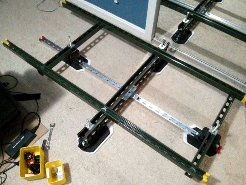

    If you want literal shaking and rattling you should look into transducers. One big advantage is that instead of just relying on the game's audio, there is software such as Game Vibe or SimVibe which can take game telemetry data -- engine RPM, road bumps, collisions, etc -- and deliver specific effects to specific points on the rig such as the seat or pedals.
    Even if you don't go full motion you can get quite a result just with transducers. For example my old rig had four really big ones (admittedly driven by two 3000W amplifiers) and I built the whole thing on springs so they could shake it even harder:

    Absolutely, I have one directly mounted to the back of my sims seat. It is great for fine motion detail, or were there is no track motion data exported - as with NL2 - so I use what is in the sound output. Don't recommend you mount the rig on springs as shown above , not hating on that member, but a setup like this often just produces unrealistic under dampened oscillations. Isolating the seat/rig on just rubber washers would be much better.
