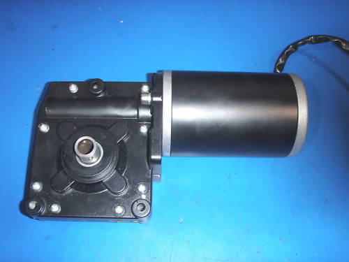

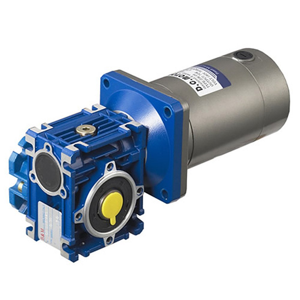

    Is this the type of motor your talking about?

    Given the space limitation a desk racer style is an option so do consider the points made by @bsft and myself regarding what to consider in making it work.
    No, the motors you linked to are 24V, 100W and 30rm. I already used Motion Dynamic as an example of suitable 60:1 DC motors but I have no idea where you are geographically located in the world: http://www.xsimulator.net/community/threads/looking-to-get-into-motion.6525/#post-72166
    If you can tell us what region of the world you live in we can perhaps suggest a source of similar motors.

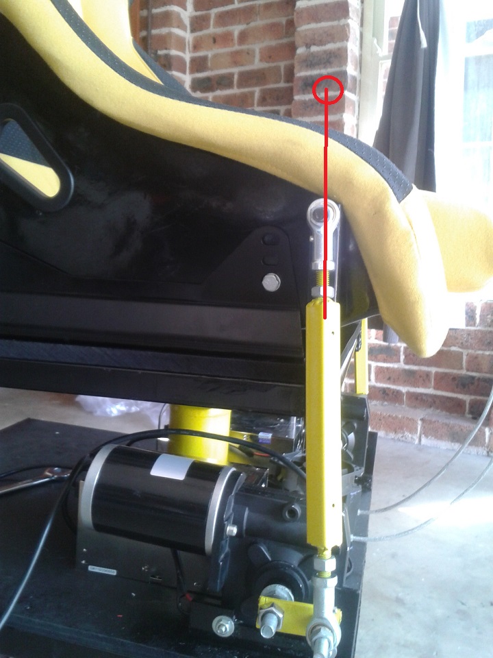

    While some angle's might not be 100% ideal, We can easily get you movin on 50:1's on a shoulder design with your space constraints. Clever usage of lever length and your speeds will be right up there. Sure Not AS fast as a 25:1 box, but understanding the load differences, there has to be a little give way here or there.
