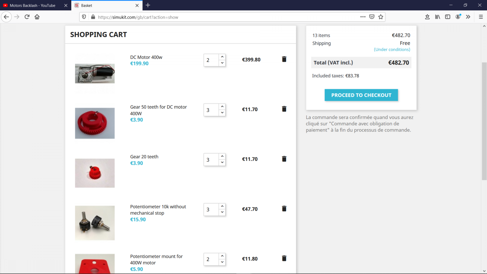

    Simukit.com Won't ship to my address...looking to find these,s parts...

    Check the FAQs, in particular the Design and Build sections, there are a bunch of options there:
    PGsaw motors from Canada, ship internationally:
    https://www.ebay.com/itm/GEAR-MOTOR...L-FEED-SIMULATOR-75-80RPM-50-1-/371596157992?
    https://www.ebay.com/itm/GEAR-MOTOR...384?pt=LH_DefaultDomain_0&hash=item51bd392f00
    3Dprint direct pot mount: https://www.xsimulator.net/community/threads/3dof-seat-mover.11103/#post-143599
    Use suitable flexible coupling to direct mount pots: https://www.xsimulator.net/community/faq/how-to-connect-protect-a-potentiometer.13/
    I use Hall sensors rather than traditional pots, as they won't break if over rotated, have excellent resolution and long life, Element14 has these worldwide: https://au.element14.com/bi-technol...fs/sensor-hall-0-2v-20v-to-10v-pin/dp/2319662
    Use SimCalc to get your head around design Vs physics to work out which motor best suits: https://www.xsimulator.net/communit...e-linear-speed-and-forces-of-your-design.270/
    You have a number of control board options, which you will find in the FAQs, but I would suggest either JRKs for ease of set up, or Sabertooth using the SMC3 Arduino code and settings app.
